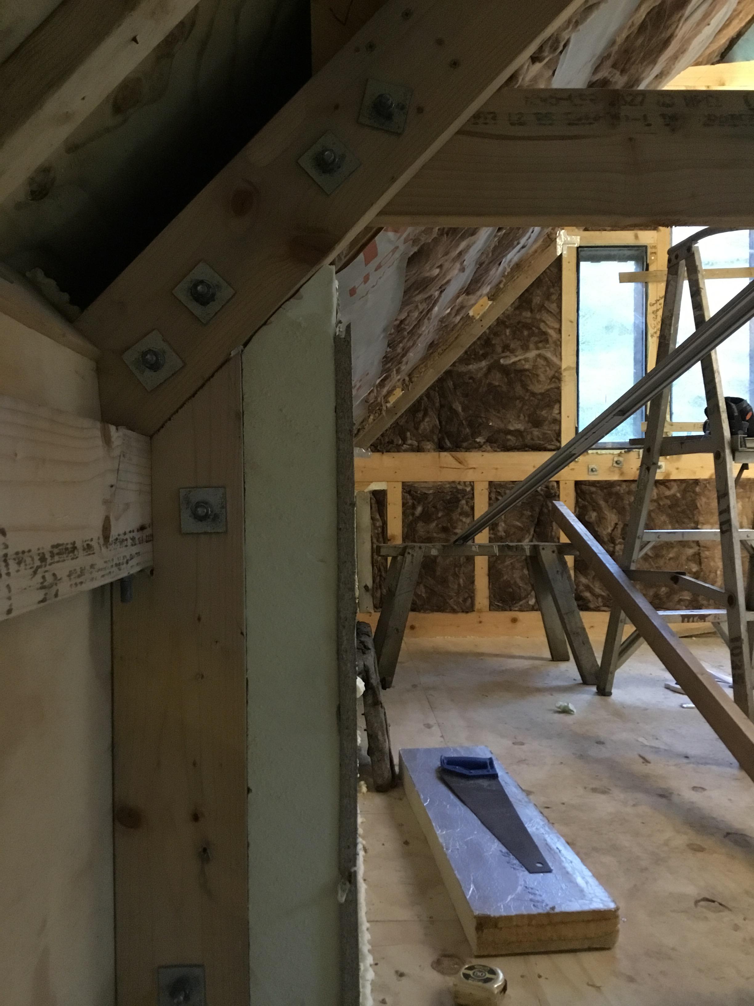

ToughButterCup Posted February 12, 2019 Posted February 12, 2019 Our roof design has 200mm insulation between rafters and 80mm underneath. With only a little bit of cursing and swearing I got three 80mm insulation boards up -on my own- yesterday. Vaulted roof spaces look sexy but they are sods to underboard. 0300 this morning : bububugger - I bet I should have put the studding in first - because that needs to be attached to the bottom of the rafters. And I've gone and hidden them now. Well, not quite. I can see where the rafters are because of the attachment points for the insulation. Those massive washers are a bit of a giveaway. Am I going to have to dig out the insulation where the verticals meet the rafters, or should I put the studding in first - and then underboard? Phhhh, 'nother steep learning curve I got myslef into innit?

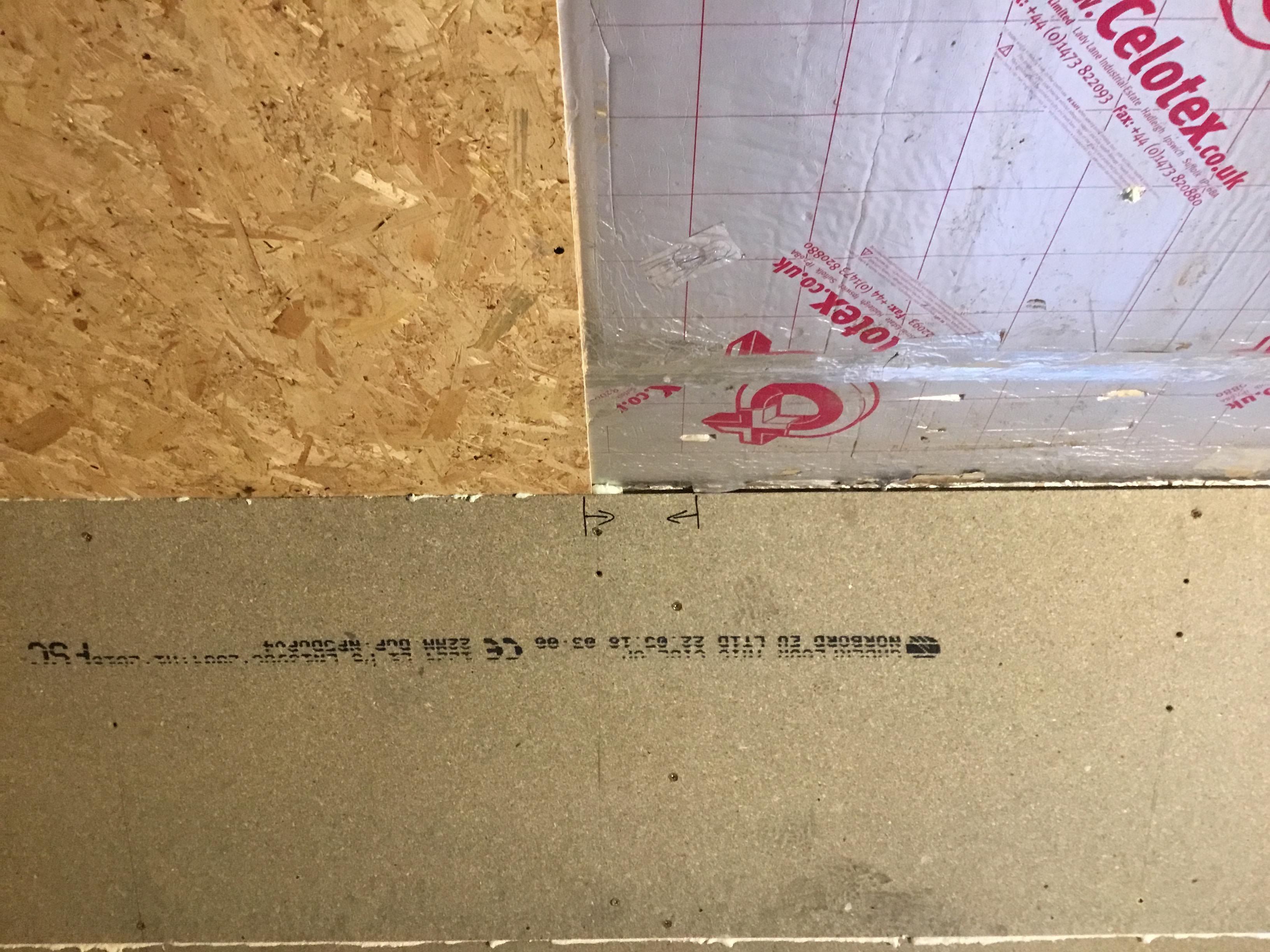

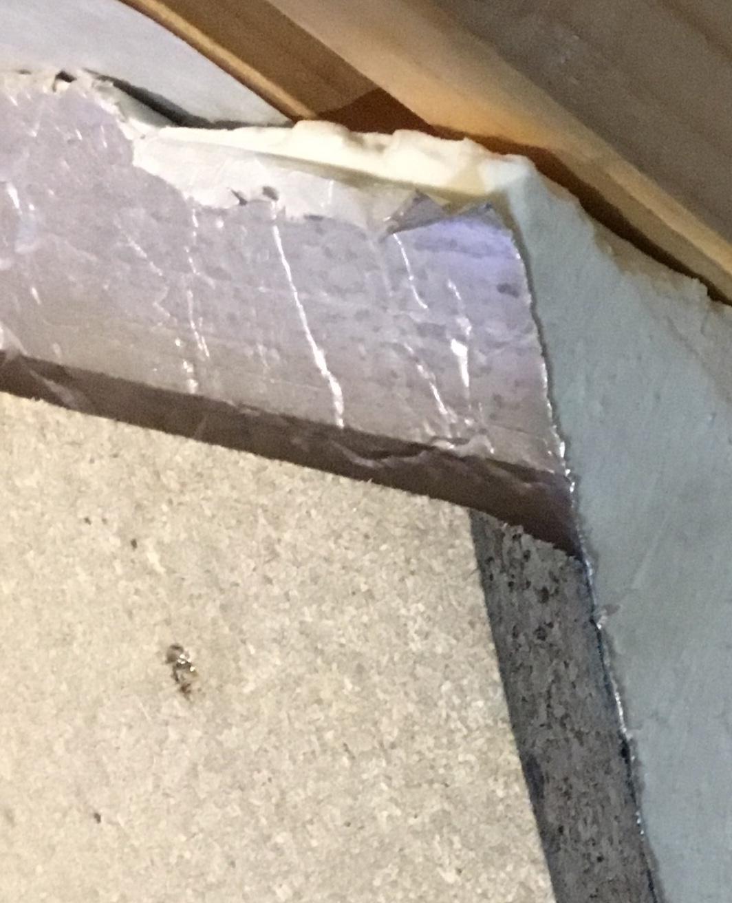

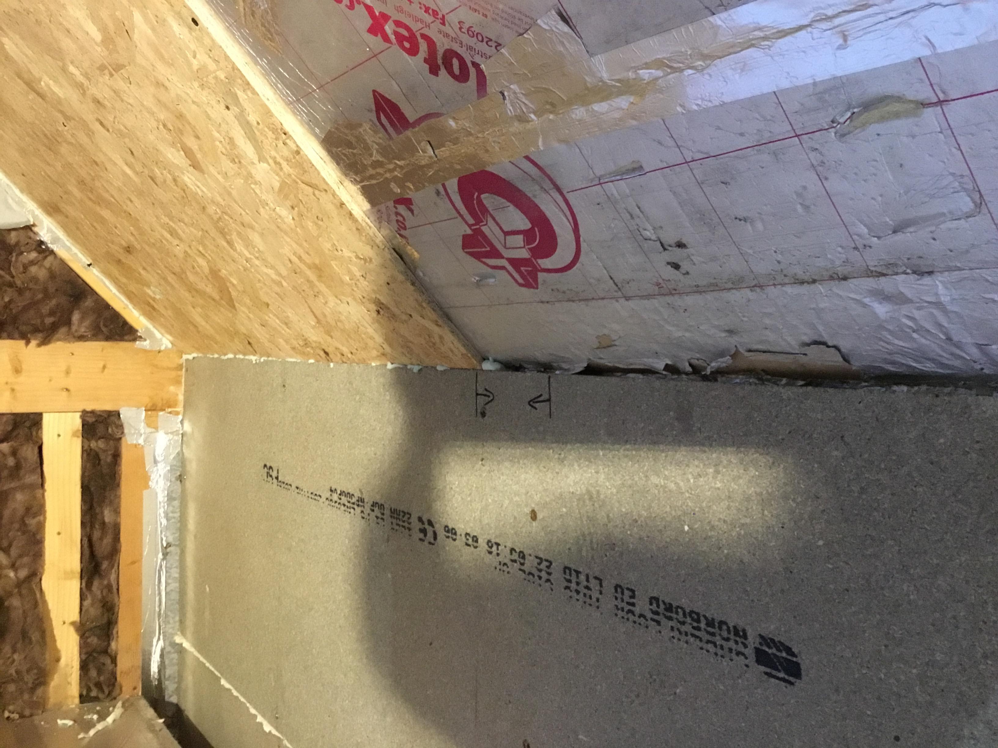

Cpd Posted February 12, 2019 Posted February 12, 2019 I know it’s not the same as yours, yours will be a “ right proper job” but this is the way I am doing it in the shed. It’s a bit tatty but all the insulation was free as was the chipboard flooring on the walls, as were the windows etc etc......

ToughButterCup Posted February 12, 2019 Author Posted February 12, 2019 37 minutes ago, Cpd said: I know it’s not the same as yours, yours will be a “ right proper job” but this is the way I am doing it in the shed. It’s a bit tatty but all the insulation was free as was the chipboard flooring on the walls, as were the windows etc etc...... Well, for free stuff, that looks excellent. So, those screws go through the board, through the Celotex and into the joists / rafter?
Cpd Posted February 12, 2019 Posted February 12, 2019 33 minutes ago, recoveringacademic said: So, those screws go through the board, through the Celotex and into the joists / rafter? Yes they are 150mm with big heads so you can really tighten them down, some need to be countersunk to give them a bit more depth as your only left with 30mm to grip into the wood, seems to work well though. Bigger screws would be better but that’s all I had in “stock” the ceiling is easier as it’s just 60mm with about 11mm osb so 90mm fixings work fine as there is more flex in the insulation and osb... again 100mm would be better but it’s just my shed and trying to use up what Ive got laying around. No point getting all this stuff for free and not using it one way or the other.
