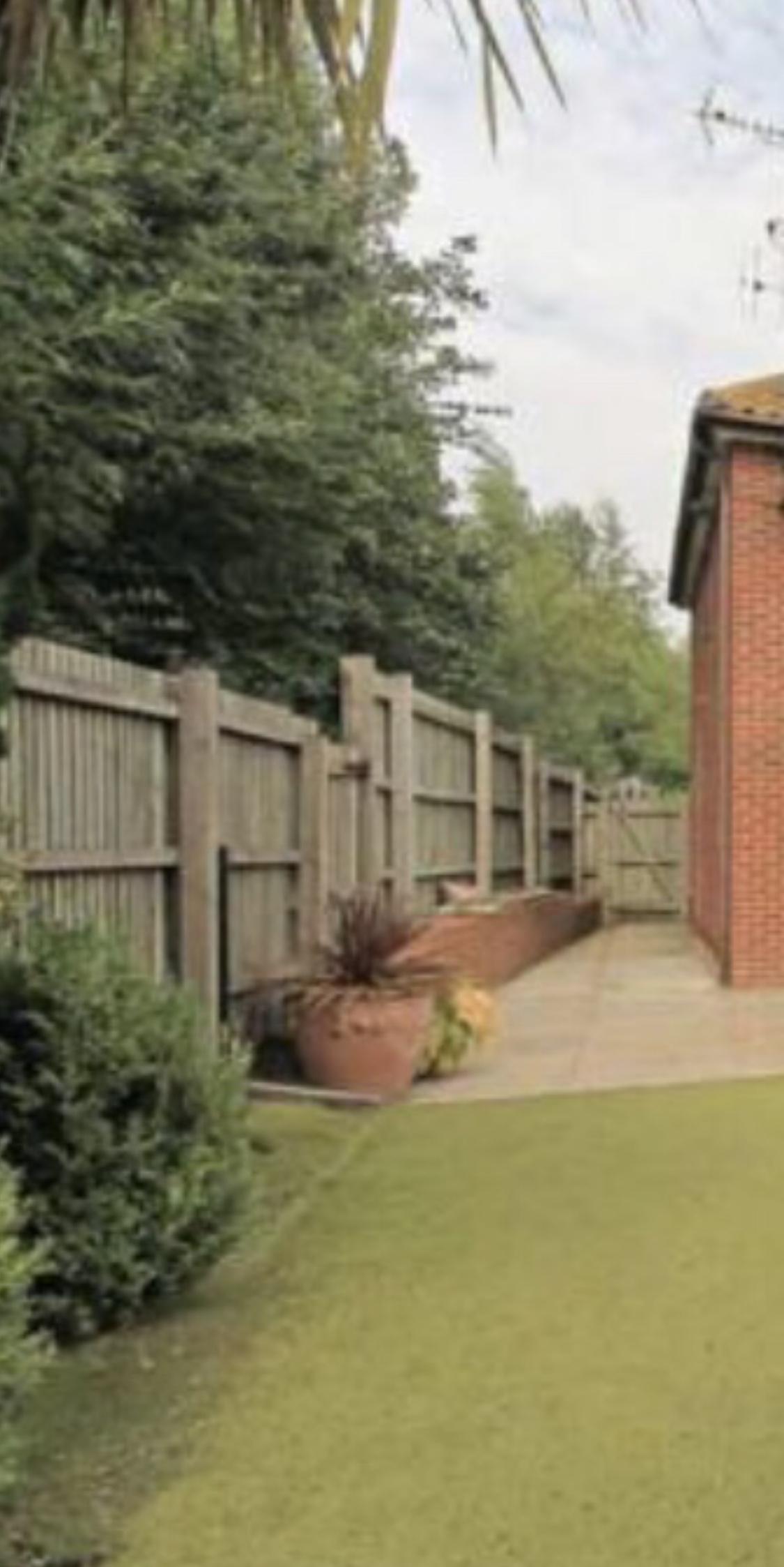

newhome Posted February 9, 2019 Share Posted February 9, 2019 It would probably go up a bank ok if it was fixed securely. We had a small slope on the garden that we put AstroTurf on and grew plants through it. Gravel would have washed down onto the flat AstroTurf. It worked ok. This was it after about 15 years Link to comment Share on other sites More sharing options...
