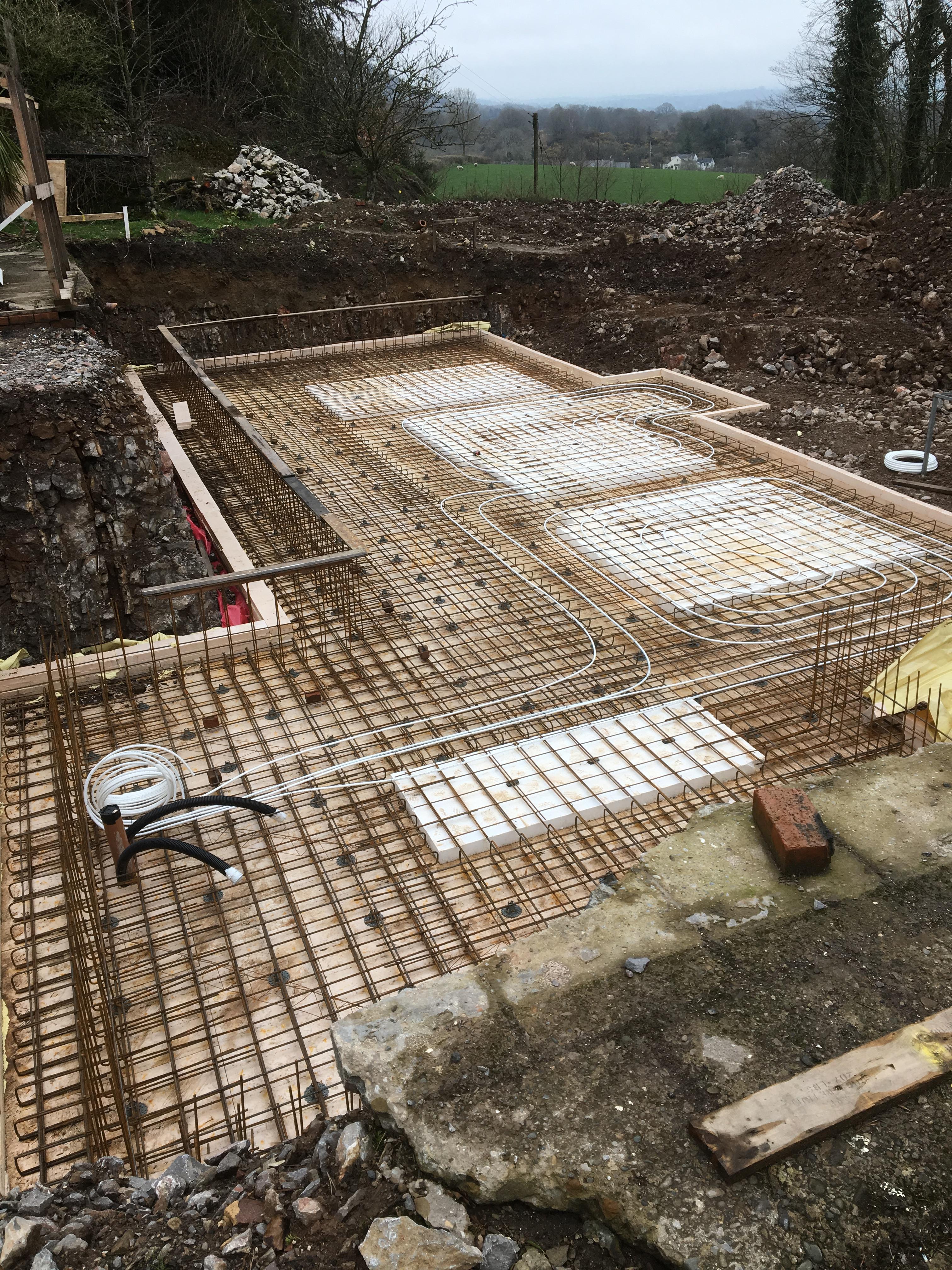

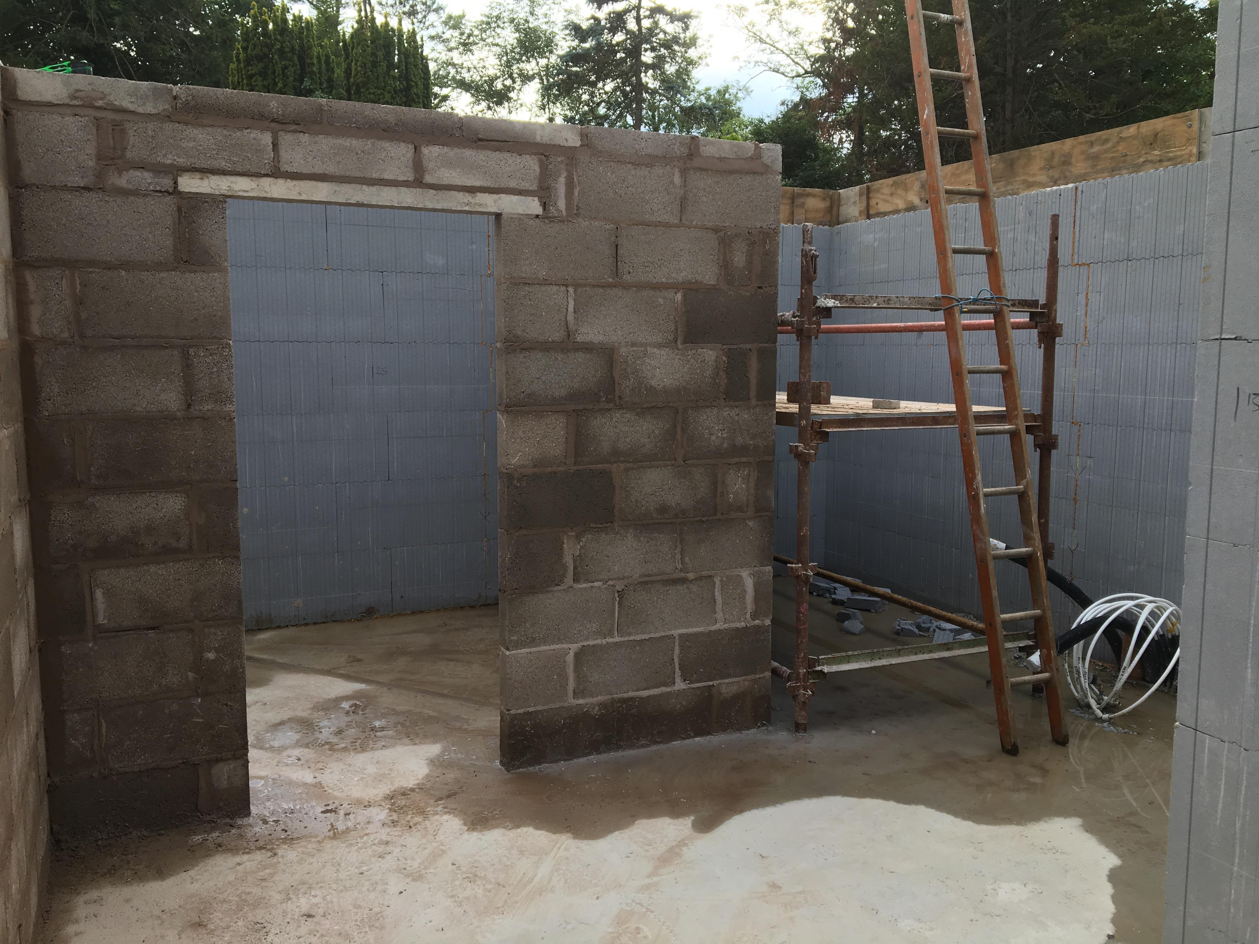

I constructed our using ICF, defiantly a DIY job if your willing to get stuck in!
Here it is with the insulated slab
ready for the concrete.
A view part for the completed basement with interior walls.

Icf as far as I am aware you can only pour up to a certain height before risk of blowout increases more . This is what concerned me because I can’t get to the outside . So cost wise you might need the concrete pump twice . Also the icf insulation wasn’t thick enough so i’d Need to add PIR anyway .

We poured 26 tonnes of concrete  in one go, to the full height of the ICF shown (2.6m) The most important thing is the prop the ICF as per the manufacturers instructions, then add more props, for good measure.  We also chose an ICF system with a good internal matrix of cross ties, this helps stop the two sections splitting during the pour, we also used s small concrete poker and resisted the urge to over poke the concrete.

I’m surprised at that . When I looked into icf ( some years ago ) they were adamant not to pour more than 5 or 6 levels . Guess things have changed .
