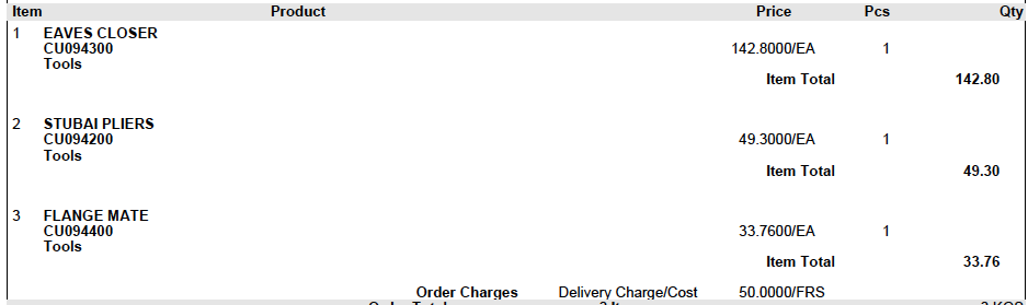

Russell griffiths Posted February 8, 2019 Posted February 8, 2019 Hi. Anybody that has done there own raised seam roof, did you find a few tools that where essential funny shape pliers, tin snips. @JamesP @Alexphd1 Cheers.
Alexphd1 Posted February 8, 2019 Posted February 8, 2019 Are you forming your own panels or buying pre made panels?
Russell griffiths Posted February 9, 2019 Author Posted February 9, 2019 Pre made panels, looking for decent tin snips, duckbill pliers, and anything you found good for bending bottom hems and other bits and pieces.

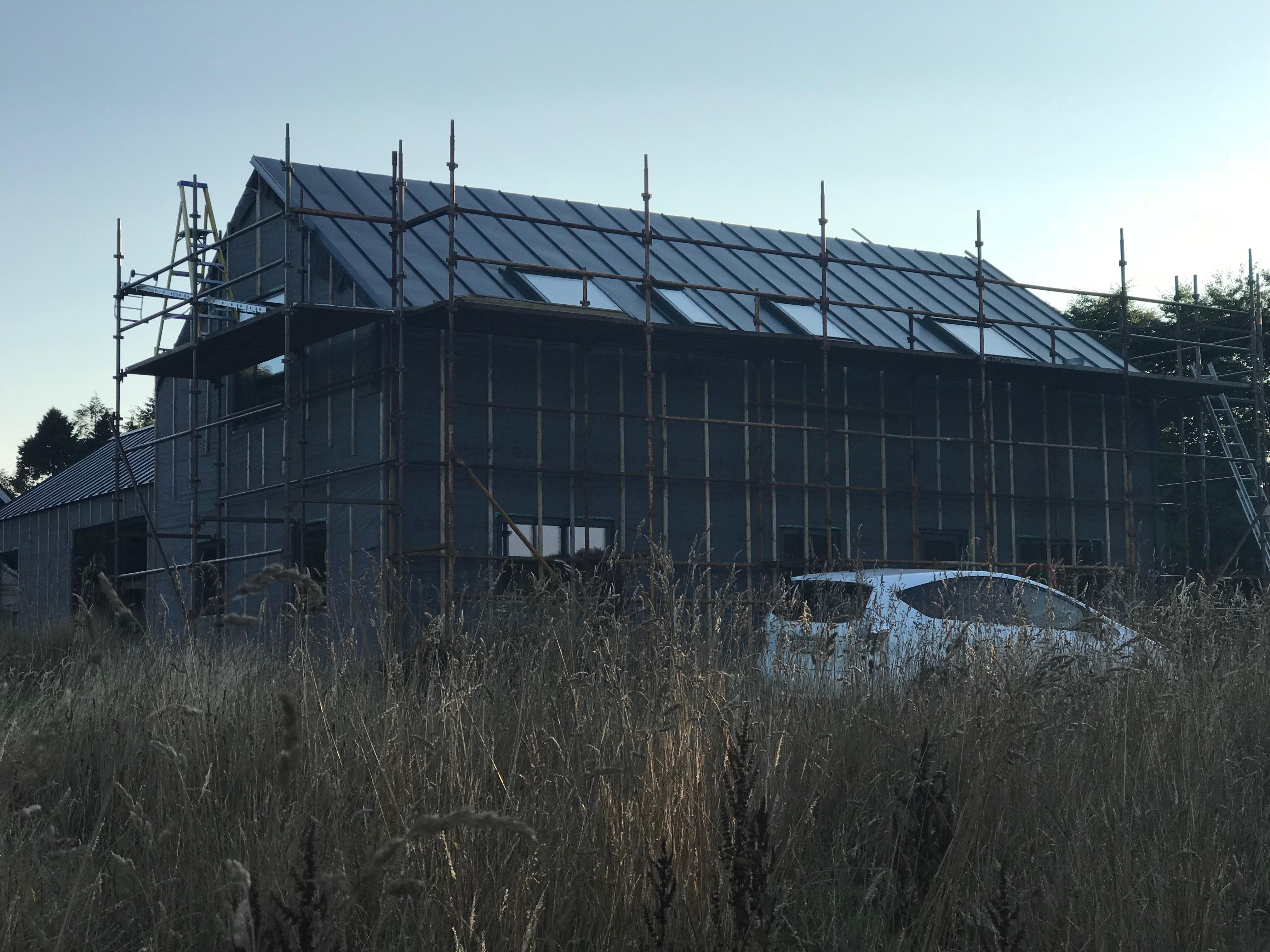

Nestor Posted February 15, 2019 Posted February 15, 2019 Hi Russell Sorry for the delay, only just seen your post. For my Tata roof they supplied, 3 tools. Eaves closer, Stubai pliers and Flange mate. I also bought left and right off set tin snips. Best bit was Makita 136mm 30 tooth metal blade for circular saw, I cut all the panels with this. 1

BNF Posted February 26, 2019 Posted February 26, 2019 Hi Can I ask how you like your TATA roof, and which one you went for, we are just researching different roofing options. We are going for an industrial roof appearance. Thanks
Nestor Posted February 26, 2019 Posted February 26, 2019 8 hours ago, BNF said: Hi Can I ask how you like your TATA roof, and which one you went for, we are just researching different roofing options. We are going for an industrial roof appearance. Thanks Hi there, very happy so far with the roof. I chose it because I could fit myself and it was within my budget. Lots of other options on the Forum here.
