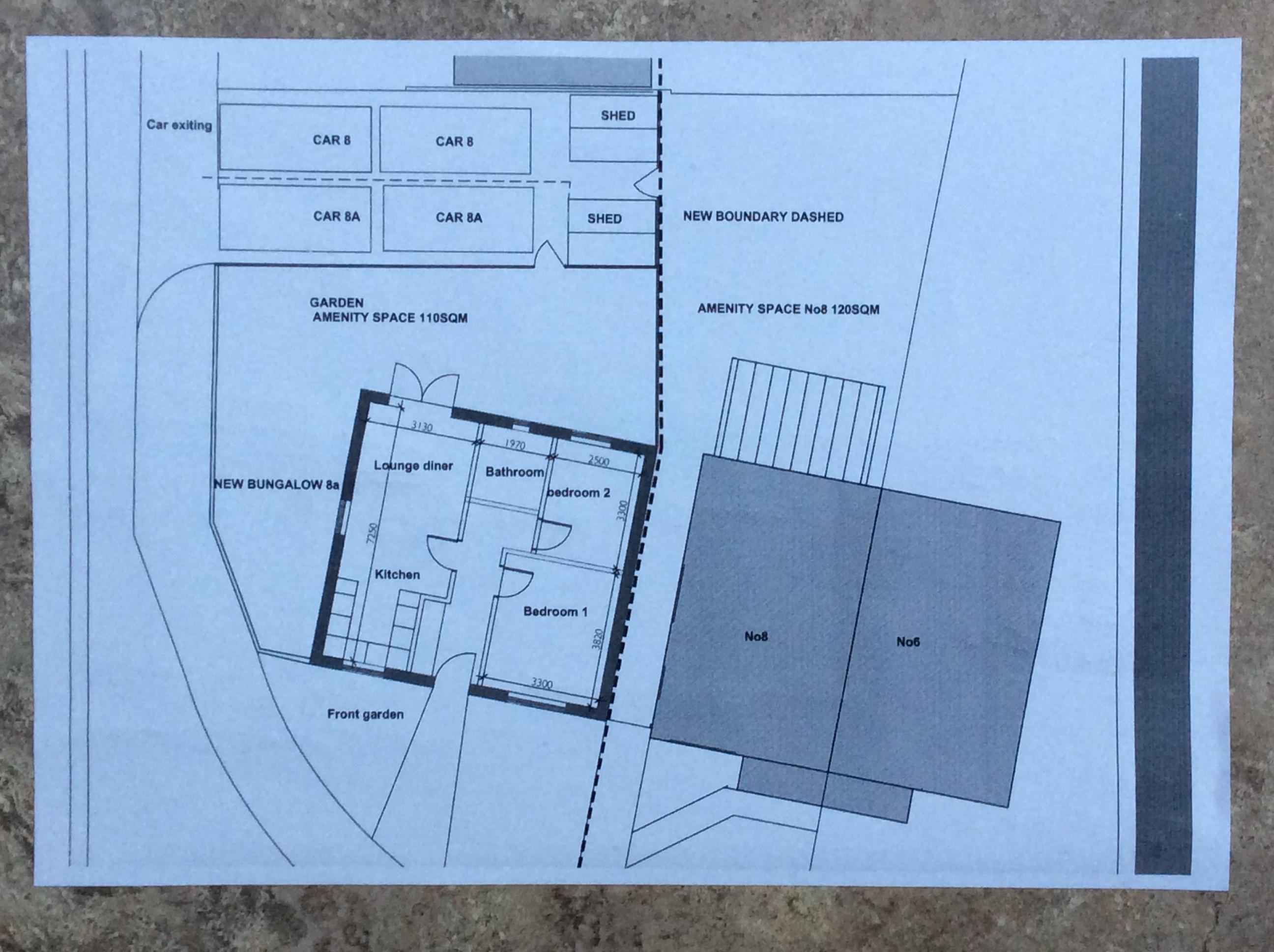

simplepimple Posted February 3, 2019 Share Posted February 3, 2019 Here's the outline plan for my teeny house. Scary posting on here because I know my build has huge limitations but everyone has been so helpful already. It's very small but perhaps that also makes is very simple? I'm due to see the architect soon for consultation prior to full planning however it would be really helpful to gain any insights anyone might have into the best use of space and design. It's quite compromised by the parking requirements. I know there are probably easier plots to work with but none that fit my budget in the area I need to be. Luckily I'm not too fussed about a small garden. Sorry there are no actual measurements apart from on the house plan itself. The front elevation is south facing. The east elevation can't have any windows as its set against the boundary with the host house. The planning department is not keen on allowing an upstairs however I wondered if it might be considered if I only keep two bedrooms - one upstairs with a bathroom and one downstairs with a shower room. I'n not sure of the correct terminology but the planning is subject to no automatic right for permitted development rights for loft conversions etc otherwise I'd just add that in afterwards. Link to comment Share on other sites More sharing options...
ProDave Posted February 3, 2019 Share Posted February 3, 2019 The plot is what it is. I would change the layout Have living room and Kitchen / diner at the front as two separate rooms one either side of the hall. That way the main living rooms get the sun. If the one to the left (west) is the living room you could have a window or even patio doors onto the side garden to get afternoon sun. Then have the bedrooms at the back either side of the bathroom with the north facing windows. I did some work in a bungalow with that layout last week and the layout seemed to work well. A variation would be double doors from both the living room and kitchen diner into the hall, then by opening both doors to each room you can pretty much open those up as one big space when you want to. I would also build the roof with attic trusses to allow for a future room upstairs. Think how you might add a staircase to serve that later on and build it so that is easy to convert later. 1 Link to comment Share on other sites More sharing options...

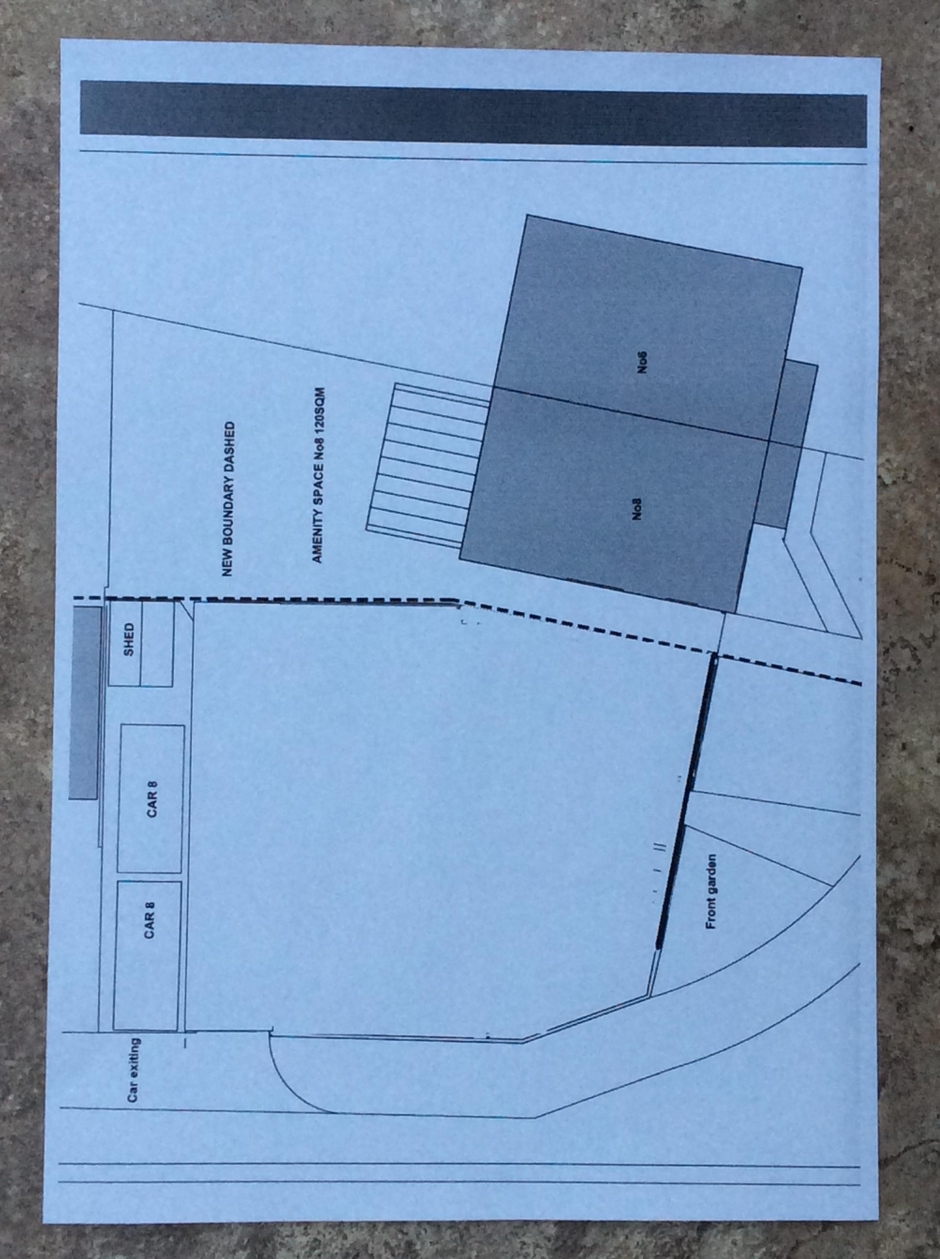

simplepimple Posted February 3, 2019 Author Share Posted February 3, 2019 The design was just the one that the architect drew for the plot sellers in order for them to gain planning permission. A previous bigger design in a slight different place was denied permission. I imagine I'll be going to the same architect for the plan for full planning. The plot is in Suffolk and the rest of the street is mainly brick 1960's semi's although there are two other detached bungalows built upon previous garden plots. 1 Link to comment Share on other sites More sharing options...
simplepimple Posted February 3, 2019 Author Share Posted February 3, 2019 The building by the parking provision is the garage of the other house next door which is co-incidentally for sale. I'm hoping to put my caravan [builders office] on the parking places during the build as the plot is tight. Link to comment Share on other sites More sharing options...

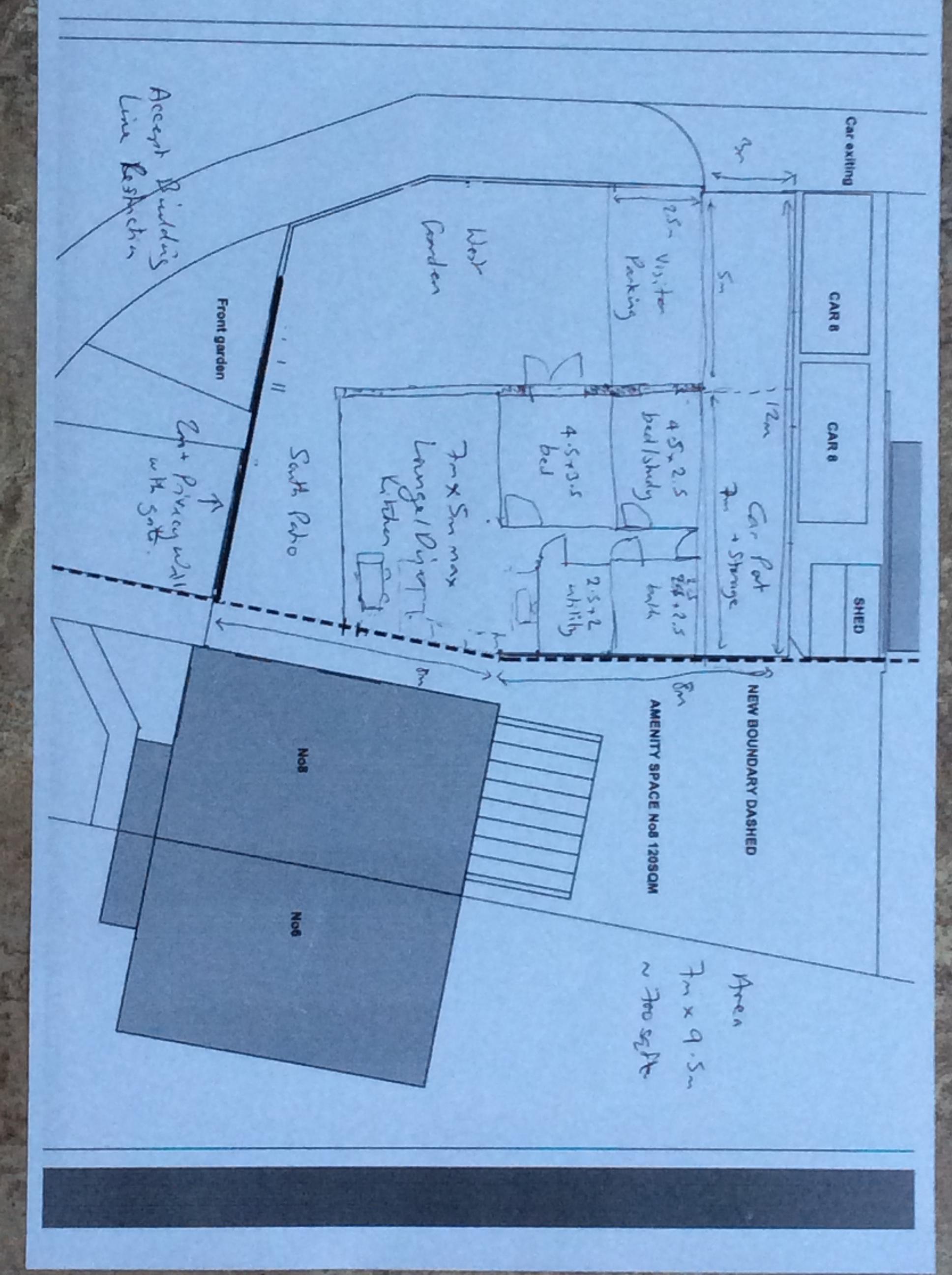

Ferdinand Posted February 4, 2019 Share Posted February 4, 2019 (edited) @newhome The normal rule is something like 2 spaces for 2/3 bed, and 3 spaces for 4-bed. @simplepimple Another material inaccuracy on the plan afaics ... next door are misrepresenting their amenity space. It says 120sqm, whilst putting a measure on it says something like 60sqm if that grid thing on the back is a conservatory, and about 75sqm if it is a patio. It may be that some of these misrepresented aspects have got through outline, but tmay be questioned at detailed planning stage .. so take your time to be sure. Visually, just compare the fifty sqm footprint of your bungalow to their back garden and it sticks out like a sore thumb. I would suggest taking great care on measurements etc. Do not let them peg out the plot for you, or you could get scalped. BE particularly suspicious of the width of their parking area, the position of that gate, that you are getting all the width of your plot, and where the edge of the pavement is taken as being. If you have not signed on the dotted line, I would get a check that your 110sqm is accurate. I think you are actually getting slightly under 80 sqm, which is a quarter less than you are being told if accurate. Potential negotiating point imo rather than a withdrawal point imo, it is still a very nice plot. Amenity space is private, and it does not I think I nclude sheds, storage, parking outside your privacy fence, or narrow areas which cannot be sued practically or access paths. F Edited February 4, 2019 by Ferdinand Link to comment Share on other sites More sharing options...

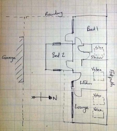

Ferdinand Posted February 13, 2019 Share Posted February 13, 2019 (edited) To add to this thread, as it may be useful. This is a design I sketched out on @simplepimple's plot. Basic idea I have attached a few prices of something a little more as I would do on that plot. Not to say that it is the only way to do it, but for alternative view and food for thought. It is a little larger by 120sqft but I am not sure that the cost would be much more. It is also a concept rather than complete, for example the way in is not resolved and there are several options. Personally I would take it right to the N boundary, create a little more space in the S patio, and adjust a few rooms depending on just what I needed. THere are lots of other possibles. (Sorry for the variable orientations; you will all have to stand on your heads, and read the other one as 'put you to sleep' material in bed.) Trad bungalow Actual Plot Alternative Proposal Commentary Good stuff. That layout out is still quite unfinished .. it would need input from yourself on things like entrances, and how you want to live. It is amazing how much is added by very little extra area. Eg moving from a 10x10 bedroom to a 11x14 bedroom, What happens is that the amount of perceived space .. eg not taken up by the bed and the door opening .. doubles or triples. It is rather like the perceived size of a car is 70-80% based on the length. On 680sqft or so, you can get 2 nice double bedrooms etc, but there are compromises on other things eg in this layout the kitchen is a bit tight and the south garden is reduced. A perforated screening wall on the building line may be the solution. It will need all need a lot of thought. If the bungalow went right to the top of the plot, you could have 3 bedrooms if really needed, but that extra space might be better in the south garden. You could also have a modest path all the way round for maintenance, but since you only have one neighbour who has paths or driveways on nearly your entire boundary, relying on that is prob. Preferable. Edited February 13, 2019 by Ferdinand Link to comment Share on other sites More sharing options...
