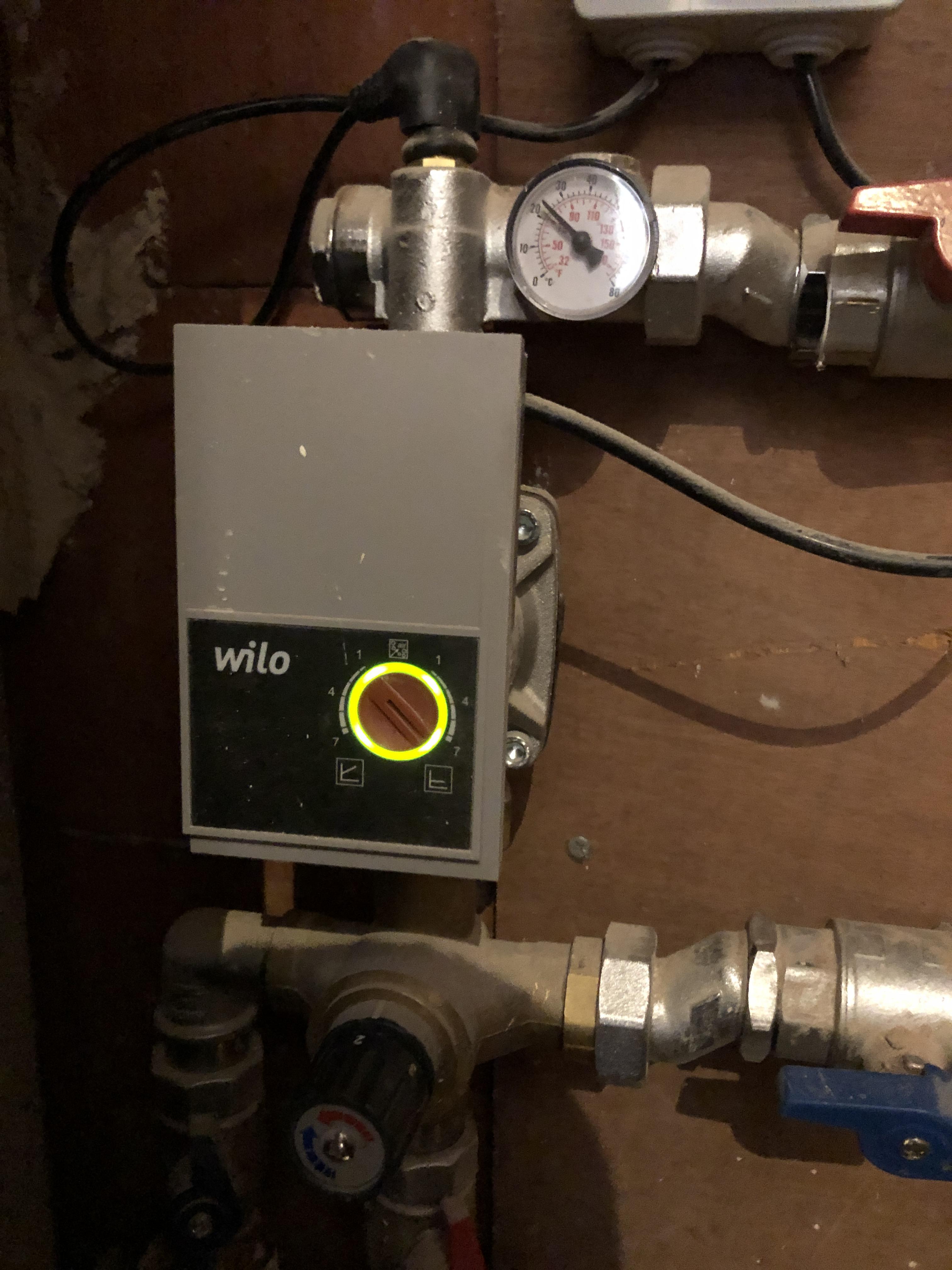

Hi,
I will email the heating engineer in the morning, but if anyone knows a simple fix I can try it today.
We have 4 UFH manifolds, all has been fine until Friday.
The kitchen seemed cold. I thought the thermostat maybe wasn't calling for heat correctly and checked that out.
It still seemed to be slow warming up, so I went to the manifold and turned the flow up slightly.
What seems to be happening is that if you turn the flow up past a certain point the water stops flowing.
Basically any higher than 2 on the mixer which is 22-23C and the flow stops. Even then I had to jack the pump up to maximum to get much flow.
The other manifolds are set between 36 and 42 and running as expected.
Probably wasn't an issue until the temperature dropped below zero.
Any thought?
Or maybe the impeller on the pump
has become partially detached.

But why would it only stop when I turn the mixer valve up?
I am going to turn it again to listen to it, thinking about it, it sounds a bit like a ball valve closing as I turn the mixer valve.
Certainly though it was working fine so maybe something is now wrong with the pump.
OK. I went and listened to it and turned it the mixing valve up and down.
Up to around 1.8 on the mixer valve I get the normal flow rate of around 3l/min.
As the valve passes through 2 it hisses slightly like a closing valve and the flow rate begins to slow down. Past around 2.5 the flow collapses to 0.5l/min the stops.
I am guessing this means that the mixer valve is broken?
The pump runs all the time and as we have maximum flow below 2 on the mixer valve it seems OK.

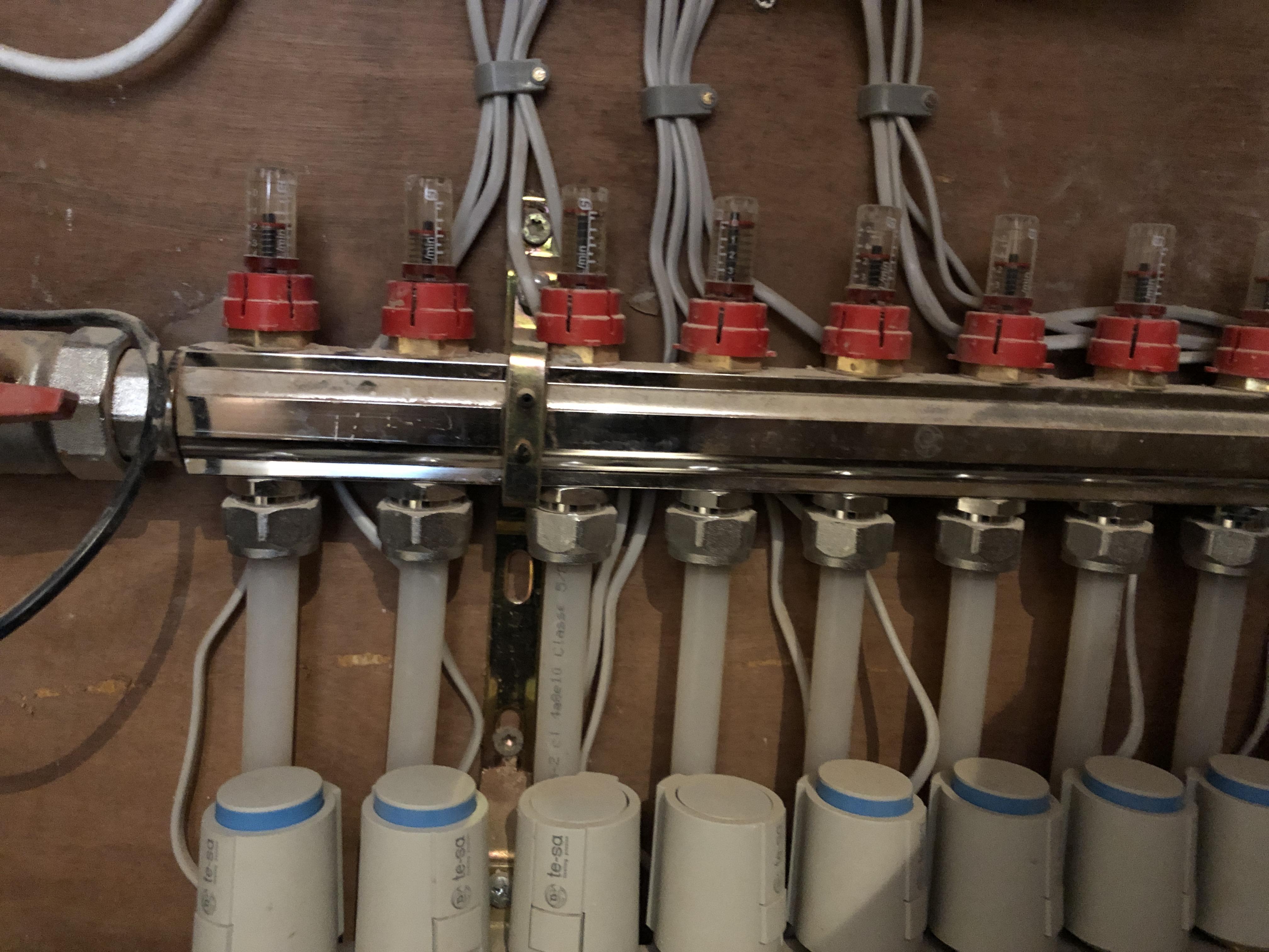

Sounds like air in the system to me.  Is this manifold higher than the others?  So flow is okay when not calling for heat, it just circulates the (cold) water around the loops but as soon as the mixer opens up demand from the hot feed, it just gets air.
Check the system pressure (assuming a sealed system) and try opening the manifold air bleed valves.
It is on the ground floor, there are two manifolds on the ground and two on the first floor.
It is a Te-Sa manifold. Having looked at it I cannot see an air bleed valve. The valves I thought were for air bleed were just for filling.
Edited by AliG
That's the blending valve in the first photo there. Happy to post a different pic if it helps.
Having looked on line I wonder if there is simply dirt in the mixer valve.
Having looked at the manual for the pump, if you put it on the central setting it runs for 10 minutes automatically bleeding the pump but not the system.
I have run this anyway just in case it helps.
