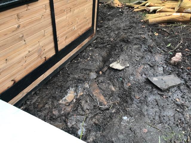

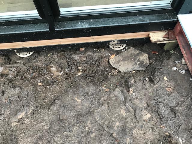

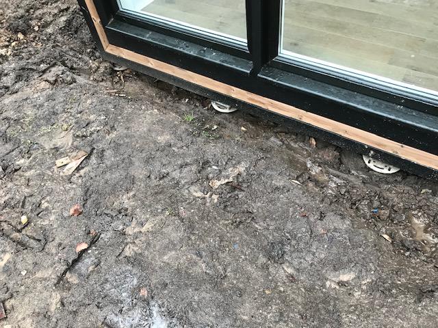

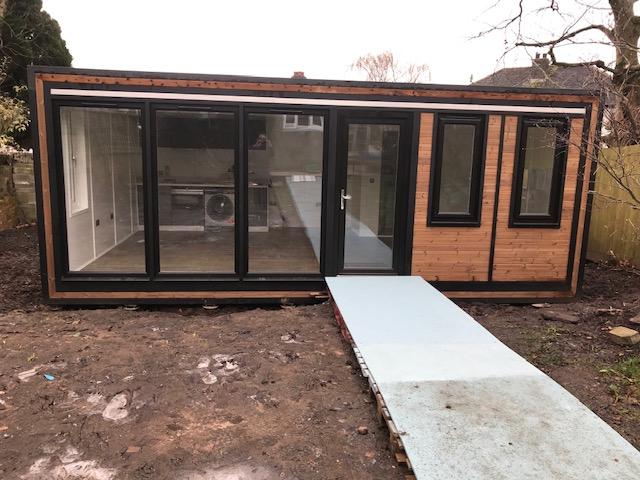

Invader75 Posted January 31, 2019 Posted January 31, 2019 Hi guys, I need to create a retaining wall in front of our new annexe. The garden is on a slight slope. Once this is done we're looking at creating a decking area or slab/patio area depending on cost. I'm no builder but don't mind getting my hands mucky. Can anyone give me some simple advice or guidelines on how to achieve this simply please? Cheers P.S. Path in the photo is just a temporary one to gain access.
Ferdinand Posted January 31, 2019 Posted January 31, 2019 WHat material do you want to retain, and what is your height required i.e. Max depth of retained material? F
ultramods Posted January 31, 2019 Posted January 31, 2019 I need to construct one which has a max height of 1 metre. I am thinking about using concrete fence posts and gravel boards. This will work out a lot cheaper for me compared to getting a professional to construct a block wall. I have seen a company on ebay that sells posts and boards cheaper than B&Q etc. I haven't checked to see what delivery would cost yet. https://www.ebay.co.uk/itm/Various-Size-Slotted-Reinforced-Concrete-Posts/283338462501?_trkparms=aid%3D555018%26algo%3DPL.SIM%26ao%3D1%26asc%3D20140122125356%26meid%3D55b1c3254cf54c81ada7f844add6d13b%26pid%3D100005%26rk%3D1%26rkt%3D6%26sd%3D283327548345%26itm%3D283338462501&_trksid=p2047675.c100005.m1851 https://www.ebay.co.uk/itm/6FT-x-1FT-Plain-Concrete-Gravel-Boards-Pack-Of-10/283327548345?_trkparms=aid%3D111001%26algo%3DREC.SEED%26ao%3D1%26asc%3D20160908105057%26meid%3Dde5324c0b27c4fa683a99297e660690e%26pid%3D100675%26rk%3D5%26rkt%3D15%26sd%3D163512746797%26itm%3D283327548345&_trksid=p2481888.c100675.m4236&_trkparms=pageci%3A68028a39-2557-11e9-830c-74dbd180cf30|parentrq%3Aa3f9f8421680ab6b23c60346ffe2eb4c|iid%3A1
Invader75 Posted January 31, 2019 Author Posted January 31, 2019 1 hour ago, Ferdinand said: WHat material do you want to retain, and what is your height required i.e. Max depth of retained material? F I need to retain the mud/soil. Eventually we need to create some kind of patio/veranda/decking in front of the annexe.
Invader75 Posted January 31, 2019 Author Posted January 31, 2019 21 minutes ago, ultramods said: I need to construct one which has a max height of 1 metre. I am thinking about using concrete fence posts and gravel boards. This will work out a lot cheaper for me compared to getting a professional to construct a block wall. I have seen a company on ebay that sells posts and boards cheaper than B&Q etc. I haven't checked to see what delivery would cost yet. https://www.ebay.co.uk/itm/Various-Size-Slotted-Reinforced-Concrete-Posts/283338462501?_trkparms=aid%3D555018%26algo%3DPL.SIM%26ao%3D1%26asc%3D20140122125356%26meid%3D55b1c3254cf54c81ada7f844add6d13b%26pid%3D100005%26rk%3D1%26rkt%3D6%26sd%3D283327548345%26itm%3D283338462501&_trksid=p2047675.c100005.m1851 https://www.ebay.co.uk/itm/6FT-x-1FT-Plain-Concrete-Gravel-Boards-Pack-Of-10/283327548345?_trkparms=aid%3D111001%26algo%3DREC.SEED%26ao%3D1%26asc%3D20160908105057%26meid%3Dde5324c0b27c4fa683a99297e660690e%26pid%3D100675%26rk%3D5%26rkt%3D15%26sd%3D163512746797%26itm%3D283327548345&_trksid=p2481888.c100675.m4236&_trkparms=pageci%3A68028a39-2557-11e9-830c-74dbd180cf30|parentrq%3Aa3f9f8421680ab6b23c60346ffe2eb4c|iid%3A1 Seems like a good and simple idea. Is it just dig, bury them down and just slot the boards in? ??
Temp Posted January 31, 2019 Posted January 31, 2019 In a rush but see the Paving Expert web site... http://www.pavingexpert.com/featur04.htm I don't think all gravel boards are strong enough to be used as a retaining wall.
Declan52 Posted January 31, 2019 Posted January 31, 2019 You could use anything simple like a railway sleeper to a dwarf kerb. There are other fancy/expensive ideas like a dry stone walling which doesn't require concrete founds, a well wacked bed of stone is all they need.
Invader75 Posted January 31, 2019 Author Posted January 31, 2019 10 minutes ago, Temp said: In a rush but see the Paving Expert web site... http://www.pavingexpert.com/featur04.htm I don't think all gravel boards are strong enough to be used as a retaining wall. Cheers. Useful site that. I think maybe one, or max two concrete gravel boards would do it. But I do like the look of battered dry walls or the gabions. I guess it doesn't really matter too much as the patio/path will be over the top.
Invader75 Posted January 31, 2019 Author Posted January 31, 2019 1 minute ago, Declan52 said: You could use anything simple like a railway sleeper to a dwarf kerb. There are other fancy/expensive ideas like a dry stone walling which doesn't require concrete founds, a well wacked bed of stone is all they need. True. Also as stated previously, it's going to be covered to cheapest and easiest is essential.
Jeremy Harris Posted January 31, 2019 Posted January 31, 2019 For a cheap, easy and quick to install small retaining wall it's hard to beat stone-filled gabions. If the wall isn't going to be seen then the baskets can just be filled with rubble. 2
Invader75 Posted January 31, 2019 Author Posted January 31, 2019 1 hour ago, JSHarris said: For a cheap, easy and quick to install small retaining wall it's hard to beat stone-filled gabions. If the wall isn't going to be seen then the baskets can just be filled with rubble. Yep, I'm beginning to lean towards that idea. There's some great things people are doing with them architecturally too. Just lost an hour in Pinterest ?
Ferdinand Posted January 31, 2019 Posted January 31, 2019 (edited) FOr 1m or less gabions sound a good solution if you have the filling and the width available. There may cheaper ways to do it, or the lower parts of it, but it looks to be a shortish wall, so I would say get what you like. There are various options around the site, including iirc some interlocking systems, if you dig. F Edited January 31, 2019 by Ferdinand
