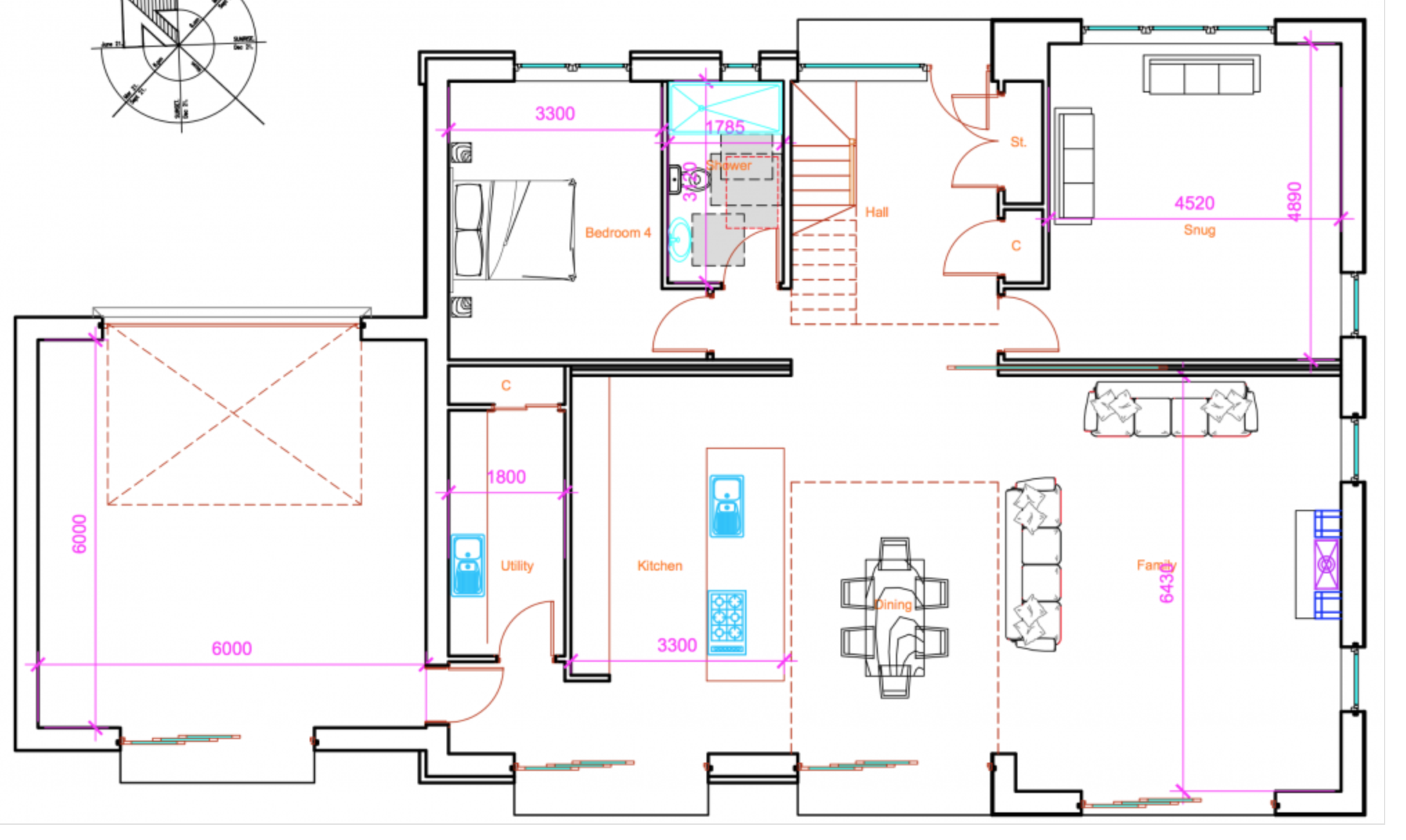

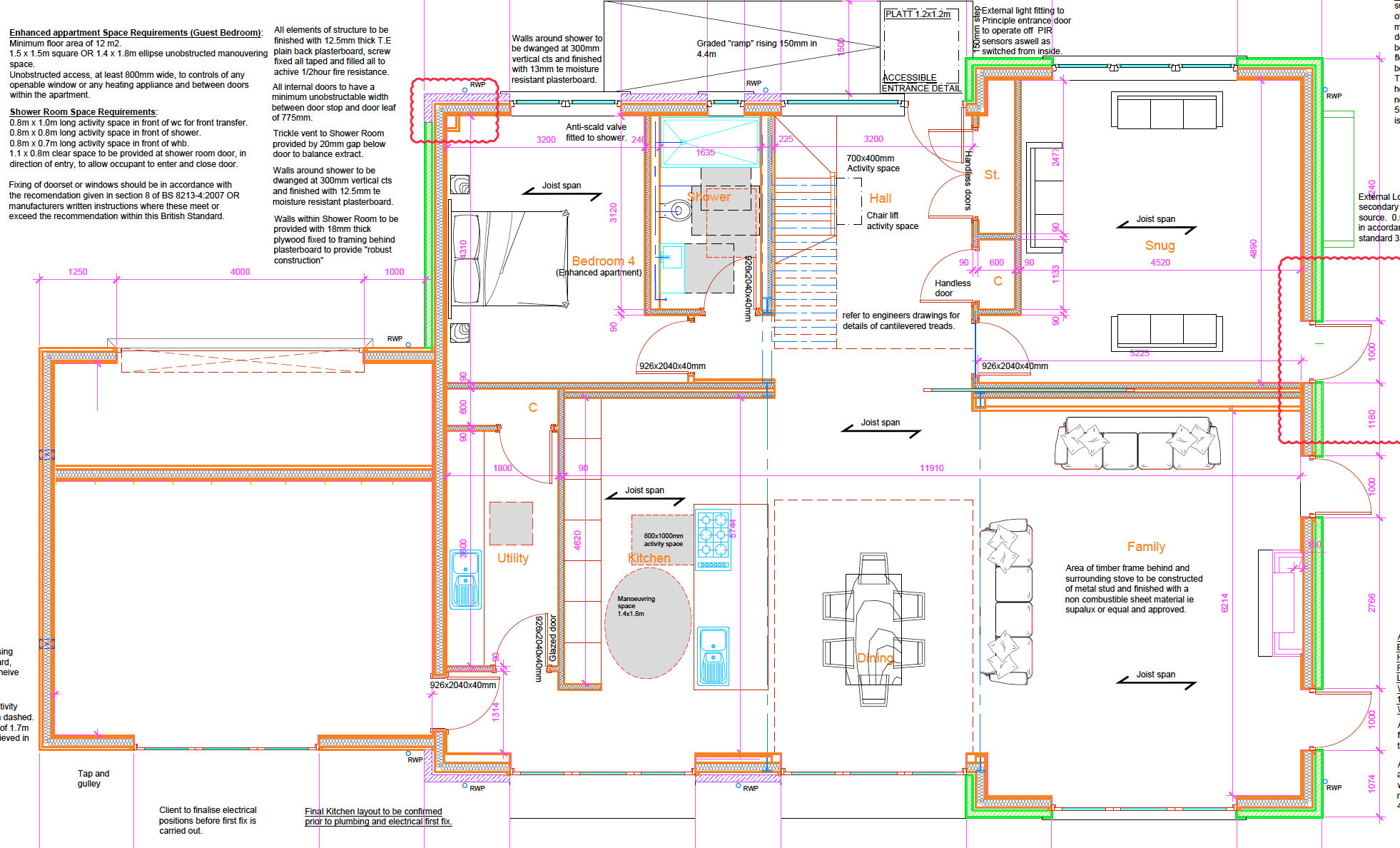

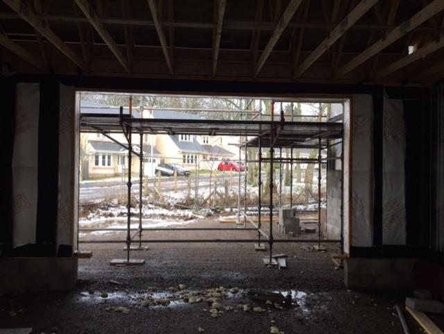

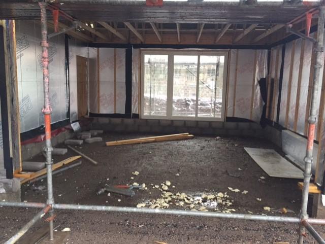

ultramods Posted January 24, 2019 Posted January 24, 2019 Our attached garage has the same closed panel insulated (u-value 0.16) walls and roof spec as the rest of the house. The floor is also going to be insulated and have UFH. The south west elevation also has a 3000mm x 2400mm sliding patio door. The plan was to fit a Hormann insulated sectional garage door, however because I doubt I will ever put the car in the garage I am now trying to decide if I should fit a garage door or simply block up the current hole with a another timber frame panel. The plan for the space is to be a home gym and maybe a games room. However another use could be a 5th bedroom for when we have a lot of family staying over. Our current plan is to live in the house for 10 years, which means I do need to consider what a future buyer would want. The garage will be clad with vertical timber, meaning if someone at a later date wanted to fit a garage door it should be simple to do. I can build a Shed to house gardening tools etc. Ignoring any planning, building control or cost issues, what would you do?
ProDave Posted January 24, 2019 Posted January 24, 2019 Has it been signed off? If not I suspect BC will want an amendment, and the council tax valuer will include it as habitable space. It sounds like a very easy "after completion" alteration. Perhaps leave the garage door to access a small storage space, and frame off the wall just a bit further in? 1
ultramods Posted January 24, 2019 Author Posted January 24, 2019 1 minute ago, ProDave said: Has it been signed off? If not I suspect BC will want an amendment, and the council tax valuer will include it as habitable space. Sounds like a very easy "after completion" alteration. Perhaps leave the garage door so access a small storage space, and frame off the wall just a bit further in? Thanks @ProDave I spoke to the BC officer this week whilst he was doing an inspection and he saw no issue with it, just told me to check that the planner would be OK with the change. In terms of council I would image the house will already be in the highest band, so we can't go higher (don't not whether to laugh or cry about that). I like your idea of a storage area which I hadn't thought of. this would mean we could have a 2 metre wide storage area and still have a 4m x 6m room. Think I will ask the plumber to put in two UFH loops to allow this option.
ultramods Posted January 24, 2019 Author Posted January 24, 2019 1 minute ago, ultramods said: Thanks @ProDave I spoke to the BC officer this week whilst he was doing an inspection and he saw no issue with it, just told me to check that the planner would be OK with the change. In terms of council I would image the house will already be in the highest band, so we can't go higher (don't not whether to laugh or cry about that). I like your idea of a storage area which I hadn't thought of. this would mean we could have a 2 metre wide storage area and still have a 4m x 6m room. Think I will ask the plumber to put in two UFH loops to allow this option. Also thinking about it some more, doing this option would mean we wouldn't need an insulated sectional door. A roller door wold probably be a better option we want to have a partition 2 metres from the garage door - in terms of not having the roof tracks.
