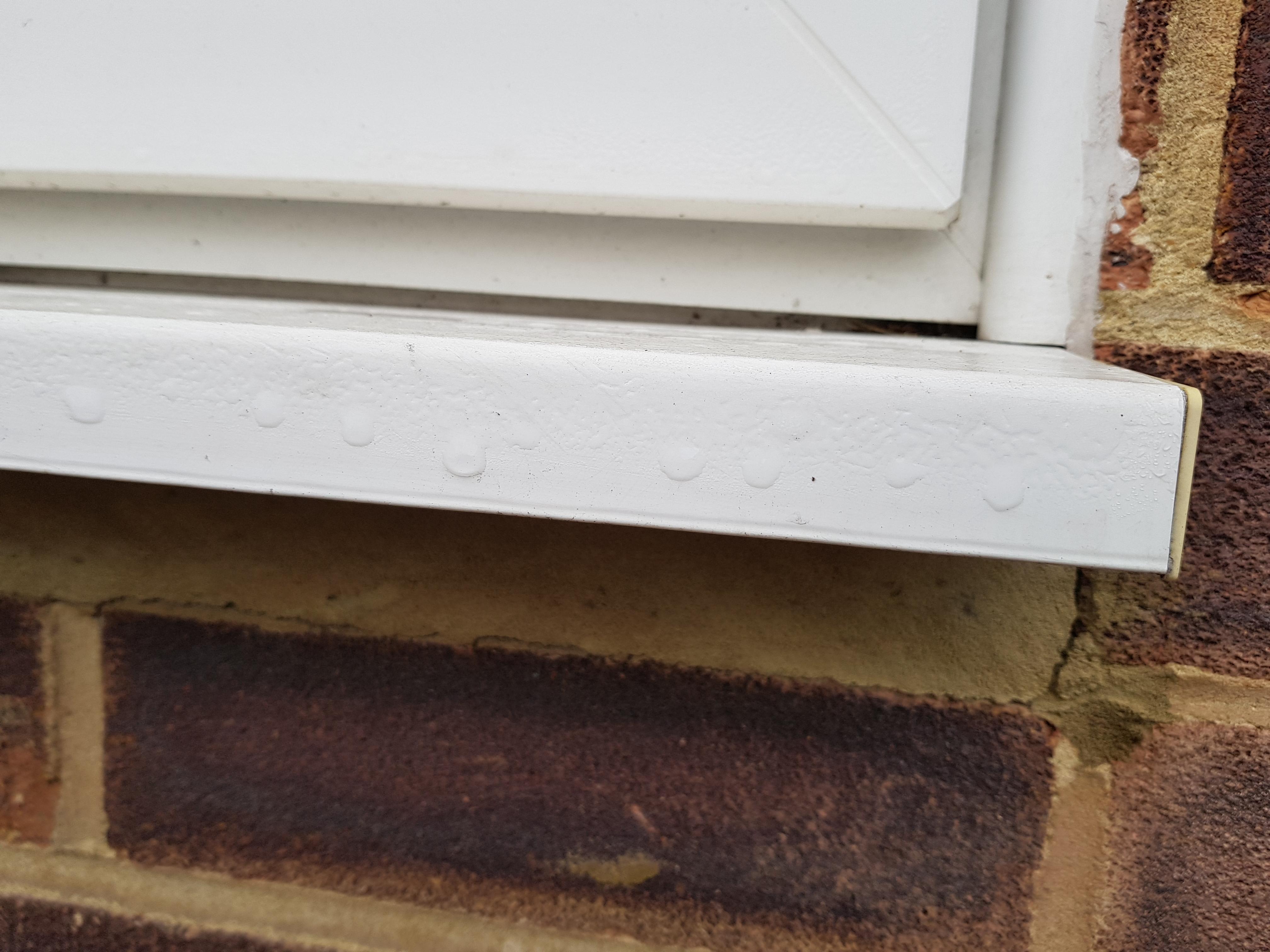

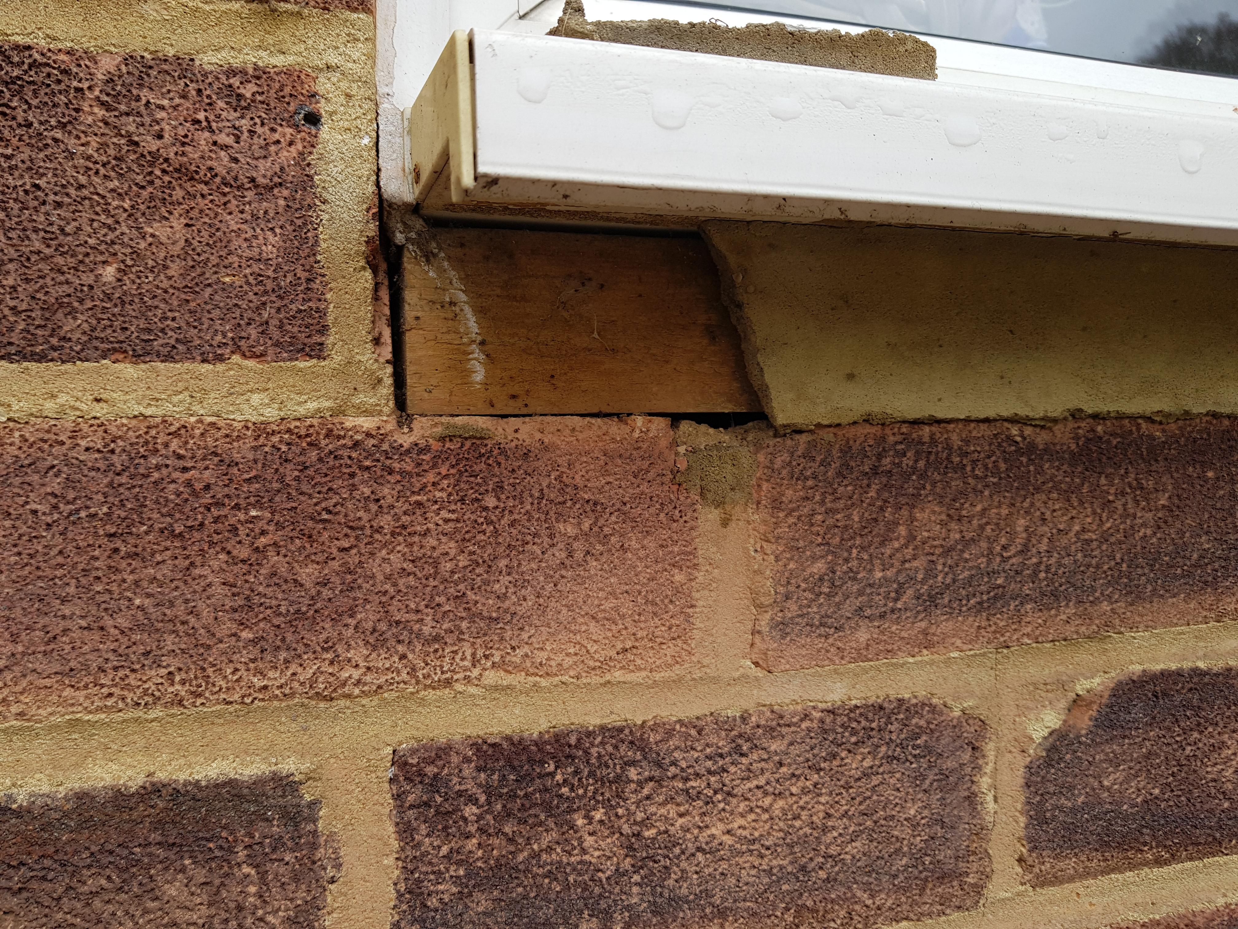

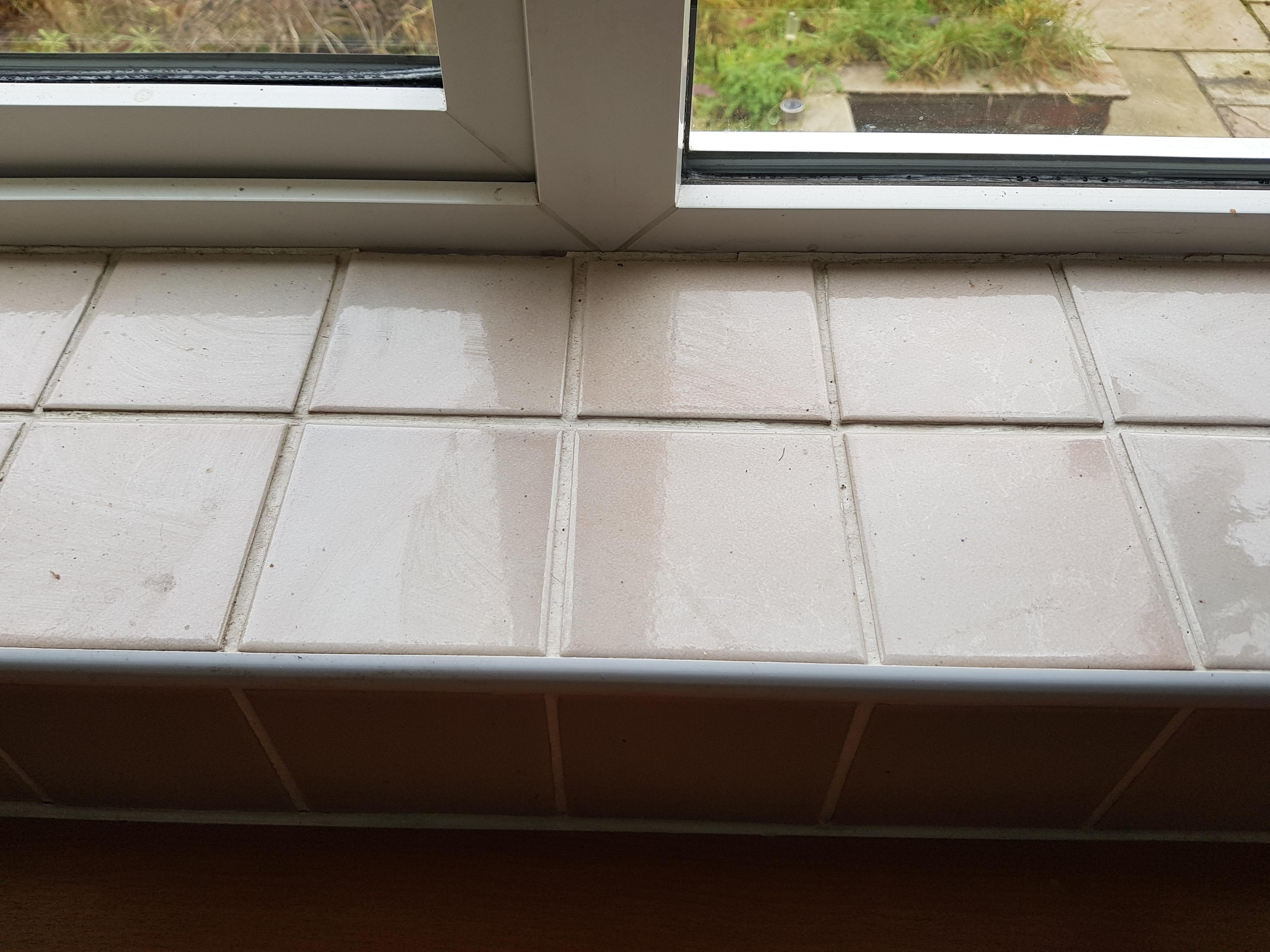

oldkettle Posted January 24, 2019 Posted January 24, 2019 I have a day off work and finally found time to take pictures of this nightmare. Our kitchen window is not installed well at all and standing inside next to the floor kitchen unit I can feel the draught from it, especially as it is so cold outside. I wonder whether I should just go buy a can of a foam and seal the whole thing from the outside - over this breaking concrete? It is supposed to be a temporary fix as the whole thing will hopefully go when we get our planning one way or the other, but if it is an easy improvement then why not.
Onoff Posted January 24, 2019 Posted January 24, 2019 (edited) I am guessing you have white trim pieces up the sides and across the top where the frame meets the wall. Will probably have been stuck on with mitre bond. These will have had a silicone bead run up them after fitting. Unfortunately the fitters have likely just whacked the windows in with frame fixings and packs and not bothered to use low expansion foam or Compriband around the frame. Most of my 2G windows are the same. I'm addressing as I go along. In your case it looks like like there was a cock up with the height so they've chucked a bit of 4"x2" in and rendered over it. At the very least they should have stapled some expanding metal on it. I'd take the rest of that render off. Use a plant sprayer over all the gaps to wet them then get a low expansion foam in there. To make pretty ideally screw some st/st expanded metal to the timber and render over. Won't help with any cold bridging but should stop draughts. Alternatively screw a strip of upvc over it and silicone round the edges. In my bathroom there was a 1" gap between top of new window and lintel all covered over by trim! You'll still have I bet huge gaps up the sides. You could take the trim off and repeat the exercise then fit new trim. Edited January 24, 2019 by Onoff 1

oldkettle Posted January 24, 2019 Author Posted January 24, 2019 (edited) Thank you, @Onoff This one is certainly quite old, it is much worse than most other windows in the house. I'd guess they replaced an old window which was probably a different size and might have decided to change the height. The draught is mostly felt when I lower my head to the work surface level, I do hope this is due to these gaps below the window. With my limited skills and time wouldn't want to destroy anything around. It is also clear the seals withing the unit have failed and I certainly need to apply a layer of (silicone? foam first?) on the inside at the bottom. Edited January 24, 2019 by oldkettle add text
Onoff Posted January 24, 2019 Posted January 24, 2019 Probably didn't allow for the cill when measuring. Cavity wall? The wind will be howling in there and escaping through every gap. Foam that lower gap inside (dampen first), cut flush then silicone over. You can work silicone grease into perished rubbers that might help too. You're on a loser taso some extent as the window is set so far out beyond the cavity. Been there / done that / living it: 1

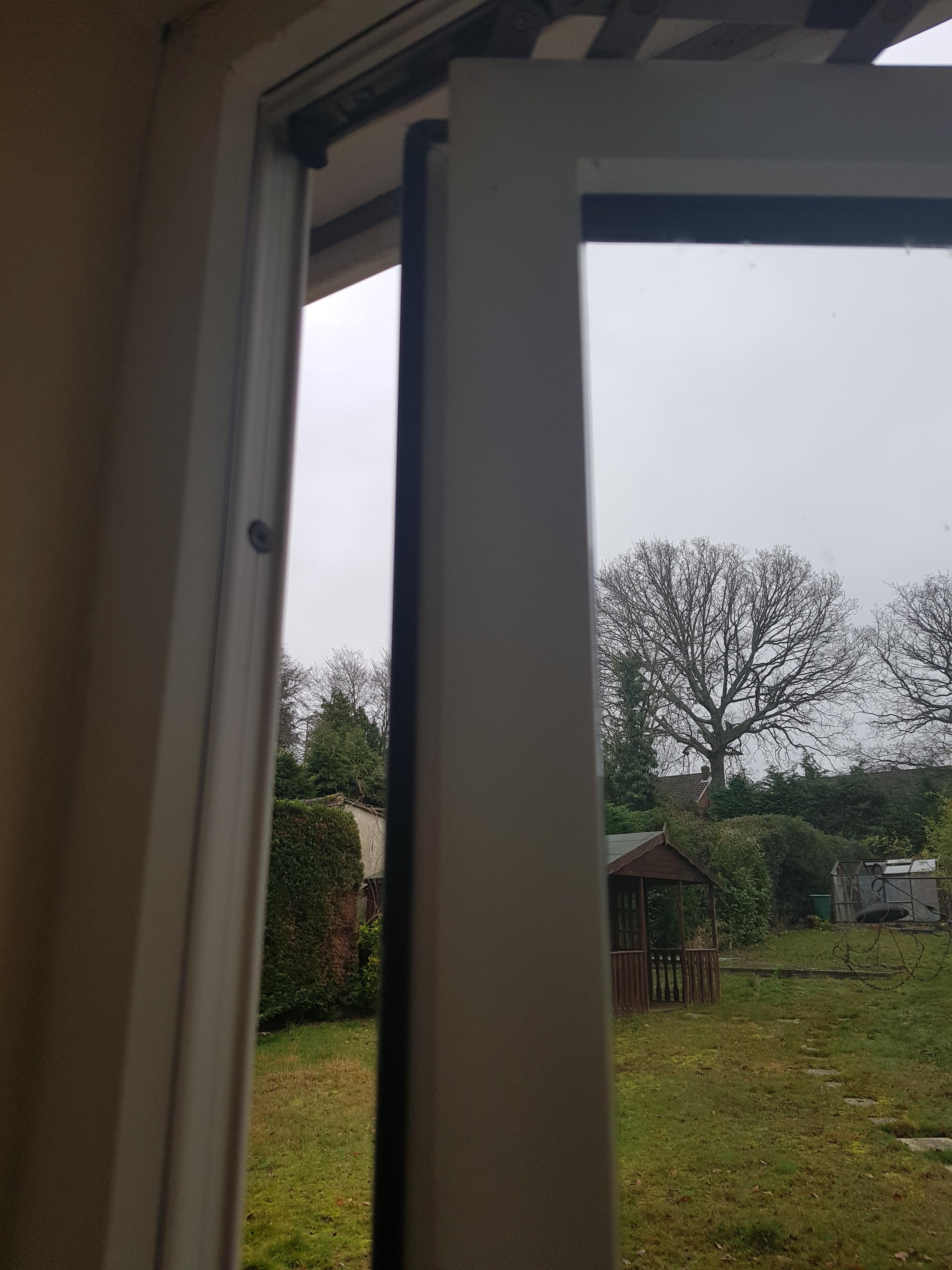

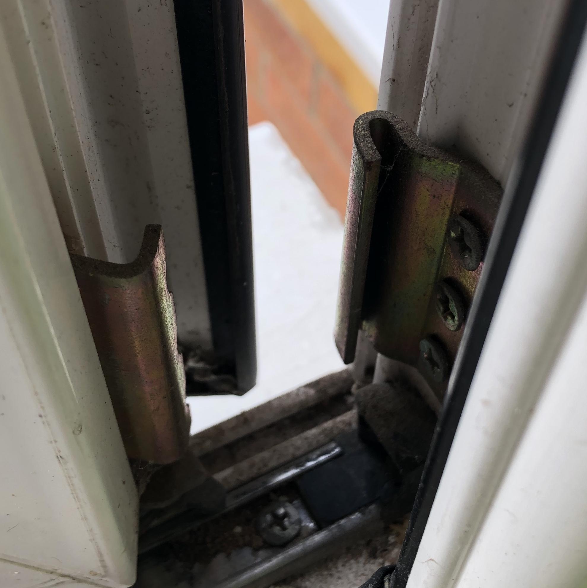

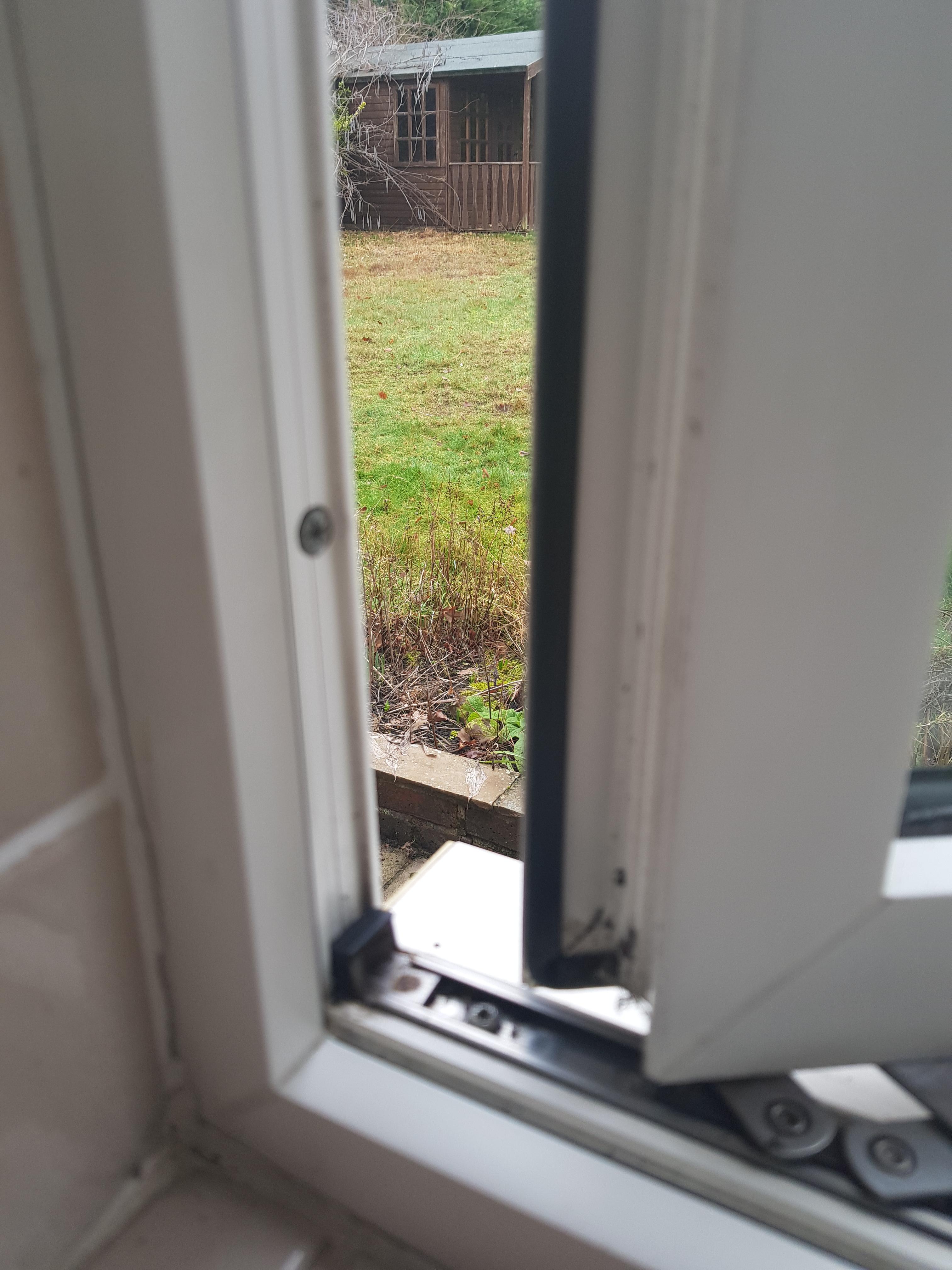

oldkettle Posted January 24, 2019 Author Posted January 24, 2019 It pays to pay attention. Why didn't I look at this gap on a hinge side before? Not sure it is clear from the picture but there is at least 3mm there! I did adjust the handle side recently but completely ignored the other one. It seems new hinges will be required...
Onoff Posted January 24, 2019 Posted January 24, 2019 Someone on here had a good link to a place that does older DG components. ??? 1
oldkettle Posted January 24, 2019 Author Posted January 24, 2019 17 minutes ago, Onoff said: Someone on here had a good link to a place that does older DG components. ??? Never seen it. Will try to find it. The adjustment video link was here not a long time ago. In the mean time - pushing the corner of the window from the outside made a massive difference :-)

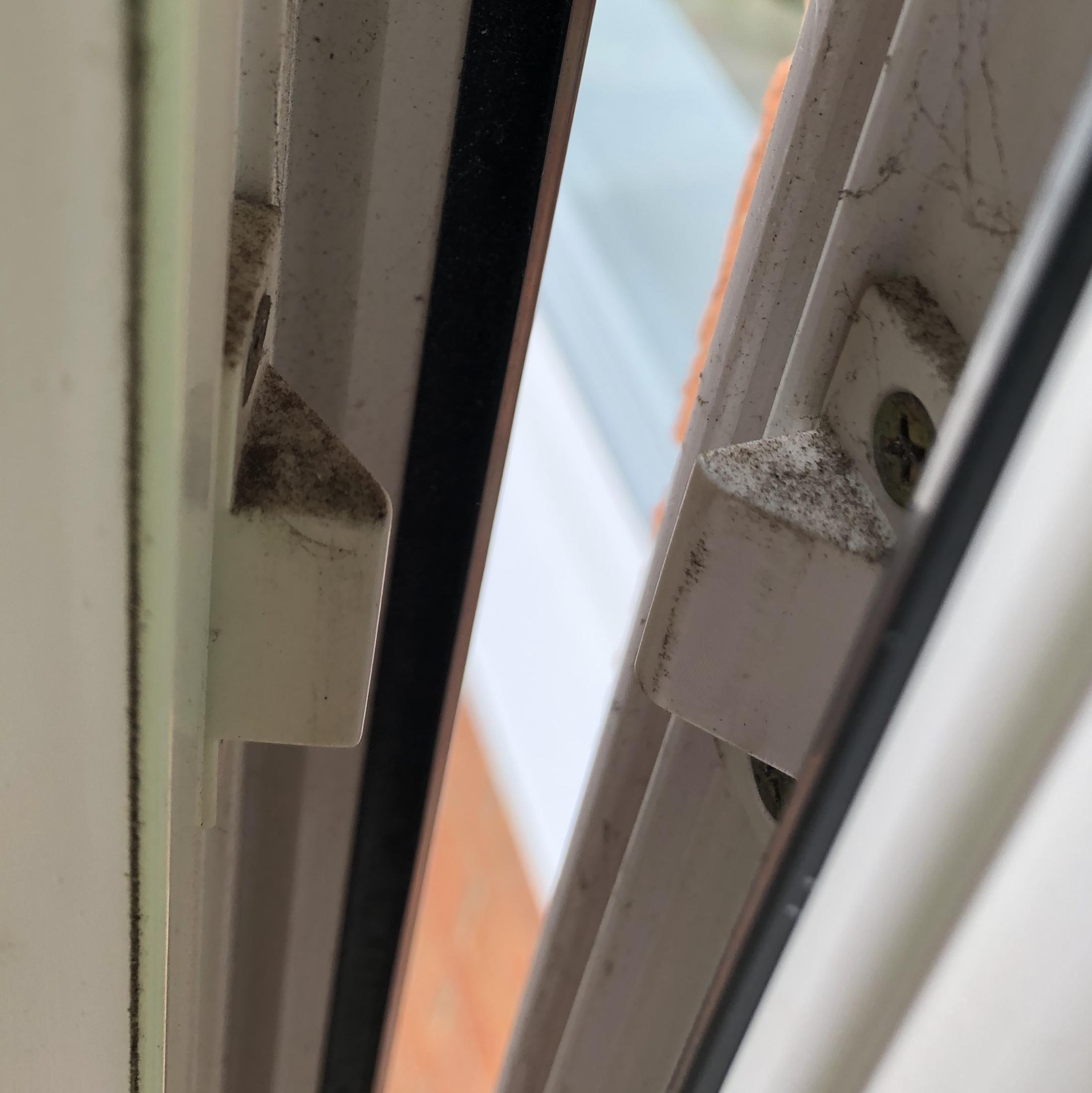

PeterW Posted January 24, 2019 Posted January 24, 2019 Sounds like someone has tried to pull the window open from the outside - there may be anti-jemmy hooks fitted or a set of alignment or sash seal wedges. If not, easy to do and cheap. Check the hinge side for these sort of things Anti - Jemmy hooks Alignment or sash seal wedge The bottom ones are designed to force the seals tight and stop the window from doing what you are experiencing. You can buy them cheap enough here 1
oldkettle Posted January 24, 2019 Author Posted January 24, 2019 (edited) Thank you, @PeterW, I did think it was used "for access" at some point! I can't see either hooks or wedges - will attach the pics shortly Do you reckon there is no need to replace the hinges - just install one of these? Edited January 24, 2019 by oldkettle

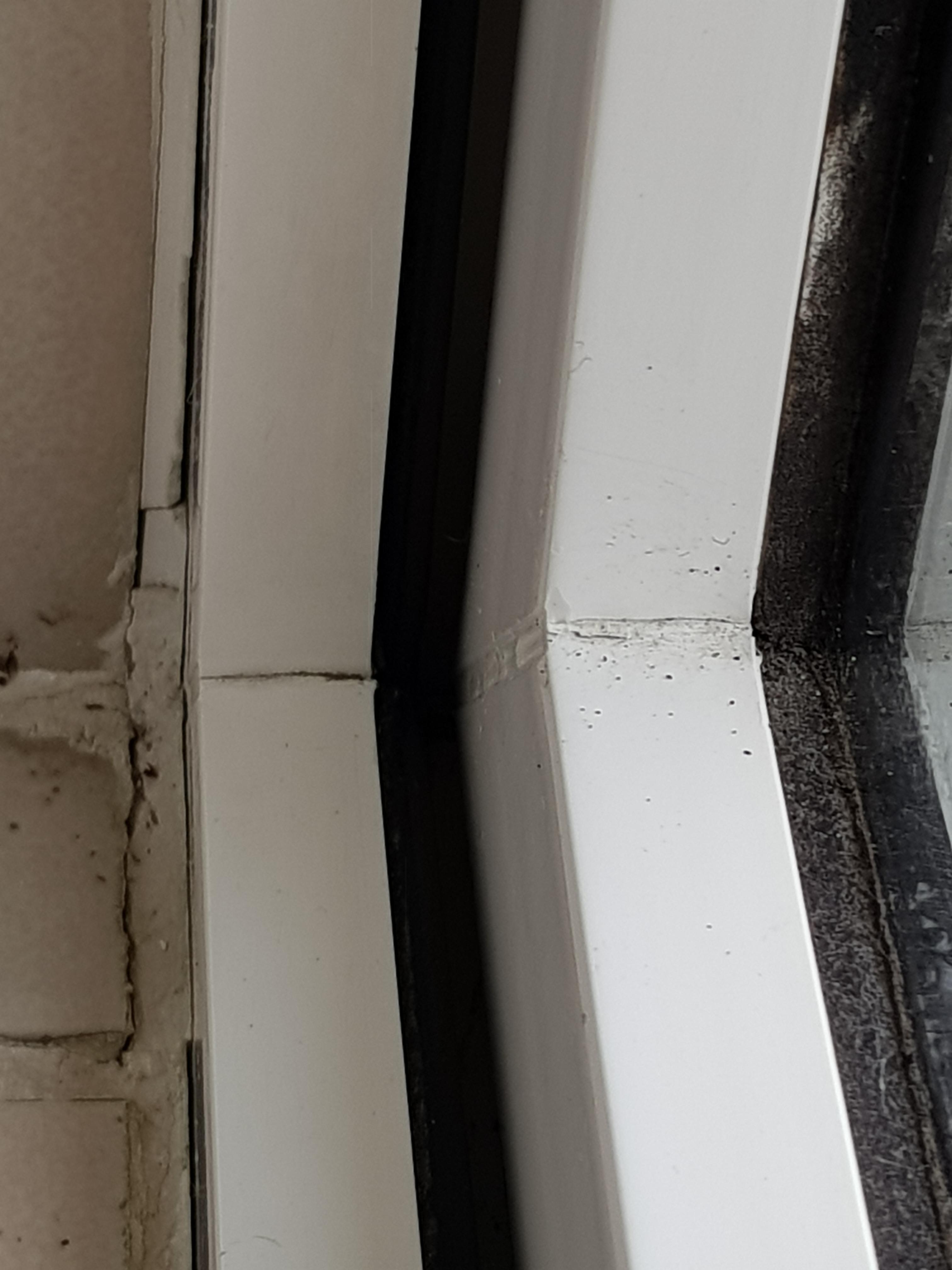

Onoff Posted January 24, 2019 Posted January 24, 2019 Lots of cracked sealant around the inside too I note. Worth renewing. Again on the inside if you remove the old silicone then foam any gaps. (Low expansion Soudal from S'fix in a proper gun). 1

PeterW Posted January 24, 2019 Posted January 24, 2019 I’d fit the wedges to that - will stop the window moving in its frame. 1
