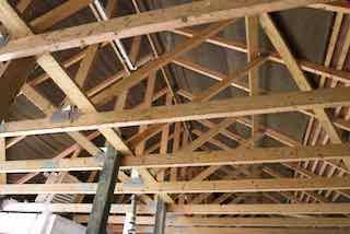

The roof has ugly trusses so I am considering having the roof off to have something more attractive. This will give both head height and the illusion of space. (Unless anyone can suggest an attractive option for the trusses?)

I would take the roof off and have a proper one designed.  I assume you are single storey so you can include some rooflights and maybe a mezzanine with all roof insulation at rafter level.

once the ceiling is up you won't see them, however, as others have said it seems a lot of work with not much left to keep and work from.

If you lifting roof then you could always run a couple more rows of blocks round the top of wall to give you hieght?
maybe just jack it up where it is  with acrow props and secure while first row of  blocks are added-then dop it back down--then up again for next row of blocks --or just pack it as you  go ,
thats what I,ve done that before on old scottich barn . using a car trolly hack to lift --then adjusted acrows to suit ---tight against wall so it can not wobble
