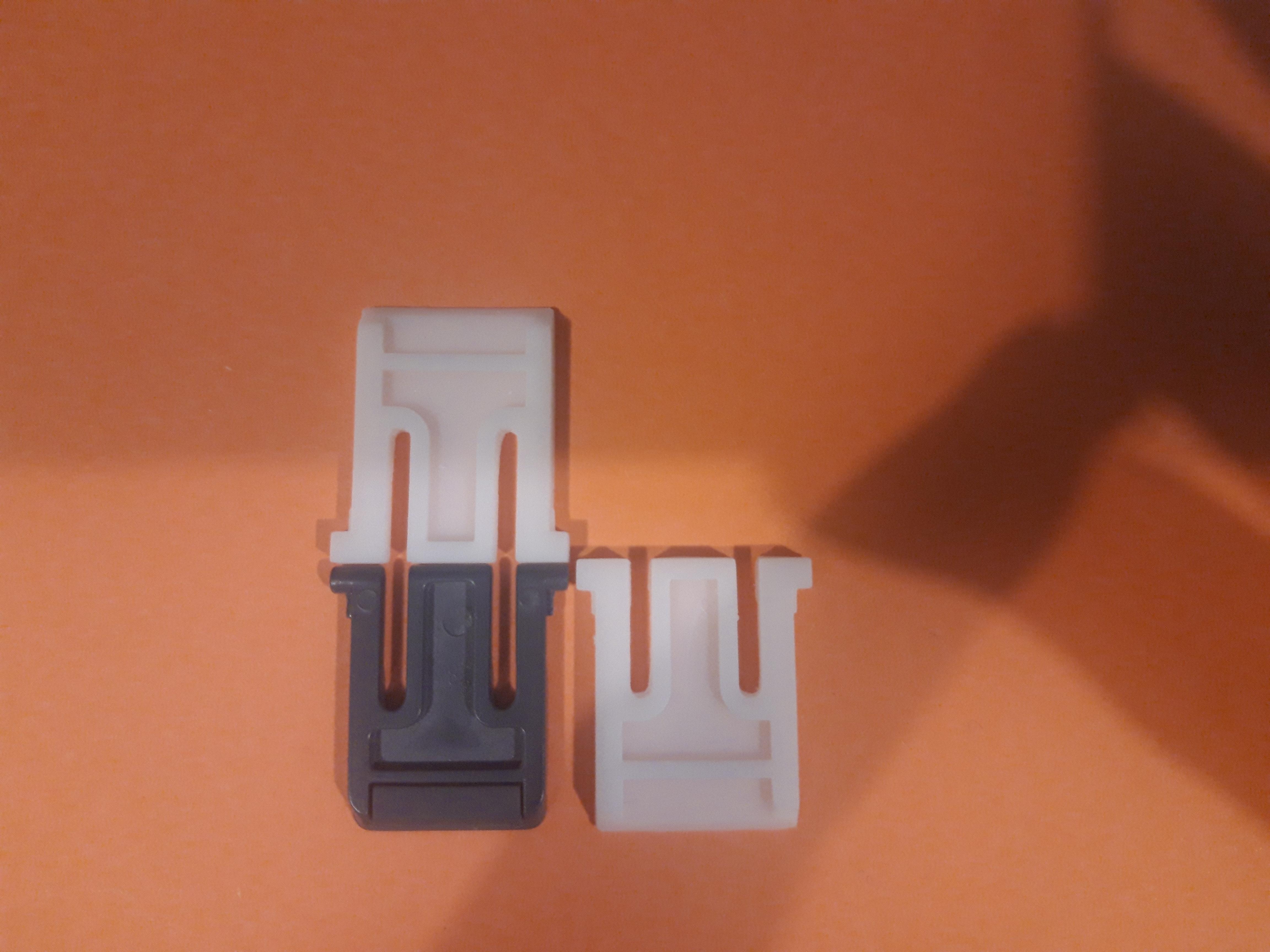

Onoff Posted November 6, 2019 Posted November 6, 2019 6 minutes ago, Jeremy Harris said: May be, I've seen a few odd things happen, but nothing quite as clear cut as this. Hopefully you can just file the corners off the pegs to get them to fit. I'll have to check later...could be me (again) that I sent you an earlier, un radiused model... 1

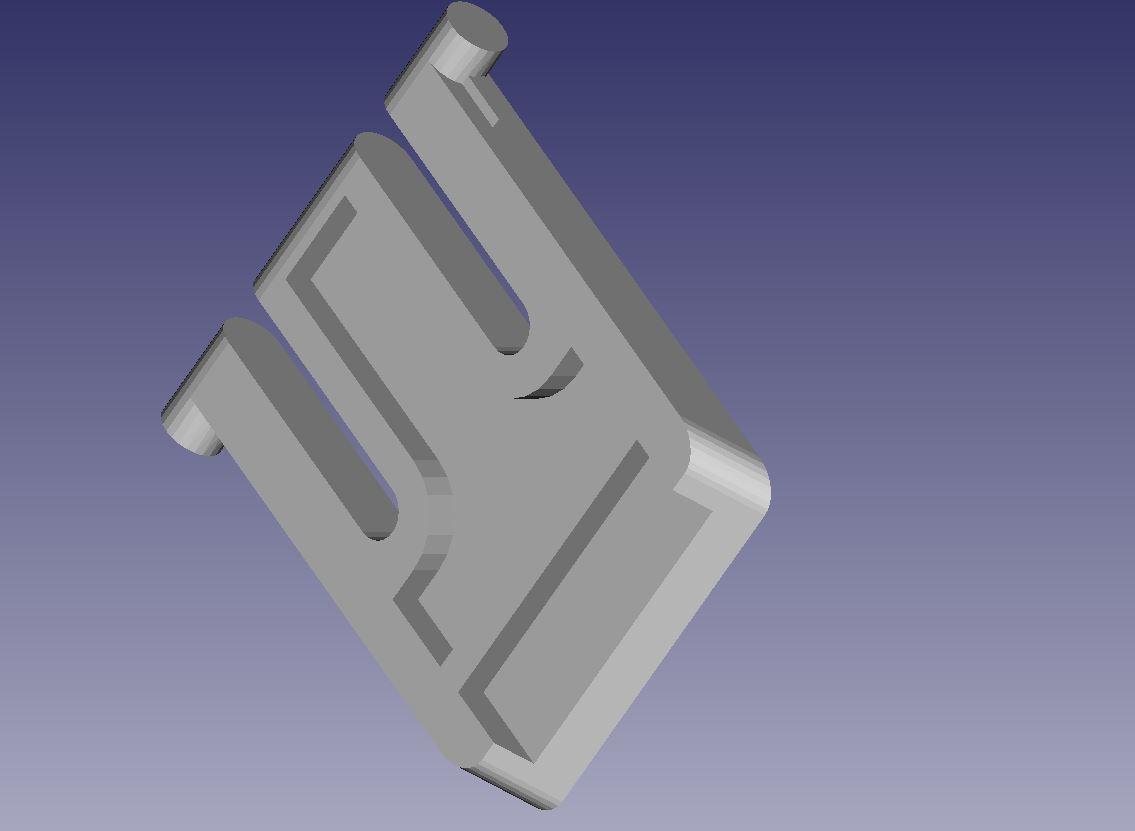

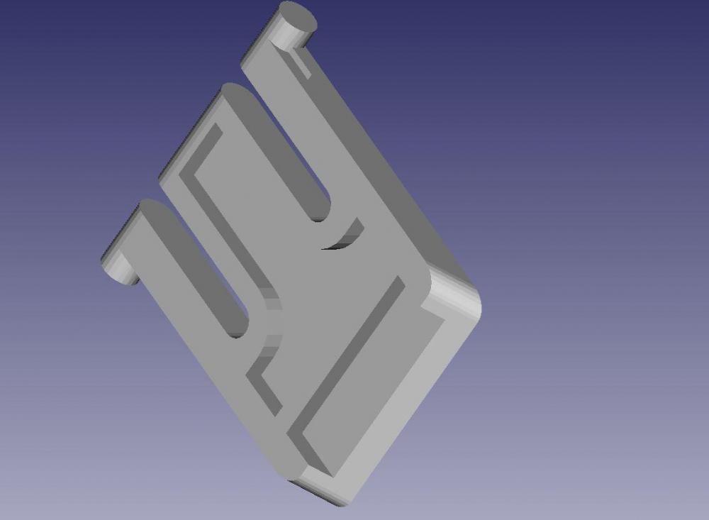

Onoff Posted November 6, 2019 Posted November 6, 2019 (edited) Erm...my fault. I must have forgotten to save after I'd done the edges! Never mind, nothing paring with a blade and some sandpaper won't cure I'm sure! Imports lovely to FreeCAD as an stl, not that it's necessary now: Edited November 6, 2019 by Onoff
Onoff Posted November 7, 2019 Posted November 7, 2019 Received with thanks! They feel really resilient and bendy enough to squeeze in where they need to go. I'll need to pare/sand the pivots on them as I forgot them on the model! ?

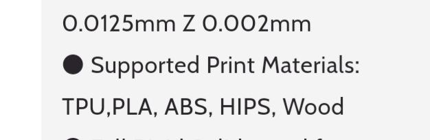

Temp Posted November 30, 2019 Posted November 30, 2019 If it comes with a reel of PLA I would experiment with that first. If the battery adaptor gets hot then PLA might creep or even soften. I think it will be ok but if it is an issue try ABS or PETG. The nozzle temperature needed for PETG (235-265C) is slightly higher than ABS (235C). Find out what the max nozzle temperature is for your printer. If not hot enough to print PETG it's possible you can upgrade the nozzle heater (aka hotend) cheaply. The heater is usually just a small aluminium block with a heater resistor and thermocouple in it. The Chinese churn these out by the bucket load. One for mine cost from £6 to about £30. Some people say you need to put the printer in a heated cabinet to print ABS reliably and since a lot of my printer is actually made from PLA the whole printer could melt :-) 1

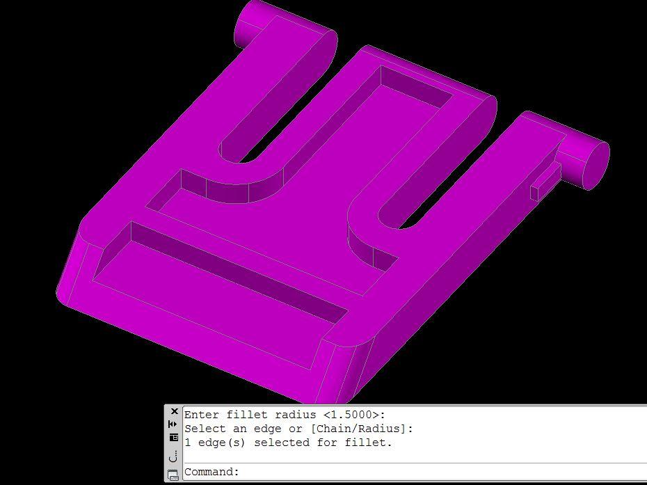

Onoff Posted December 20, 2019 Posted December 20, 2019 On 28/11/2019 at 08:14, scottishjohn said: i know nothing about 3 d printing --but that failure looks very simply that the material is not strong enough or too brittle Is it a case like nylon where you need to boil it up in water to stop it make it more flexible+ stop it becoming to brittle? Jeremy has kindly printed me some more to try. This time I've added the radii on the stub axles that I forgot last time on the model I sent him. I can't see that moisture conditioning like you suggest could hurt so may give that a go. This I thought a good read: https://www.plasticstoday.com/materials/materials-analyst-part-85-fixing-brittle-nylon-product-water/141225133500 As a an aside I've also ordered a reel of ABS which might prove stronger? That and some wood PLA so my lad can print his sister a Baby Groot!
