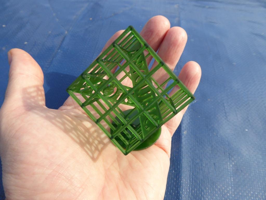

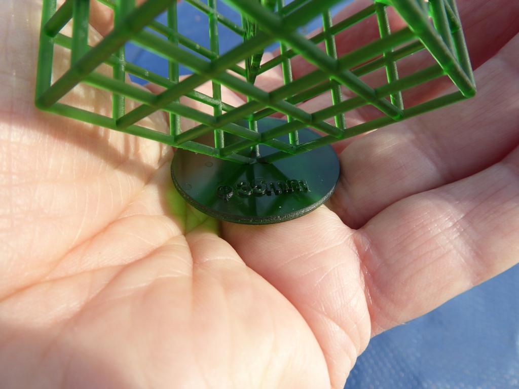

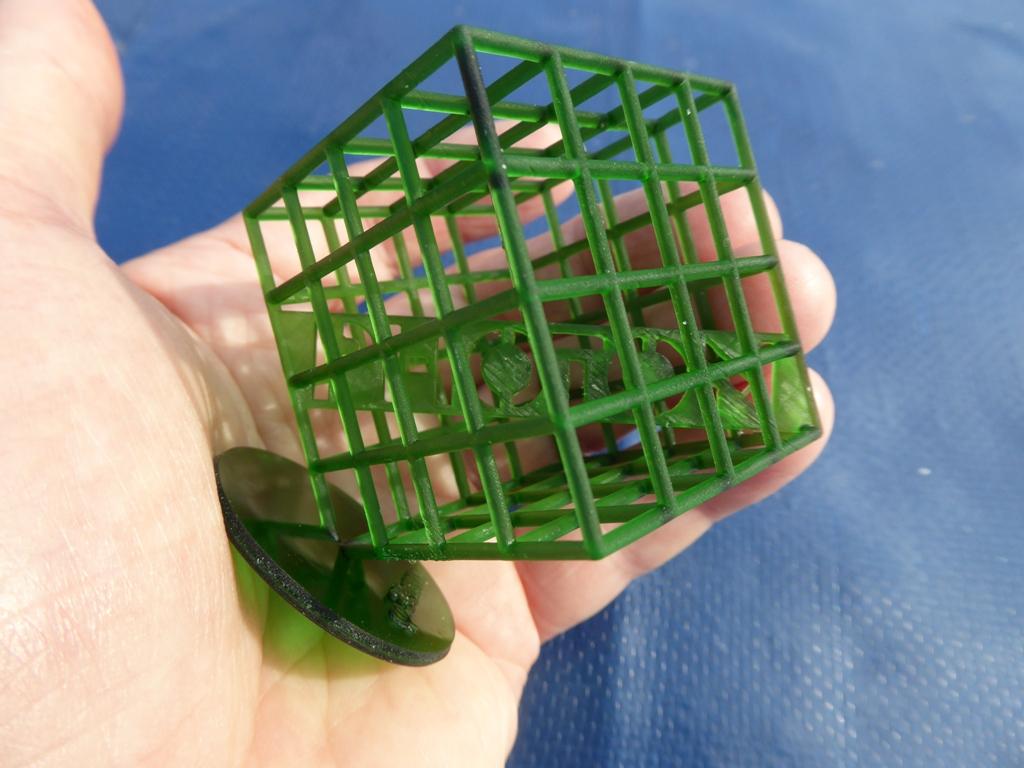

Jeremy Harris Posted August 2, 2019 Posted August 2, 2019 Just finished cleaning and post-curing my first test print: Pretty impressed with the result, especially as this printer is very much a budget machine. I did the test at 50µ resolution, rather than the 20µ maximum, as increasing the resolution massively increases the print time. This took a bit over 4 hours at 50µ, at 20µ it was predicting a print time of over 15 hours. 3
Temp Posted August 3, 2019 Posted August 3, 2019 Wow, that's very good. I've been trying and totally failing to print a similar lattice cube on my filament based printer. 1

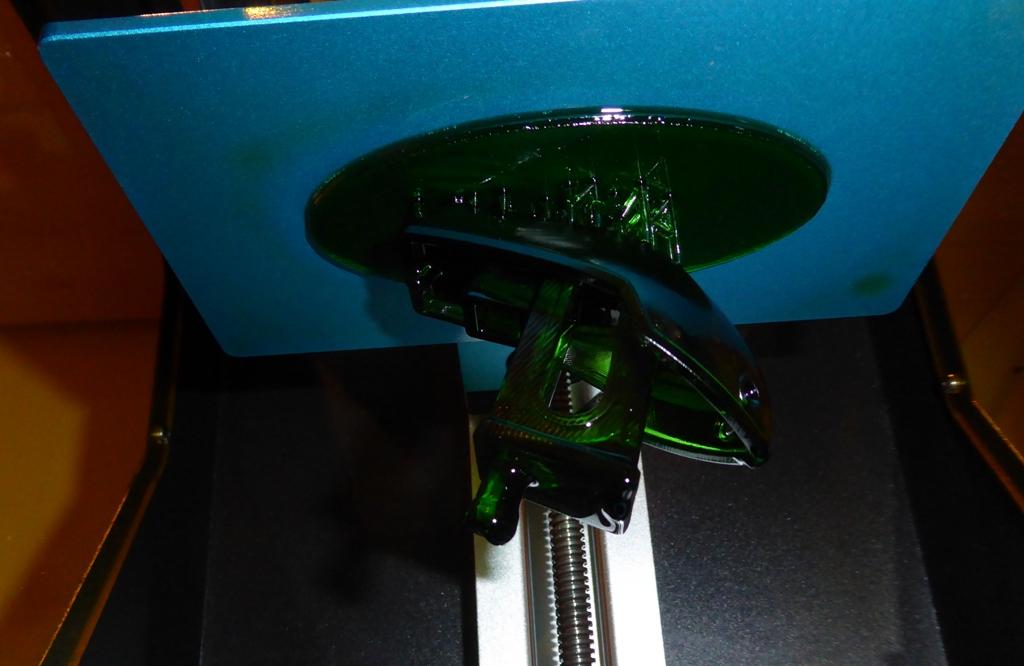

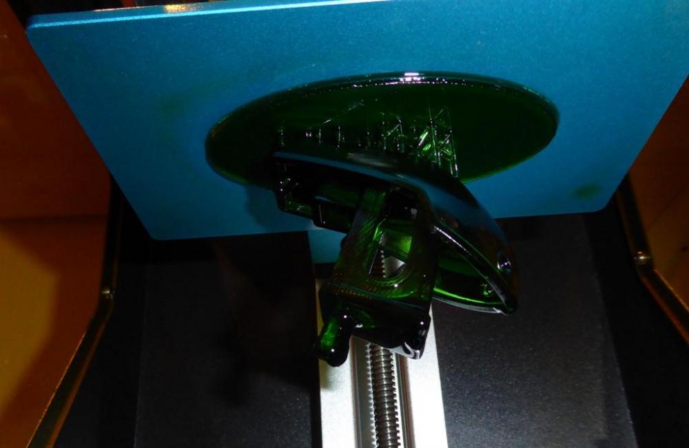

Jeremy Harris Posted August 3, 2019 Posted August 3, 2019 2 hours ago, Temp said: Wow, that's very good. I've been trying and totally failing to print a similar lattice cube on my filament based printer. The flip side is that, although the resin printer does the lattice cube easily, it has now failed twice printing a benchy. It seems that there isn't enough area on the bottom of the hull to keep the model stuck to the build plate, so it comes off and ends up at the base of the resin tank. I'm just about to try and print it again at an angle, with a pad and supports underneath, in the hope that it will stay stuck OK. 12 minutes ago, Onoff said: A question or two. When modelling in 3D within AutoCAD I can SLICE solids on a plane if I just want a chunk to work with. Similarly I can merge two solids into one. Is it possible to take two different designs of 3D model from say thingiverse or yeggi and plagiarise just the bits I want from each? What software do I need (to learn)? Though Makita battery adapters are ten a penny I'm struggling though at the mo to find a print that will slot into the bottom of the Ferrex tool from Aldi I just bought. I could, but don't really want to, buy a 2Ah battery from Aldi and use the ready made top half but at £15 it's twice the price of the tool! One slight snag with some models around seems to be that they are available as a mesh file (.stl or similar) and it's a bit of a PITA to then derive a full drawing from that. The mesh files are only the surfaces, so primitives aren't separated out; it's just a contiguous set of surfaces that's described. It's possible to work with these and add additional objects, that can be translated into surface mesh files, but so far I'm finding manipulating these a bit challenging. Might be because I'm used to working with drawing files that describe all the parts separately; I've no experience of working with mesh files, so I keep wanting to be able to select parts when a mesh file doesn't really have the concept of individual parts. I'd suggest trying to convert any files you find into something you're familiar with, like AutoCad, if you can, as, like all CAD software, a new programme has a fairly steep learning curve. I'm having a problem because I keep looking to do things in the way AutoCad would work, but am finding that even simple tasks, like selecting a part and moving it by a fixed 3D offset to fit to another part isn't intuitive. Might be because AutoCad has a very oddball and quirky interface, but because I've been using it for decades I've come to accept that as being normal...

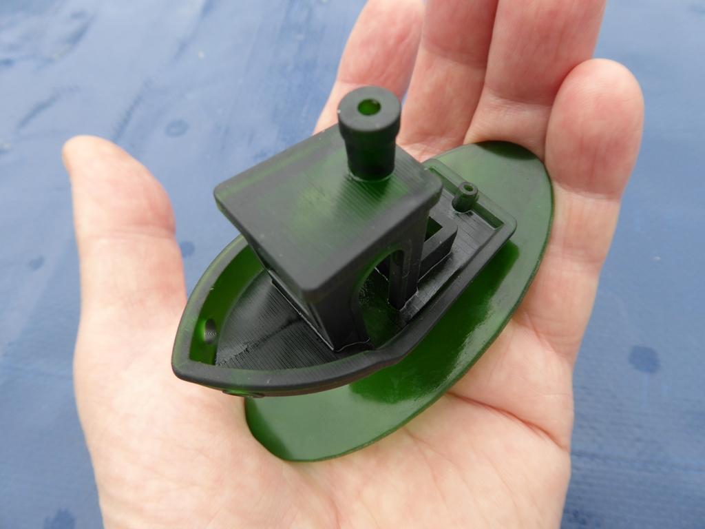

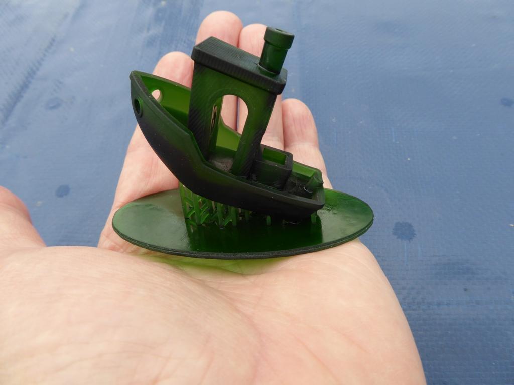

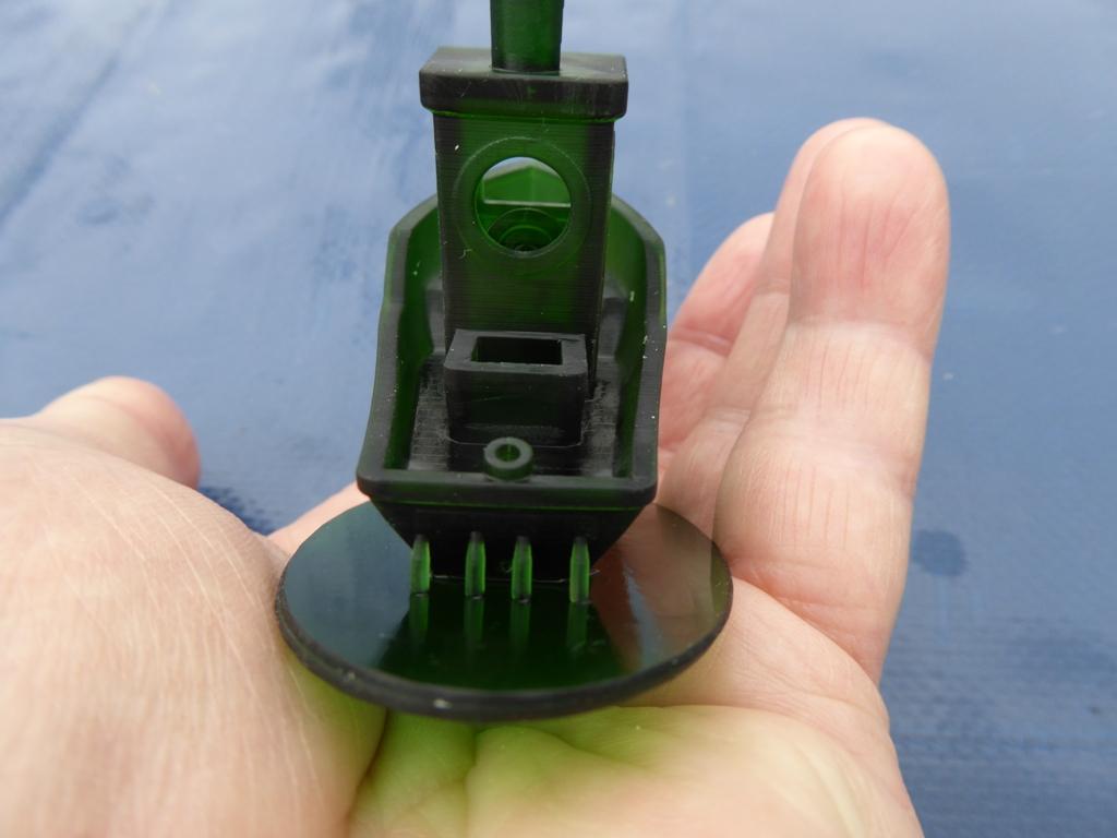

Jeremy Harris Posted August 3, 2019 Posted August 3, 2019 Third time lucky... Took three goes to get the standard Benchy test model to print, there's an issue with resin printers needing a larger base area so that the model stays fixed to the build plate. From what I've learned (largely by experiment) the problem relates to the balance of forces when a layer is separated after it's been printed. The newly cured 50µ layer adheres to the thin layer of FEP film between the exposure screen and the resin. The build platform moves up a few mm after printing each layer, and this breaks the layer away from the FEP film (or is supposed to) so allowing resin to flow in ready to expose the next layer. If the layer adheres more strongly to the FEP than it does to the build plate, then it will just pull off the build plate. The work around is to add a support plate plus supports to the model, and angle the model slightly so that the area being printed at any time is smaller than the area that's adhered to the build plate. This seems to have completely fixed things. This is the Benchy, upside down, "hot off the press" (really straight out of the resin tank) showing the plate and supports I added: And these photos show the same Benchy after being cleaned up and post-cured: Overall I'm pretty happy with this printer so far. Not too steep a learning curve to get it to work well, I just need to get to grips with 3D CAD now. I also want to try out some other resins, as so far I've just been using the sample bottle that came with the printer, which is (unsurprisingly) the cheapest resin available. I suspect that the results might be better with some of the more expensive, opaque, resins. Off to trim all the support structure off the Benchy and clean it up a bit to see how it looks when finished. 1

Temp Posted August 3, 2019 Posted August 3, 2019 4 hours ago, JSHarris said: Took three goes to get the standard Benchy test model to print, there's an issue with resin printers needing a larger base area so that the model stays fixed to the build plate. That's also an issue with filament printers. The slicer I use (Curua) can add a raft or a brim around the object for you automatically. A raft is usually several layers thick and goes under the part. A brim is just a one layer "land" that surrounds the object like the brim around a hat. A brim is easy to remove so no need to raise the object on supports. A raft is harder. 1
