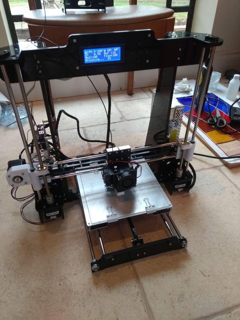

Temp Posted January 29, 2019 Share Posted January 29, 2019 Its alive! Just. Having survived being powered up with a reverse polarity PSU (my fault) its printing it's first Benchy. Whole printer will need bolting down to something rigid because if the floor isn't dead flat the gap between head and bed isn't consistent. Should be able to sort that. 2 Link to comment Share on other sites More sharing options...

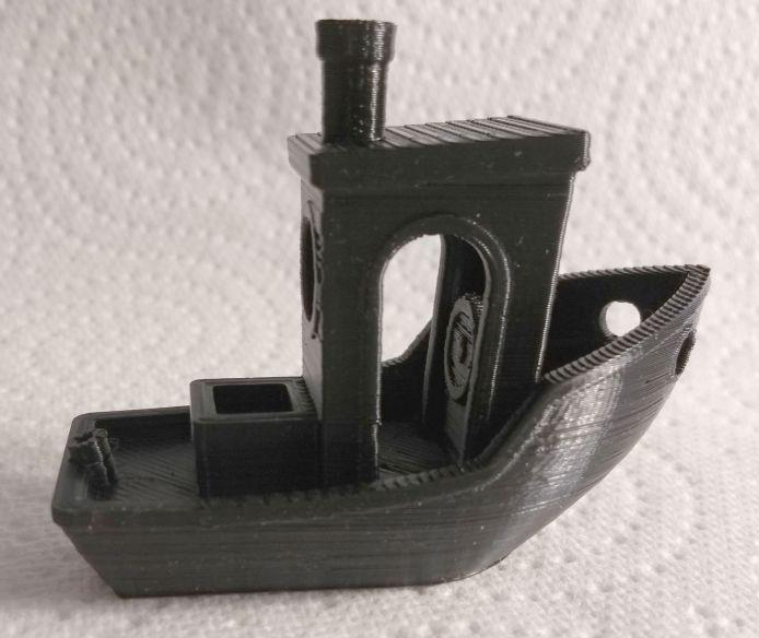

Temp Posted January 29, 2019 Share Posted January 29, 2019 (edited) Close up results of first print. For scale its about 2" long. Pretty pleased with how it turned out. Surprised how much force it took to break off the chimney given that its got a hole down the middle. Edited January 29, 2019 by Temp 3 Link to comment Share on other sites More sharing options...

Onoff Posted January 29, 2019 Share Posted January 29, 2019 1 hour ago, Temp said: Close up results of first print. For scale its about 2" long. Pretty pleased with how it turned out. Surprised how much force it took to break off the chimney given that its got a hole down the middle. Love it! ? Link to comment Share on other sites More sharing options...

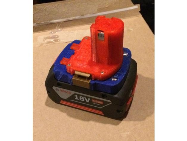

Onoff Posted January 29, 2019 Share Posted January 29, 2019 Indicative only but how much to make one off battery adapter (the blue bit) similar to this? Link to comment Share on other sites More sharing options...
Temp Posted January 29, 2019 Share Posted January 29, 2019 Material cost is one thing, labour another... If you know the weight of the part then material cost is easy to estimate. The slicer software Cura told me the boat/Benchy weighs 14 grams and used about 4.8m of filament. A 1Kg reel of 1.75mm diameter PLA or ABS filament is around £16-£18 from Amazon and is roughly 330m long. So the material cost was about £18*14/1000=25p or £18*4.8/330 = 25p. So even something 10 or 20 times the weight wouldn't be expensive in material. As for labour.. Cura predicted it would take about 2.5 hours to print Benchy and it actually took just over 3 hours. So if you had to pay someone to supervise the machine it would dominate the cost. It's why I don't fancy offering to print 50 clips for Peter, it could be 150 hours of time on my machine. I imagine the online places also get sent a lot of designs that don't print very well because they haven't been designed to be 3D printed. For example while you can print in mid air (overhang) there are limits or it sags. Typically you might have to add printed supports but again the slicer software can add these and you have to cut them off afterwards. The cost and times above could be higher/longer if you wanted to print 100% solid objects. Most people print hollow parts with a honeycomb inside. The slicer program does all that for you as well. You specify how thick you want the walls and what percentage of infill you want and it does the rest. I printed the boat above with 1.6mm walls and a 20% infill and it feels quite strong but I guess something like a part for a cordless tool might need a higher infill %. 1 Link to comment Share on other sites More sharing options...
Temp Posted January 29, 2019 Share Posted January 29, 2019 Just for info I went to Thingiverse and typed in "Dewalt"... https://www.thingiverse.com/search?q=dewalt&dwh=935c50e4a1c6da8 ...up came some battery adaptors other people have designed. This one... https://www.thingiverse.com/thing:1248463 ..is for a "Dewalt Lithium 20VMax to RYOBI One+ 18 volt Adapter" and is similar to both the blue and orange parts on your photo. I loaded it into Cura and it estimated something like 8.5 hours of print time. 1 Link to comment Share on other sites More sharing options...
newhome Posted January 29, 2019 Share Posted January 29, 2019 2 minutes ago, Temp said: Just for info I went to Thingiverse and typed in "Dewalt"... https://www.thingiverse.com/search?q=dewalt&dwh=935c50e4a1c6da8 ...up came some battery adaptors other people have designed. This one... https://www.thingiverse.com/thing:1248463 ..is for a "Dewalt Lithium 20VMax to RYOBI One+ 18 volt Adapter" and is similar to both the blue and orange parts on your photo. I loaded it into Cura and it estimated something like 8.5 hours of print time. You know @Onoff never goes for the easy option 8.5 hours - wow!! I guess it's like everything - it all evolves over time. In a few years I'm sure they will be laughing at these relatively primitive slow machines whereas we look upon them with wonder. Link to comment Share on other sites More sharing options...

Temp Posted January 30, 2019 Share Posted January 30, 2019 Have done three small prints so far. Main issue/difficult I'm finding with the A8 is levelling the bed.... To get the first few layers to stick to the bed the nozzle has to skim over the bed the thickness of a sheet of paper above it. So the bed has to be level to that accuracy. However the printer mechanics make this quite difficult to set up. It's adjusted using M3 bolts and wing nuts but the whole thing isn't very rigid, move the printer and it twists enough to make the gap too big or two small requiring readjustment. I've got a bit of 25mm MDF on the way to bolt it to. I've seen references to auto levelling add-ons but not investigated that yet. 1 Link to comment Share on other sites More sharing options...
