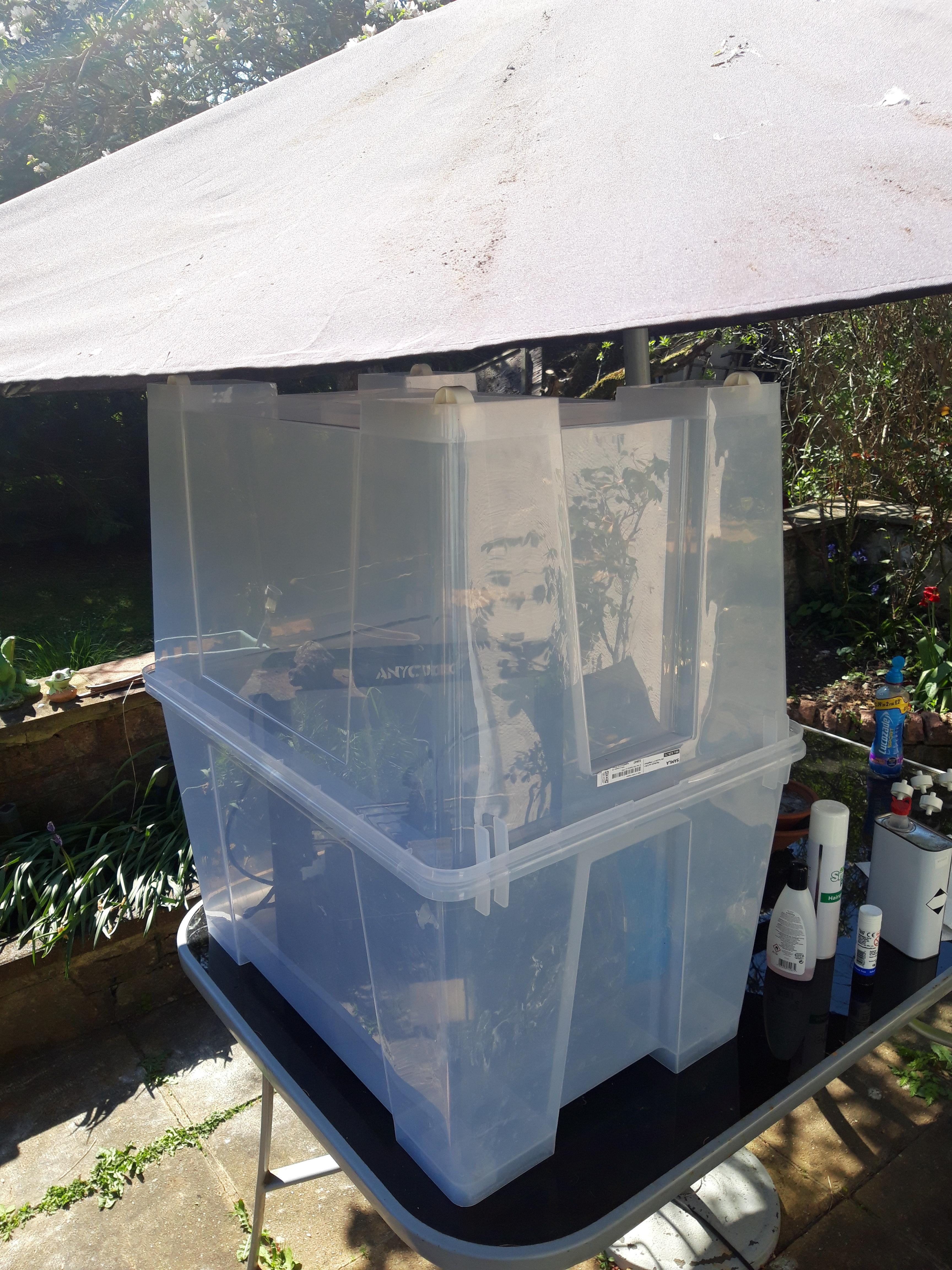

Onoff Posted April 25, 2020 Share Posted April 25, 2020 @Temp, ever printed in ABS? My lad tried yesterday afternoon / evening. It's Steadytech ABS PRO which isn't as smelly/ noxious as normal ABS so I'm informed by a regular user. He set up outside on the patio table whilst the day was still hot and printed into the evening. As a nod to keeping everything warm he placed a huge, upturned, clear storage crate over the whole printer. The crate wasn't quite tall enough to touch the table. After approx 21 layers the whole print slid across the bed where it had become unadhered. Also a bit of warping, curvature. I'll ask my regular user contact but I'm reading things like to use hairspray, glue stick, masking tape, ABS slurry on the bed to stop this. Link to comment Share on other sites More sharing options...
Temp Posted April 25, 2020 Share Posted April 25, 2020 (edited) 6 hours ago, Onoff said: After approx 21 layers the whole print slid across the bed where it had become unadhered. Also a bit of warping, curvature. Not used it myself but apparently its very susceptible to small temperature variations which distort the print or cause it to come off the bed. Some people say even a slight draught from an air conditioning vent is enough to cause a problem and recommend fully enclosing the whole printer in a box. I've heard mention of an Ikea cabinet or box that people use but haven't investigated. Edit: Forgot to mention there are YouTube video suggesting using acetone and scrap abs to help adhesion to the bed. https://youtu.be/saNoiV-op-0 Edited April 25, 2020 by Temp Link to comment Share on other sites More sharing options...

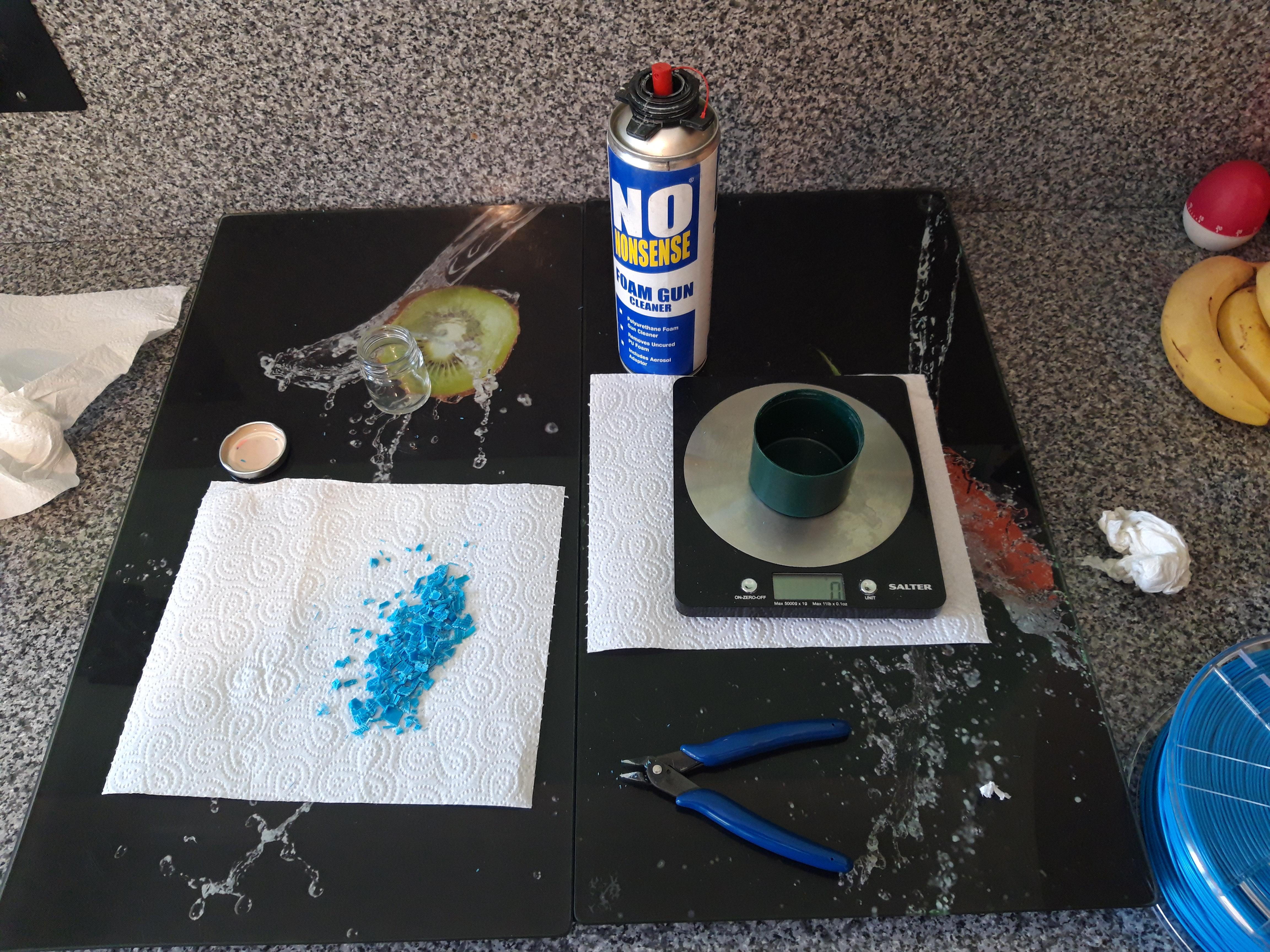

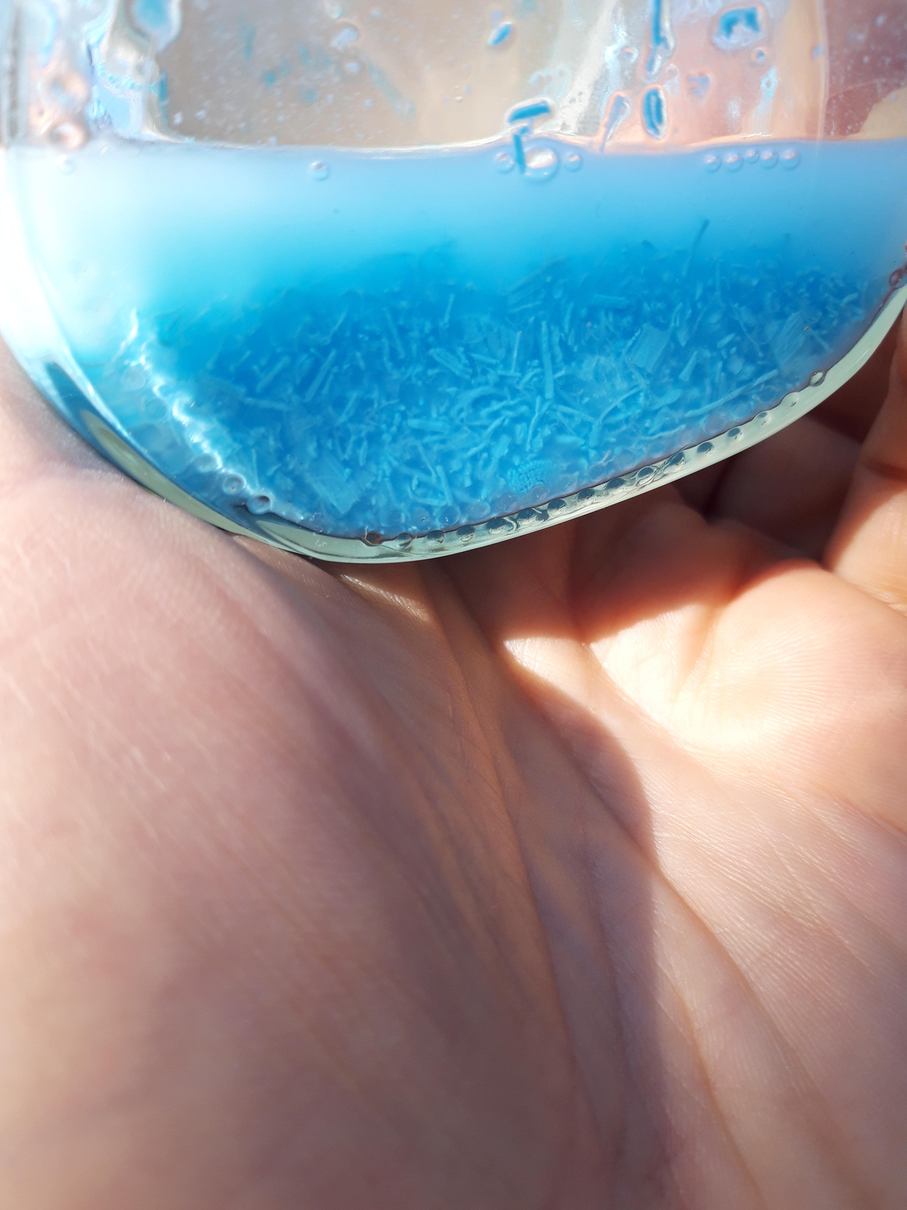

Onoff Posted April 25, 2020 Share Posted April 25, 2020 What exactly is ABS slurry? Is it ABS fully dissolved in "acetone" or a bitty liquid for "grip"? Not sure if this foam gun cleaner is pure acetone. What we've seen on YouTube it looks like milk as in made from white filament. Link to comment Share on other sites More sharing options...
Temp Posted April 25, 2020 Share Posted April 25, 2020 I think nail polish remover is Acetone but don't let the wife catch you pinching it. Link to comment Share on other sites More sharing options...
Onoff Posted April 25, 2020 Share Posted April 25, 2020 10 minutes ago, Temp said: I think nail polish remover is Acetone but don't let the wife catch you pinching it. It apparently has glycerine etc in it that can cause issues. Pure acetone is best. Link to comment Share on other sites More sharing options...

Onoff Posted April 25, 2020 Share Posted April 25, 2020 My lad thought that printing ABS without any adhesion promoter would work if he enclosed the printer and printed a sacrificial shield encircling the print. Lesson learnt! It moved: It warped: Despite printing a sacrificial "heat shield" around it: This was the first layer, you can see how the "hole" didn't adhere: It has potential though, nice tight layers: It won't go to waste though. It'll get chopped up to make ABS slurry. Using foam gun cleaner "contains acetone" and it's taking an age to dissolve the ABS. Just tried Lidl's Baufix thinners, first ingredient acetone and that's dissolving it a treat. Link to comment Share on other sites More sharing options...

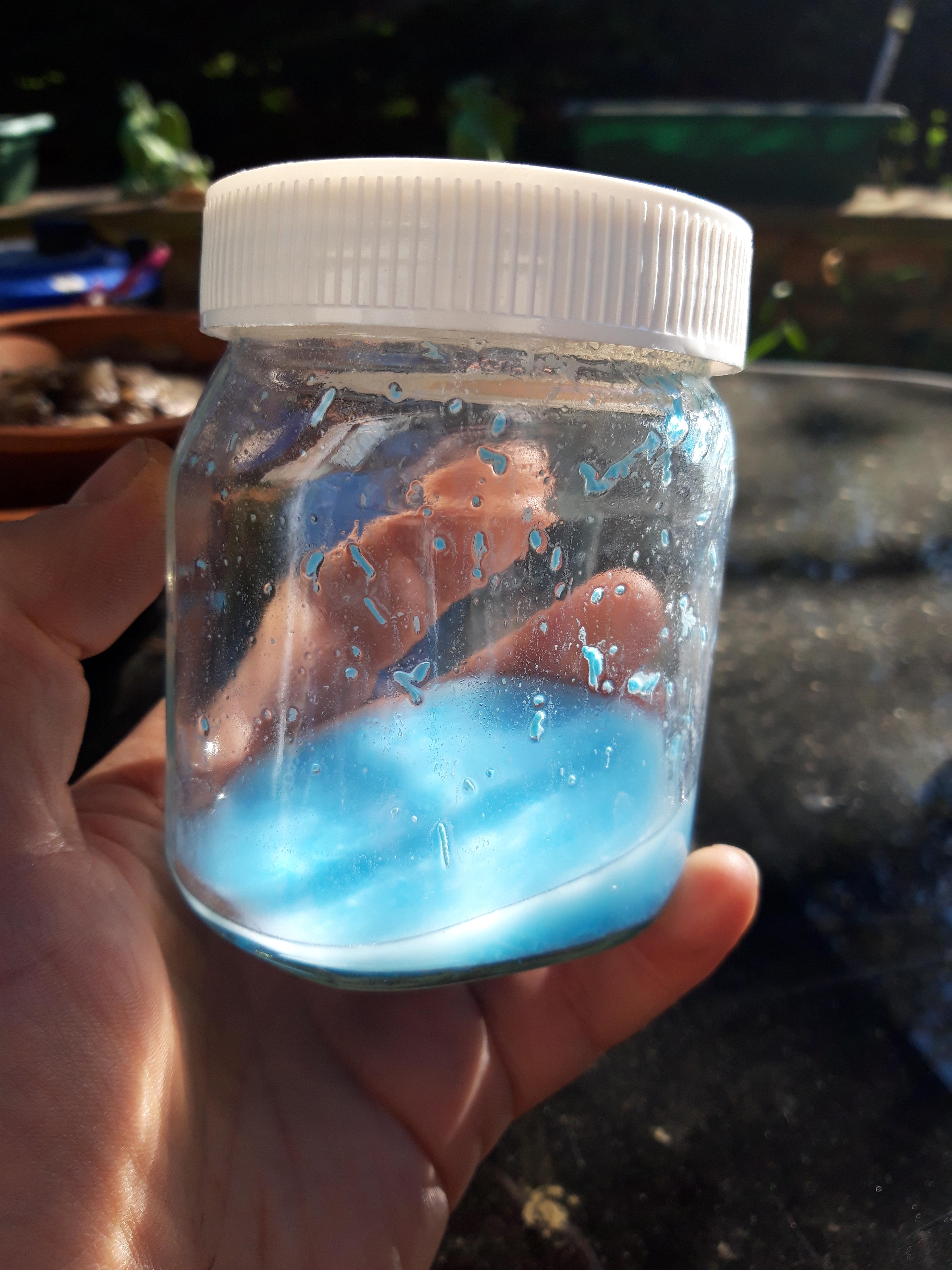

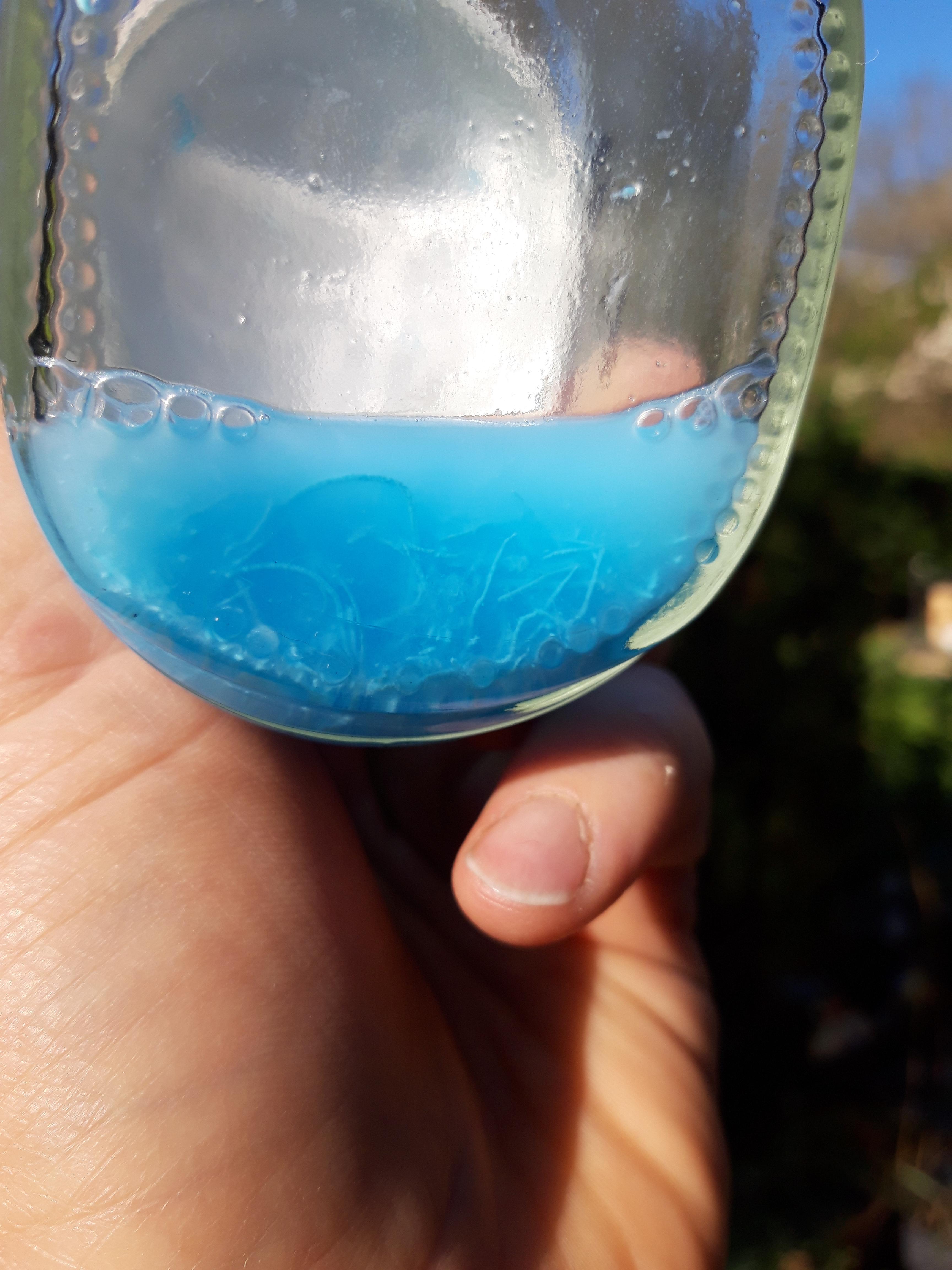

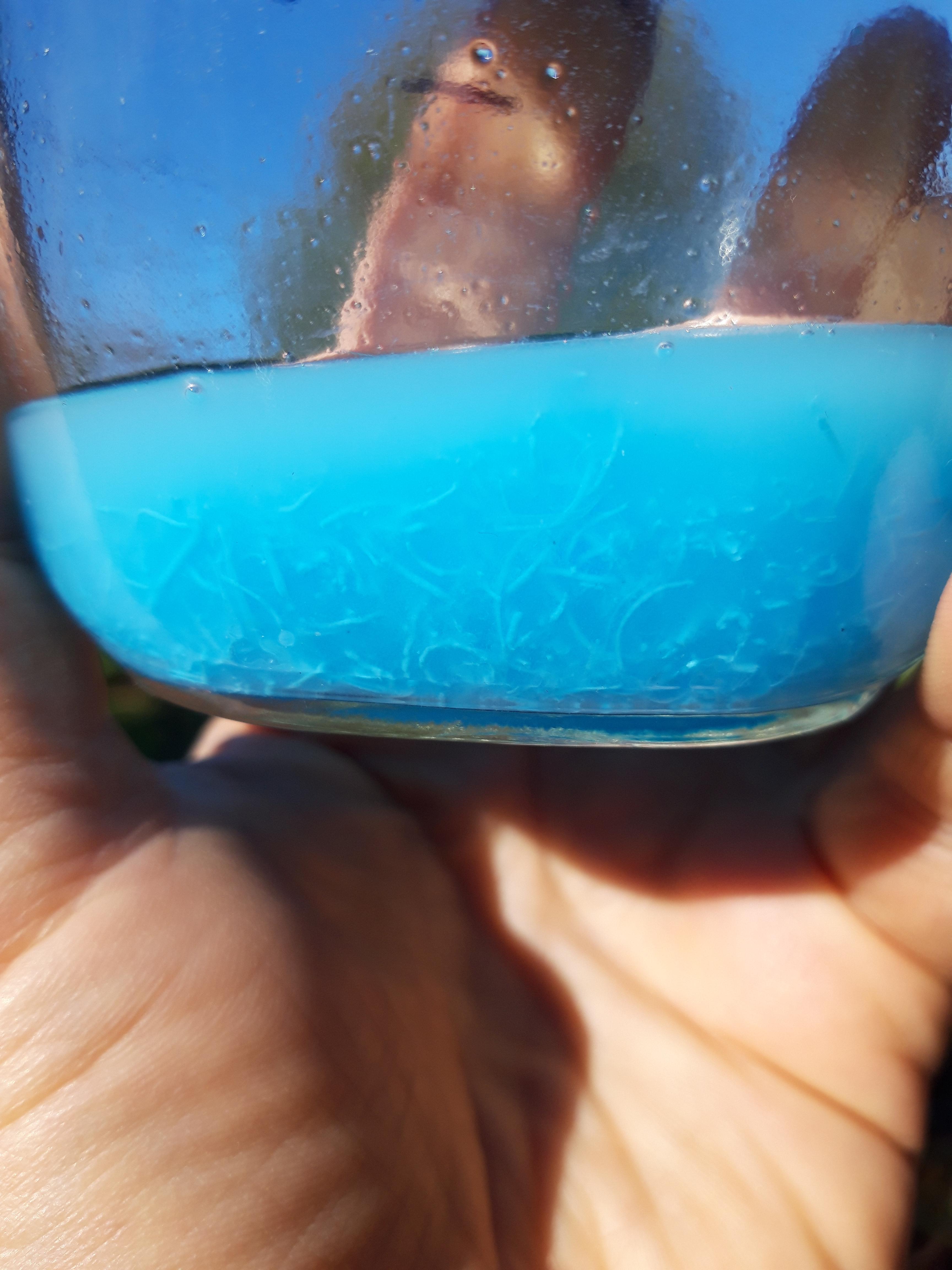

Onoff Posted April 26, 2020 Share Posted April 26, 2020 (edited) We've zero experience printing with ABS here. I've made up two jars of ABS slurry in the absence of pure acetone, with foam gun cleaner and then thinners, both listing acetone as the first ingredient. In both cases I think the results aren't "smooth" enough to coat the bed without the remaining, undissolved ABS fibres being thicker than the first layer and affecting the print. Can't figure why if they started dissolving the ABS why it hasn't continued. In both cases the ABS was scrap print material. That has therefore been heated & cooled. I wonder if fresh ABS off of the reel would work better? Foam Gun Cleaner: LIDL Baufix Thinners: If anything the foam gun cleaner (first picture) looks to have finer "bits" in. The Baufix thinners one seems to have some long strands in there. Edited April 26, 2020 by Onoff Link to comment Share on other sites More sharing options...
Onoff Posted April 26, 2020 Share Posted April 26, 2020 Grated ABS, solvent weld pipe fittings seemed to dissolve pretty well in LIDL Baufix thinners into a slurry. Painted it on a crafty corner of the black glass patio table and it dried to a film. By Christ has it stuck. You can barely scrape it off with your nail. Neat IPA takes it off OK.So then tried it on a corner of the Anycubic i3 Mega S. The bed is glass but with a coating of some sort with tiny holes in. Gets good reports for adhesion.The ABS slurry seems to have filled the holes in the bed coating. It's a pig to get off. This is AFTER cleaning with IPA.Can't take this bed off seemingly. Undid the corner clips but it wouldn't budge. Any ideas?Don't really want to put slurry on the whole bed or hairspray. Is it that I can get an "over bed" to go atop this one I wonder? Link to comment Share on other sites More sharing options...
Gone West Posted April 26, 2020 Author Share Posted April 26, 2020 5 hours ago, Onoff said: Can't figure why if they started dissolving the ABS why it hasn't continued. Can you have a saturated solution of that stuff? Link to comment Share on other sites More sharing options...
Onoff Posted April 26, 2020 Share Posted April 26, 2020 2 hours ago, PeterStarck said: Can you have a saturated solution of that stuff? Not sure. Doing some more reading and in theory, because of the special bed design on this printer model, adhesion promoters aren't required. However, best results are achieved if the whole printer lives in a draught free enclosure. Cue my next project! Link to comment Share on other sites More sharing options...

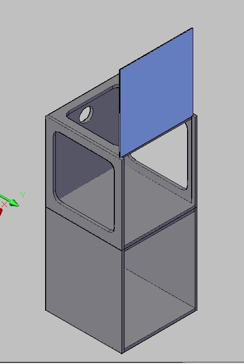

Onoff Posted April 27, 2020 Share Posted April 27, 2020 Looking to make an enclosure for the 3D printer. Probably on castors and likely with a pc fan at the back for fume extract to a window for when printing ABS. It'll in effect be two 600mm cubes. Top one for the printer and the lower one shelved out for storage. Plan for the top is to have a vertically sliding clear panel. This will nominally be 600x600. Not sure what to use, acrylic, polycarbonate etc. Also what thickness? Any thoughts? Cheers. Link to comment Share on other sites More sharing options...
SteamyTea Posted April 27, 2020 Share Posted April 27, 2020 18 minutes ago, Onoff said: Not sure what to use, acrylic, polycarbonate etc. Also what thickness? Any thoughts? Cheers. Cast acrylic, it more stable and optically clear. Probably get away with 4mm, maybe need 6mm. 1 Link to comment Share on other sites More sharing options...
