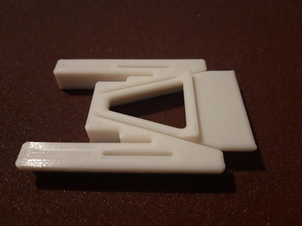

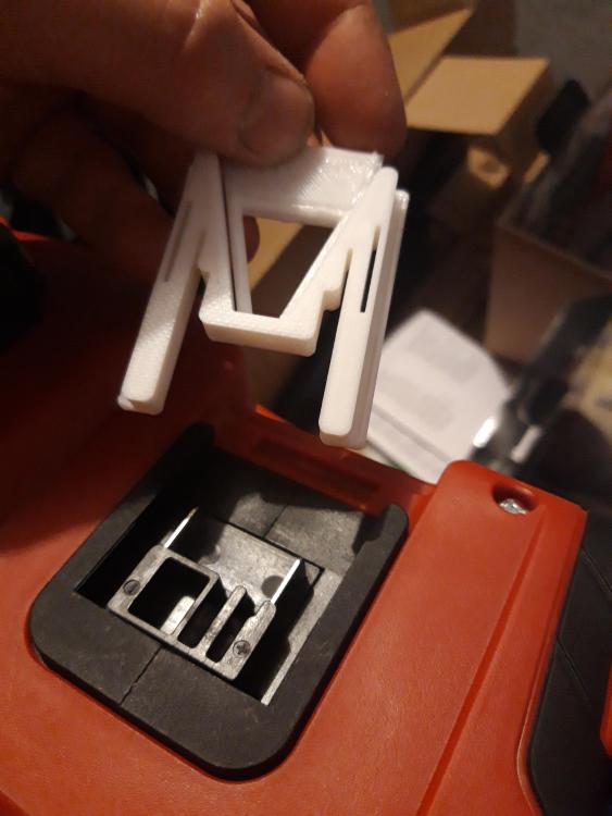

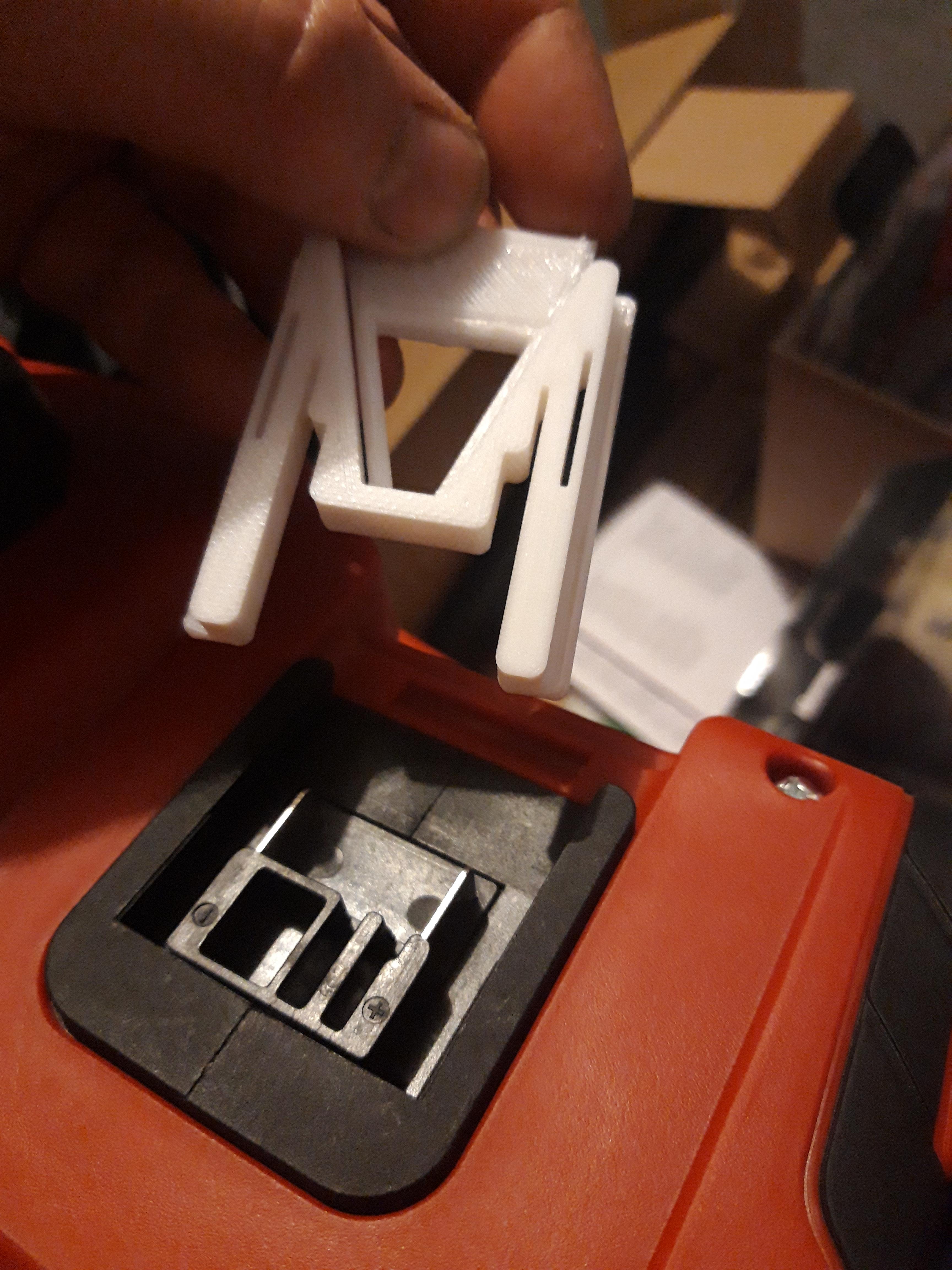

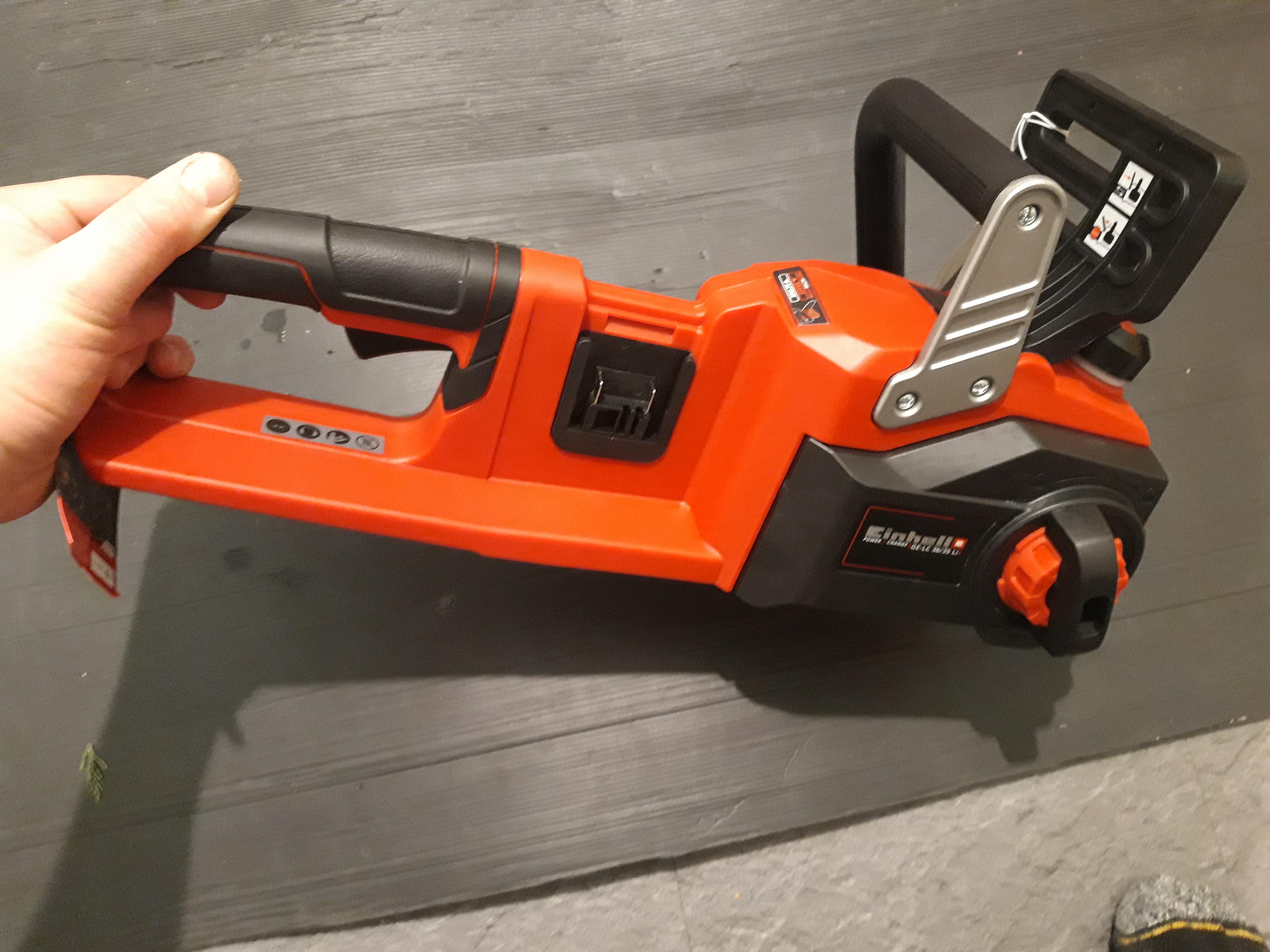

Onoff Posted April 9, 2020 Share Posted April 9, 2020 The bare Einhell chainsaw turned up: Found a Makita battery to Einhell / Ozito adapter on Yeggi. Done a quick and dirty print in PLA to check the fit. A bit too loose for my liking. As the video below shows. The guy on the Yeggi link says it's not tight tba. Doing another print and just upping it by a couple of percent on the off chance that might make things tighter. VID-20200409-WA0021.mp4 Need to get some 1mm copper sheet off my brother to make the connecting plates. Link to comment Share on other sites More sharing options...

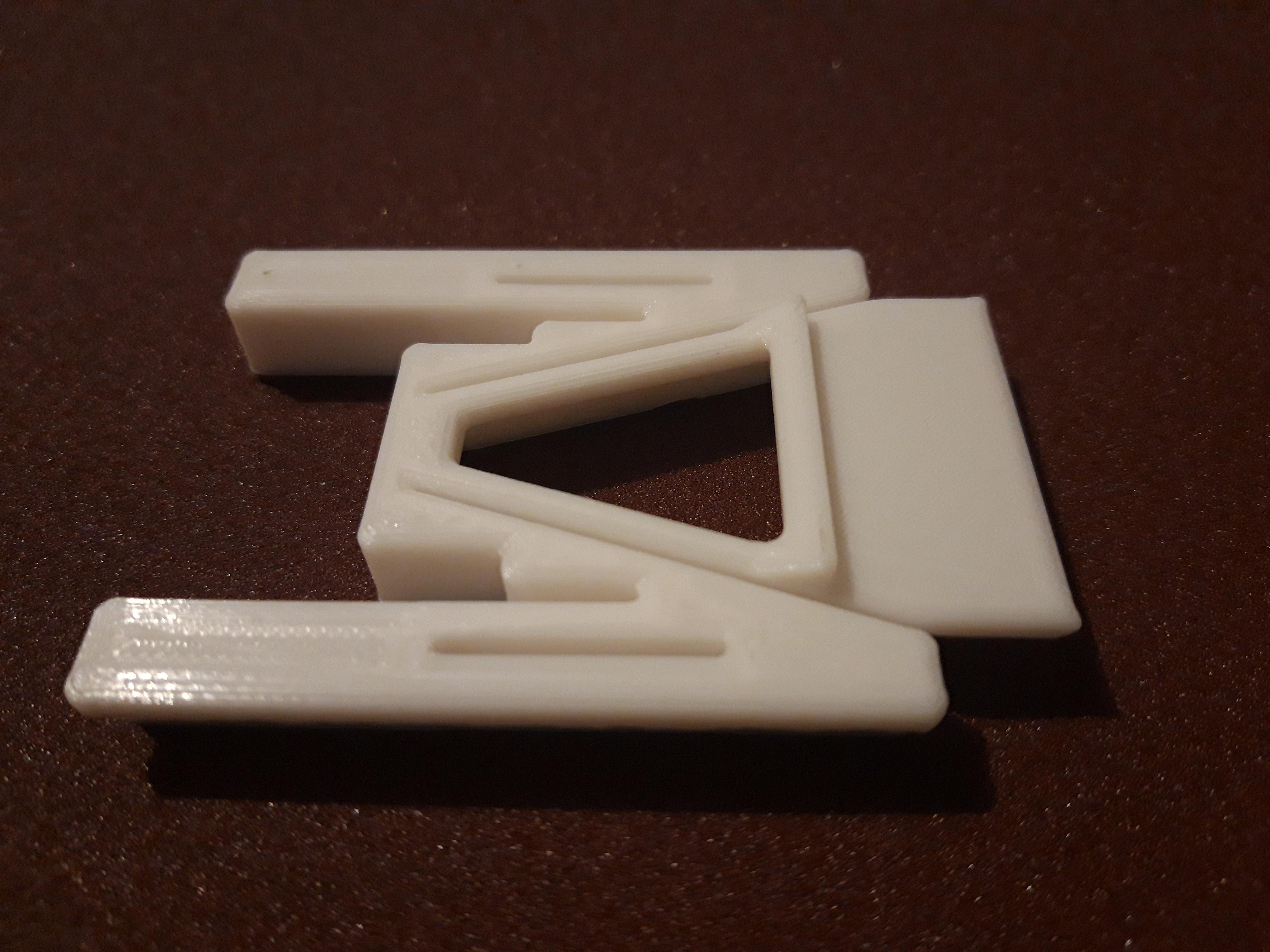

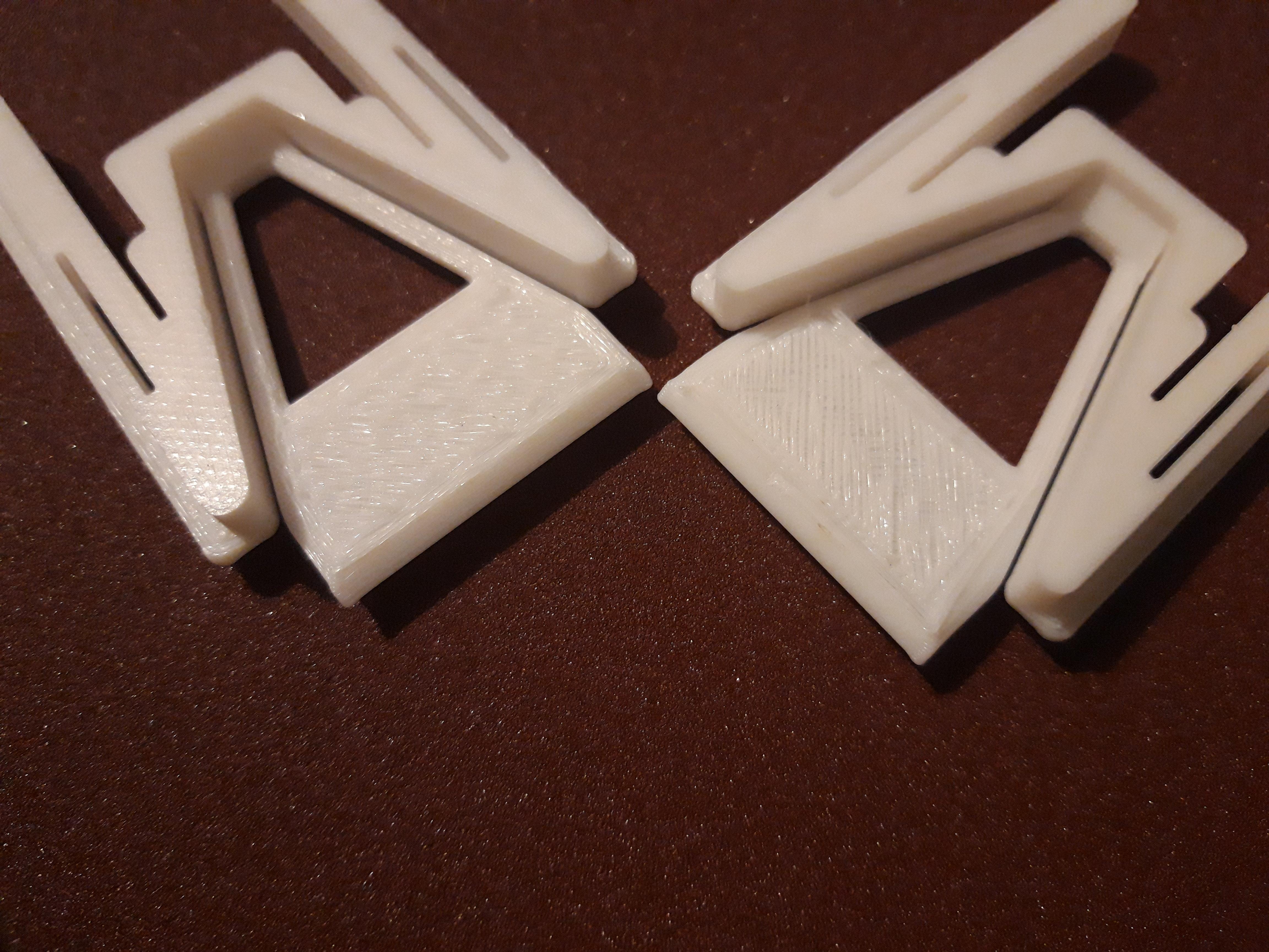

Onoff Posted April 9, 2020 Share Posted April 9, 2020 @Temp, PLA print problems! This prints this way up. Only 25% infill, doesn't look too bad...this side. But turn it over and the underside of the V shape release clip, that had supports (snapped off) look dog rough. Any suggestions? Cheers. Link to comment Share on other sites More sharing options...
Temp Posted April 10, 2020 Share Posted April 10, 2020 Unfortunately it's always pretty rough where supports have to be used. There are some solutions but its not always possible to use them. Sometimes you can... Rotate an object and print it at an unusual angle so that overhangs are nearer to the vertical so either it doesn't need supports or the supports are in a less important place. Split the object in two horizontally in CAD creating a flat face, print both parts side by side with the split face down out and glue back together. (The split face doesn't actually have to be flat because any rough parts caused by supports will end up hidden inside the part when it's glued back together). Frequently I modify a design in CAD to avoid needing supports. So called "design for 3d printing". For example splitting a part to create a joint. Easy in F360 to create matching pegs and holes or dovetails from the same sketch. Not quite sure what to recommend for your part. I'm guessing that central bit needs to flex as it's a spring clip of some sort? Link to comment Share on other sites More sharing options...
Onoff Posted April 20, 2020 Share Posted April 20, 2020 (edited) The Makita battery to Einhell/Ozito continuation: Einhell it seems bought Ozito. From that came the Power X Change system. Seems the same batteries fit both makes. Off of Thingiverse we downloaded a ready made adapter by a chap named Seibar. That itself was his take on a model developed by a chap, sportsedan. Seibar's was a little loose for my liking so we increased widths/thicknesses here and there and made it a bit tighter. The visible face on his, you would see, where the Makita battery clips on looked dog rough imo: So our 1st print was done with the layer orientation at 90deg to Seibars: It fits nice and tight, Face you see not too bad: But.....it was printed with this end sitting on the bed, where the supports came off, it's horrible: The clip broke as well. Pretty sure the layer orientation didn't help: Printing another with the end squared off and more "meat" on the clip: 0.2mm layers, black Steadytech PLA. Watch this space about 8pm tonight! Edited April 20, 2020 by Onoff 1 Link to comment Share on other sites More sharing options...
Onoff Posted April 20, 2020 Share Posted April 20, 2020 Pretty happy with that I think. Second one just started printing. The battery "terminals" for this are fab'd from 1mm copper sheet, soldered together. Some deft tin snipping to be done. Link to comment Share on other sites More sharing options...
Onoff Posted April 21, 2020 Share Posted April 21, 2020 (edited) Got up at 4, my lad still hadn't gone to bed! ? He had though printed the second battery adapter: A little rough at the very apex but there's a bit of a uniform pattern in the "weave": Copper sections next to make and solder. Then fully assemble the chainsaw and test with Makita Li-ion batteries. Hoping PLA stands the test of time and I'm not left wishing I'd printed them in ABS! Edited April 21, 2020 by Onoff Link to comment Share on other sites More sharing options...

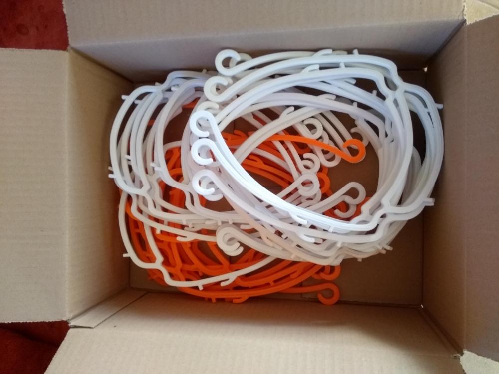

Temp Posted April 21, 2020 Share Posted April 21, 2020 After a lot of agro with my printer (blown fuses, failed bearings *2, crap prints) I've just finished printing a batch of visor headbands for the NHS. Part of this project.. https://national3dprintingsociety.co.uk/medical-am-covid-19/ 1 Link to comment Share on other sites More sharing options...
Onoff Posted April 21, 2020 Share Posted April 21, 2020 14 minutes ago, Temp said: After a lot of agro with my printer (blown fuses, failed bearings *2, crap prints) I've just finished printing a batch of visor headbands for the NHS. Part of this project.. https://national3dprintingsociety.co.uk/medical-am-covid-19/ Wouldn't mind printing some. So many designs though it's knowing where to start. What material are you printing in? Can you print just the bands or do you need to supply the visor part too? Link to comment Share on other sites More sharing options...
Jeremy Harris Posted April 21, 2020 Share Posted April 21, 2020 How are these being disinfected? I only ask, because I've read a fair few articles recently about the inherently porous nature of 3D prints, because the layer adhesion is never 100% perfect, means that it's very difficult to guarantee that pre-use disinfection with liquid disinfectants (which is essential before they can be safely used) may not be effective. Part of the spec from the NHS is that the stuff arrives in a sealed bag and is guaranteed to be free from contamination, so there's no risk that someone who's asymptomatic but shedding the virus whilst making these can accidentally transmit infection via these parts. Link to comment Share on other sites More sharing options...
Temp Posted April 22, 2020 Share Posted April 22, 2020 5 hours ago, Onoff said: Wouldn't mind printing some. So many designs though it's knowing where to start. What material are you printing in? Can you print just the bands or do you need to supply the visor part too? The team behind that project have been working to get a design approved by the NHS. The stl files are on their site and were updated to version 7 today. The ones I've been printing were the previous version which I think are only accepted by care homes. They have been designed to be stackable eg you can print a stack of 4,8,16 etc in one go then split them. They have to be printed in PLA or PETG. Other materials might be acceptable but they haven't been tested yet. You just print bands. They have people making the clear part and doing assembly. The clear part is just a ring binder cover with 4 punched holes. 1 Link to comment Share on other sites More sharing options...
Temp Posted April 22, 2020 Share Posted April 22, 2020 4 hours ago, Jeremy Harris said: How are these being disinfected? I only ask, because I've read a fair few articles recently about the inherently porous nature of 3D prints, because the layer adhesion is never 100% perfect, means that it's very difficult to guarantee that pre-use disinfection with liquid disinfectants (which is essential before they can be safely used) may not be effective. Part of the spec from the NHS is that the stuff arrives in a sealed bag and is guaranteed to be free from contamination, so there's no risk that someone who's asymptomatic but shedding the virus whilst making these can accidentally transmit infection via these parts. The project team have a company sterilising printed bands. Thats the reason they say you should not send them to hospitals yourself. My guess is they either irradiate them or soak in bleach. 1 Link to comment Share on other sites More sharing options...
Onoff Posted April 22, 2020 Share Posted April 22, 2020 4 hours ago, Temp said: The team behind that project have been working to get a design approved by the NHS. The stl files are on their site and were updated to version 7 today. The ones I've been printing were the previous version which I think are only accepted by care homes. They have been designed to be stackable eg you can print a stack of 4,8,16 etc in one go then split them. They have to be printed in PLA or PETG. Other materials might be acceptable but they haven't been tested yet. You just print bands. They have people making the clear part and doing assembly. The clear part is just a ring binder cover with 4 punched holes. Thanks. Material stock would be my issue immediately. How many grams per band / bands per kilo and can it be any colour? I wanted 1kg of black Steadytech PLA the other day. Had to settle for x3 300g. Link to comment Share on other sites More sharing options...
Jeremy Harris Posted April 22, 2020 Share Posted April 22, 2020 5 hours ago, Temp said: The project team have a company sterilising printed bands. Thats the reason they say you should not send them to hospitals yourself. My guess is they either irradiate them or soak in bleach. That makes sense. Our volunteer team ran into similar issues with infection control, but I have to say the NHS have put in place a pretty good system for informing and helping people to comply. The technique for disinfection that has been reported as being the most effective on pretty much any material is to heat to 65°C in a dry oven. Most plastics can tolerate this, and there's a study that's looked at the effectiveness of this method and found it comes out ahead of other methods, particularly for potentially porous materials (like FDM prints), where liquid disinfectants may not penetrate all the pores. The dry heat technique also works well for disinfecting single use PPE, if it runs short. It's the only practical technique for disinfecting N95 type masks, as they are made with a high surface charge on the fibres, to enable them to trap fine particles, and wet disinfection destroys this, apparently. Link to comment Share on other sites More sharing options...

Onoff Posted April 22, 2020 Share Posted April 22, 2020 All soldered up and tested. The jury's out. Need to try with good batteries. I'll assemble the chainsaw with the blade etc tomorrow and try it: Short video: 1 Link to comment Share on other sites More sharing options...
Onoff Posted April 23, 2020 Share Posted April 23, 2020 ????? The Einkita / Makhell hybrid chainsaw only WORKS! It's alright too. No proper oil so I've put 20w50 (for the Capris) in. Video tomorrow / the weekend. Link to comment Share on other sites More sharing options...
PeterW Posted April 23, 2020 Share Posted April 23, 2020 Just now, Onoff said: No proper oil so I've put 20w50 (for the Capris) in. Please don’t do that. It’s not expensive and go buy some biodegradable chain oil instead of spreading crap into the environment. And please wear proper PPE for the saw - you can’t outrun the chain when it snaps, and it won’t be pretty if it does. Link to comment Share on other sites More sharing options...
Onoff Posted April 24, 2020 Share Posted April 24, 2020 11 hours ago, PeterW said: Please don’t do that. It’s not expensive and go buy some biodegradable chain oil instead of spreading crap into the environment. And please wear proper PPE for the saw - you can’t outrun the chain when it snaps, and it won’t be pretty if it does. ?I'll drain it off and get some biodegradable stuff. Have to be mail order I assume at the moment unless either of the garden machinery places is open. Hardly essential tbh, it's enough knowing it all works! As for PPE what's the requirements? It's really quiet compared to a petrol job so are ear defenders required? Saying that I imagine they could protect your ears against a chain breaking and whipping up! I'd never even considered that! 1 Link to comment Share on other sites More sharing options...
