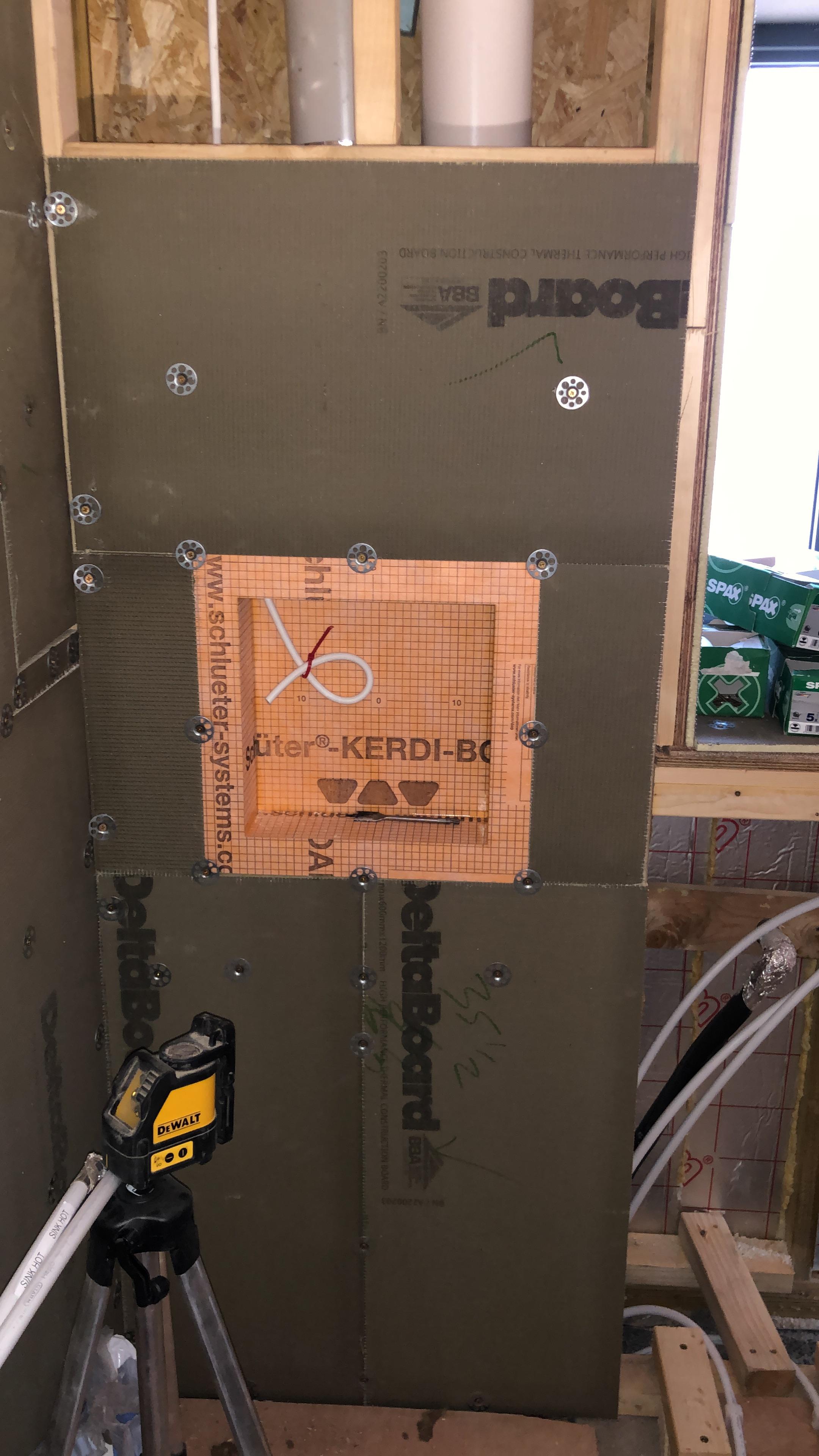

Weebles Posted January 16, 2019 Share Posted January 16, 2019 We are looking at putting in shower recesses into our showers. Are these prefab boxes worth it? https://www.kerdi-board.co.uk/shower-niche.aspx https://www.pureadhesion.co.uk/marmox-niche-300x400x100mm.html If so, anyone got any preference? Thanks 1 Link to comment Share on other sites More sharing options...

SiBee Posted May 30, 2020 Share Posted May 30, 2020 (edited) Never seen these but they are a good idea. Without checking the details myself, do they com3 in different s dims? 85mm is shallow once tiled. I made my own (marmot and orbry board) Openings with tile sizes in mind to try and limit cut edges and to fit mosaics. I did hav3 the luxury of a large cavity Edited May 30, 2020 by SiBee Added pics 3 Link to comment Share on other sites More sharing options...

Nickfromwales Posted May 30, 2020 Share Posted May 30, 2020 On 29/05/2020 at 11:43, Bored Shopper said: which one did you go for eventually? What's the configuration? We're designing ours now, too many options!! Moisture resistant plasterboard is ample, if used sensibly and in conjunction with a tanking solution. Why spend stupid amounts of money on something that requires tanking ANYWAY? If you want something waterproof then cement board ( Aqua panel etc ) is a one-up option but if you’re tanking is still overkill imo. Ive a 1/4 century of high-end bathroom installs under my belt btw, so am not making these comments without care and confidence. Link to comment Share on other sites More sharing options...
Onoff Posted May 30, 2020 Share Posted May 30, 2020 Made mine under instruction of His Highness the Welsh Wizard: Timber frame: Lined with Aquapanel: Tanked: If you want a really big pocket you likely won't get a former anyway. Link to comment Share on other sites More sharing options...
Pocster Posted May 31, 2020 Share Posted May 31, 2020 They are expensive for what they are . But takes 2 mins to install . They have a collar that surrounds them which I’ve yet to install . Joints on the board have some special mix you use . Boards are described as water resistant rather than water proof . Still if the water has got past your tiles / grout / Mastik you’re in trouble anyway . Link to comment Share on other sites More sharing options...
Onoff Posted May 31, 2020 Share Posted May 31, 2020 35 minutes ago, pocster said: Boards are described as water resistant rather than water proof . Still if the water has got past your tiles / grout / Mastik you’re in trouble anyway . Interesting. I reckon I could fill my tanked pockets up like a pond. 1 Link to comment Share on other sites More sharing options...
