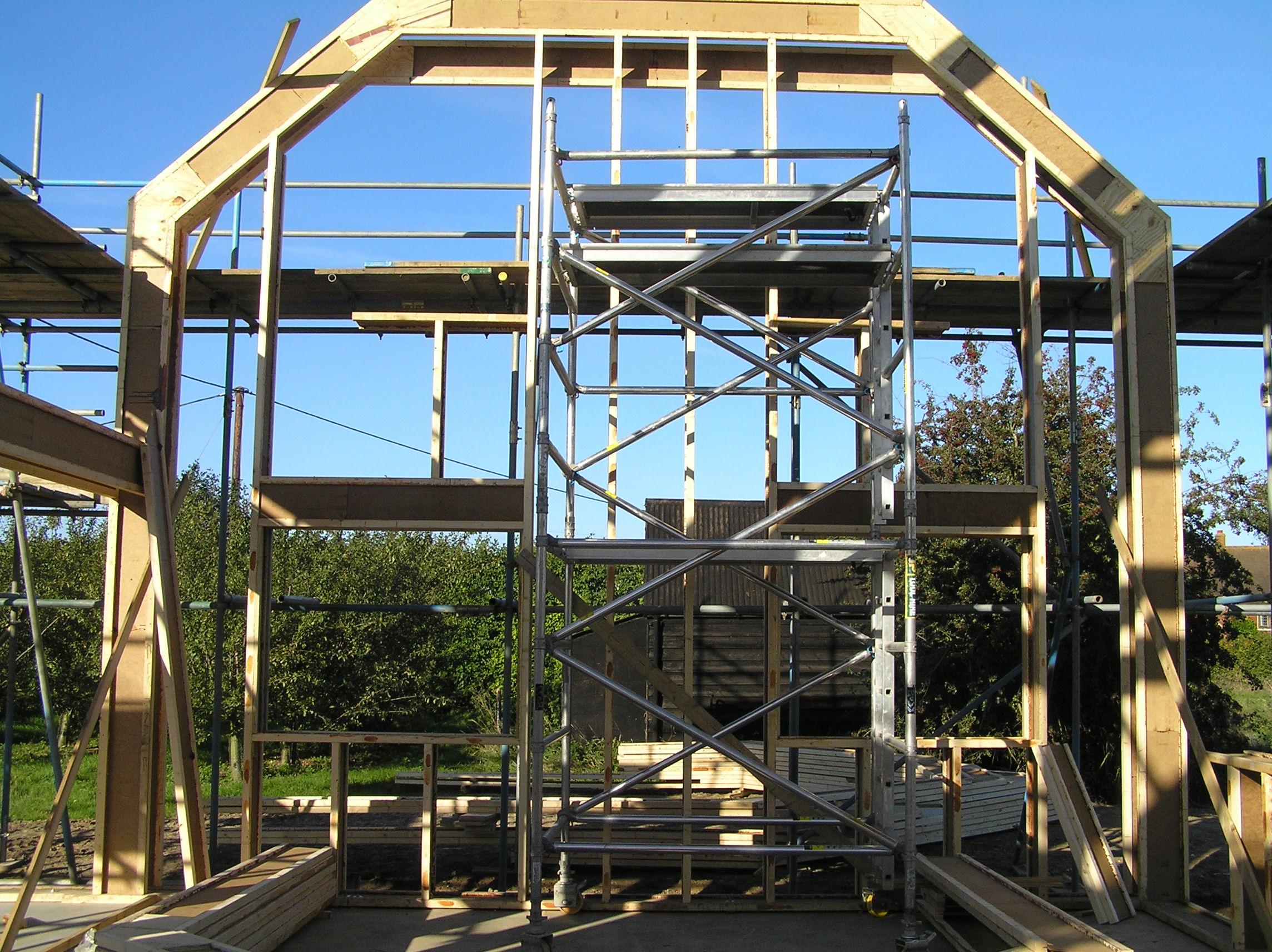

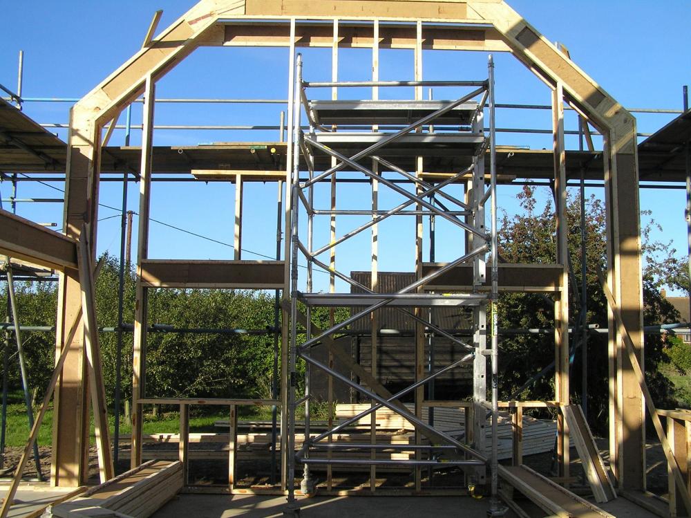

Gone West Posted January 16, 2019 Posted January 16, 2019 Our sole plate is a single 300mm Steico I-beam which has OSB3 web strengtheners bonded underneath at intervals where the plate is bolted to the slab. The 300mm Steico I-beam studs are nailed to the sole plate. 1 1
Simplysimon Posted January 16, 2019 Author Posted January 16, 2019 thanks guys, were both these stick built or did the walls come in panels? @MikeSharp01 any pics? cheers
Gone West Posted January 17, 2019 Posted January 17, 2019 11 hours ago, Simplysimon said: thanks guys, were both these stick built or did the walls come in panels? Mine is a portal frame and each individual part of the frame was made in the factory and fitted to the sole plate on site. 1
