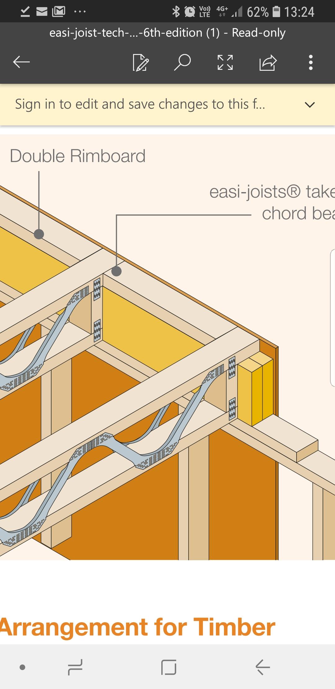

Big Neil Posted January 15, 2019 Posted January 15, 2019 Anyone used these or considered them? They seem (certainly in respect of polystyrene based ICF builds) like such a simple option. 2 slits, re-barred in from behind and bobs your uncle. Pour your concrete. there's a Canadian chap called Cody on YouTube who suggests using a length of wood once a line has been marked, to rest them on to avoid twisting during the pour.
Big Neil Posted January 15, 2019 Author Posted January 15, 2019 (edited) ..sidebar - if hanging a wallplate off the simpson style hangers, would it possibly be easier to attach joist hangers to the wooden wall plate first before dropping it onto the wall. Edited January 15, 2019 by Big Neil correction
Alexphd1 Posted January 15, 2019 Posted January 15, 2019 There is a few options for hanging joists. We went the cheapest but most time consuming. We bolted a timber batten into the concrete around the icf and hang the posi joist of the top chord on the timber batten.
Big Neil Posted January 15, 2019 Author Posted January 15, 2019 15 minutes ago, Alexphd1 said: There is a few options for hanging joists. We went the cheapest but most time consuming. We bolted a timber batten into the concrete around the icf and hang the posi joist of the top chord on the timber batten. Morning Alex. Have you any pictures. I've been looking at the different hangers recently as I would never fully understand their installation. The link below seems to have an interesting options, in fact looks like what i have suggested above to a degree, i.e have hung the hangers on the chord before attaching it to the wall. Makes sense really. If you have a straight piece of timber you can evenly space the hangers without having to wobble around on a ladder, plus you have a margin of error i suppose in regards the retaining bolts http://www.ana-white.com/2011/10/momplex/how-frame-floor-inside-icf-walls-part-1

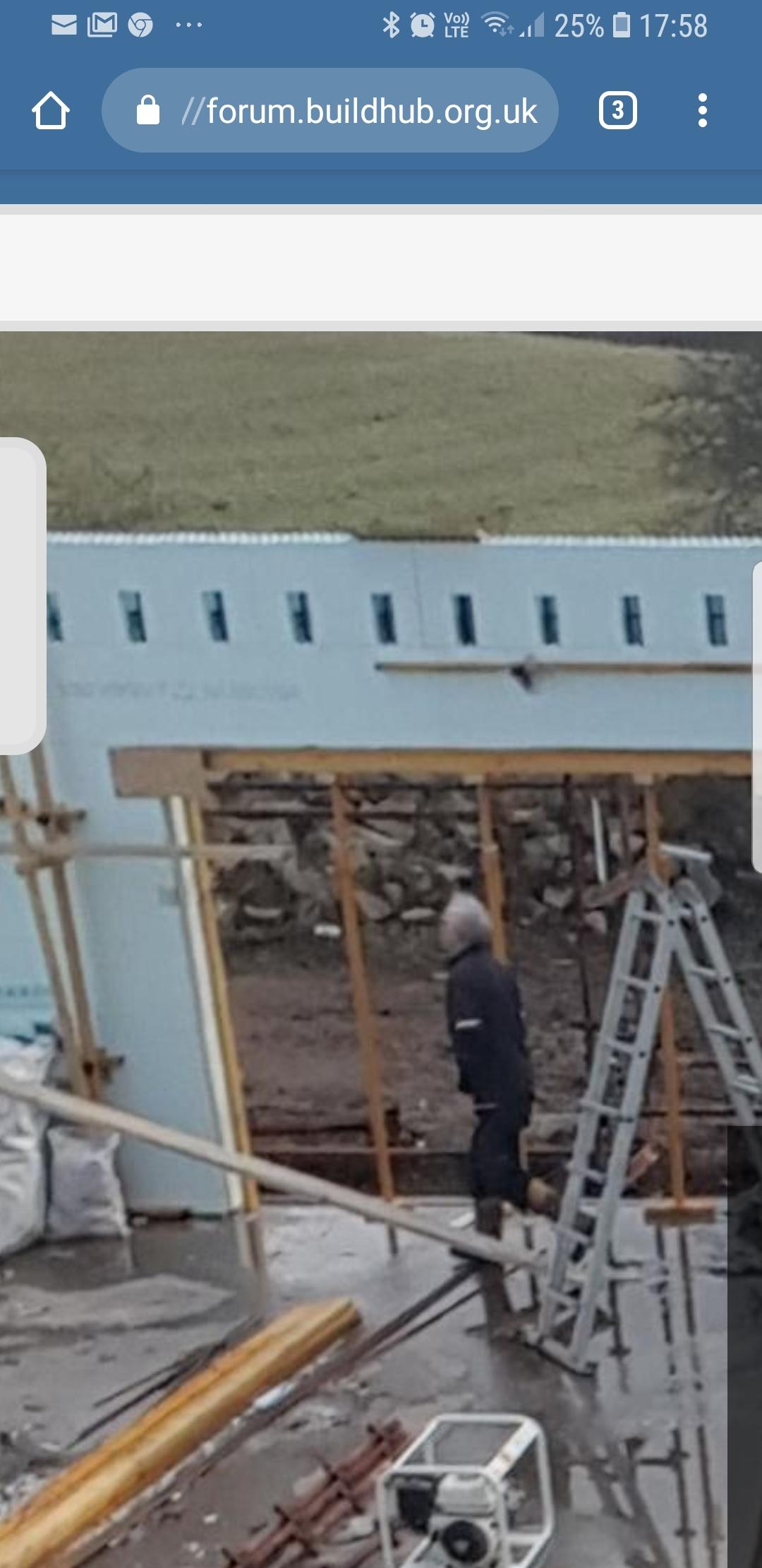

Russell griffiths Posted January 15, 2019 Posted January 15, 2019 I’m hoping to hang the pole plate(English name) rim board (yank name) wall plate(wrong name) before the concrete goes in, all bolts in place for concrete to surround them will fit joist hangers later as I will hire a positive placement gun to do this, as I have far to many nails to even think about doing it by hand
Big Neil Posted January 15, 2019 Author Posted January 15, 2019 Pole PLate - gotcha I've watched that video thoroughly now with sound and it makes sense. The Pole plate is held in front of the holes by using screws into the thingamejigs which are also used for plasterboard fixing, Holes drilled through into the holes then anchor bolts inserted from the void side tied if possible against rebar, but pre-tensioned by doing the nut up a bit. Makes total sense. And I suppose it you have already checked the piece you're using as the pole plate is level, you just line the joist hangers up at the top and the floor by association, is level.

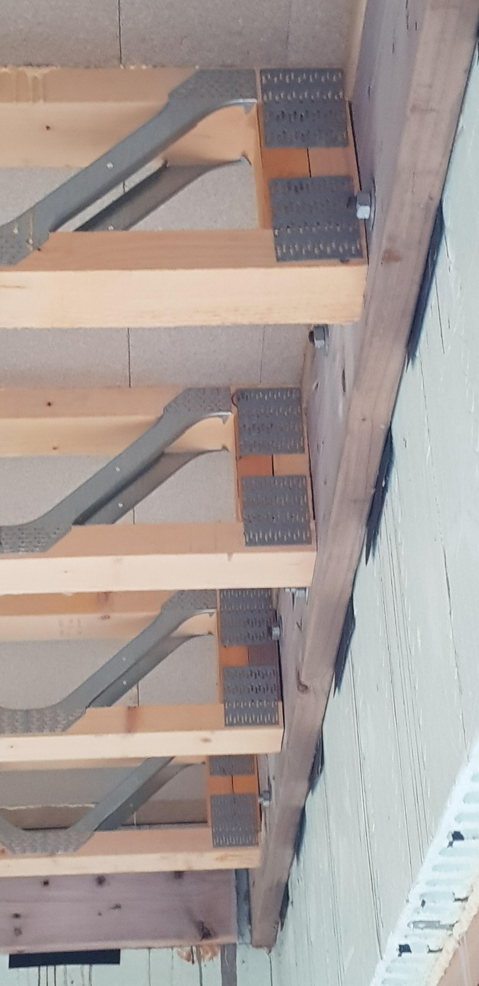

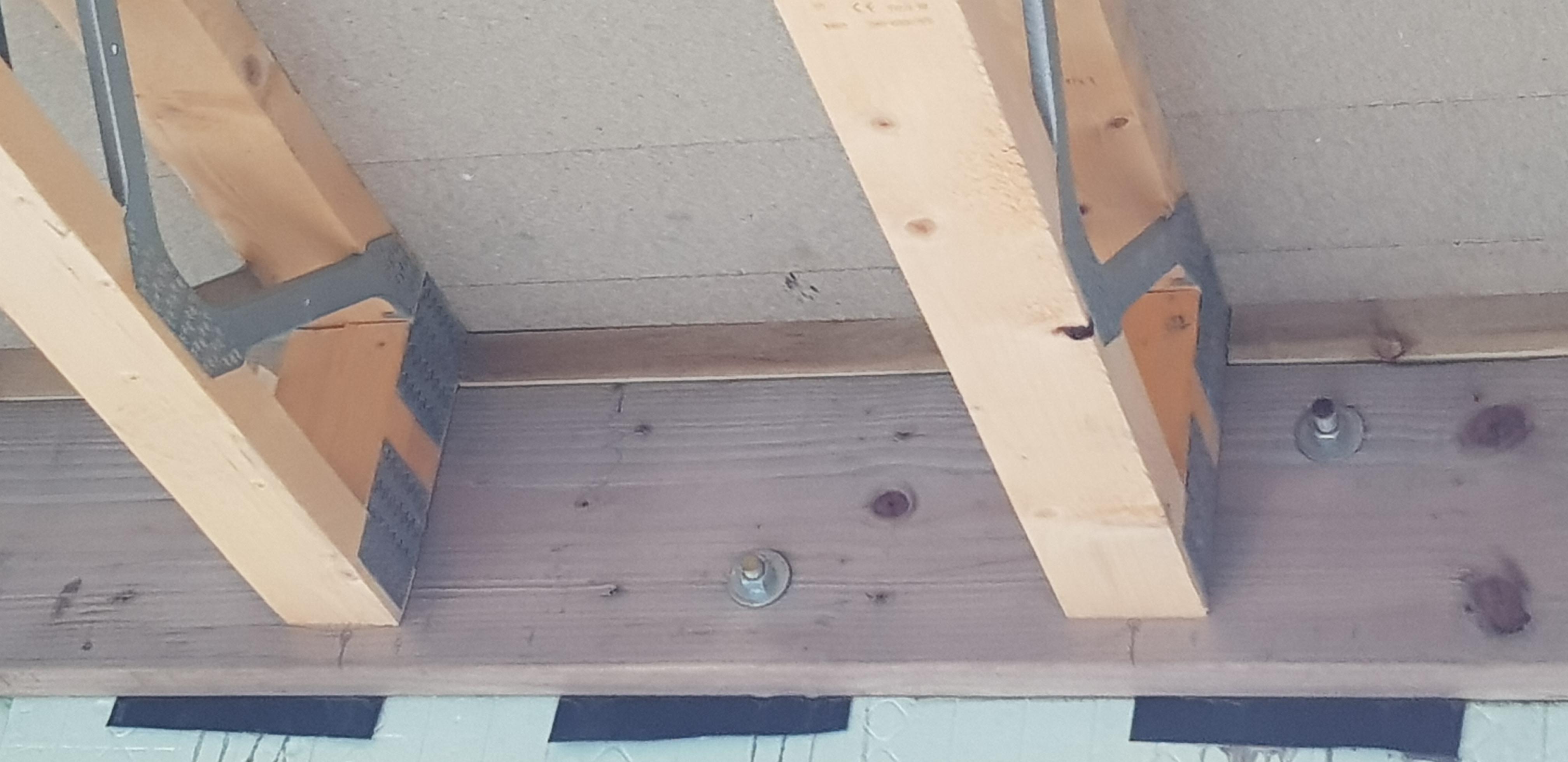

Alexphd1 Posted January 15, 2019 Posted January 15, 2019 (edited) We done exactly as on video. Then hang the posi joist on top chord on the rim joist no metal hangers. The rim joist also reinforced for the pour and worked well with zont bracing, it may get in way of metal bracing? We made the mistake of cutting the hole between every second plastic tie (nudara) thinking this was metric..... the nuts and washers clashed with the joists every now and again..... We just stuck in extra joists and sorted out 400 centers when clear of nuts again. Also put in a cutting of plastic dpm between the timber and the concrete. Worked very well, replicate on build 2. Edited January 15, 2019 by Alexphd1

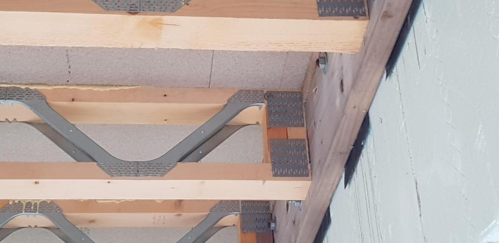

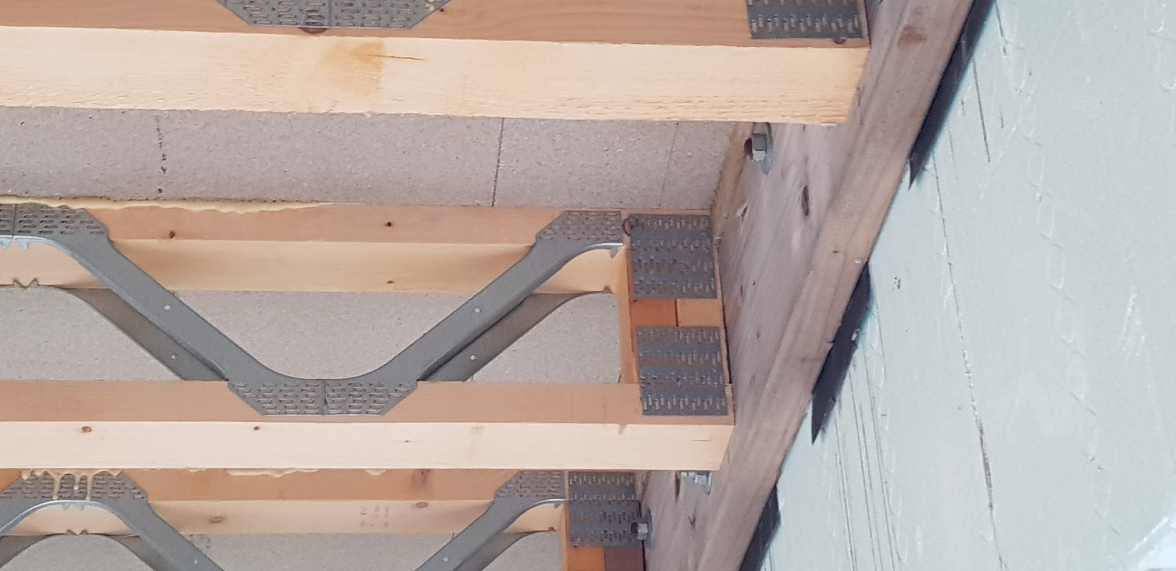

Alexphd1 Posted January 16, 2019 Posted January 16, 2019 Just a few pics of posi joist hanging on top chord. 2
Big Neil Posted January 16, 2019 Author Posted January 16, 2019 Am i blind or is there no obvious bracket in those last few. HOw are they attached @Alexphd1
Alexphd1 Posted January 16, 2019 Posted January 16, 2019 No brackets. Top chord of joist is sitting on the rim joist.
Ed Davies Posted January 16, 2019 Posted January 16, 2019 @Alexphd1, were the bottom cords cut to length and the blocking crimped on on site or at the factory? Did you do the rim boards then give them mm level measurements, or what?
Alexphd1 Posted January 16, 2019 Posted January 16, 2019 (edited) I didn't realise you could make posi joists on site. Luckily we have a factory a few miles from us and ordered joists in small quantity, think smallest order was 15.... All joists where made in factory, we have a metal I beam in centre and used this side for a few mm packers where we had more tolerance on top chord. The minimum was 45mm overhang on top chord, the timber is 47mm wide and the top chord is a mm into the eps. I did have a few sleepless nights between ordering and joists arriving! Edited January 16, 2019 by Alexphd1
Alexphd1 Posted January 16, 2019 Posted January 16, 2019 Rim joist and metal beams where in place. Everything was marker out and measured then supplied to manufacturer.
