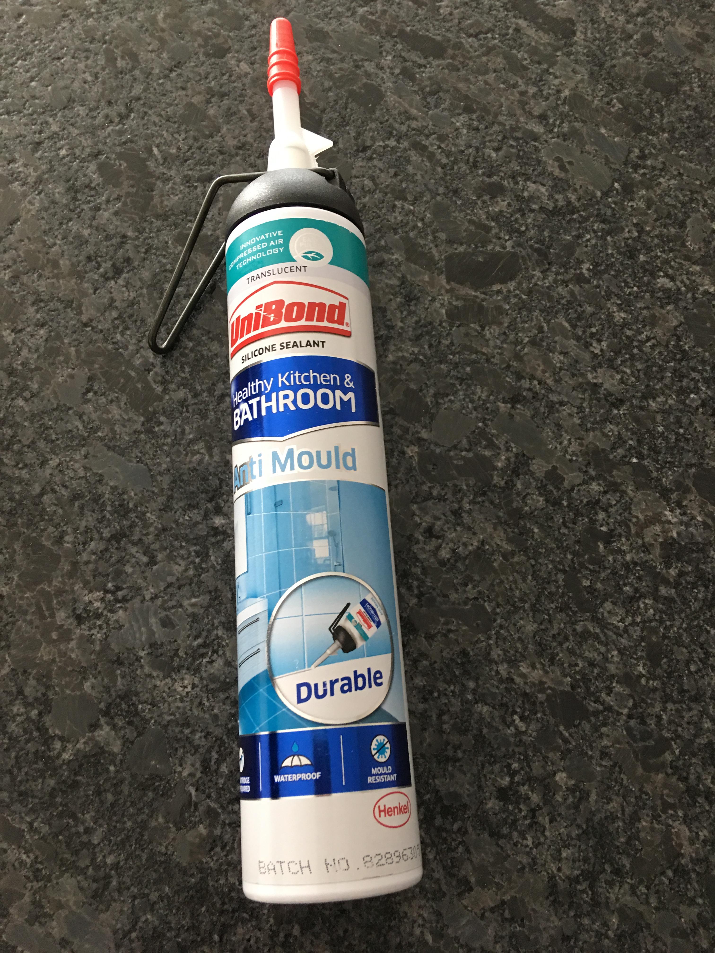

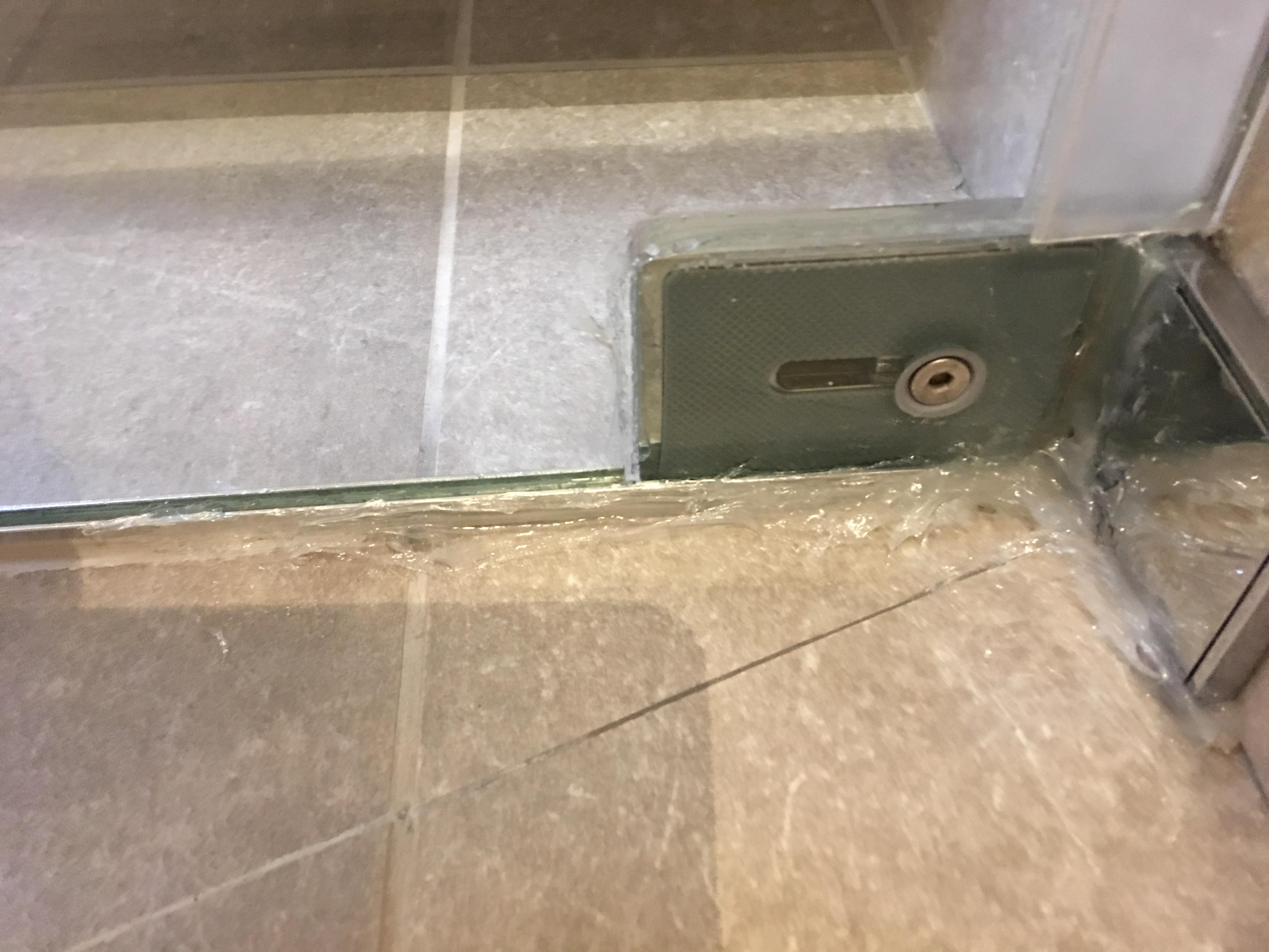

lizzie Posted February 17, 2019 Author Share Posted February 17, 2019 Ok so all cleaned off and dried (with hairdryer) decided to have another go myself.....its not a thing of beauty @Onoff it makes you look like Michaelangelo to my bad Picasso LOL. Yet to water test, that comes tomorrow. Demented.com 2 Link to comment Share on other sites More sharing options...
newhome Posted February 17, 2019 Share Posted February 17, 2019 Well done on giving it a go @lizzie. What sort did you use? The guy that came to do mine clearly used a cheap shite white one that has discoloured already and started to unbond. Not sure whether I should use a colour or clear in the gap between the white shower tray and cream tiles. The grout colour is Jasmine. I have some Mapei jasmine silicone so am wondering whether to use that but see CT1 and Forever White keep being mentioned so I'm confused lol Link to comment Share on other sites More sharing options...
lizzie Posted February 17, 2019 Author Share Posted February 17, 2019 @newhome this is my latest one. It has a built in applicator which is ‘easy’ to use, well it is easy compared to a gun and I practiced on cardboard for a few days and did really well but it went to pot when I got onto the job proper. I used clear for mine as that is best in the location I have. I saw the £80 lot used cheapest screwies stuff although it was clear as I had specified it had to be clear. Such a small job has turned into a mammoth task feel so bloody useless! 1 Link to comment Share on other sites More sharing options...

lizzie Posted February 18, 2019 Author Share Posted February 18, 2019 So I failed the water test. Thought I had cracked it but post shower cleaning down the screen with the squegee and a small amount of water appeared on my test paper the other side of the glass. I had an extra long shower with none appearing so go figure! Its a better result than professionals got though much less water so not feeling too despondent. When I can get the mental energy to start scraping it all off again will have another go meantime back to the sponge in the corner. Link to comment Share on other sites More sharing options...
newhome Posted February 18, 2019 Share Posted February 18, 2019 34 minutes ago, lizzie said: So I failed the water test. Oh bugger! You sure it's getting through the sealant and it's not getting in through a gap in that fixing somehow? 1 Link to comment Share on other sites More sharing options...
Onoff Posted February 18, 2019 Share Posted February 18, 2019 33 minutes ago, newhome said: Oh bugger! You sure it's getting through the sealant and it's not getting in through a gap in that fixing somehow? Try a smear over that fixing? 1 Link to comment Share on other sites More sharing options...
Vijay Posted February 18, 2019 Share Posted February 18, 2019 worth putting talc powder or flour over the area to see exactly where it leaks from? Or possibly UV dye so you can trace the leak exactly?? 1 Link to comment Share on other sites More sharing options...
Onoff Posted February 18, 2019 Share Posted February 18, 2019 12 minutes ago, Vijay said: worth putting talc powder or flour over the area to see exactly where it leaks from? Or possibly UV dye so you can trace the leak exactly?? You're thinking of the trick with a fat bird... 1 Link to comment Share on other sites More sharing options...
lizzie Posted February 18, 2019 Author Share Posted February 18, 2019 I will have to use more sophisticated test methods, thanks for the suggestions. The weird thing is I had a really long shower and no leak at all it was only the cleaning the water off the glass screen that caused the seepage so maybe the fixing as you say...as suggested will try a smear across the top of it tomorrow and see what happens Link to comment Share on other sites More sharing options...
