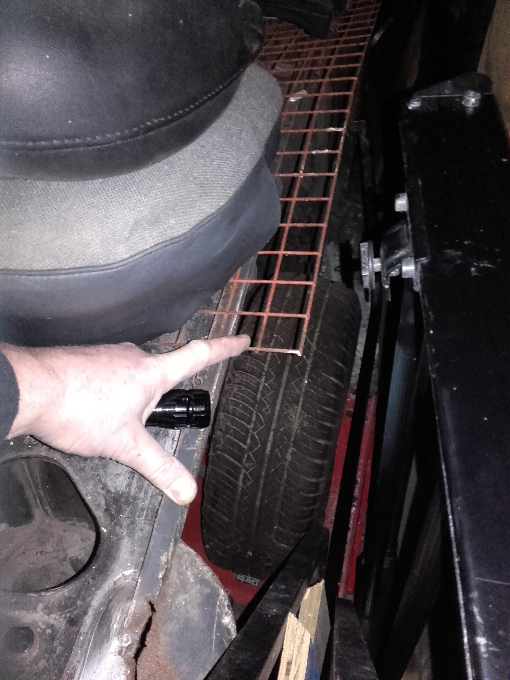

Onoff Posted January 5, 2019 Share Posted January 5, 2019 Only got this bit. Nominal 1 1/4" x 1 1/4" so about 35x35 through the hole - too small I assume. Not taken a vernier to it but looks about 4mm dia rod. Guessing about 6'x4'. Red oxide painted. Will happily dig it out. 1 Link to comment Share on other sites More sharing options...
Gone West Posted January 5, 2019 Author Share Posted January 5, 2019 2 minutes ago, Onoff said: Only got this bit. Nominal 1 1/4" x 1 1/4" so about 35x35 through the hole - too small I assume. Not taken a vernier to it but looks about 4mm dia rod. Guessing about 6'x4'. Red oxide painted. Will happily dig it out. Thanks Clive but the grid size is a bit small for what I want. I'll try P & W Nash as you suggested. I saw a wheeled one on Youtube which has given me an idea. Link to comment Share on other sites More sharing options...

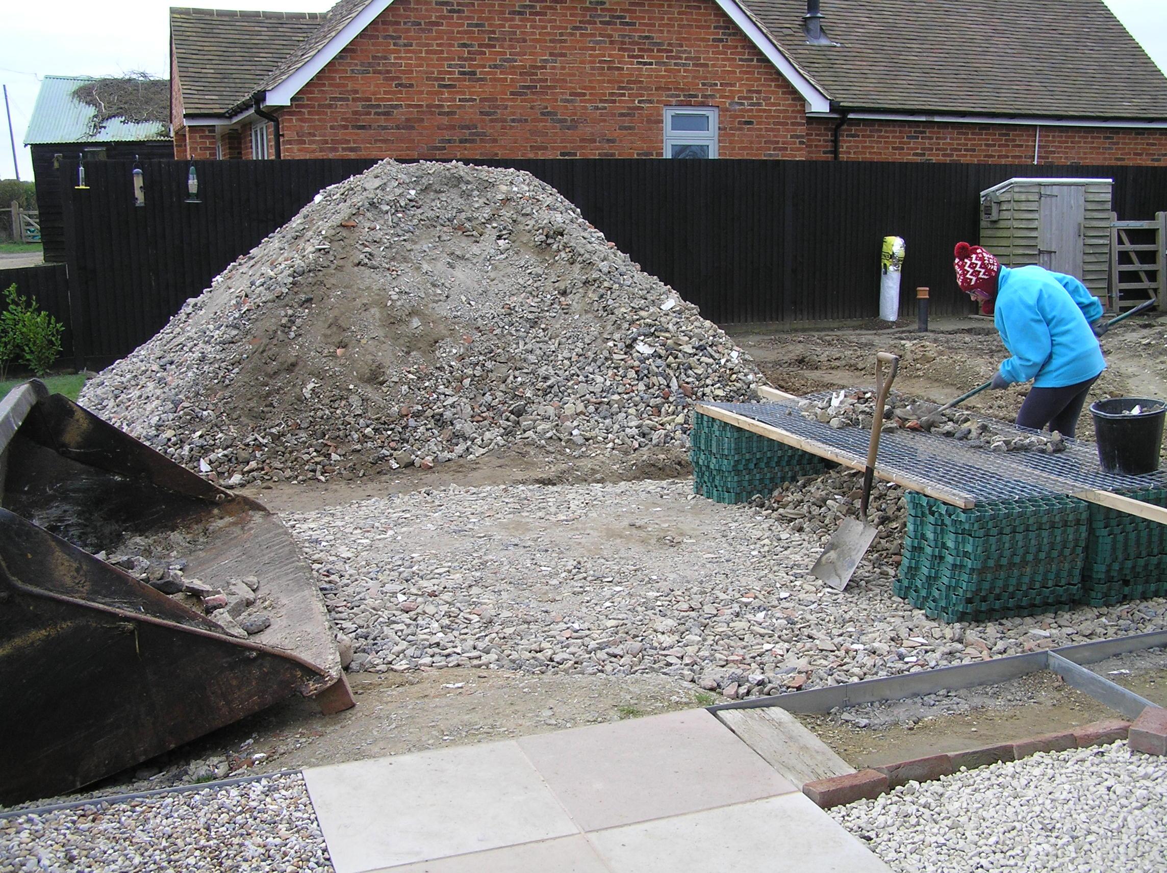

Gone West Posted February 20, 2019 Author Share Posted February 20, 2019 As an update, what we did in the end was as simple as possible, surprise, surprise. We bought some 2.4 x 1.2m 50mm mesh, laid it over some 50 x50mm timbers for support and riddled it by hand. We started in the middle of January and finished a few days ago. We have been doing it every day except when it rained and when there was a bitterly cold wind. I've been shovelling and Wendy riddling. All the larger than 50mm rubble we put in a telehandler bucket and the farmer took it. We started with around 40 tonnes and the farmer took around 11 tonnes. The only good things I can say about the process is that it has saved us a lot of money and kept us fit. 4 Link to comment Share on other sites More sharing options...
