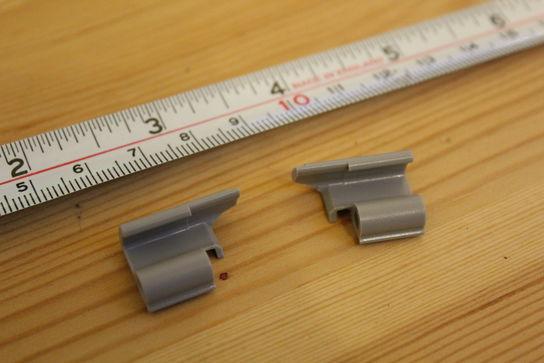

Ed Davies Posted December 19, 2018 Posted December 19, 2018 (edited) Today has not gone well, so far. Got first three Velux windows on Monday and opened the first one today. Have previously watched YouTube videos on installation and read instructions. All seems to make sense for the first parts, anyway. First job is to stand it up and separate the sash and the frame. Stand up. Remove white polystyrene packing bits, push handle bar into place. Doesn't click as convincingly as I'd expect, flops down with tongue of plastic free, couldn't get that to engage. Pull directly on lock mechanism, unlocks and swings open fine. Play with that a bit to see if plastic tongue could be engaged properly. Nope. In the process, break the pathetic bit of plastic I think it's supposed to engage on (pieces shown below). Oh well, implausible I can get that sorted before next year but we can live without for now. Pop polystyrene bits on top of sash and swing it down and get it on floor and frame more or less horizontal. Press buttons to release frame from sash. Nope, no click. Can't get them to budge at all. Careful look, doesn't seem to be any other possible buttons or anything. Press with tip of long nosed pliers in case chilly fingers aren't pushing enough. Still no click. While struggling with those manage to break a bit of the insulation in the top of the window. But that can be stuck back with appropriate glue, I hope. So, any tips on what I might be missing regarding pushing those buttons in? Edited December 19, 2018 by Ed Davies

Bitpipe Posted December 20, 2018 Posted December 20, 2018 I have a few power operated velux (top hung) - roofer installed. I recall some bit or other of plastic coming off on the clip when we were testing the power and our main window guy had some uber super glue that bonded it back on and never had any trouble since.
Ed Davies Posted December 21, 2018 Author Posted December 21, 2018 Thanks @Bitpipe , yes, gluing the bit of insulation I broke might well be the answer but I think I'll try Velux (next year) for the small parts at the top in the latching mechanism as the areas of the breaks are tiny for the amount of force involved. Yesterday I got the frame and sash separated OK. Don't know what the problem was the day before; maybe I just wasn't pushing quite hard enough on the buttons as they did need a fair amount of force.
