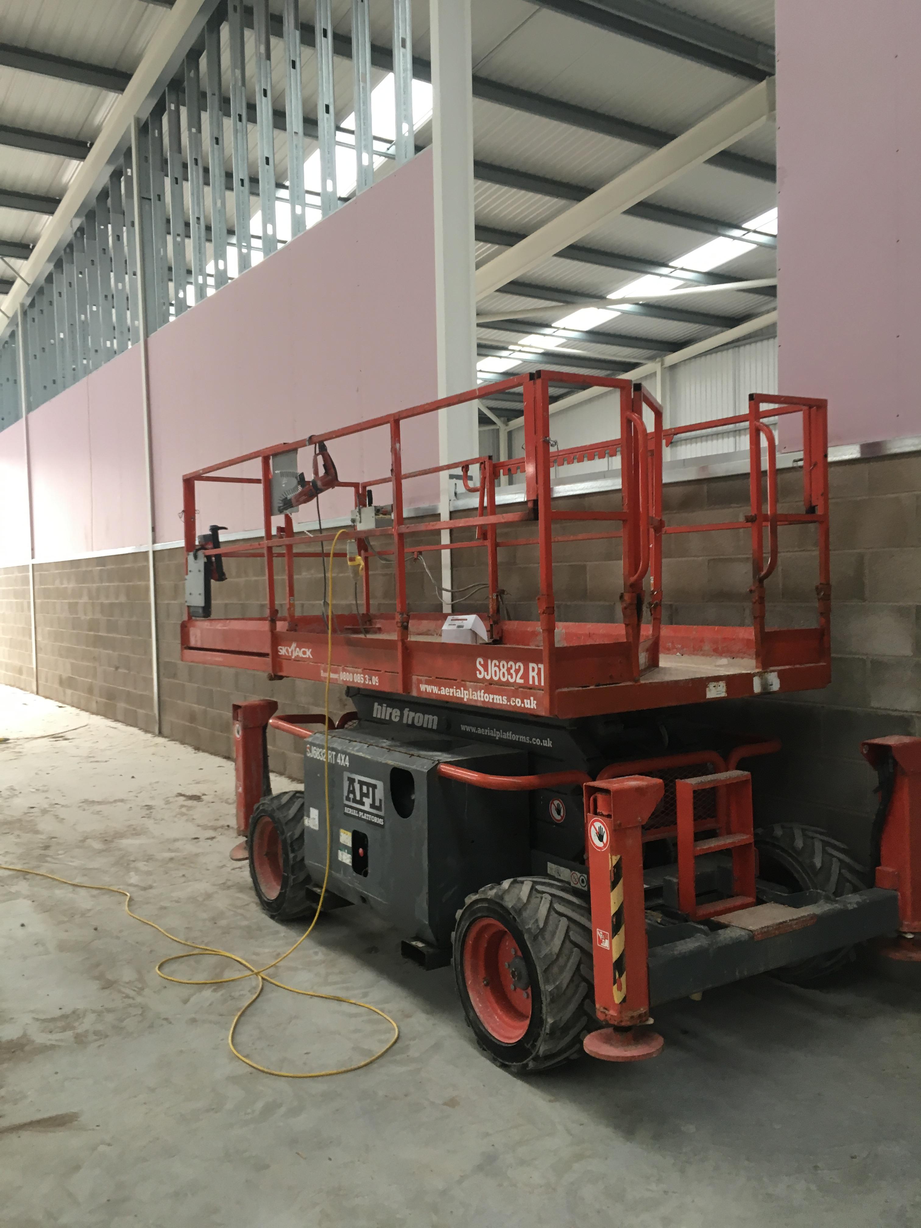

scottishjohn Posted December 5, 2018 Share Posted December 5, 2018 (edited) the gyproc jumbo 150 stud walling I had to use that to split a showroom up as i was making 3 units out of one big building for fire proofing as the units were different tennents the spec was one layer of 19mm plank dry wall followed by 2layer of fireline dry wall -- this was onboth sides of the stud frame work ,with a fire curtain hung in centre it is absolutly sound proof and the wall is 5m tall sloping down to 3.5 at other end . so yes if you want sound proof use jumbo studding and thick layers of plaster board . I was worried that it would not take the weight of all that plasterboard 19+30=49mm per side --thats alot of weight still there 10 years later and no cracks in skim coat Edited December 5, 2018 by scottishjohn Link to comment Share on other sites More sharing options...

scottishjohn Posted December 6, 2018 Share Posted December 6, 2018 joiners don,t like the thin webs for attaching too or thats what iwas told up here local builders merchant had never even heard of them I coud be using them in my own next house ,as the man says --they are straight and thats exactly how i split the workshop -- killer big solid blocks +butress up to 8ft then studding to roof couldn,t lift them any further .LOL and we don,t nice things like that platform to hire locally Link to comment Share on other sites More sharing options...
