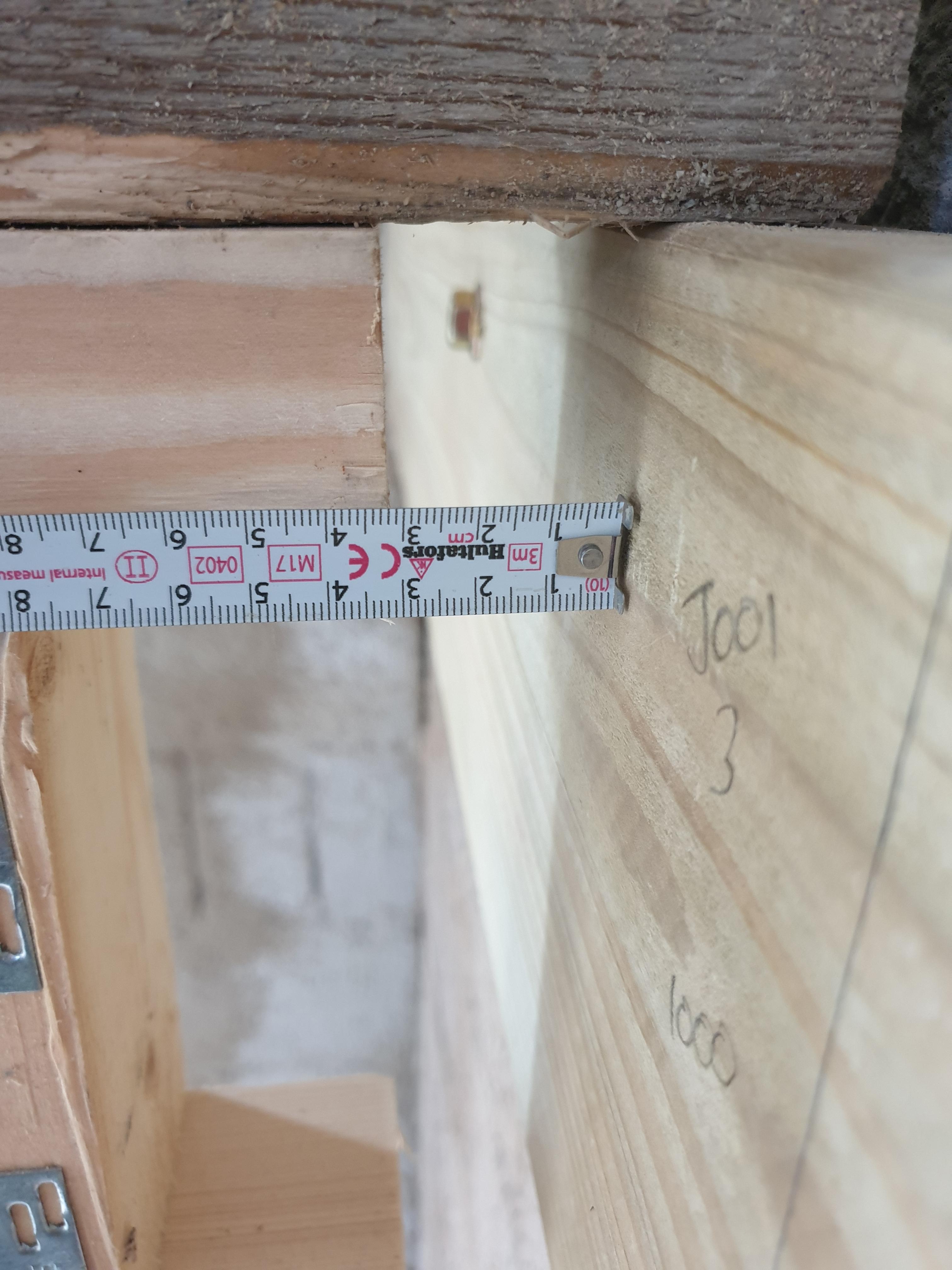

ToughButterCup Posted December 4, 2018 Author Posted December 4, 2018 17 hours ago, joe90 said: @recoveringacademic have you got a resolution yet? OK, here goes. Lengthening the joist as per the SE's (Cullen's own SE) is acceptable. Packing out the top and bottom chords is acceptable (BCO and Cullen's SE) And I had a really interesting discussion with the BCO yesterday. I made the point that the bottom of the joist hanger extends below the bottom of the wall plate. And that my learning from this discussion group is that a 'floating' bottom chord, even if nominally supported by a joist hanger is undesirable. He agreed. I said I would replace the wallplate with one which supports the bottom chord of the joist directly. OK it's a PITA, but that's all. Here's what really interests me: the BCO drew my attention to the tops of the UH hanger I mentioned that the designer told me that we are allowed to snap that top bit off if needed. The blurb here (page 49), (Cu Cullen technical Guide .pdf) talks about '... Elongated slots and unique snap off feature, allows for height adjustment and face fix only option...' And in the way of BCOs the world over, he asked for documentary evidence (sent) So, it seems likely that I'll replace the wallplates, pack out the ends as directed, and put the joists up. We agreed that I'd do a small section of one room and then ask the BCO to visit to see how I'm getting on. All in all, I think that between us, we have managed to pull my hand out of the fire. Photos to follow later this week. Ian

Mr Punter Posted December 4, 2018 Posted December 4, 2018 @recoveringacademic I just want to check that you are aware that the proposal from Cullen only allows an extra 25mm extension to each end of the joist - 50mm total. In your earlier posts on this topic you suggested that the joists were 100mm short.
ToughButterCup Posted December 4, 2018 Author Posted December 4, 2018 15 minutes ago, Mr Punter said: @recoveringacademic In your earlier posts on this topicyou suggested that the joists were 100mm short. Even I make mistakes... ? The errors seem to vary a bit between joists... Roughly 20 - 30 mm generally This photo was taken with the other end hard up against the joist on the other wall, so here the error is 15 or 16 mm. Thanks for watching my back. 1
