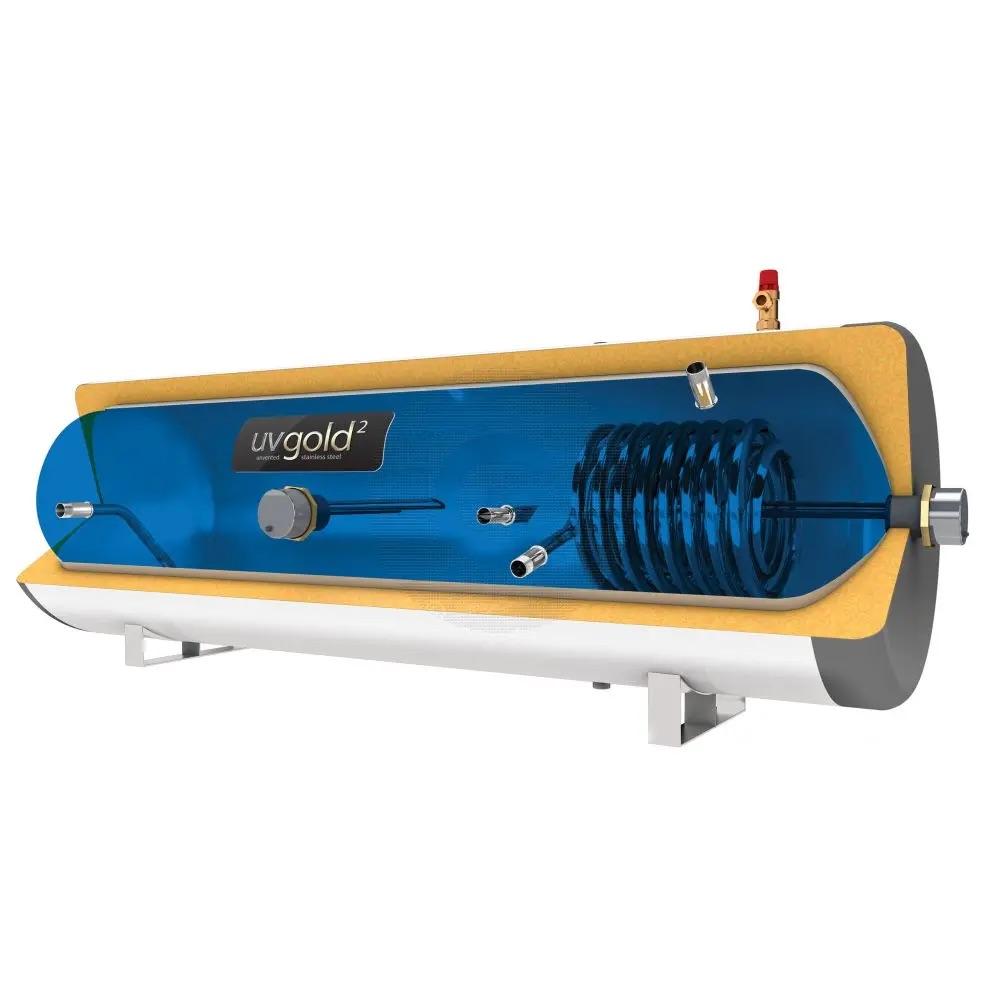

Gav_P Posted February 15, 2021 Author Posted February 15, 2021 (edited) I’ve got a duff immersion thermostat on my UVC. Just ordered a replacement, but it got me thinking about which immersion should be the primary. Normally it’s obvious in a vertical cylinder (lower one for whole tank heating, upper one for quick / small amount of hot water)... but I’ve no idea on a horizontal cylinder. Any suggestions? Here is a picture of it with locations (end and middle): Edited February 15, 2021 by Gav_P
Gav_P Posted February 15, 2021 Author Posted February 15, 2021 12 minutes ago, PeterW said: Which is the water out..?? Funnily enough the diagram doesn’t show it. It’s actually where the PRV is (and the PRV is nearer the middle), so straight out the top above the coil.
PeterW Posted February 15, 2021 Posted February 15, 2021 I’d have the boost one as the one through the coil then. What length is the immersion ..? 1

Gav_P Posted February 15, 2021 Author Posted February 15, 2021 (edited) 1 hour ago, PeterW said: I’d have the boost one as the one through the coil then. What length is the immersion ..? Both 11” Currently the other way round... I think I’ll swap them over then. Edited February 15, 2021 by Gav_P
