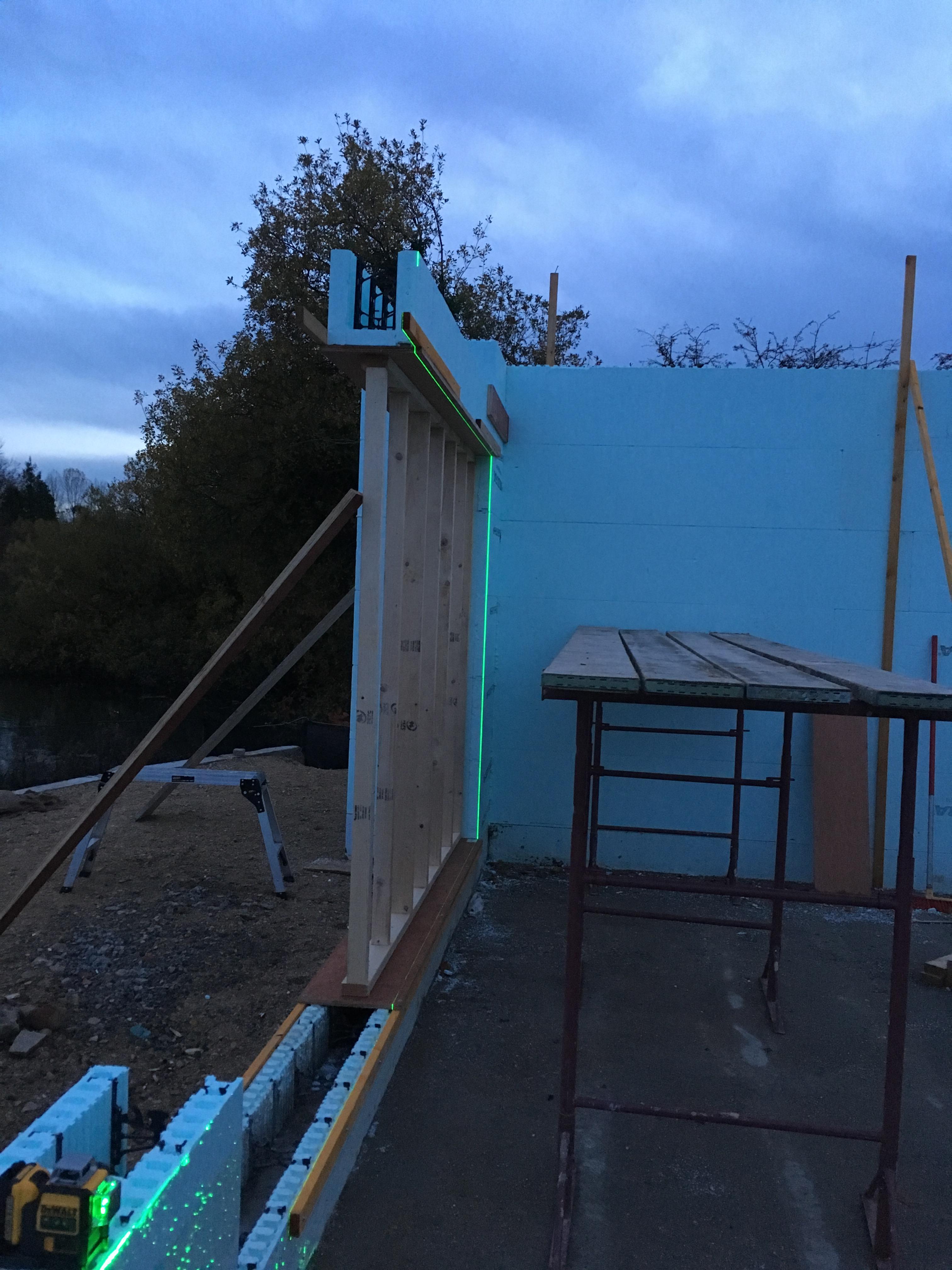

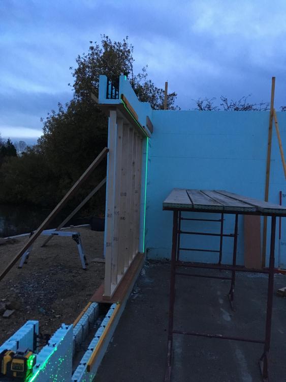

Russell griffiths Posted November 9, 2018 Posted November 9, 2018 First pour was only 450mm high. It seems the vents that collapsed where the telescopic sections, as one piece slots inside another you get an overlap, it was this overlap that allowed concrete slurry to push up from the bottom and enter the hollow tube, if i wa doing it again I would get some thin xps sheet and clad the vents to seal them up and add extra strength. This is what I was up to today.

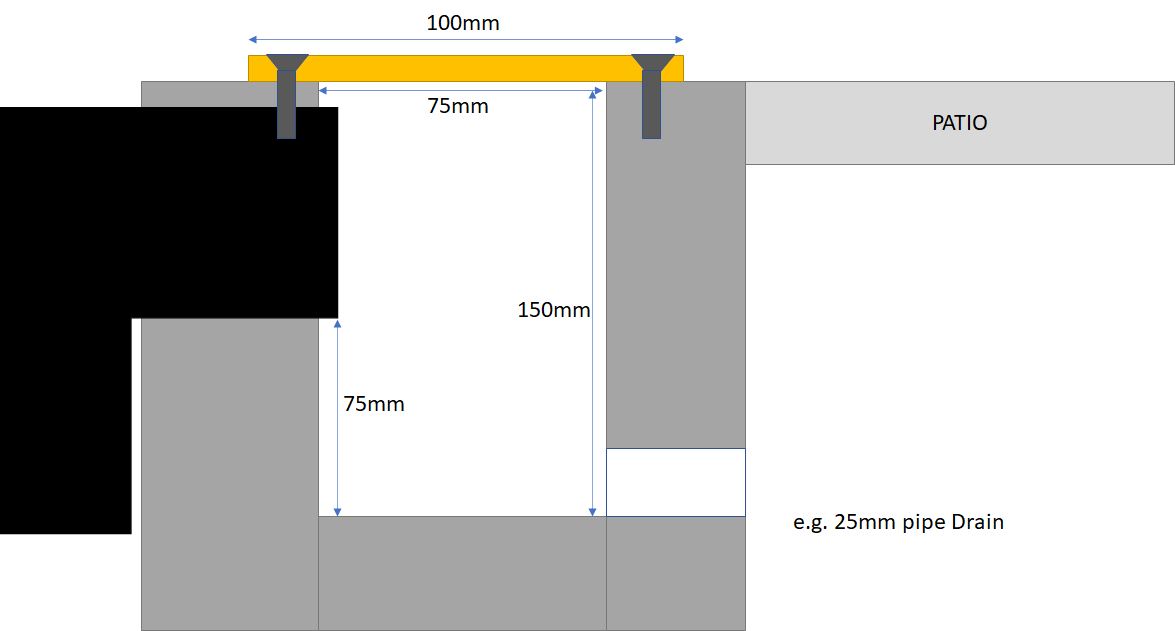

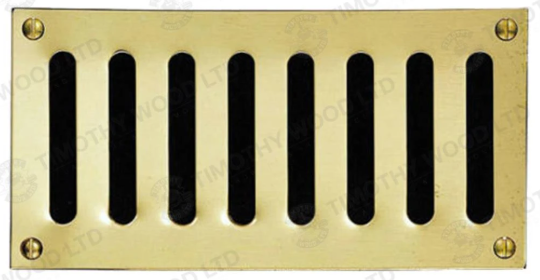

MortarThePoint Posted May 21, 2020 Posted May 21, 2020 (edited) Not sure what the correct forum protocol is here (new thread or use old one) but I am facing a similar issue. Is it not possible to have the vent sunk down in a box with a horizontal grate over the top as long as the box can drain? Obviously it would be a problem if the drain pipe blocked and the top was open to rain. We are working out how to get vents in to our porch whilst having level access. The porch has a roof. I'd like to keep the ability to have a level patio at the back too don the line. There are lots of vents along that elevation so... There'd be mesh under the brass vent plate shown screwed over the box. Edited May 21, 2020 by MortarThePoint
