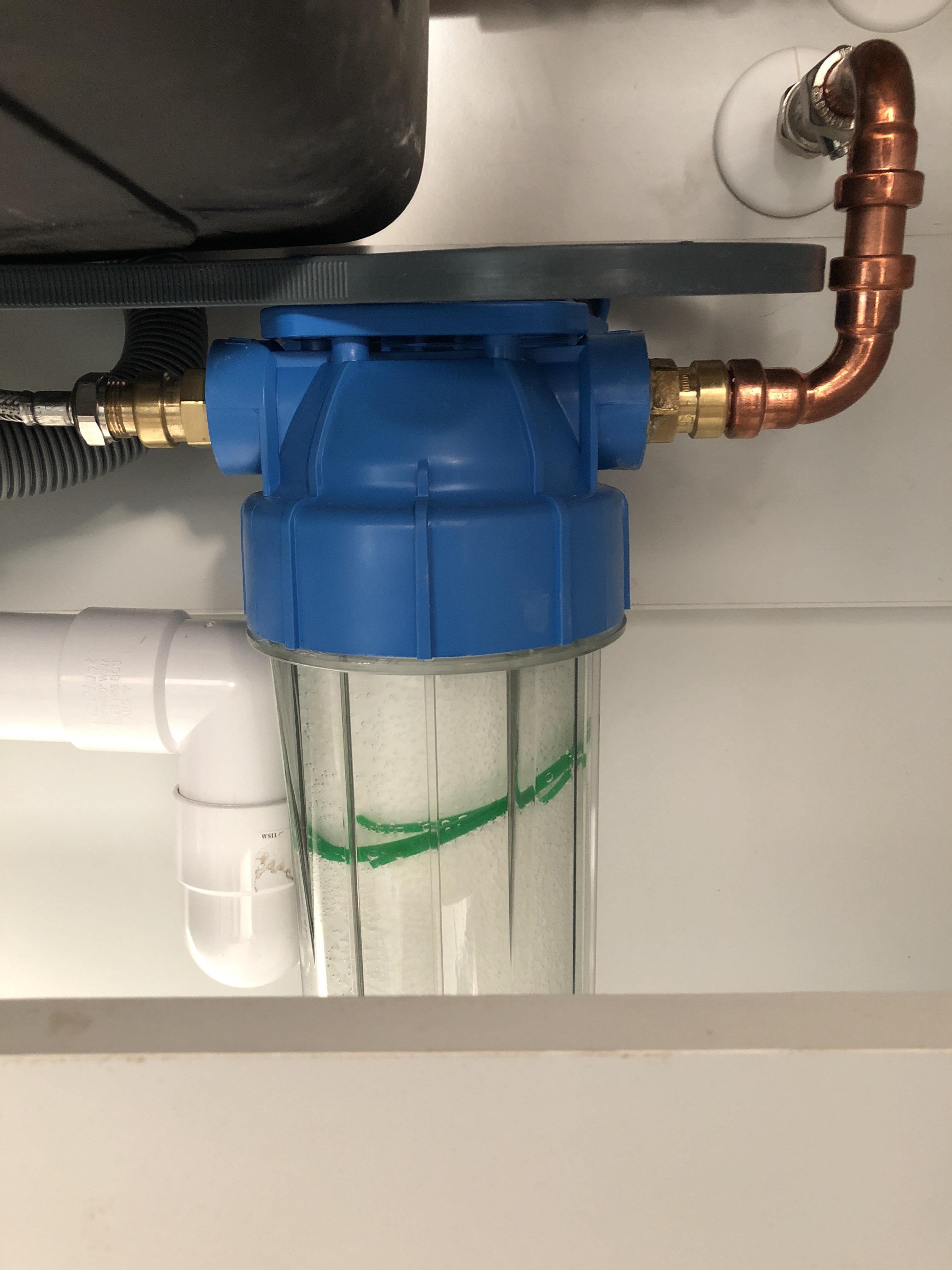

PeterW Posted November 9, 2018 Posted November 9, 2018 If you’ve not already bought it or fitted it then don’t bother - I took one back as it was rubbish. Replaced it with this and a pair of standard 1/2” to 15mm Tectite push fits for less than £20.

PeterW Posted November 12, 2018 Posted November 12, 2018 On 11/11/2018 at 21:51, daiking said: No I haven't yet, I had looked at some only options from water filter 'specialists' but will give that eBay listing a once over. I hope you can appreciate that to the untrained eye there is very difference between those products and buying blind off eBay by a laymen often ends in less than success as well. Expand Try this - pipework in copper / Tectite at client request. Units are well made, Tectite male 1/2” connectors are wound with 2 wraps PTFE as this is brass into HDPE so can sometimes bite a little as the thread pulls in. Look to be machined threads in the HDPE head rather than moulded so they are better tolerance. Came with a 5 micron wound filter that will be replaced with a carbon block after commissioning. Dynamic balanced 3 bar across the build, no discernible difference in flow between hot and cold (hot unfiltered) They do them in 1/2”, 3/4” and 1” but the limiting factor is the flow rate through the filter itself so anything above 1/2” isn’t really necessary if it’s feeding a single tap.
