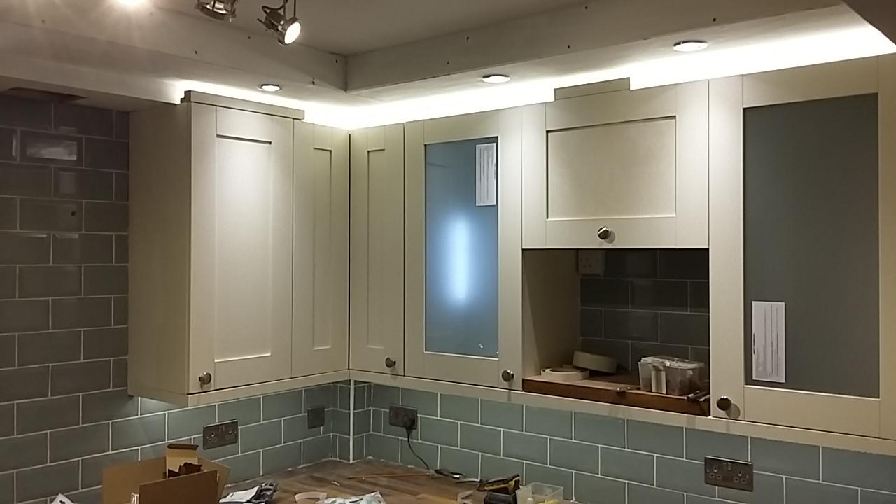

I'm currently halfway through doing this job with a 2.4m celing with 120mm + 60mm drop from the celing
I will get some photos and post my thoughts later for a bit more detail. It's a bit chilly on site to draw stuff today.

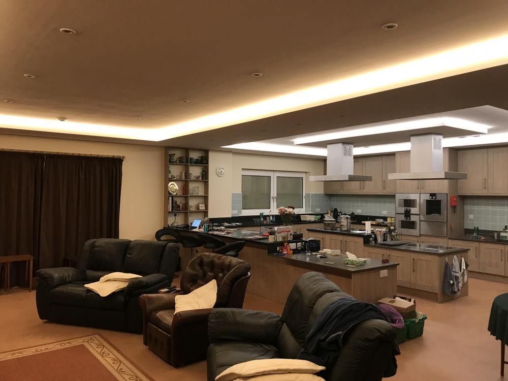

GF-Plan.pdfGF-Plan.pdfWe have a 150mm reveal in the lounge/kitchen/diner, picture of kitchen from lounge.
2900mm floor to higher parts, 2750mm to lower parts apart from kitchen island which is raised by 50mm to lift the extractors.  SO a 150mm drop.

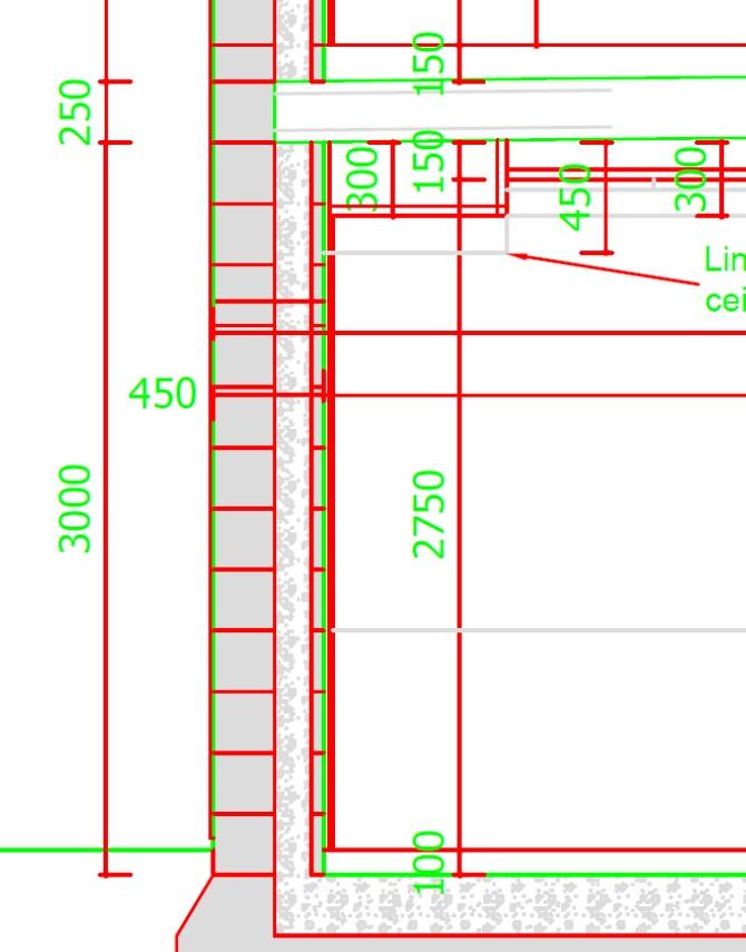

I also have a 150mm service void above the ceiling.  (here is the build up).
250mm pre-stressed concrete first floor (large span).  The lower dropped ceiling is in the hall where the Ground floor MVHR manifolds are.

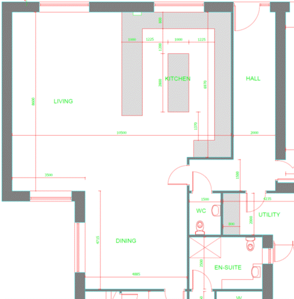

The room is 10m by 8m plus the dining room, see plan.
The lighting in the kitchen is 3000K, whilst in the lounge 2700K, giving bright working light in the kitchen and softer light in the lounge.
