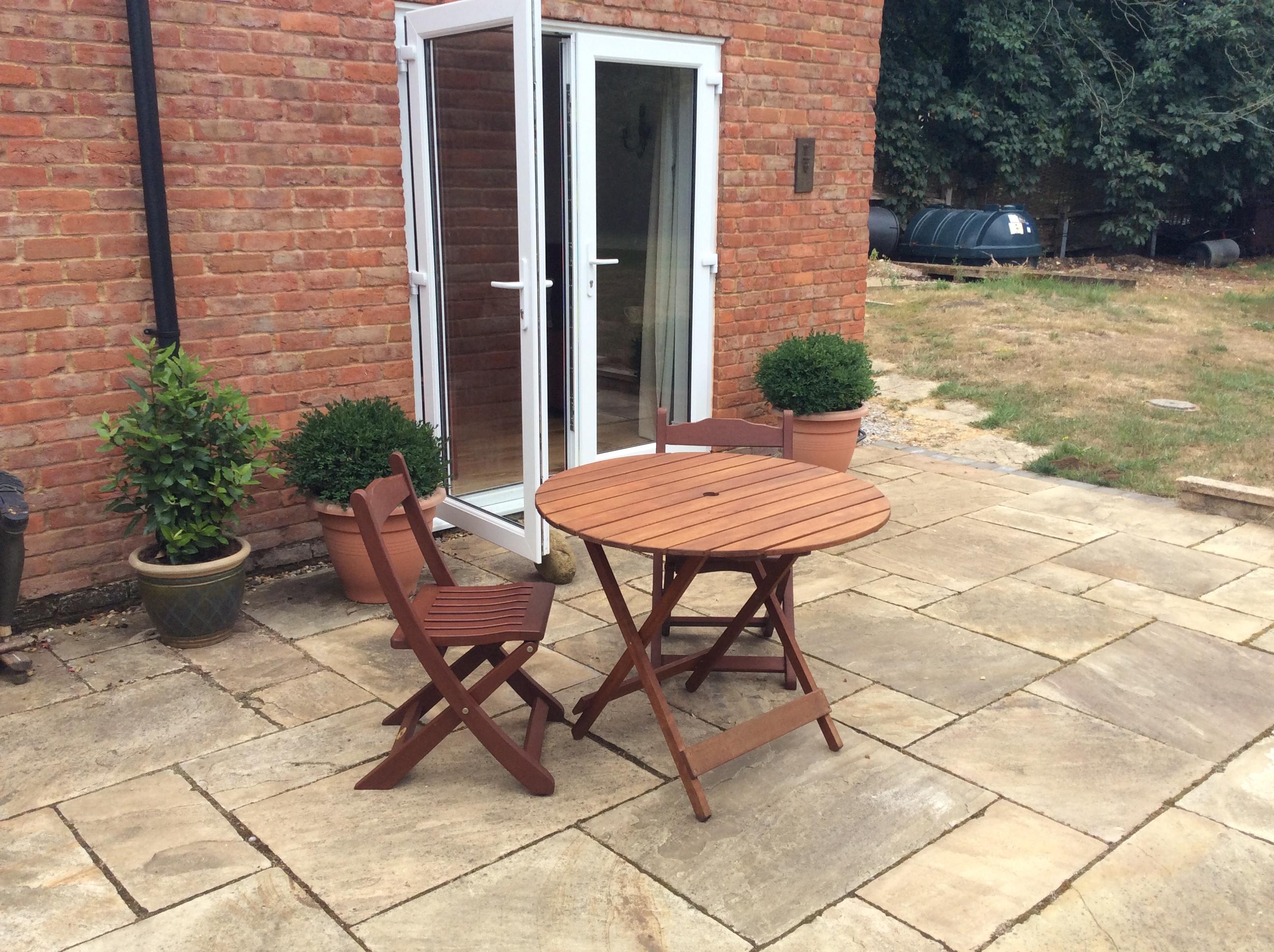

Roger440 Posted October 28, 2018 Posted October 28, 2018 Well, chaps and chapesses, been a while since i was here, but i have a question, The back wall of my house way clearly very wet upto the DPC. Investigation releaved that the patio had been laid with a slight fall to the wall, and being natural stone was layed on a bed of motar or similar. Nowhere for the water go, so end result unsurprising really. The patio was one brick below the DPC. Having dug all this out, its starting to dry out nicely. However, once the sewage treatment plant and rain water soakaway are installed, i need to re-instate a patio. Obviously it needs to slope away from the house, but that really raises it up a touch. Dont reallywant to lower the whole patio, its big! Traditionally, the paving was supposed to be "2 bricks below the DPC". Clearly the requirement for level thresholds means that cant be achieved Ive been looking at the various detail drawings for the thresholds, but whatever system is used, does the wall ABOVE the DPC not get wet? I thought the 2 brick idea was to counteract rain bouncing / splashing the wall? Plenty of you guys must have level thresholds, so is you wall OK? The wall inquestion is west facing, so gets all the weather. Thoughts?

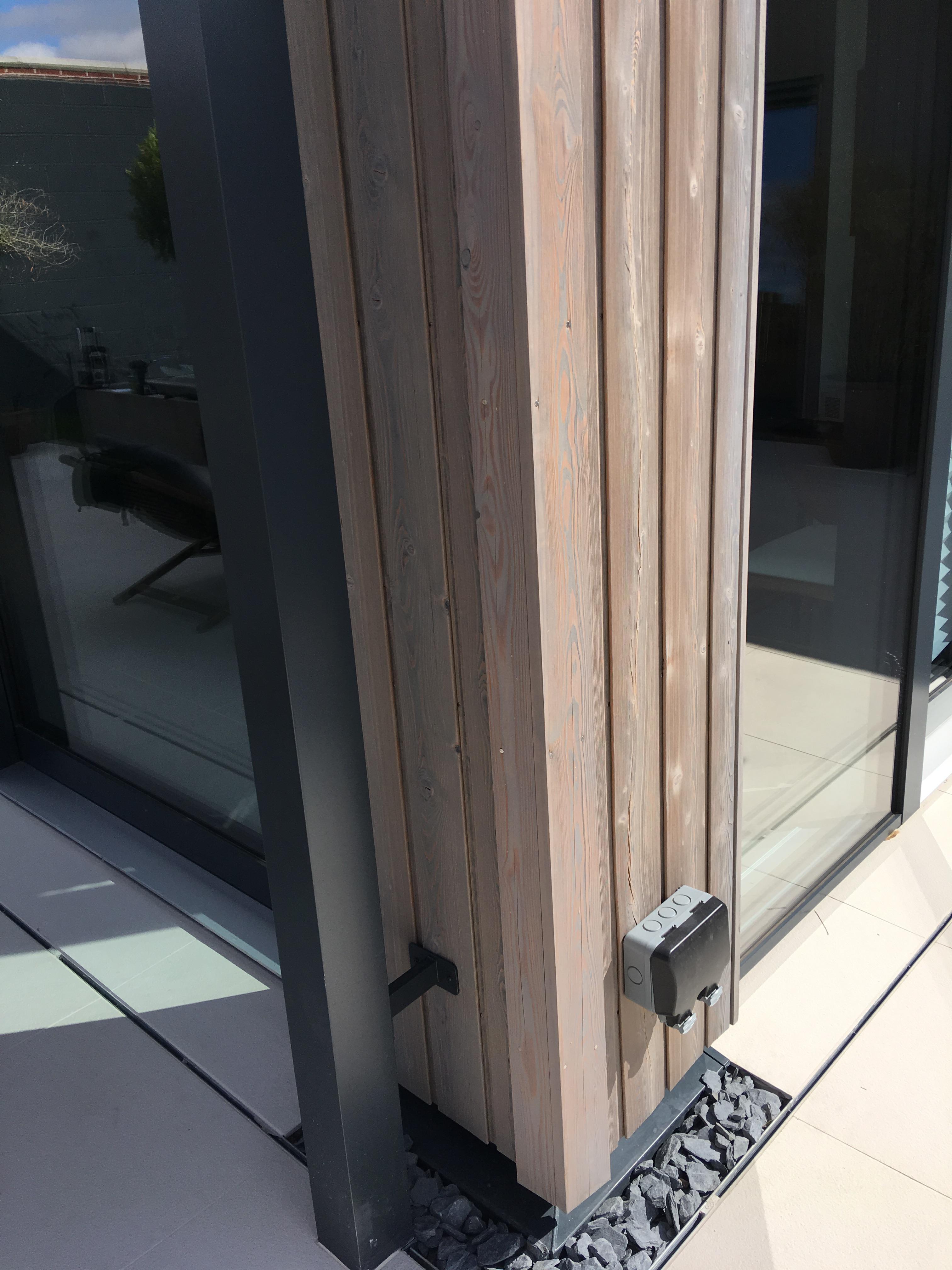

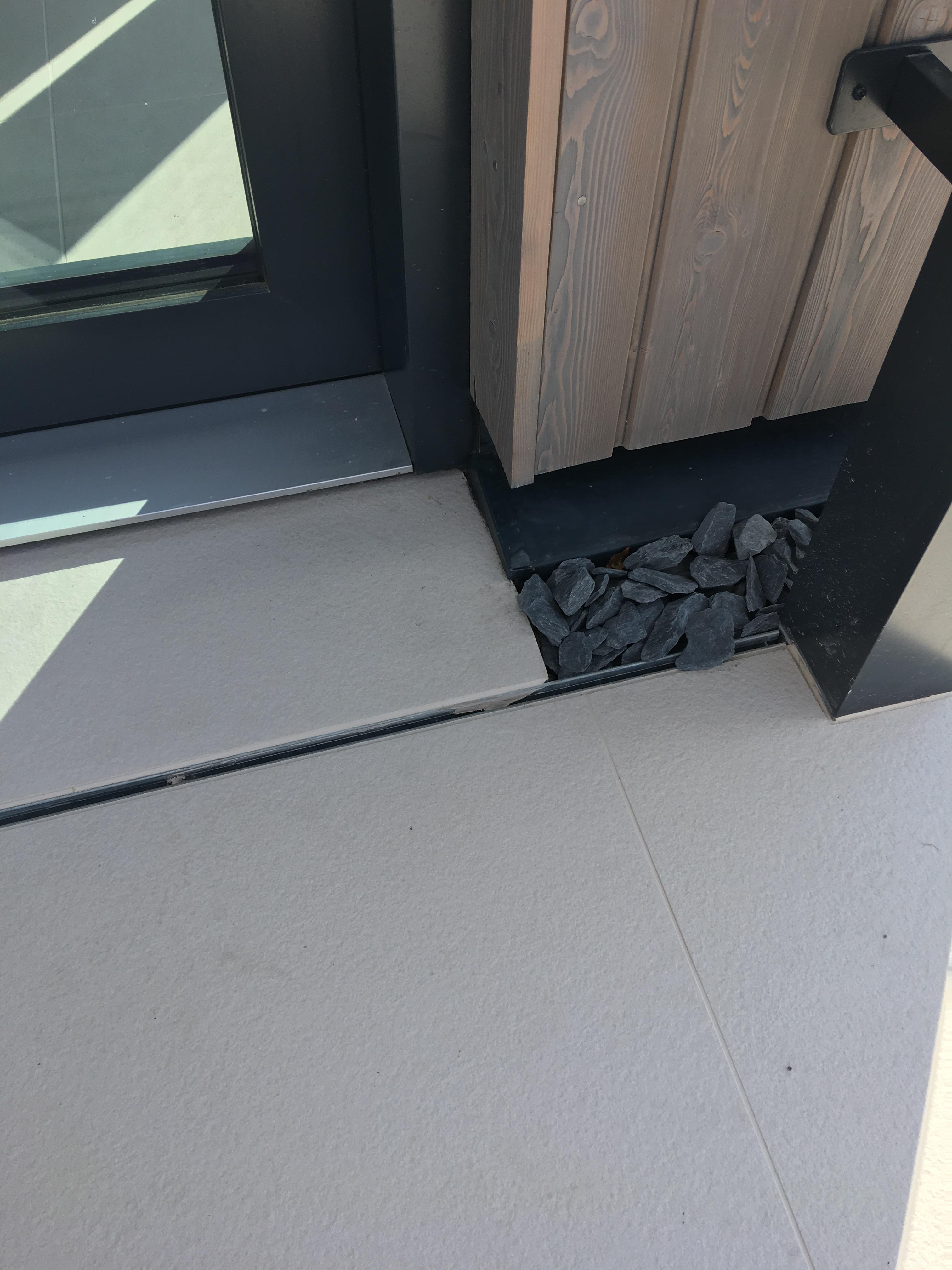

lizzie Posted October 28, 2018 Posted October 28, 2018 Ive got a french drain and gravel topped with decorative slate. In front of that I have a slot drain, that does the level threshold area where I not have gravel as I wanted my tile to run up to threshold. Slot drain runs right around the patio perimeter 2

Roger440 Posted October 28, 2018 Author Posted October 28, 2018 2 minutes ago, lizzie said: Ive got a french drain and gravel topped with decorative slate. In front of that I have a slot drain, that does the level threshold area where I not have gravel as I wanted my tile to run up to threshold. Slot drain runs right around the patio perimeter Thanks Lizzie. But as per my post above, does the bottom of your cladding not get soaked in heavy rain from the water splashing back onto it? Looks very nice though
lizzie Posted October 28, 2018 Posted October 28, 2018 3 minutes ago, Roger440 said: Thanks Lizzie. But as per my post above, does the bottom of your cladding not get soaked in heavy rain from the water splashing back onto it? Looks very nice though No the cladding is above the ground level by a few inches and it is set back behind the french drain, we have an aluminium trim around the eps then the cladding is above that.

Jeremy Harris Posted October 28, 2018 Posted October 28, 2018 We got around the water splash problem by fitting 200mm high black uPVC around the bottom of our cladding. Seems to work well. I didn't bother to do this for the garage cladding and as a consequence the bottom of the larch cladding on the garage is looking a bit manky.

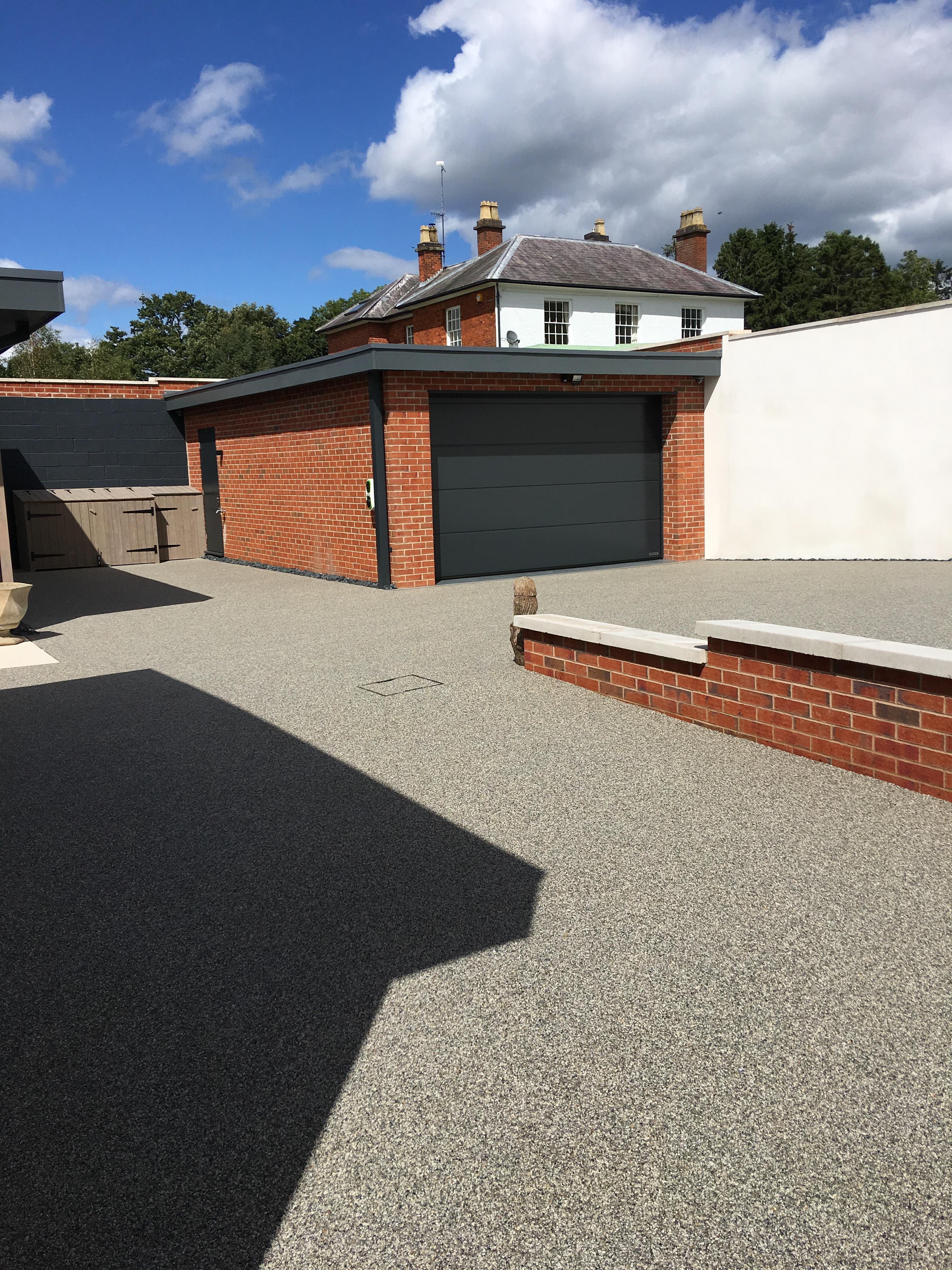

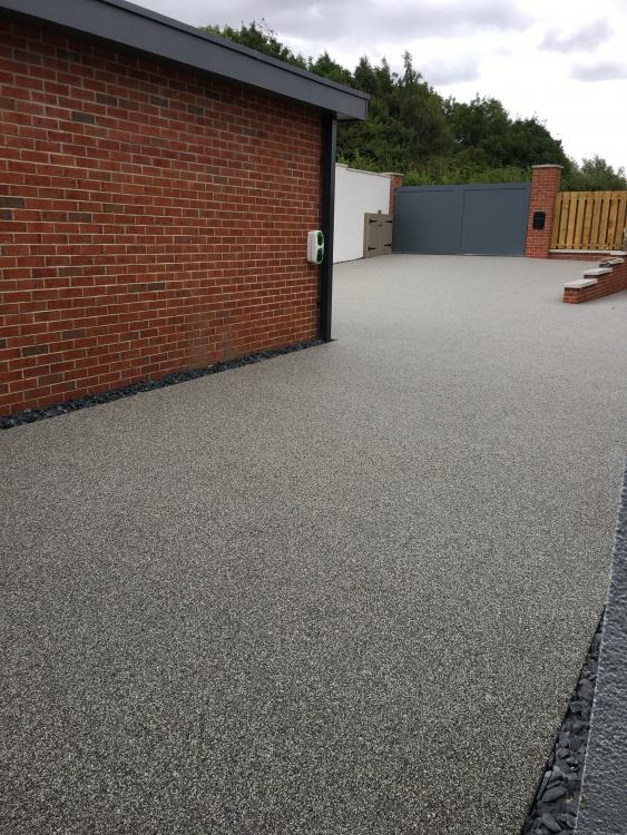

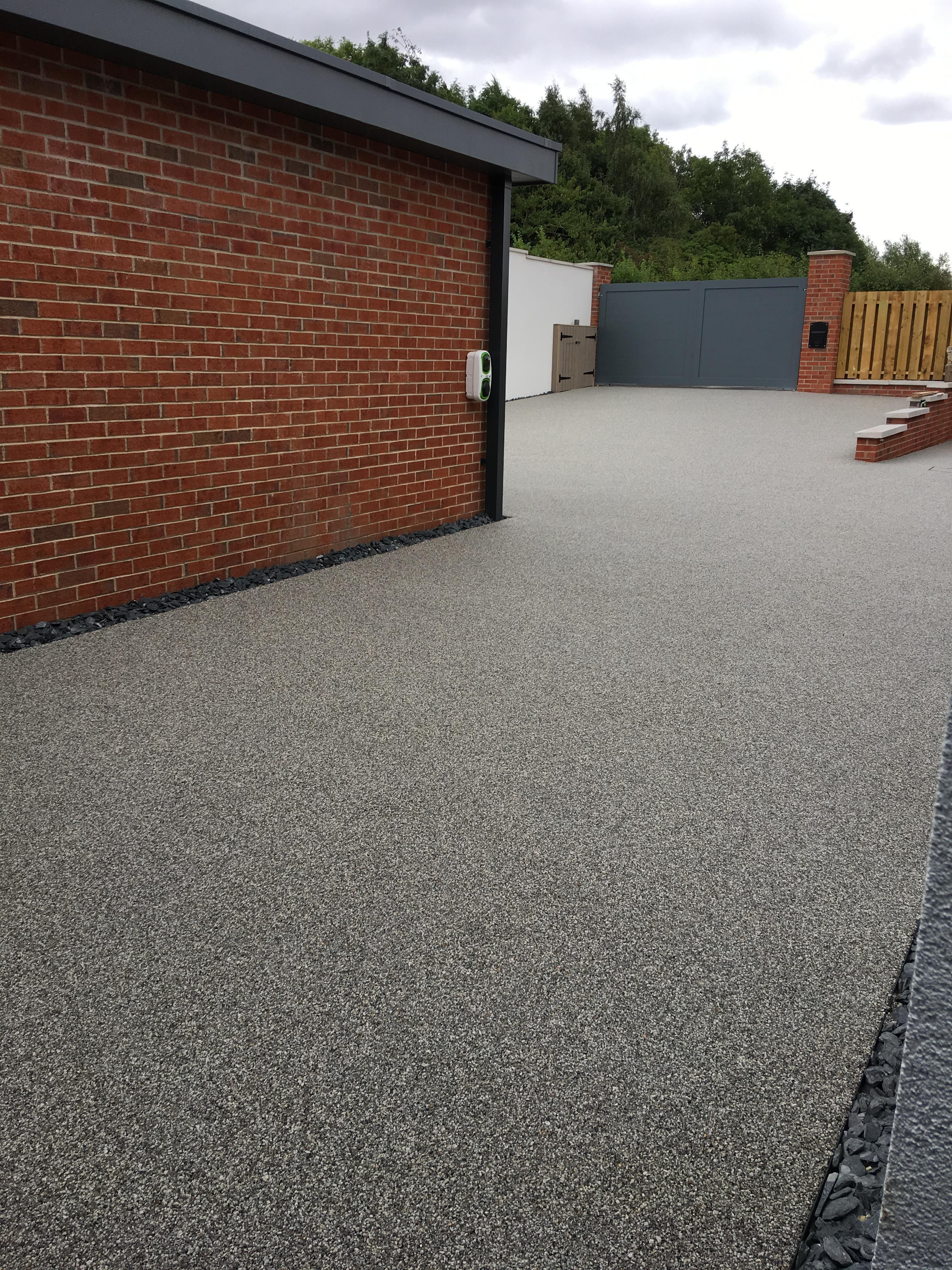

lizzie Posted October 28, 2018 Posted October 28, 2018 My garage is all brick no cladding. We have the same french drain with gravel/slate as around the house that sits against the brick below dpc level. In front of door we have an aco drain similar to the one suggested earlier by redocober, its a slope down to the garage so we need to stop water running in. It works well no issues at all and we have a resin drive. Sorry have not got a close up pic to hand.

Roger440 Posted October 28, 2018 Author Posted October 28, 2018 1 minute ago, lizzie said: My garage is all brick no cladding. We have the same french drain with gravel/slate as around the house that sits against the brick below dpc level. In front of door we have an aco drain similar to the one suggested earlier by redocober, its a slope down to the garage so we need to stop water running in. It works well no issues at all and we have a resin drive. Sorry have not got a close up pic to hand. Exceptional How old is it though. Looks brand spanking new?
lizzie Posted October 28, 2018 Posted October 28, 2018 1 minute ago, Roger440 said: Exceptional How old is it though. Looks brand spanking new? It is brand new! I think same principal would work work with old bricks though our french drain is about 70 wide which is enough to cope with any splashing. Our bricks are not getting wet down there.
Roger440 Posted October 28, 2018 Author Posted October 28, 2018 2 minutes ago, lizzie said: It is brand new! I think same principal would work work with old bricks though our french drain is about 70 wide which is enough to cope with any splashing. Our bricks are not getting wet down there. You have a decent overhang there too, which will definitely help, but i hope your right. Will be really interesting to see it in a couple of years time. My wall is the gable end, overhang is an inch at best, and west facing, so worst combination possible. The pic below shows just how bad it got, though that laregly as a result of it puddling against the way, but the bricks are so soft it just wicks up the wall.

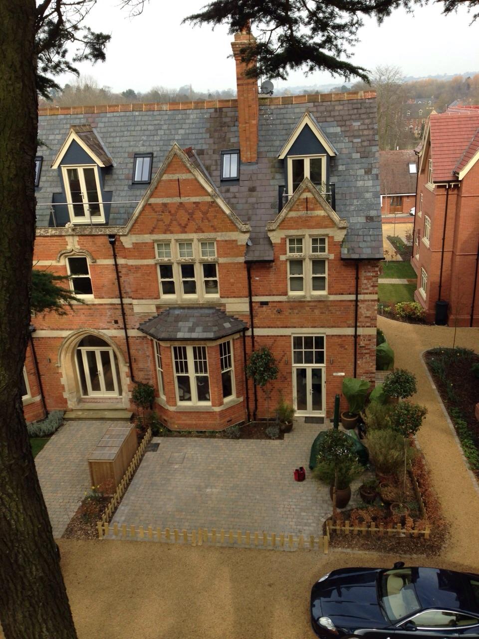

lizzie Posted October 28, 2018 Posted October 28, 2018 You could try a slightly different approach. I have a townhouse part of a Victorian school conversion. Suspended timber floor and no modern damp course. Conservation officer was a tyrant with the developer on the build.....Munster joinery did the windows its on their web site. To solve the problem of drainage/splashing around the walls which are porous old bricks they put in a french drain but left it open. It is deep maybe a foot deep with just an inch or so of gravel in the bottom. It is faced with slate on the inner side of the earth trench wall and slate against the brick side too to protect the old brick but still let it breathe. This big trench takes all the water and it goes away and because it is so deep there is no splashing. It was specificaly designed to prevent splashback against the walls. There is a shallow border for plants all around to make it safe from falling in and hide it a bit. There is no garden as such its all paved . At thresholds they essentially created a bridge, a sort of small culvert type thing so there was a level threshold with paving right up to the threshold and under it the french drain. There is no problem at all with damp on the walls or drainage it works. I cant find a close up but if you zoom in you may be able to see what I mean, Im not great at explaining it.
Roger440 Posted October 28, 2018 Author Posted October 28, 2018 41 minutes ago, lizzie said: You could try a slightly different approach. I have a townhouse part of a Victorian school conversion. Suspended timber floor and no modern damp course. Conservation officer was a tyrant with the developer on the build.....Munster joinery did the windows its on their web site. To solve the problem of drainage/splashing around the walls which are porous old bricks they put in a french drain but left it open. It is deep maybe a foot deep with just an inch or so of gravel in the bottom. It is faced with slate on the inner side of the earth trench wall and slate against the brick side too to protect the old brick but still let it breathe. This big trench takes all the water and it goes away and because it is so deep there is no splashing. It was specificaly designed to prevent splashback against the walls. There is a shallow border for plants all around to make it safe from falling in and hide it a bit. There is no garden as such its all paved . At thresholds they essentially created a bridge, a sort of small culvert type thing so there was a level threshold with paving right up to the threshold and under it the french drain. There is no problem at all with damp on the walls or drainage it works. I cant find a close up but if you zoom in you may be able to see what I mean, Im not great at explaining it. Thanks for the info. I understand what you are saying. The front half of the house is 200 years old and im doing similar to you there. Logically i can do the same at the back. Just need a way to soften the visual impact of a big trench! Plants. My wife will be impressed. I like the open space idea, she wants plants everywhere! 1
