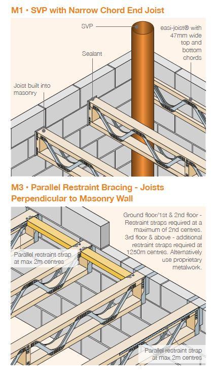

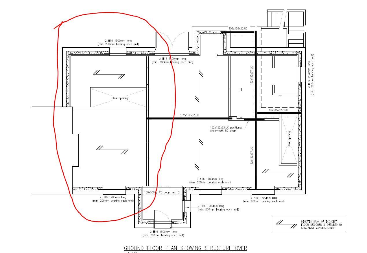

willbish Posted October 28, 2018 Posted October 28, 2018 Wondering on the collective opinion, what is the better way to support posi-joists on internal blockwork walls?  The two options, as far as I can see -Bear the bottom chord directly on the block work or -Use a JHM type hanger  Any structural advantages to either method? Will be trying to minimise any movement/deflection  Bearing directly onto the block work is easier and cheaper and length of joists less critical Using hangers feels the more superior way to do it but I'm not sure why!  Just to add the block work walls will continue up another story so there will be plenty of weight bearing down
Russell griffiths Posted October 28, 2018 Posted October 28, 2018 I would say built in as well the only down side is the length of joist, will you be able to handle a full length that goes from outer wall to outer wall will it be too heavy or lack of space to manage  our roof timbers are 11m but only weighs 45kg. Little things to think about.Â
joe90 Posted October 28, 2018 Posted October 28, 2018 Ours were built in, this allowed the joists to be a little over length and overlap each other but enabled them to be âtightâ into the hangers on the outside walls.
willbish Posted October 28, 2018 Author Posted October 28, 2018 3 minutes ago, Russell griffiths said: I would say built in as well the only down side is the length of joist, will you be able to handle a full length that goes from outer wall to outer wall The internal block walls are not intermediary supports. They are supporting the ends of the joists
Mr Punter Posted October 28, 2018 Posted October 28, 2018 OK. Make sure you specify the max deflection  must not exceed 8mm or 0.002 x span. The standard is 12mm which can feel a bit bouncy.  2 stairs? 2
willbish Posted October 28, 2018 Author Posted October 28, 2018 @Mr Punter thanks will do  Yep 2 stairs. Set to the right services bedroom with full height vaulted ceiling only. Rest of the property is under a different pitch roof that has to be a bat roost. ?
