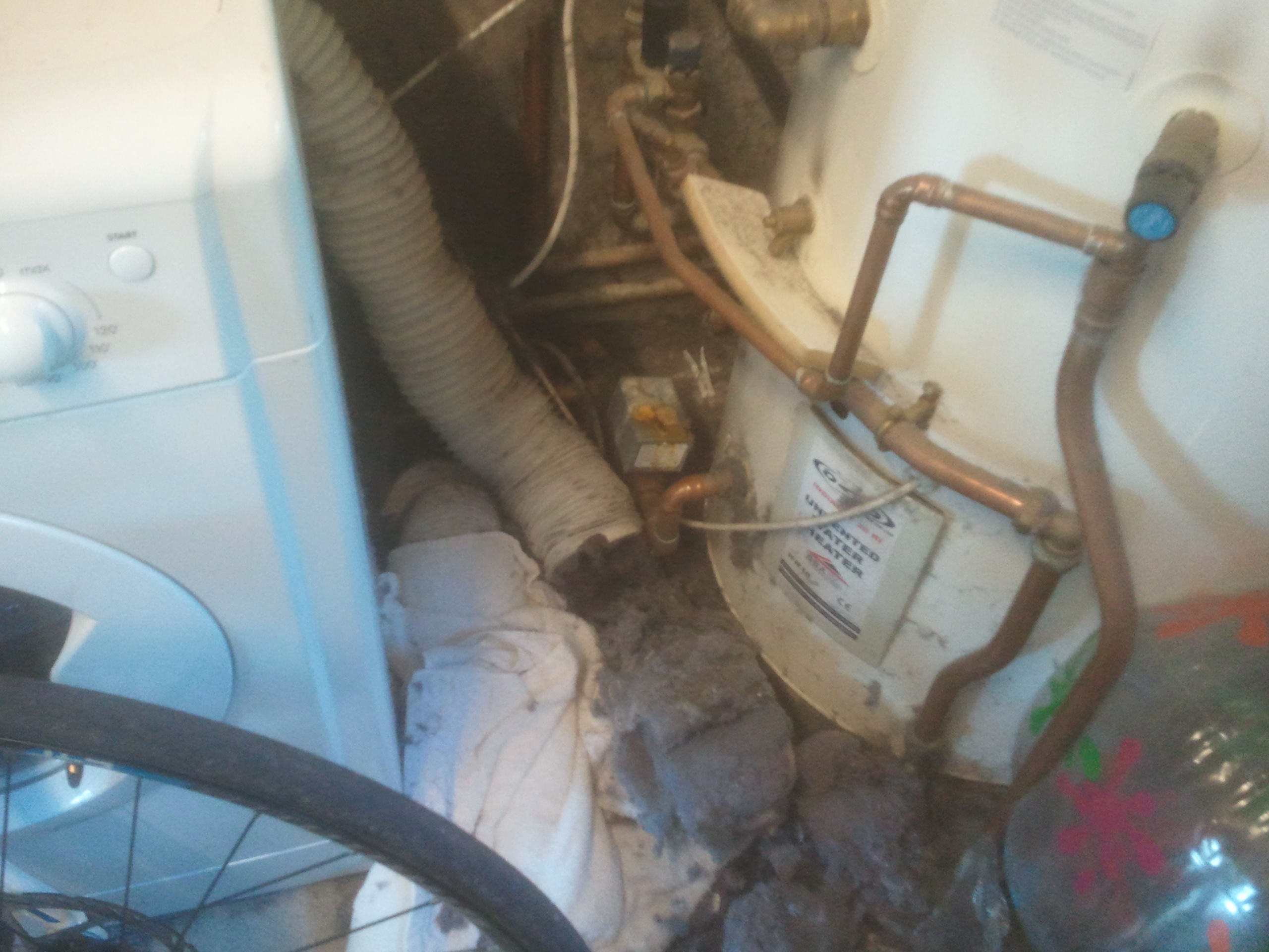

ProDave Posted July 28, 2016 Posted July 28, 2016 Sometimes I see things in my line of work that astound me. This being one of them. What you are seeing there is the vent hose of a tumble dryer just lying on the garage floor. That's a solid mass of dry fluff eminating from the hose across the garage floor. I would expect most of the hose itself to be similarly full of fluff. If it had caught fire, no doubt a manufacturing fault would have been blamed and there would be calls for the manufacturer to recall the product. Just how people can live like this astounds me. I wonder what the landlord would think if his house had burned down through the neglect of the tenant and what would have been a 100% avoidable accident?
Nickfromwales Posted July 28, 2016 Posted July 28, 2016 Yup, looks like an accident waiting to happen. Im particularly fond of the incorrect plumbing of the PRV on the multiblock of the UVC. It comes along to the front t&prv and goes up 10" or so before teeing in above the home made tundish. Whoever signed off that UVC for G3 isn't much of a worrier. Non tres bien.
ToughButterCup Posted July 29, 2016 Posted July 29, 2016 7 hours ago, Nickfromwales said: plumbing of the PRV on the multiblock of the UVC. It comes along to the front t&prv and goes up 10" or so before teeing in above the home made tundish. Whoever signed off that UVC for G3 isn't much of a worrier. And they say that sometimes I'm too fond of talkin' tech.... I'll get my coat. 1
ProDave Posted July 29, 2016 Author Posted July 29, 2016 I hadn't spotted the plumbing fail. So it's a double fail photo, two for the price of one. you get value on this forum. 1
