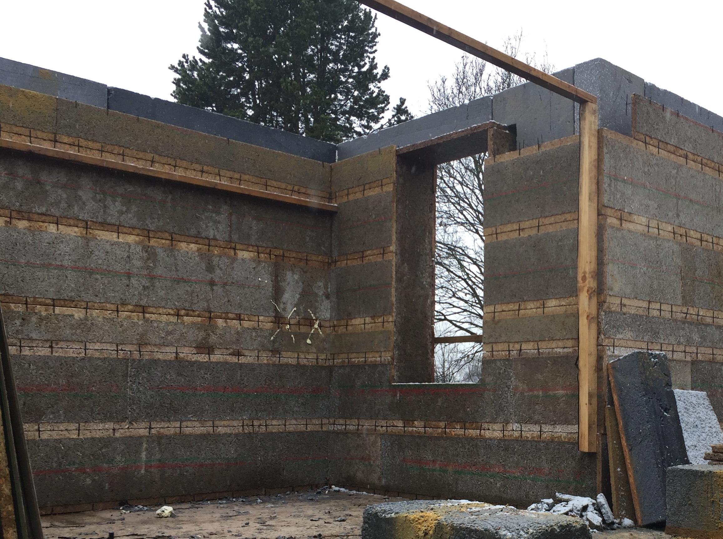

Humpty Dumpty Posted February 13, 2019 Share Posted February 13, 2019 Hi Tom have you made any progress? I used velox. Not the easiest to build with. It’s heavy and difficult to align/level and if your not very careful as you go up vertical (and horizontal) alignment can also fall out of line. It needs shoring up and bracing properly to ensure no blow outs and you need your wits about you. But you do end up with a very solid dense structure. Not for the faint hearted. Easy enough to cut with a decent circular saw. Get yourself a festool, loads of spare blades and a guide rail. A decent level and loads of decent timber for shoring up and a few hundred acrrows and a hell of a lot of decent screws. I literally got through several thousand. That’s all you need ..... and several 100 tons of concrete. I quite liked the look of Sismo which was another method I thought about and nearly went with. Would be quicker, easier and cheaper. Still not sure if I made the right choice......... perhaps maybe just?? Link to comment Share on other sites More sharing options...

Humpty Dumpty Posted February 13, 2019 Share Posted February 13, 2019 It was a toss up. Was a solo self build. Something to keep me out of mischief at weekends. I though velox was easier but don’t think it turned out that way. Had Sismo quoted to include assembly and pour (they do that option as do velox) inc materials and build from memory Simso was circa. 65/70k ..... all in of which assembly was circa 25/30k and you get 3D scale drawings etc.... velox quoted 50k to assemble and build and mats cost me circa 70k. There’s a trade off as I still feel Sismo isn’t as good.... terms of insulation. I also thought about using metal shuttering laid to insulation slabs to exterior pre plugged to affix to concrete prior to pour and think that would have been as quick as Simso and cheaper than both build systems. The figures above don’t include concrete Link to comment Share on other sites More sharing options...

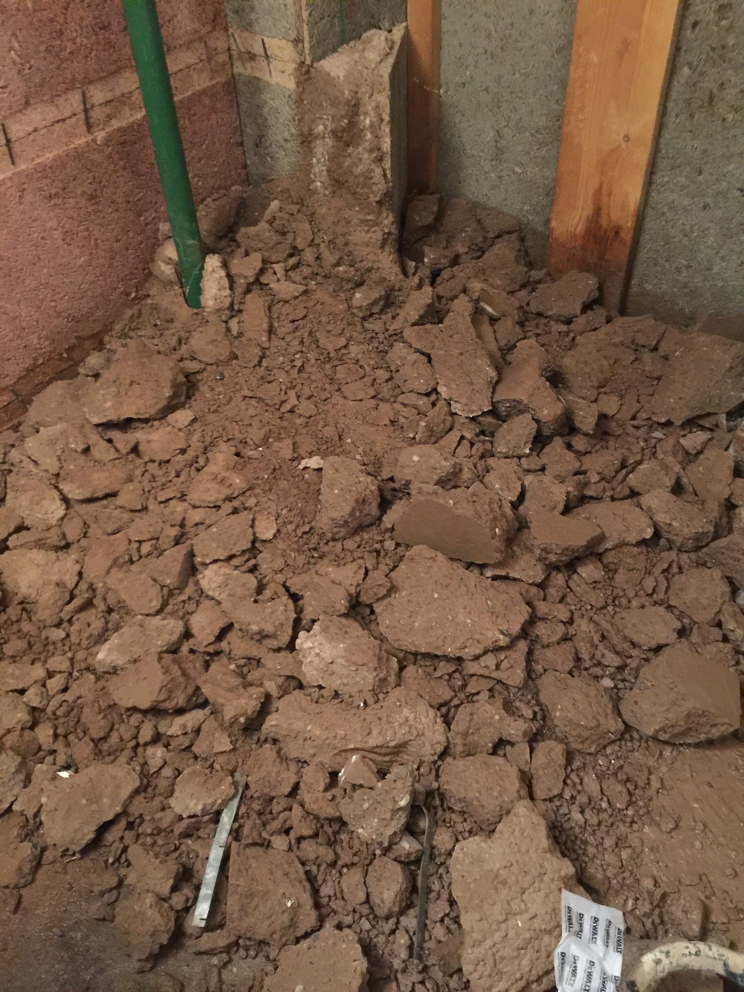

Humpty Dumpty Posted February 13, 2019 Share Posted February 13, 2019 What can go wrong Link to comment Share on other sites More sharing options...
Mr Punter Posted February 13, 2019 Share Posted February 13, 2019 16 minutes ago, Humpty Dumpty said: What can go wrong I am not quite sure what I am looking at here. Care to elaborate? Link to comment Share on other sites More sharing options...
Humpty Dumpty Posted February 13, 2019 Share Posted February 13, 2019 Whatever system you go with decide on the system first before getting planning approval. Not so much of an issue with sismo and a completely freestyle build using hired shuttering, but if you go with velox do your drawing & dims to the build system, increments of 500mm/250mm height and 1/2/1.5 meters lengthways. Minimises wastage and cutting which all makes for a quicker cheaper build. I didn’t do that and wasted material because of it. Same goes for position and sizing of windows doors etc...... 1 Link to comment Share on other sites More sharing options...

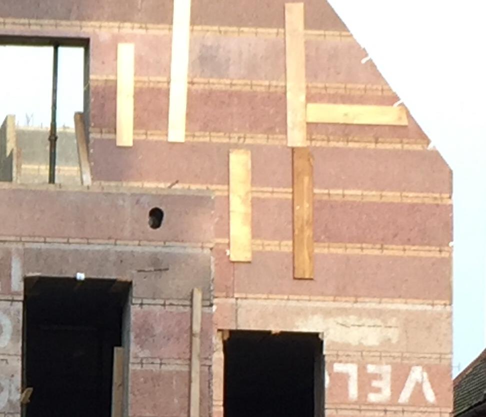

Humpty Dumpty Posted February 13, 2019 Share Posted February 13, 2019 Just now, Mr Punter said: I am not quite sure what I am looking at here. Care to elaborate? Blow out bottom of a 2.5 Mtr wall through which I lost several tons of concrete.... happened twice on the same pour..... hell of a mess and clean up job while you have trucks backing up with wet concrete. Small off cut panel = weakness which needs shoring up very well to prevent. Link to comment Share on other sites More sharing options...

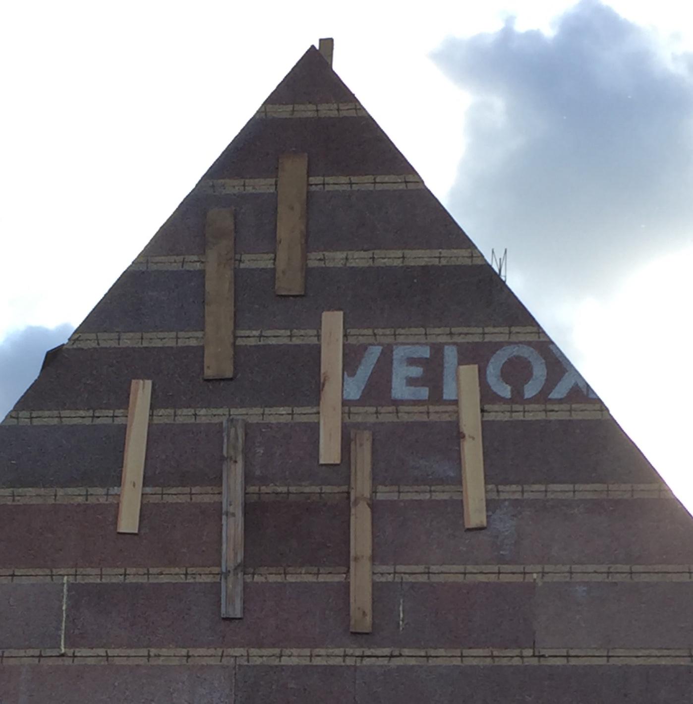

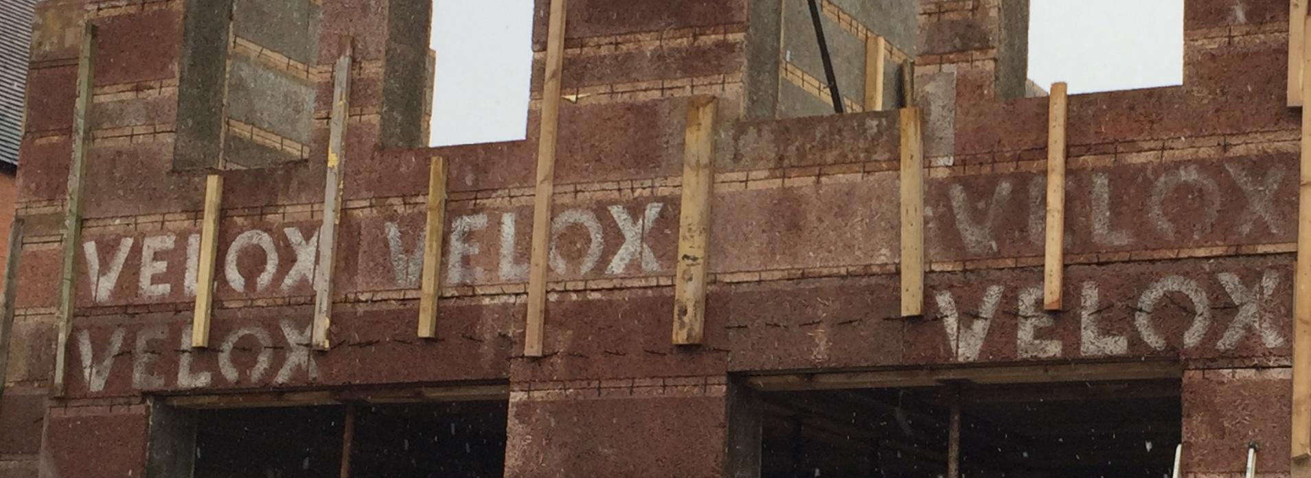

Humpty Dumpty Posted February 13, 2019 Share Posted February 13, 2019 Bracing Link to comment Share on other sites More sharing options...

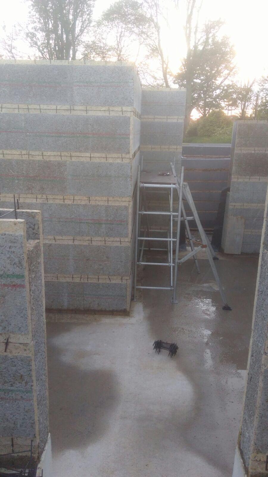

Humpty Dumpty Posted February 13, 2019 Share Posted February 13, 2019 1 minute ago, scottishjohn said: their website is so poor with very little real information ,no construction manual ,or listing of components not for me Sismo? Basically it’s an insulated metal cage which come in large format blocks and you just wire clip the cages together. It has to be used with a proprietary scaffold that clips to the cage internally to the build and holds it plumb for concrete pour..... whereas velox I built 3 storeys no scaffold (tut tut... I know but it was safe enough) , just working off the internal floor slabs with my trusty little tower and a big ladder. It can be done but with lots and lots of care..... Link to comment Share on other sites More sharing options...

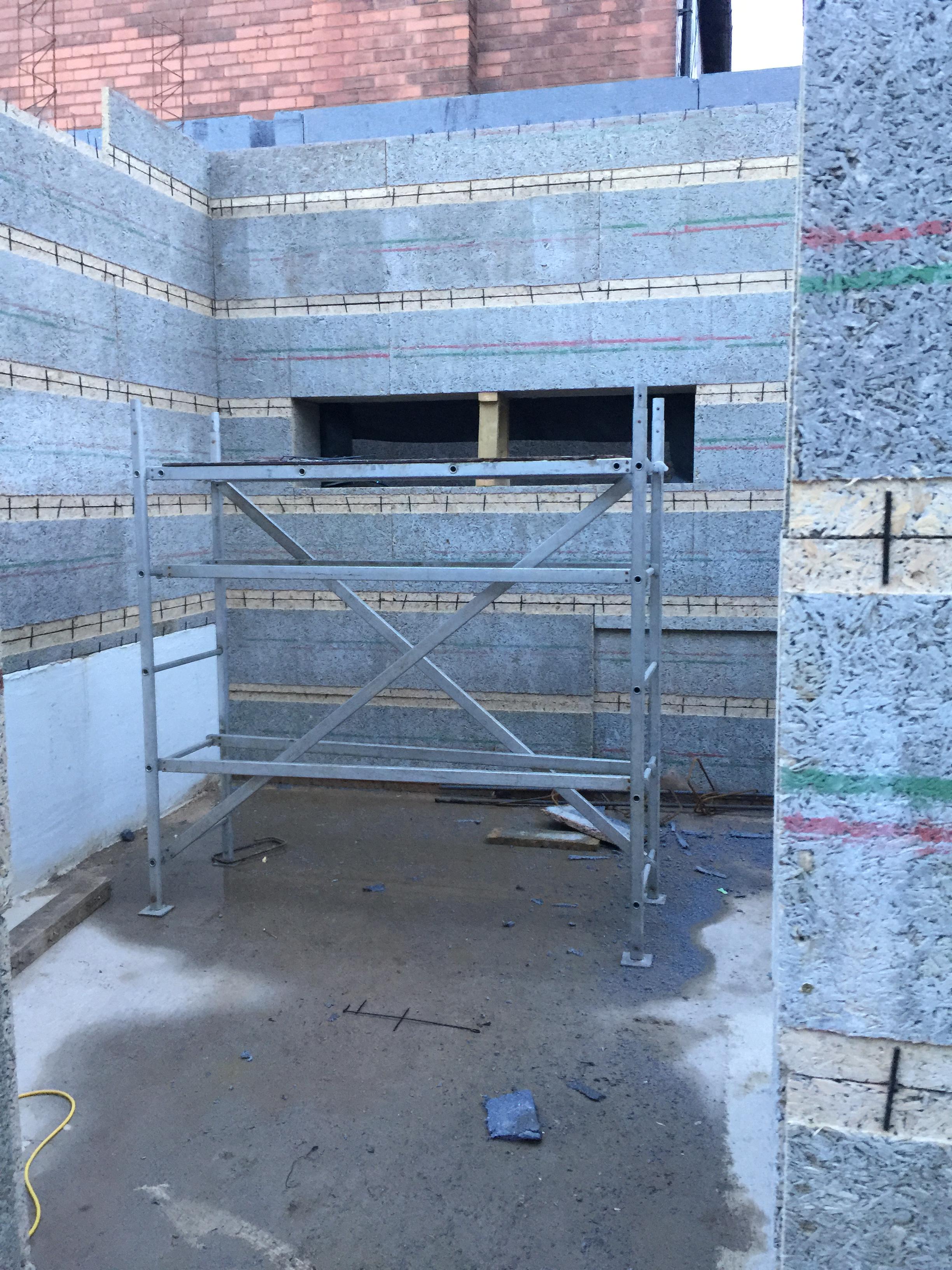

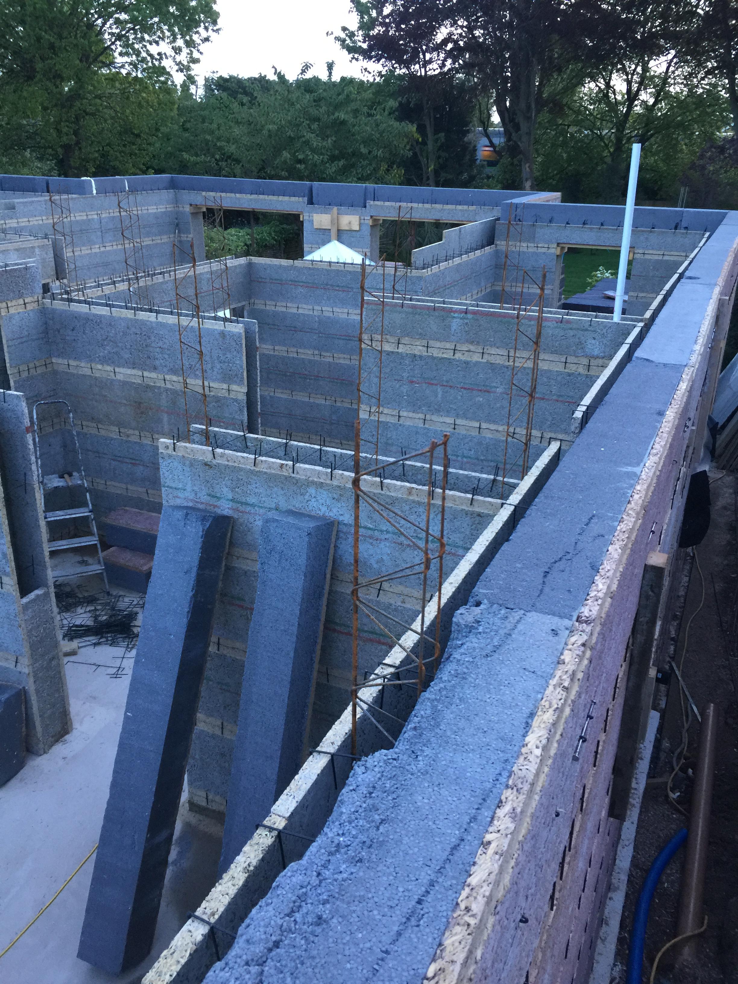

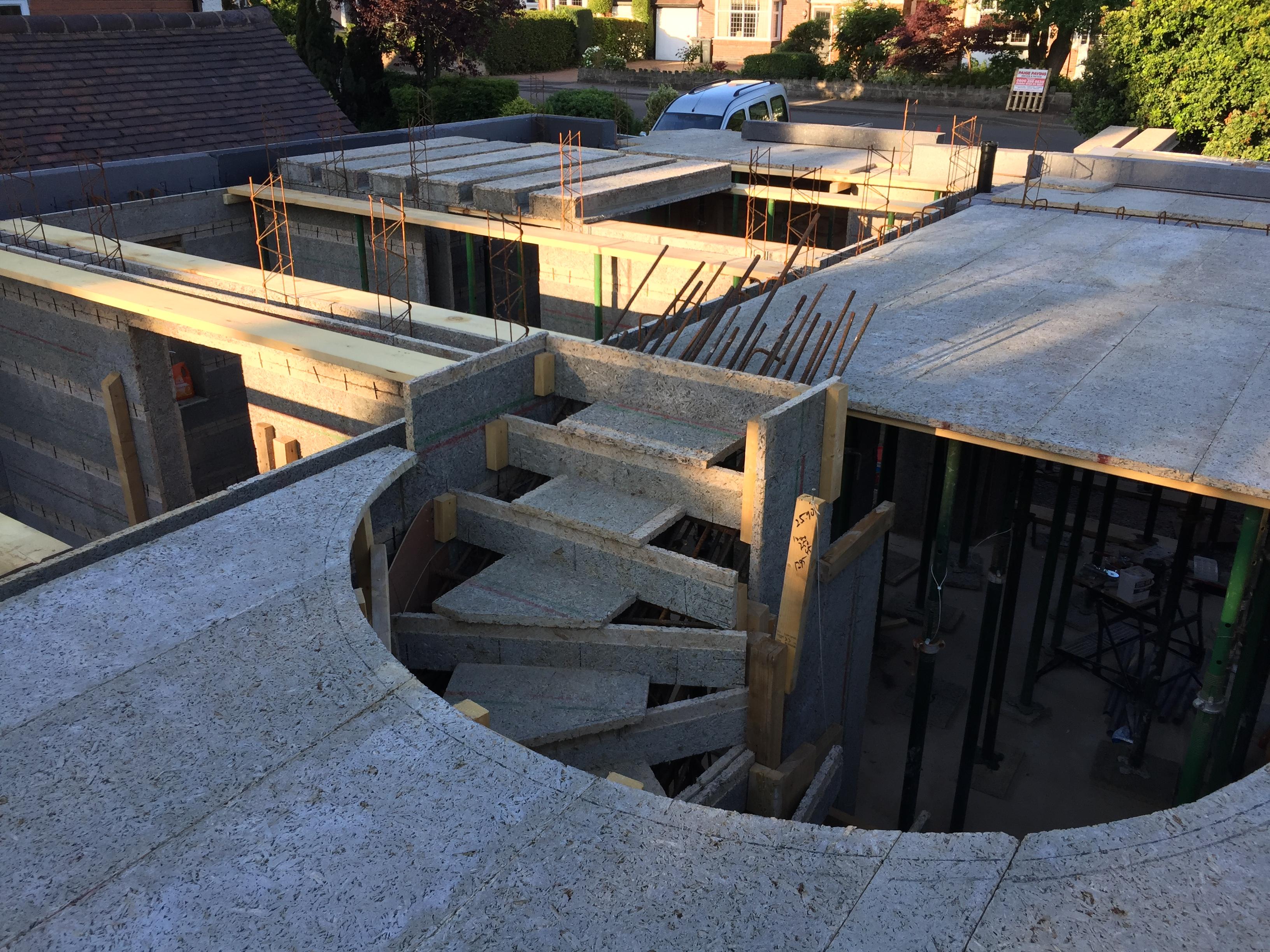

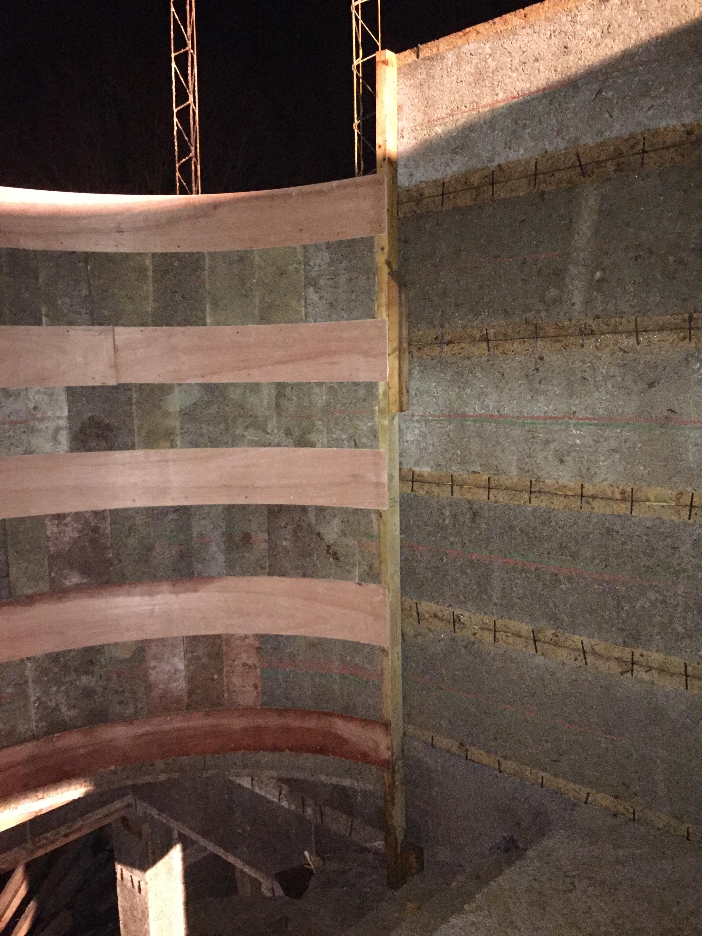

D Walter Posted February 18, 2019 Share Posted February 18, 2019 I would echo Humpty Dumptys comments on using Velox. It is a bit agricultural, hard on tools and heavy to lift/shit. Chasing for services is much harder work than with EPS formwork. Lots of care needed to keep everything plumb and we screwed small plywood squares over every intersection of three Velox boards prior to pouring to keep all joints aligned. The end result is incredibly solid with good fixability internally and externally, good for plastering and good sound insulation. We had minimal issues with Velox boards bowing and expanding but we had pretty much perfect weather for building. Link to comment Share on other sites More sharing options...
