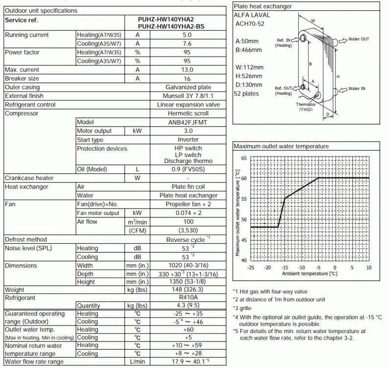

The only device that is connected across all 3 phases is the ASHP. It failed during this latest event, and now cannot be turned on without immediately tripping the circuit. It didn't fail during any previous event.
Given the extent of the damage, my parents in law are naturally very concerned about the situation. There’s the obvious safety concern if a specific problem can't be identified, but there’s also the potential costs associated with replacing all of the damaged components. Of course, these can be claimed on household insurance, but if the problem returns, I suspect their insurer may be less than happy to pay out again.
Based on the admittedly technically light explanation of the problem above, can anyone think of a possible mechanism that could lead to the outcome above?
The ASHP engineer is coming by tomorrow morning to install a new board in the ASHP. Is there anything I should be asking him in relation to this situation?

Do you actually need three phase, or is this a throwback to a time when ASHPs had to have s 3 phases supply due to high start loads? If the ASHP I’d fried, maybe it’s time to change it for an inverter based unit!?
Sad as it sounds a vast number of cus / dis boards get thrown in but nobody bothers to check the manufacturers terminal within are properly tightened!
No idea. It's a 5 year old Mitsubishi - I've always assumed that an ASHP from a mainstream brand of that era would be inverter driven. At this stage, we don't know what's actually fried. It might be just a small control board.
Even though it is 3 phase, I will bet it has a neutral connection and used that and 1 phase for the control circuitry (so it can use the same controls as the single phase version) so if it is a floating neutral that would be as likely to go pop as your sky box.
