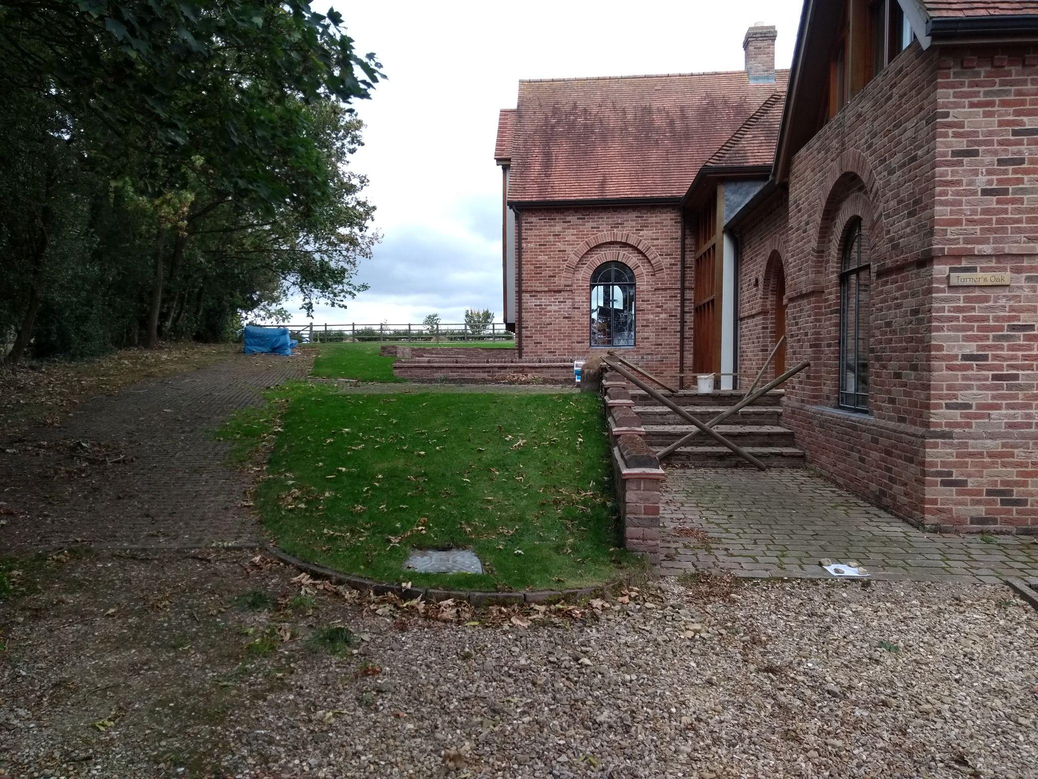

Jeremy Harris Posted October 2, 2018 Posted October 2, 2018 There can be some impact from Part M on odd things, I found. I ended up moving our house slightly to the West on the plot to allow enough room for the access ramp to the rear door and the requirement to "enable a wheelchair user to manoeuvre into the dwelling". I was advised that this meant I had to provide a flat area outside the back door (which is at the top of the access ramp) to allow a wheelchair user to turn through 90 degrees and enter the house, together with the normal flush threshold. You don't have to use the front door for wheelchair user access, BTW, any entrance level door can be used to meet the Part M requirement.
Temp Posted October 2, 2018 Posted October 2, 2018 1 minute ago, mike m said: Current thinking is brick and block, most of all the new builds i have seen recently are two leaves of 100mm block with 100mm cavity, typically with 50mm PIR board in the cavity, though with 100mm aerated block on the inner leaf. I would put more than 50mm of PIR in the cavity if building again . At least 75mm, ideally 100mm. I also have concerns that builders don't always butt together the sheets of insulation very well. If I could figure out how to do it I'd prefer two layers with staggered joints or some sort of filled cavity.
Temp Posted October 2, 2018 Posted October 2, 2018 4 minutes ago, JSHarris said: I was advised that this meant I had to provide a flat area outside the back door (which is at the top of the access ramp) to allow a wheelchair user to turn through 90 degrees and enter the house That can work well. For example if you have steps down off the flat area as well as the ramp, the steps have to be 90cm wide anyway. I appreciate we have a lot more space than most but this is what we were allowed. Ignore the wood, I have been fixing loose slabs. The bit on the left is (was going to be) reinforced grass but never got around to laying grass on it.
