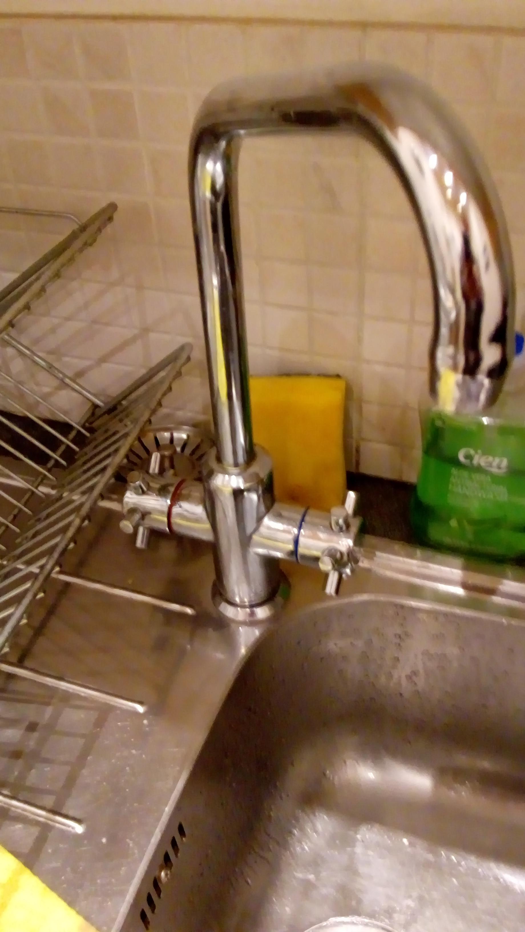

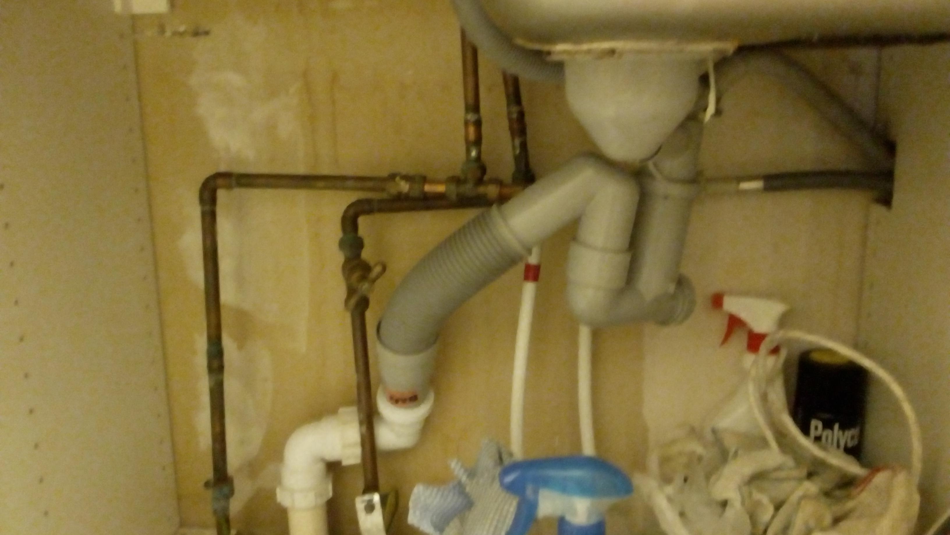

Tennentslager Posted September 28, 2018 Posted September 28, 2018 So best advice, repair or replace. Soldered underneath and I can't do that. It's the boys rental and I'd just DIY rather than bother landlord who is a gem of a guy but he'll get a plumber out. More...can't see any isolator for the hot...

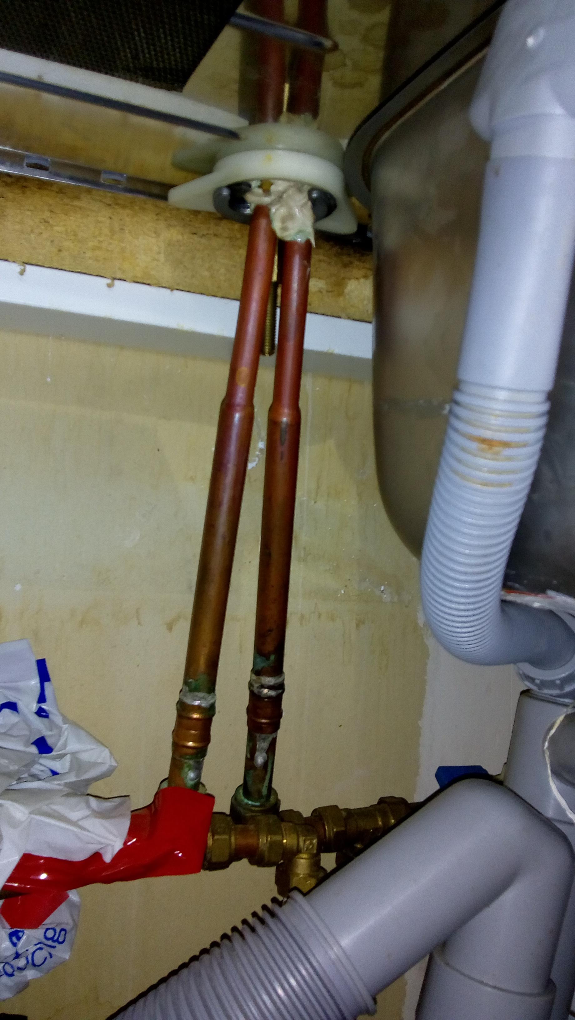

ProDave Posted September 28, 2018 Posted September 28, 2018 Dripping underneath I assume is the problem? Those copper tails screw into the tap and seal with an O ring. Shut off water and open hot tap to releive pressure, slacken the compression joint at the bottom. See if you can screw the tail a bit tighter into the tap body, then re tighten compression fitting.
Tennentslager Posted September 28, 2018 Author Posted September 28, 2018 No @ProDave it's the tap. Not the pipe No great problem but needs fixed
Crofter Posted September 29, 2018 Posted September 29, 2018 It's not just needing a new ceramic cartridge, is it?
Tennentslager Posted September 29, 2018 Author Posted September 29, 2018 2 hours ago, Crofter said: It's not just needing a new ceramic cartridge, is it? Probably but where to get such a part...?

Crofter Posted September 29, 2018 Posted September 29, 2018 Just now, Tennentslager said: Probably but where to get such a part...? eBay! e.g. https://www.ebay.co.uk/itm/1-2-Brass-Ceramic-Disc-Tap-Valve-Insert-Cartridge-Quarter-Turn-20Teeth-42-104mm/282979261875?_trkparms=aid%3D555017%26algo%3DPL.CASSINI%26ao%3D1%26asc%3D20151005190540%26meid%3Db804398d11e6482abbb37a30f2b242de%26pid%3D100505%26rk%3D1%26rkt%3D1%26%26itm%3D282979261875&_trksid=p2045573.c100505.m3226 (no connection/endorsement etc- simply the first one on the listing). If you get one with too long a spindle, it will still work, but you will see some of the brass part showing. How do I know this... It's a straightforward job needing a couple of spanners, but you will need to isolate both sides of the tap.
