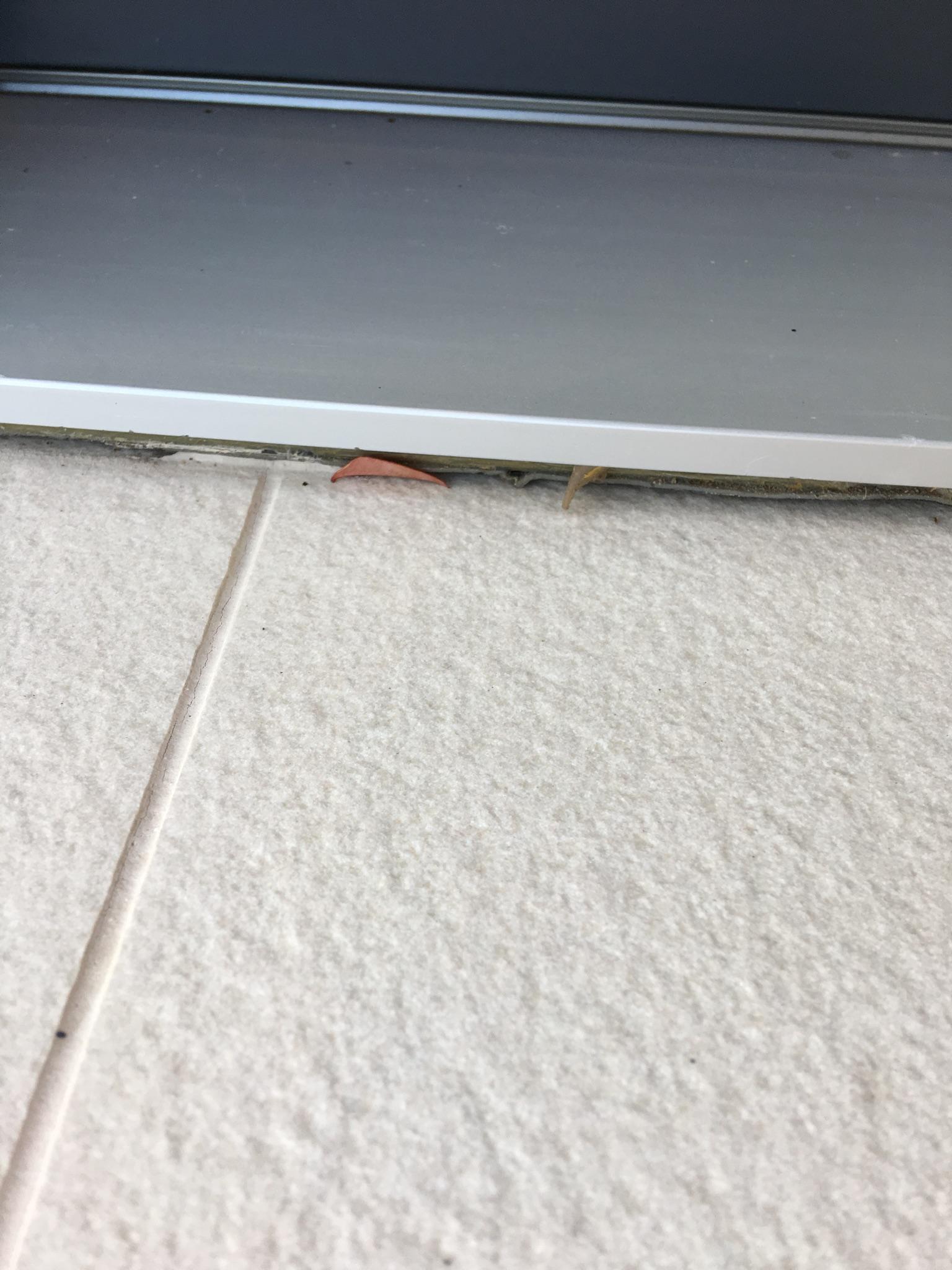

lizzie Posted September 27, 2018 Posted September 27, 2018 You may recall my leaking sliders saga. Eventually it was resolved and no more water ingress. The problem was caused by the level thresholds sitting on the slab with no drainage rebate underneath......great thinking from window company and project manager, I wont start ranting about the useless so called professionals again that ship has long sailed now just need to find an answer to the remaining problem area. The remedial work undertaken was to cut out part of the slab to allow the thresholds to drain out and that works but it was not possible to get a drainage channel under the thresholds as there should have been so the weep holes drain directly out onto the patio. The thresholds sit about 10cm off the pato tile outside (inside is fine) I can get a finger under the gap between threshold and patio tile. They should be flush to the tile but cannot be becuase that would block the drainage weep holes and we would have water inside again. I need a solution.........ideas so far....possibly something fabricated with drainage holes? Some grout or mastic with gaps where weep holes discharge.......but that still leaves level thresholds with a 10mm ‘step’ A very poor photo attached. All suggestions gratefully received thank you.

lizzie Posted September 27, 2018 Author Posted September 27, 2018 they are Internorm lift and slide doors. The drainage holes are just where the threshold (underneath) meets the tiles, thats in the 10mm gap. The drainage holes should empty into a drainage channel below and then tiles laid flush to threshold but because of cock up there is no drainage channel underneath so holes have to be able to drain onto patio

lizzie Posted September 27, 2018 Author Posted September 27, 2018 12 minutes ago, Mr Punter said: I cannot see an issue with this draining onto the patio. no thats not the issue. What I have to resolve is how to deal with the unsightly gap with thresholds not fitted properly. It doesnt look quite so bad in the photo but looks awful in reality plus debris is gathering under there and will block the drainage holes. Also the aluminium threshold flexes if you step on it. It is not designed to be unsupported it is designed to sit flat on the ground. What I need is a way of filling or covering the 10mm gap whilst still allowing the water to escape.....and something that looks reasonable too.
PeterW Posted September 27, 2018 Posted September 27, 2018 I’d look at a 10x30mm rectangular profile and wedge that under the edge, leaving the gaps for the drainage. Not ideal but probably the best you can do.

lizzie Posted September 27, 2018 Author Posted September 27, 2018 8 minutes ago, PeterW said: I’d look at a 10x30mm rectangular profile and wedge that under the edge, leaving the gaps for the drainage. Not ideal but probably the best you can do. Thanks Peter would you be able to point me at such a profile or do I need to get one fabricated.
PeterW Posted September 27, 2018 Posted September 27, 2018 Not expensive - 10x10 is Standard size 10x10 1

Mr Punter Posted September 28, 2018 Posted September 28, 2018 Get the material powder coated to the same colour as the cill. Maybe cut it into 200mm lengths and space at 220mm centres to leave drainage gaps. 1
