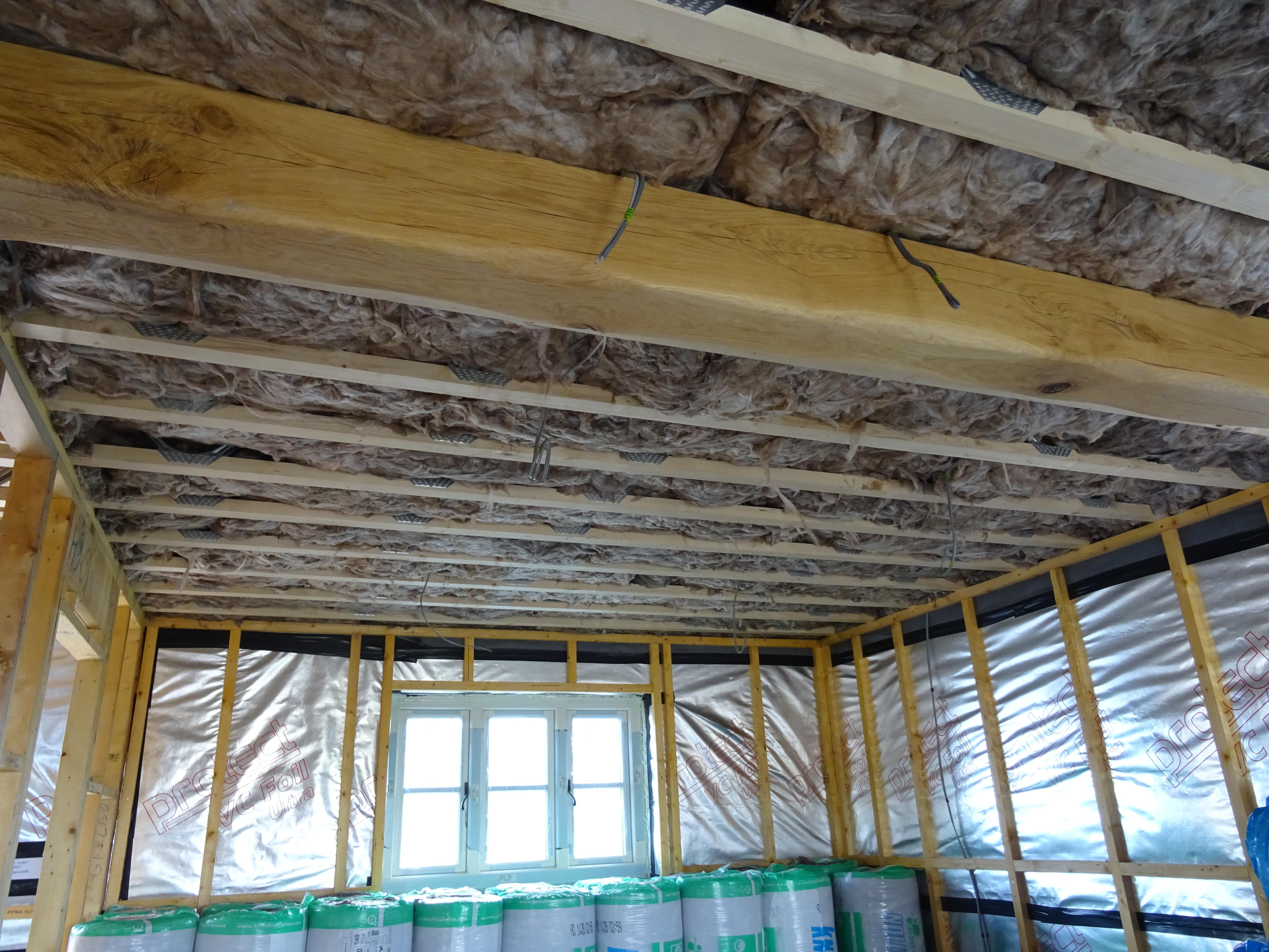

Redoctober Posted September 21, 2018 Posted September 21, 2018 Not sure about insulation being nailed / screwed to the joists but like @Declan52 has said, insulation usually goes in between the joists - that is certainly the way we did ours. See image - Nothing required to keep it in place as the width of the insulation came in at the same width of the gap between the joists.
