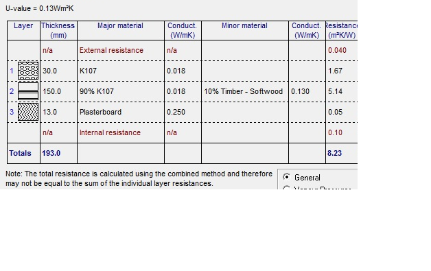

A_L Posted September 21, 2018 Share Posted September 21, 2018 4 hours ago, mike m said: Having looked at a U-value calculator for 0.11 ..... I think they are a bit optimistic, even with a 10% timber fraction (38mm@400mm centres) I get 0.13 Link to comment Share on other sites More sharing options...
