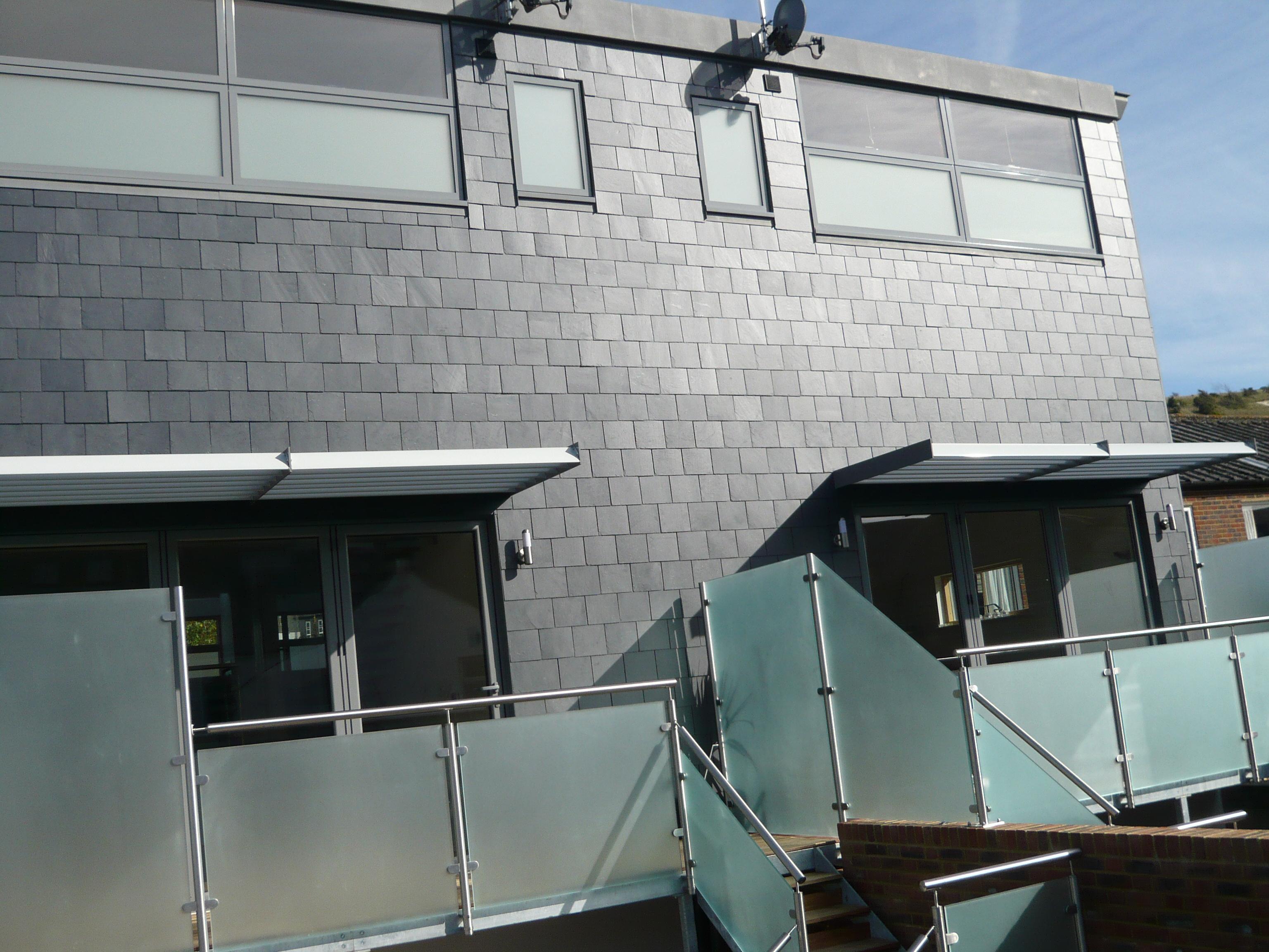

Mr Punter Posted September 17, 2018 Share Posted September 17, 2018 We did these horizontal ones in powder coated alluminium. There is a bracket at each end and one in the centre behind the slates which fixed to the outside of the timber frame with several coach screws. 1 Link to comment Share on other sites More sharing options...

Juj Posted September 17, 2018 Share Posted September 17, 2018 4 hours ago, Mr Punter said: We did these horizontal ones in powder coated alluminium. There is a bracket at each end and one in the centre behind the slates which fixed to the outside of the timber frame with several coach screws. Sorry to take this off topic @Mr Punter but I'm literally window shopping at the moment and like the look of your, erm, windows! Link to comment Share on other sites More sharing options...
Mr Punter Posted September 17, 2018 Share Posted September 17, 2018 6 minutes ago, Juj said: Sorry to take this off topic @Mr Punter but I'm literally window shopping at the moment and like the look of your, erm, windows! The windows were Velfac. IdealCombi do a similar looking system. The doors were another make. The lower part of the windows was obscured due to planning / overlooking constraints. Link to comment Share on other sites More sharing options...
