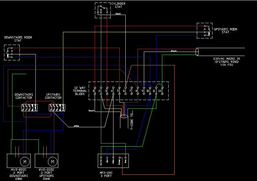

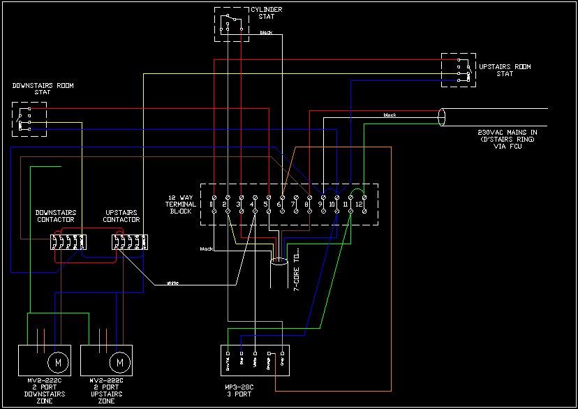

Onoff Posted September 6, 2018 Author Share Posted September 6, 2018 (edited) Drawing opened in Draftsight. As an aside the paper size was 420x297 i.e A3. Then used Win 7 Snipping Tool to select on screen: Alt/Ctrl/Print Scrn: Both rubbish imo, just not "crisp" enough and a bit fuzzy! The wire colour text on the 3 port valve is illegible. If I print out on paper it's all perfectly legible. Never used to have these issues with AutoCAD 2000 / 2000i. A much simpler beast (what I was trained on) and more than adequate for my needs than 2010 but the old packages won't run on my 64-bit systems. I may buy the Longbow converter at around £140 to overcome this. I've tried running AutoCAD in XP Mode but it's awful. Edited September 6, 2018 by Onoff Link to comment Share on other sites More sharing options...
