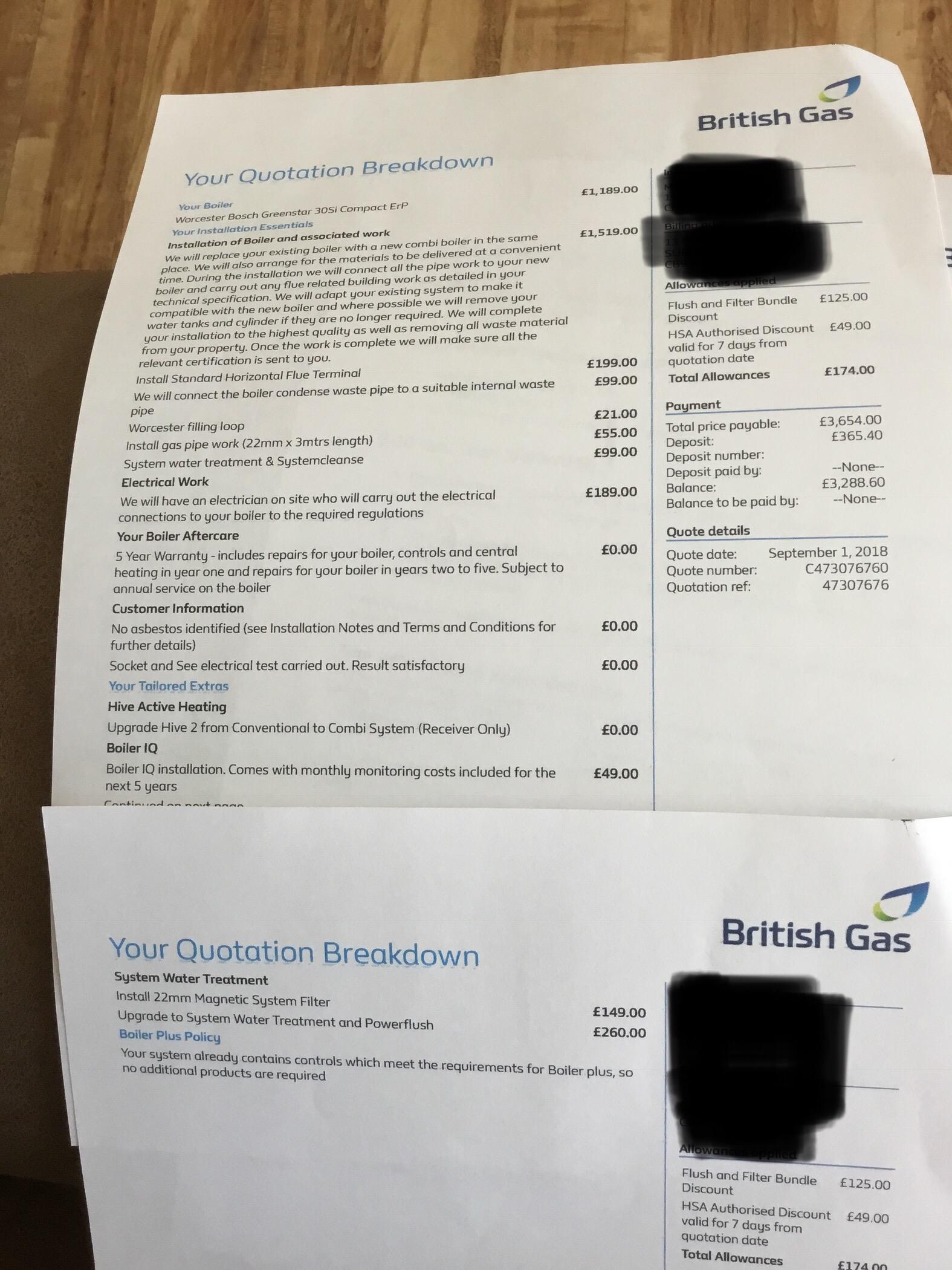

Thanks all.
Changing to a combi partly to stop heating water we never use (while still having a good supply of hot water available)
Also we have a shower pump right near our bedroom and it’s bloody noisy. A combi should see the end of this.
The existing boiler is very old, and while we have the money to change it I’d like to.
Seems very reasonable to be fair.
And can have 0% finance over 2 years which I wasn’t expecting (with a 10% deposit)
£3654...is expensive...I had a boiler replaced ( back boiler in fire place) new combi, new gas fire and an extra radiator added for under £2000
You can check the retail price of the boiler easily enough, and then work out roughly what it should cost to install based on normal labour rates, plus a bit for any additional pipe and fittings.
For example, back in 2008 when we had our old system boiler replaced with a new Vaillant combi, the new boiler cost about £800 at that time.  We were converting from a system boiler to a combi, so the labour included removing two water tanks from the loft and the old hot water cylinder, adding new pipe runs, bricking up a fairly large hole in the wall where the old rectangular boiler flue had been, as well as drilling a new hole through the wall for the new flue.  The price included a power flush (mandatory in order to get the boiler warranty).
Total cost came to a bit over £2k in 2008.  Labour involved two blokes for about a day and a half doing the boiler swap and plumbing, plus an electrician for an hour or so to wire things up.  Some of that labour time was just hanging around, as the power flush took a couple of hours and there wasn't much they could be getting on with whilst that was going on.
If you assumed rates of £200/day, and were generous and said there were four man days, then that comes out at £800 for labour.  On top of that there were probably a £100 or so of pipe and fittings, plus VAT, so their price to us back in 2008 was definitely on the high side, but they were a big firm who I thought at the time presented a lower risk of doing a bad job.  They were also Vaillant agents, so could give the 5 year warranty.  As it turned out I'd have been better using a smaller local firm, as they screwed up and we were faffing around with warranty calls from there for over a year before things got sorted properly..
I've just checked, and a similar boiler today costs around £900, and labour rates around here for decent plumbers/heating engineers are around £220/day now, so the same job today should cost around £1900 +VAT, so around £2,280.  I reckon the top whack price for something like this should be around £2,500 for an expensive part of the UK, less for areas where labour costs are lower.
