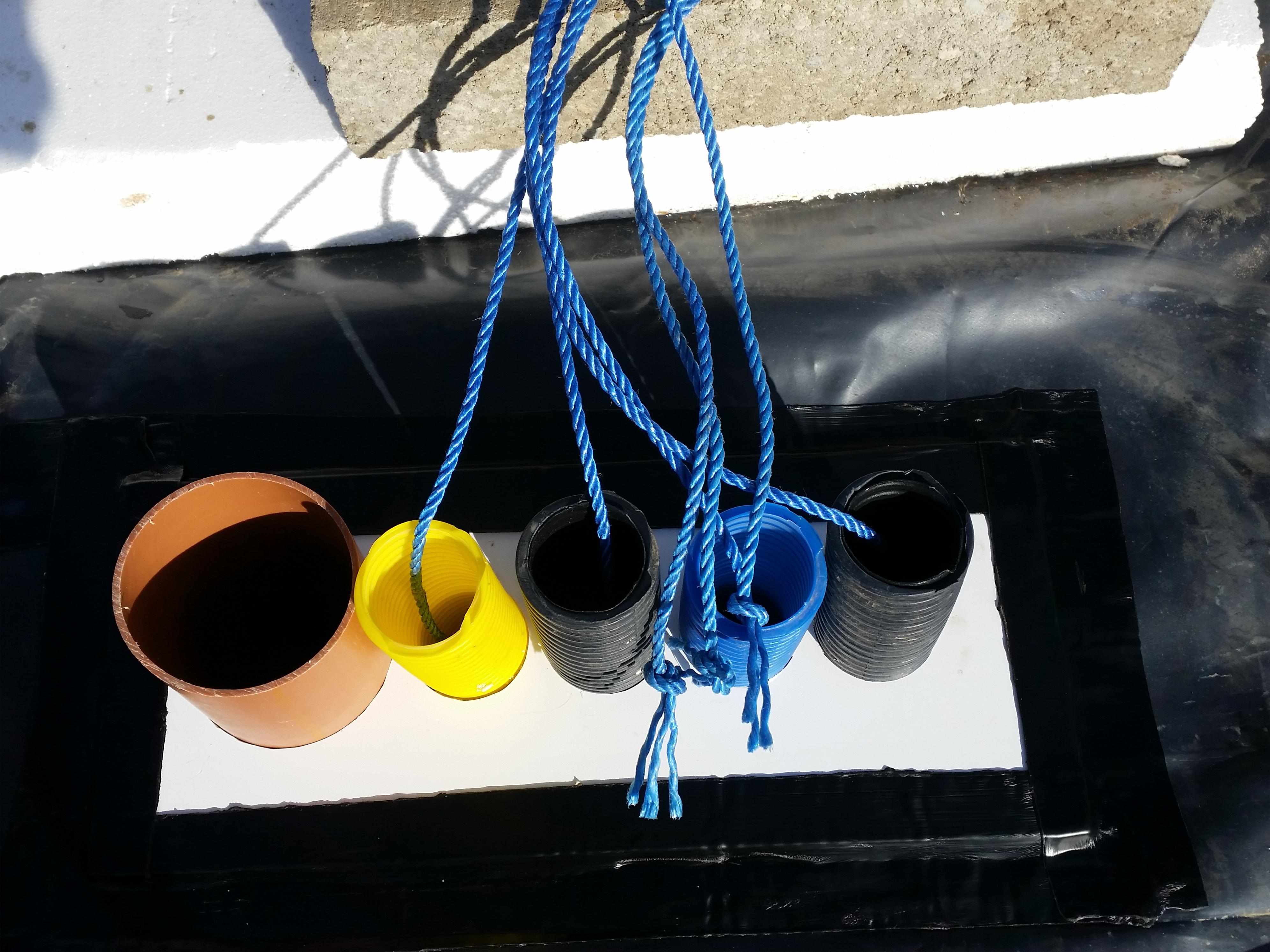

willbish Posted August 27, 2018 Posted August 27, 2018 I have top hats to seal the 110mm waste pipe penetrations through my radon membrane. Simple. But also have a bank of 6x 63mm ducts to seal around too. What is the correct method to seal these? The Icopal Easi pour radon seal looks like a very effective (and costly) method. Any other methods equally as acceptable?

willbish Posted August 27, 2018 Author Posted August 27, 2018 @Russell griffiths is that just a liquid membrane though? The Icopal product is a two part sealant, mixed together and poured to 30mm thickness before hardening. I don't think I could satisfactorily paint a liquid membrane around the ducts.

PeterW Posted August 27, 2018 Posted August 27, 2018 Is this a radon membrane under a solid slab..?? Duct tape and an off cut of membrane will work fine ..!
willbish Posted August 27, 2018 Author Posted August 27, 2018 14 minutes ago, PeterW said: Is this a radon membrane under a solid slab..?? Sure is 14 minutes ago, PeterW said: Duct tape and an off cut of membrane will work fine ..! That i can do easily! First ever BC inspection looming, want to be impressing and not a cause for concern.
Russell griffiths Posted August 27, 2018 Posted August 27, 2018 I thought you wanted it for on top of block n beam, do you have the correct tape for the membrane ? just use that.
willbish Posted August 27, 2018 Author Posted August 27, 2018 2 minutes ago, Russell griffiths said: do you have the correct tape for the membrane ? Yep, got double sided and single sided. Only issue is once I've got an offcut around the 6 ducts, I will be able to 'see' down between, where the ducts don't tessellate.
MikeSharp01 Posted August 27, 2018 Posted August 27, 2018 (edited) I made a set of plastic plates on a cnc machine with banks of close fit holes for each group then sealed this plate to the DPC and then ran a bead of polyurethane adhesive around each pipe to make a perfect seal. The Bi was happy. Edited August 27, 2018 by MikeSharp01 1 1
PeterW Posted August 27, 2018 Posted August 27, 2018 So... pull all but one of the ducts to the side,tape the two edges and then let the ducts back into position. Next one, next one etc. That joins all the edges. Then cut a letterbox in a spare bit, drop over the ducts and double sided tape and job done.
willbish Posted August 27, 2018 Author Posted August 27, 2018 @MikeSharp01 that is a solid solution. No doubt the BI was happy. Top job! I think I will try my best with offcuts and tape...
Nickfromwales Posted August 28, 2018 Posted August 28, 2018 Squirt some expanding foam down first to take up the bulk of the gaps Leave that cure and then cut back flush, then the membrane and tape. @MikeSharp01, thats worthy of a gold star. Please proceed to the site cabin and affix one the the chart I sent you
