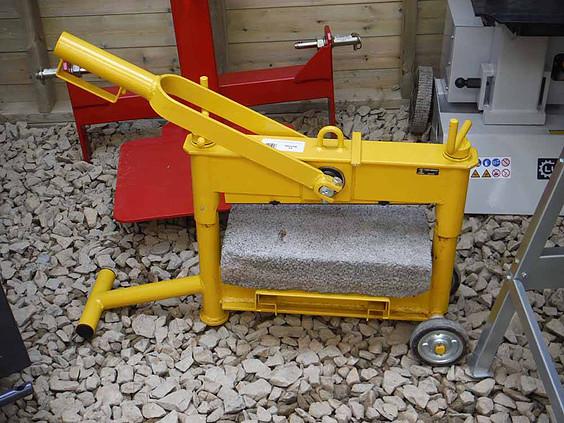

epsilonGreedy Posted August 23, 2018 Author Posted August 23, 2018 @Onoff I had bumped into that YouTube video before, thanks for the reminder. If I could walk into my local ScrewFix and buy one I would try it out today as it suits my personal low-tech low-budget hands on approach to self build. The rough fractures at the split points look bad but in practice I reckon they would promote a nice grippy mortar bond in contrast to the glazed smooth surface of a disc cut. I fear obtaining this gadget will involve a PayPay transaction to some outfit in rural China and a 3 month sea delivery.

Declan52 Posted August 23, 2018 Posted August 23, 2018 4 minutes ago, epsilonGreedy said: @Onoff I had bumped into that YouTube video before, thanks for the reminder. If I could walk into my local ScrewFix and buy one I would try it out today as it suits my personal low-tech low-budget hands on approach to self build. The rough fractures at the split points look bad but in practice I reckon they would promote a nice grippy mortar bond in contrast to the glazed smooth surface of a disc cut. I fear obtaining this gadget will involve a PayPay transaction to some outfit in rural China and a 3 month sea delivery. Just use a tape measure to score a line where it needs broke. Thats all that tool is doing away with. The rest is just a hammer and bolster and a few thumps. 1

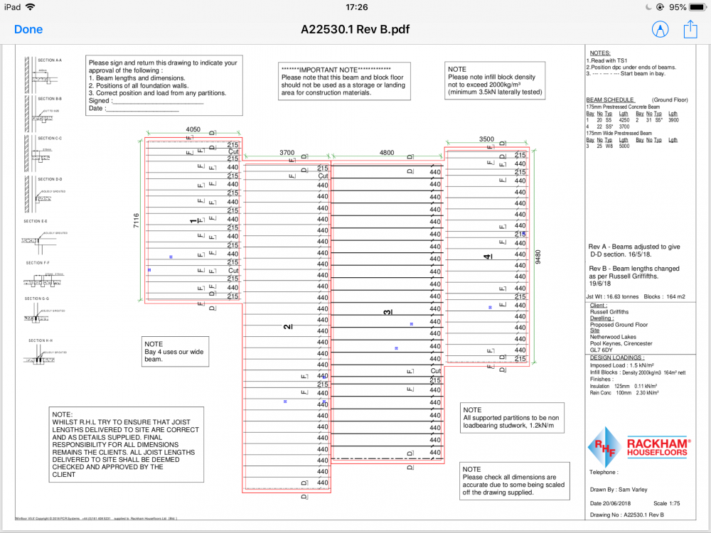

epsilonGreedy Posted August 23, 2018 Author Posted August 23, 2018 16 hours ago, Russell griffiths said: Why have you not got a hose pipe connected to it most of the modern ones have a hose connection I was unaware of this option, the brickie team duo seemed to prefer shouting at each other when one got covered in cutting dust. 16 hours ago, Russell griffiths said: If you are having block n beam floor it will pay to get this set up nicely as you will have a fair few cuts. Yes I am. I thought the beam layout would be designed to avoid cutting lots of blocks? What triggered the need for cutting in your case?
Onoff Posted August 23, 2018 Posted August 23, 2018 (edited) 10 minutes ago, epsilonGreedy said: @Onoff I had bumped into that YouTube video before, thanks for the reminder. If I could walk into my local ScrewFix and buy one I would try it out today as it suits my personal low-tech low-budget hands on approach to self build. The rough fractures at the split points look bad but in practice I reckon they would promote a nice grippy mortar bond in contrast to the glazed smooth surface of a disc cut. I fear obtaining this gadget will involve a PayPay transaction to some outfit in rural China and a 3 month sea delivery. Add another $20 for shipping & import taxes to the UK: https://www.amazon.com/Multi-Angle-Brick-and-Block-Cutter/dp/B01LR94QNE/ref=sr_1_fkmr2_1?s=hi&ie=UTF8&qid=1535016403&sr=8-1-fkmr2&keywords=marshall+block+cutter (Don't make me make one! ) Edited August 23, 2018 by Onoff 1

Russell griffiths Posted August 23, 2018 Posted August 23, 2018 2 hours ago, epsilonGreedy said: I was unaware of this option, the brickie team duo seemed to prefer shouting at each other when one got covered in cutting dust. Yes I am. I thought the beam layout would be designed to avoid cutting lots of blocks? What triggered the need for cutting in your case? Block n beam layout is dictated by room length and span some rows will be 440 block length some will be 215 block width, if you have a soil pipe coming up through the floor you do not want it hitting a beam, so it needs to fall in a gap or block area. If you have two pipes in an area it may be unlikely that both will fall in the gaps (block area) so you may have a row of 440 then a row of 215 then a row of cuts. The pic shows all 440 blocks but a row of cuts on the end. Ignore blockwork buildup, my build is ICF so will look different to yours. Have you had a beam company do a drawing yet, it will show you very clearly where any cuts go. if not I would look into it as mine took 4 weeks to turn up.

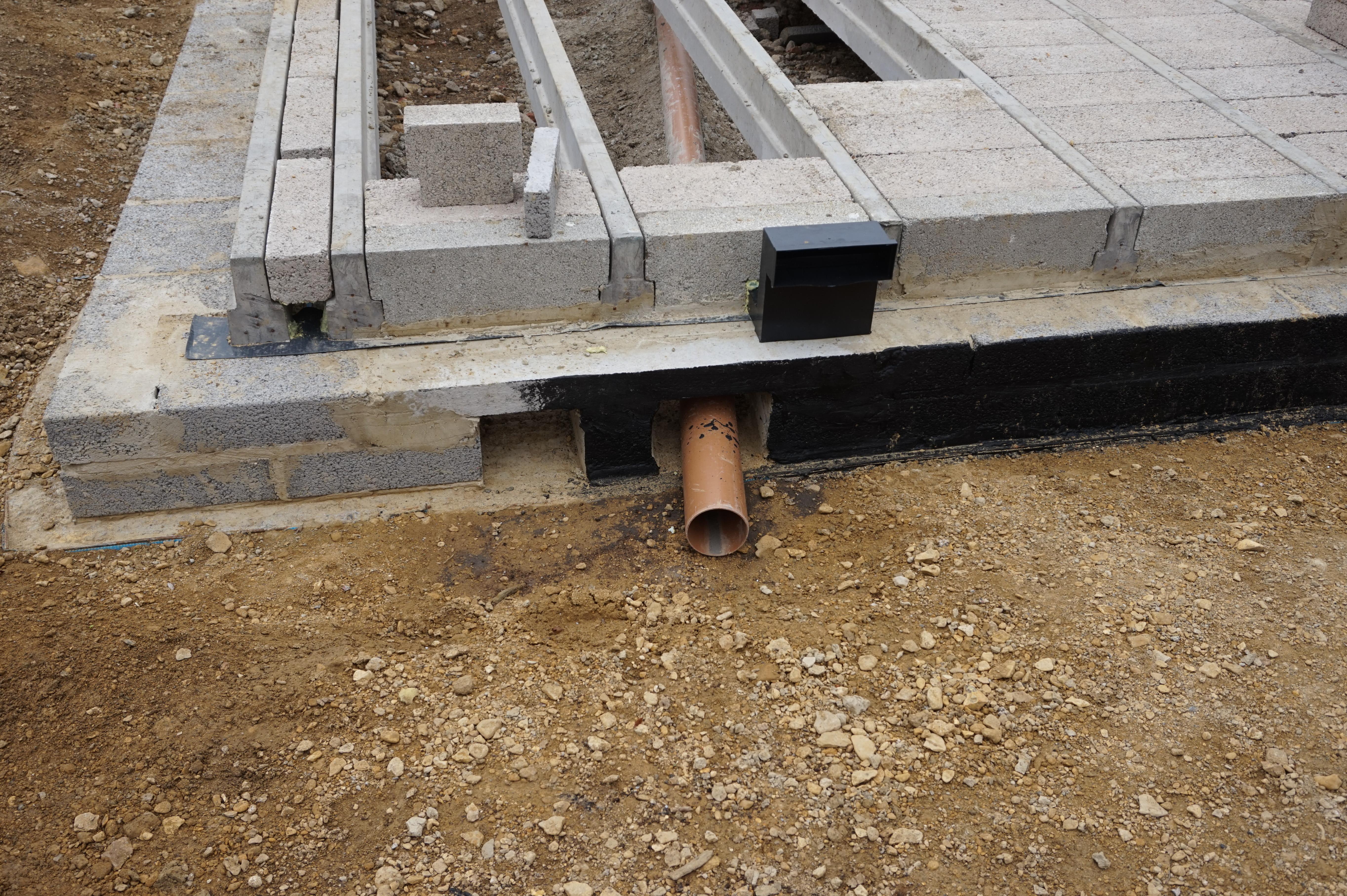

epsilonGreedy Posted August 23, 2018 Author Posted August 23, 2018 1 hour ago, Russell griffiths said: Block n beam layout is dictated by room length and span some rows will be 440 block length some will be 215 block width An illuminating photo thank you. I am curious about the function of the bitumen paint. 175mm high beams? Your mortar has a more sandy colour than mine, what is your ratio? Lots of flat blocks there, I only did that in the end for an intermediate dwarf footing wall mid way through the sitting room intended to eliminate risk of bounce.
Russell griffiths Posted August 23, 2018 Posted August 23, 2018 175mm high beams. Black bitumen paint serves no purpose apart from keeping me happy. Everything in the photo will end underground in the end so just trying to keep a bit of damp of the face. Mortar colour will be dictated by many things, we are in the Cotswolds so the sand is a bright yellow. Mix is 4:1 all flat blocks, easier to lay and exact width of my ICF wall.
Russell griffiths Posted August 23, 2018 Posted August 23, 2018 Block n beam layout. You can see the cuts if you enlarge it a bit. I would recommend this company if they have a depot near you. Seemed efficient, I changed things 3 times and it didn’t seem a problem awkward site for an artic,driver very good put them all exactly where I wanted them. And £ 800 cheaper than the next quote. 1
Onoff Posted August 23, 2018 Posted August 23, 2018 There's this: http://orituk.com/product/4300-mfk-brick-block-cutter/ 1

Onoff Posted August 23, 2018 Posted August 23, 2018 (edited) I reckon I could make one of these. Must be a cam in there that pushes down on the blade. Thinking a lump of I beam on the bottom..... Edited August 23, 2018 by Onoff

PeterW Posted August 23, 2018 Posted August 23, 2018 7 minutes ago, Onoff said: I reckon I could make one of these. Must be a cam in there that pushes down on the blade. Thinking a lump of I beam on the bottom..... Not accurate enough for a beam and block floor. £200 gets you a Husky that if you clean it up after you finish and run it on decent two stroke oil and super unleaded will be worth £200 in 6 months time.
