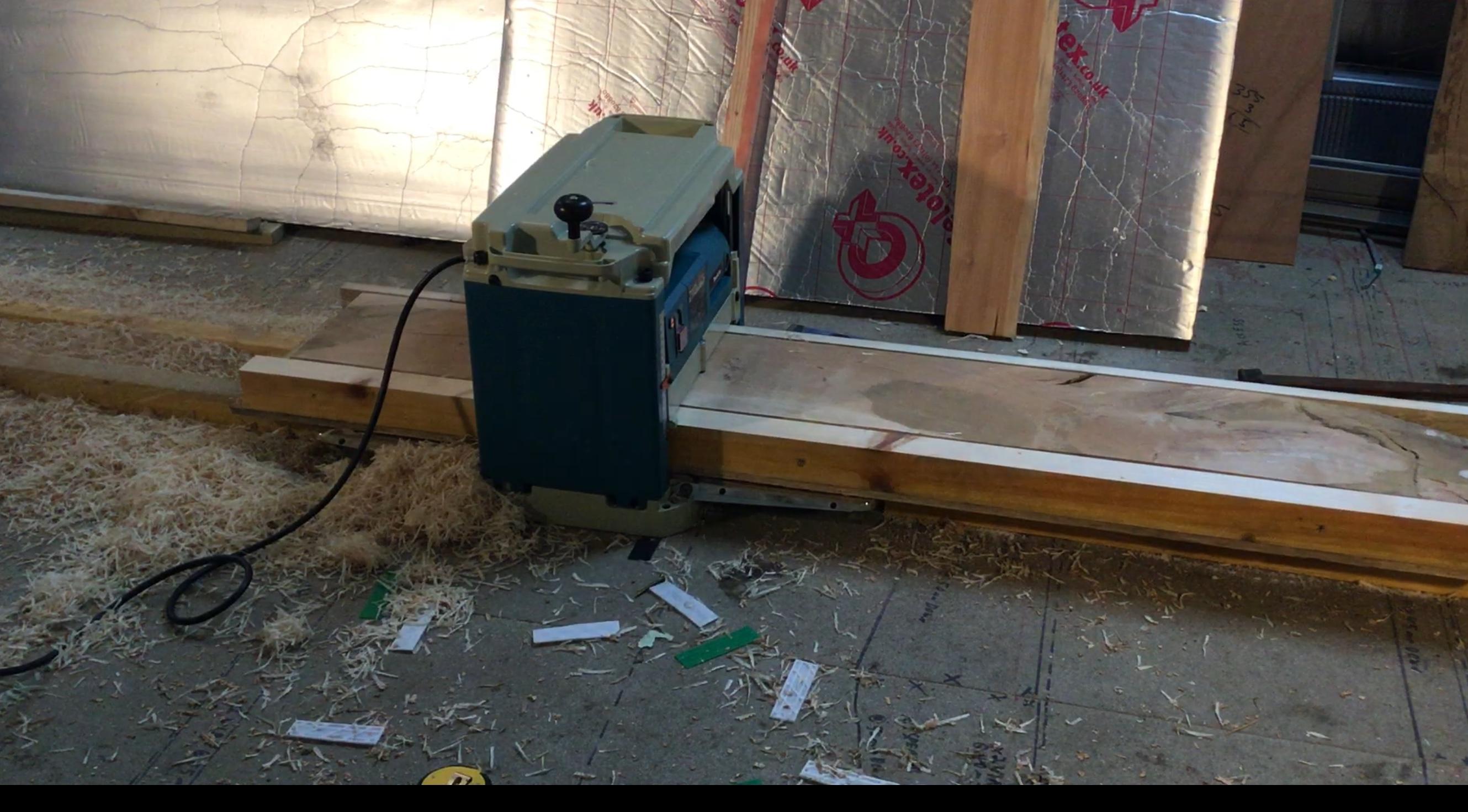

Cpd Posted August 19, 2018 Posted August 19, 2018 (edited) I was recently using some oak I Slabbed 5 years ago with a chainsaw mill to make a fire place. To get a good top surface I first got a bit of ply and made a couple of timber sides. I then wedged my oak board in and levelled it up so that the vary minimum of wood would need to come of the top surface to get it level. Once it was chocked up I screwed it in place (making sure the screws were well below the finished plane level. I then just stated shooting it through my makita planer / thicknesser what will take up to just over 300mm wide. I just took of a fraction each time to prevent overworking the motor but it worked great. The final result was fantastic and was so smooth I did not even need to sand it. I tried to upload the video I made but failed due to it being the wrong file type....... and I am a dinosaur when it comes to my iPad. I have nearly finished the fire place and will start another thread when it’s done. But I just wanted to show that I did something just like you are talking about with very basic kit. Ie a planer only ! Edited August 19, 2018 by Cpd 1

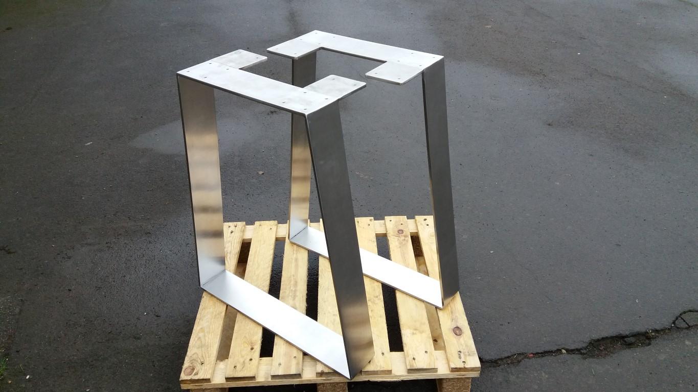

Onoff Posted August 20, 2018 Posted August 20, 2018 Just for reference done in st/st by a guy in Northampton: http://www.paul-holland.com
jack Posted August 20, 2018 Author Posted August 20, 2018 I think I saw something else he did (lab tables with removable tops?) on the forum you mentioned above. Extremely tidy work, and in stainless too!

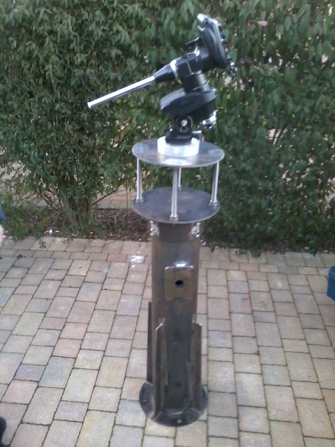

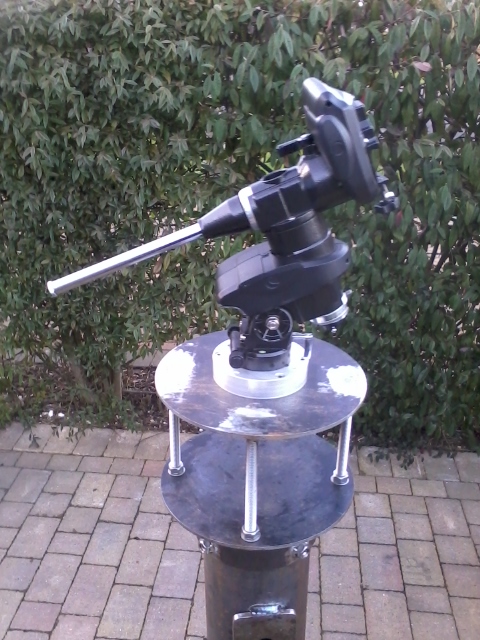

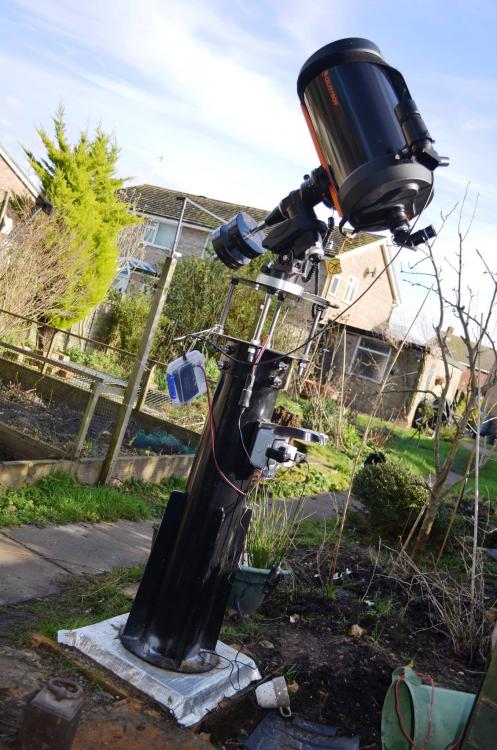

Onoff Posted August 20, 2018 Posted August 20, 2018 (edited) 44 minutes ago, jack said: Yep, already thinking about a strip of epdm or nitrile rubber along the bottom. Concrete floors make something like this a must! I hear you on the costs of galvanising etc. We've started getting quotes for galvanising and powder coating our gates and I've been surprised at some (well, nearly all) of the prices coming back. Galvanisers few and far between now. Medway galvanizers do both galv and ppc. These people zinc flame sprayed and 2-pack epoxied my brother's astronomy pier: http://beeverlimited.co.uk Before & after but taken on a crap phone: Edited August 20, 2018 by Onoff
