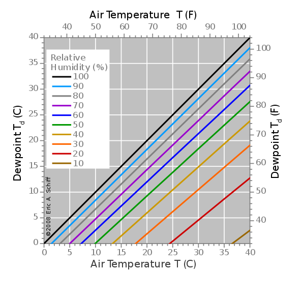

Jeremy Harris Posted August 9, 2018 Share Posted August 9, 2018 It's also possible that it's condensation from thermal bridge around the skylight, especially as water vapour is lighter than air (it's why clouds float) and so any condensation is more likely to occur at any cold spot high up. In the recent weather I doubt that either the temperature or humidity conditions, even at night, would be enough to cause condensation of this sort, though, and anyway, there should be a vapour control layer (VCL) that's specifically there to prevent moist, warm air from inside the house getting into the structure. The VCL should be right behind the internal plasterboard, and have no holes in it - care being needed to seal around it where there are things like light fittings inset into the ceiling. Link to comment Share on other sites More sharing options...

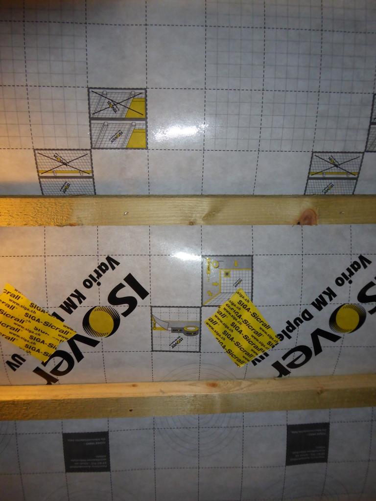

haddock Posted August 9, 2018 Author Share Posted August 9, 2018 15 minutes ago, JSHarris said: there should be a vapour control layer (VCL) that's specifically there to prevent moist, warm air from inside the house getting into the structure. The VCL should be right behind the internal plasterboard, and have no holes in it - care being needed to seal around it where there are things like light fittings inset into the ceiling. Here's what the flange that's acting as a thermal bridge looks like from inside the room. Only a small part of it is exposed and as you can see the upper surface gets mouldy from the wet. I think a lot more condensation forms on the underside of the flange caused by moist air rising via the ceiling void but I don't have any direct evidence of that. Link to comment Share on other sites More sharing options...
haddock Posted August 9, 2018 Author Share Posted August 9, 2018 54 minutes ago, JSHarris said: The VCL should be right behind the internal plasterboard, and have no holes in it - care being needed to seal around it where there are things like light fittings inset into the ceiling. There’s nothing to stop air rising through the light fittings and into the ceiling void — that’s maybe 20 ingress points just in the main living space. Would the VCL be something that would rest over the top of the light fittings then? Not sure what form it takes but I doubt there’s any practical way of retrofitting one. Link to comment Share on other sites More sharing options...
Jeremy Harris Posted August 9, 2018 Share Posted August 9, 2018 Yes, there should be a VCL fitted somewhere between the inner surfaces and the insulation, to prevent warm, moist, air being able to penetrate up and cause interstitial condensation. Ideally the VCL should be as close to the rear of the inner surface as practical. For example, here's a photo of our roof (we have insulation between the rafters, rather than above the ceiling) showing the VCL - it's a plastic sheet that's there to prevent warm moist air reaching any area that could be cool enough to cause condensation to form: This is an area in the services room upstairs where there's no plasterboard fitted, but everywhere else is the same; the plasterboard is screwed to those 50 x 50 battens/. Where the VCL meets window or door frames it's taped to them, behind where the plasterboard fits, to maintain a vapour-tight seal. Link to comment Share on other sites More sharing options...
