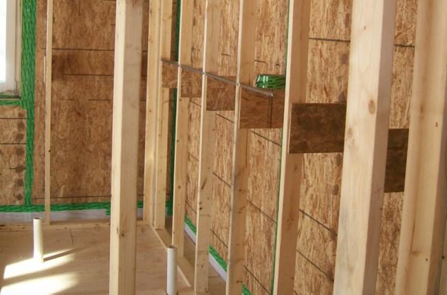

deuce22 Posted August 7, 2018 Author Posted August 7, 2018 Thanks. I just had a look at Larsen truss walls and it looks like there's a few ways to construct them. These could quite easily be made on site if I was allowed to use the thing pieces of OSB to join them together. I'll do some more research on the insulated raft ystem. Thanks.
