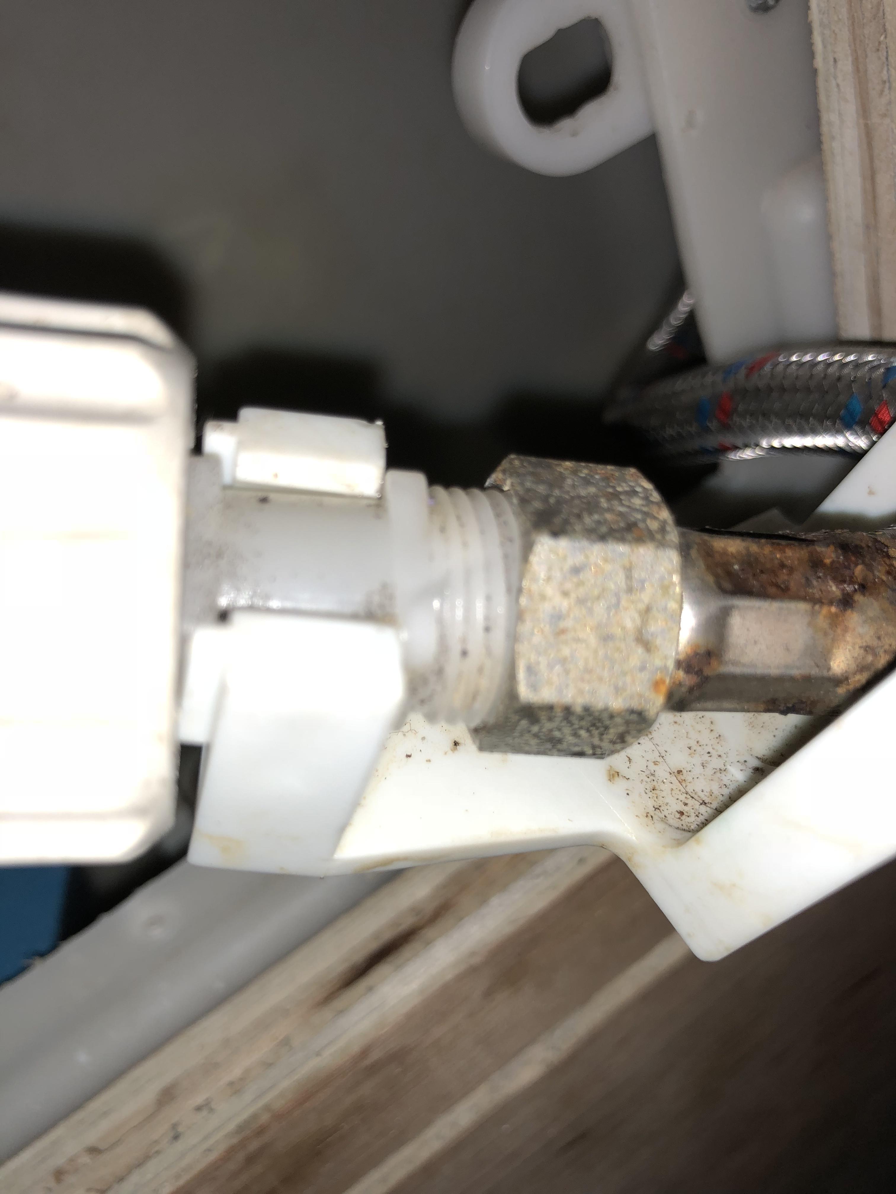

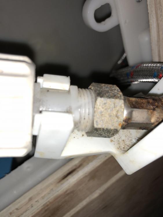

Onoff Posted July 21, 2018 Share Posted July 21, 2018 Lady plumbers...hands in tight spaces... On a serious note I've taken the liberty of firing off a couple of these images to toiletspares.co.uk Does to me look like an early Siamp fill valve. I've waded through every image on the site and Siamp looks the nearest. They may come back of course and say the only way to be sure is to whip it out for a proper look... 1 Link to comment Share on other sites More sharing options...
newhome Posted July 21, 2018 Author Share Posted July 21, 2018 My nails are sharp. You wouldn’t be smiling ? Thank you so much for that. I was frantically googling for the flush thing too but couldn’t find one like it. Link to comment Share on other sites More sharing options...
newhome Posted July 21, 2018 Author Share Posted July 21, 2018 Next problem. It’s attached to this plastic thing at the front. I’ve unscrewed it from the unit but can’t get the plastic collar thing to let go unless anyone has any ideas. Then I thought I would just unscrew the nut. Never used a spanner before so went in search of one. Found one that says 13/16 one end and I think it says 11/16 the other end but one is too big and the other too small. Looks like I may need to buy one the right size if I can work out what it needs. Link to comment Share on other sites More sharing options...
Onoff Posted July 21, 2018 Share Posted July 21, 2018 11/16" & 13/16" equate to a 17 & 21mm spanner. See then if you have an 18/19 or 20mm spanner or small adjustable. 1 Link to comment Share on other sites More sharing options...
newhome Posted July 21, 2018 Author Share Posted July 21, 2018 Just now, Onoff said: 11/16" & 13/16" equate to a 17 & 21mm spanner. See then if you have an 18/19 or 20mm spanner or small adjustable. Thanks. The hubby had sets and sets of the damn things. Christ knows where they all are. There are 2 adjustables but they look huge. I will go back into the cavern of hell garage and have another look. Another cheap and cheerful Amazon purchase seems appropriate to ensure that I have full sets of these things going forward. Would this be any good for once in a blue moon stuff? https://www.amazon.co.uk/Amtech-K0400-Combination-Spanner-11-Piece/dp/B008G0HWX4/ref=sr_1_6?s=diy&ie=UTF8&qid=1532166433&sr=1-6&keywords=spanner+set Link to comment Share on other sites More sharing options...

PeterW Posted July 21, 2018 Share Posted July 21, 2018 2 hours ago, newhome said: Next problem. It’s attached to this plastic thing at the front. I’ve unscrewed it from the unit but can’t get the plastic collar thing to let go unless anyone has any ideas. Then I thought I would just unscrew the nut. Never used a spanner before so went in search of one. Found one that says 13/16 one end and I think it says 11/16 the other end but one is too big and the other too small. Looks like I may need to buy one the right size if I can work out what it needs. Lever it up and it will unclip from that and that is a 17mm nut... 1 Link to comment Share on other sites More sharing options...

Onoff Posted July 21, 2018 Share Posted July 21, 2018 5 minutes ago, PeterW said: and that is a 17mm nut... 11/16" in old money! 1 Link to comment Share on other sites More sharing options...

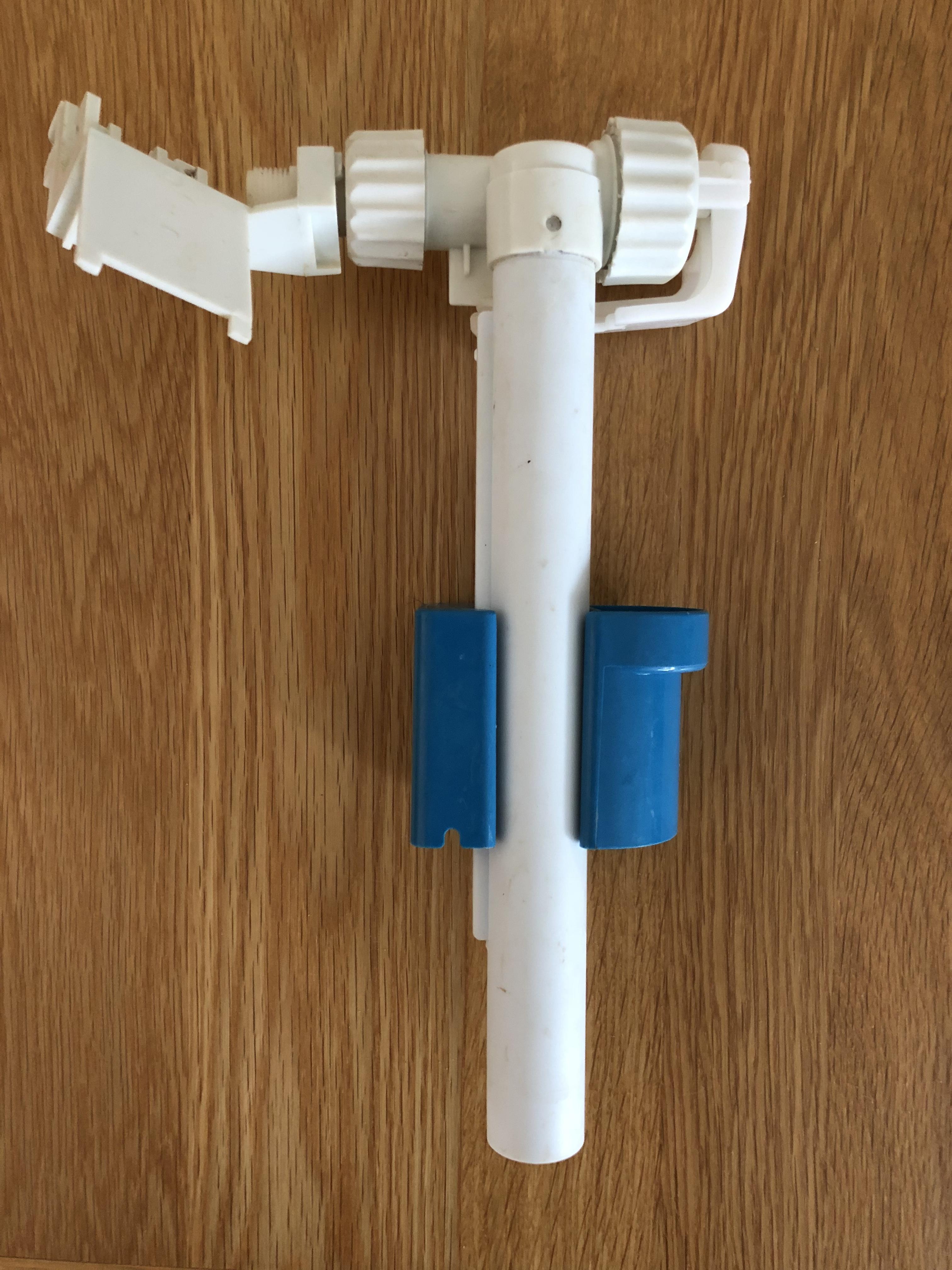

newhome Posted July 21, 2018 Author Share Posted July 21, 2018 Success! Couldn’t find a spanner but managed to improvise with some grippers. What now please? 1 Link to comment Share on other sites More sharing options...

newhome Posted July 21, 2018 Author Share Posted July 21, 2018 2 hours ago, newhome said: Success! Couldn’t find a spanner but managed to improvise with some grippers. What now please? Do I need to search for a replacement one of these or do I need to do something to fix it? Link to comment Share on other sites More sharing options...
newhome Posted July 21, 2018 Author Share Posted July 21, 2018 I've unscrewed everything and rinsed it although nothing looked dirty inside in truth. Link to comment Share on other sites More sharing options...
Jeremy Harris Posted July 21, 2018 Share Posted July 21, 2018 Pretty sure it's this one (swap the bracket over from your existing one) : https://www.toiletspareparts.com/collections/siamp-toilet-spares/products/siamp-95l-side-entry-inlet-float-valve-1-2-15mm-plastic-30950607 Hopefully one of the experts will confirm or otherwise if this is the part before you splash some cash (although it's only £12). 1 Link to comment Share on other sites More sharing options...
newhome Posted July 21, 2018 Author Share Posted July 21, 2018 Are they fairly standalone things? So if it fits on the side inlet pipe it should work regardless of make? Wondering if I should get a more reliable make? Link to comment Share on other sites More sharing options...
Jeremy Harris Posted July 21, 2018 Share Posted July 21, 2018 They all vary a bit, and one problem with built in cisterns is that there often isn't much room inside to fit the fill valve without the float touching something and perhaps jamming. You can repair the valve you have, as the chances are the diaphragm has a small hole or split in it, but a new diaphragm is around £3 and you really need to take the fill valve out to gain access to it, anyway. By the time you've done that it's easier to just fit a new valve. One of the plumbing experts here will know whether there's a more reliable side entry fill valve that will fit in the same space as that Siamp one, perhaps. If not I'd just replace it with the same one - they usually seem to last for around 5 years before failing, from what I can gather. 1 Link to comment Share on other sites More sharing options...
newhome Posted July 21, 2018 Author Share Posted July 21, 2018 Just now, JSHarris said: One of the plumbing experts here will know whether there's a more reliable side entry fill valve that will fit in the same space as that Siamp one, perhaps. If not I'd just replace it with the same one - they usually seem to last for around 5 years before failing, from what I can gather. Thanks. It's been in 8 years and is the one that has had the most use being the downstairs loo, and also the only loo that worked when we moved in, so I guess that's not too bad. The others have various issues but given my experience with the one upstairs I think that's due to the rods etc not being fitted correctly or still pressing down after a flush as the one upstairs doesn't leak or do anything strange with all of the rods and clips taken off. I have the joy of putting that back together and trying to avoid the issue yet to come . Link to comment Share on other sites More sharing options...
PeterW Posted July 21, 2018 Share Posted July 21, 2018 There are millions of Siamp ones in use - unless you’re up for buying Geberit and doing some sort of Frankenstein’s inlet on it, as the main nut where the pipe is I would expect is pretty non standard ... 1 Link to comment Share on other sites More sharing options...
