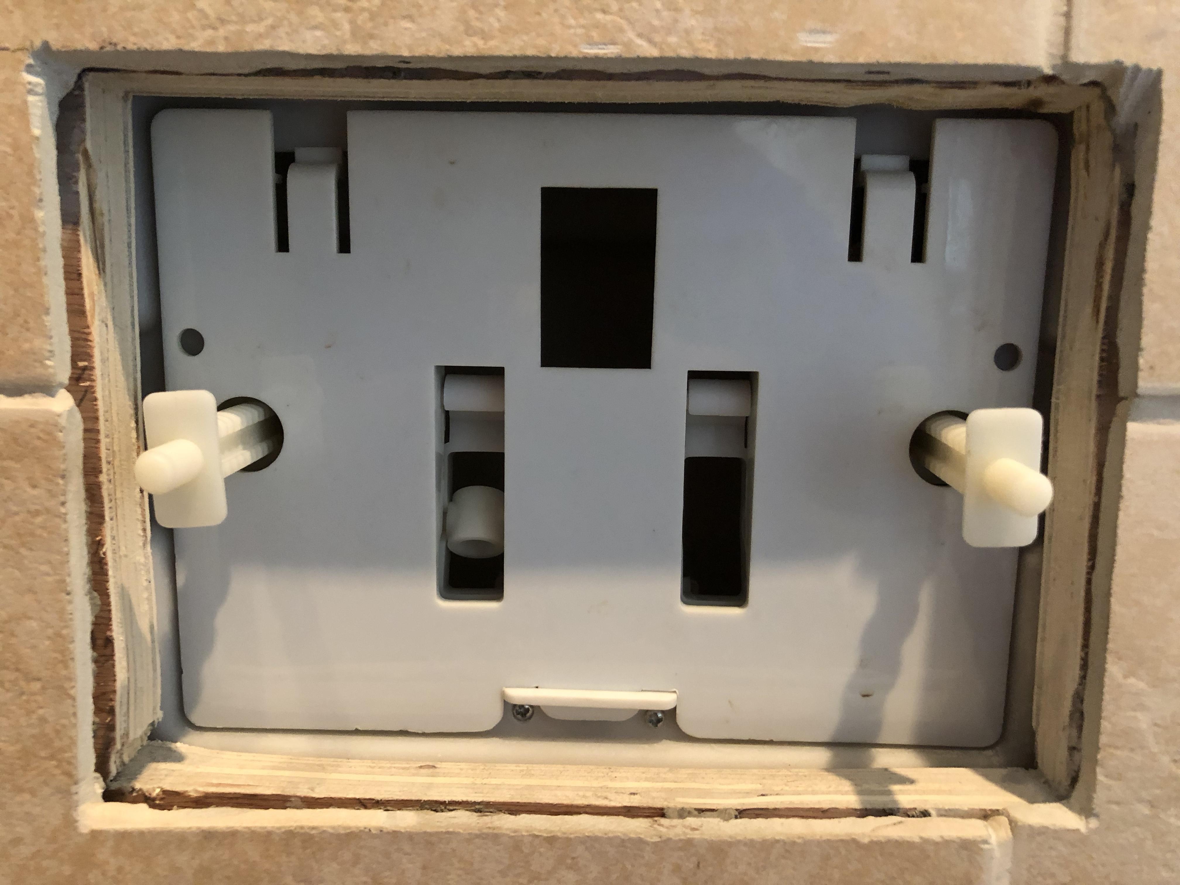

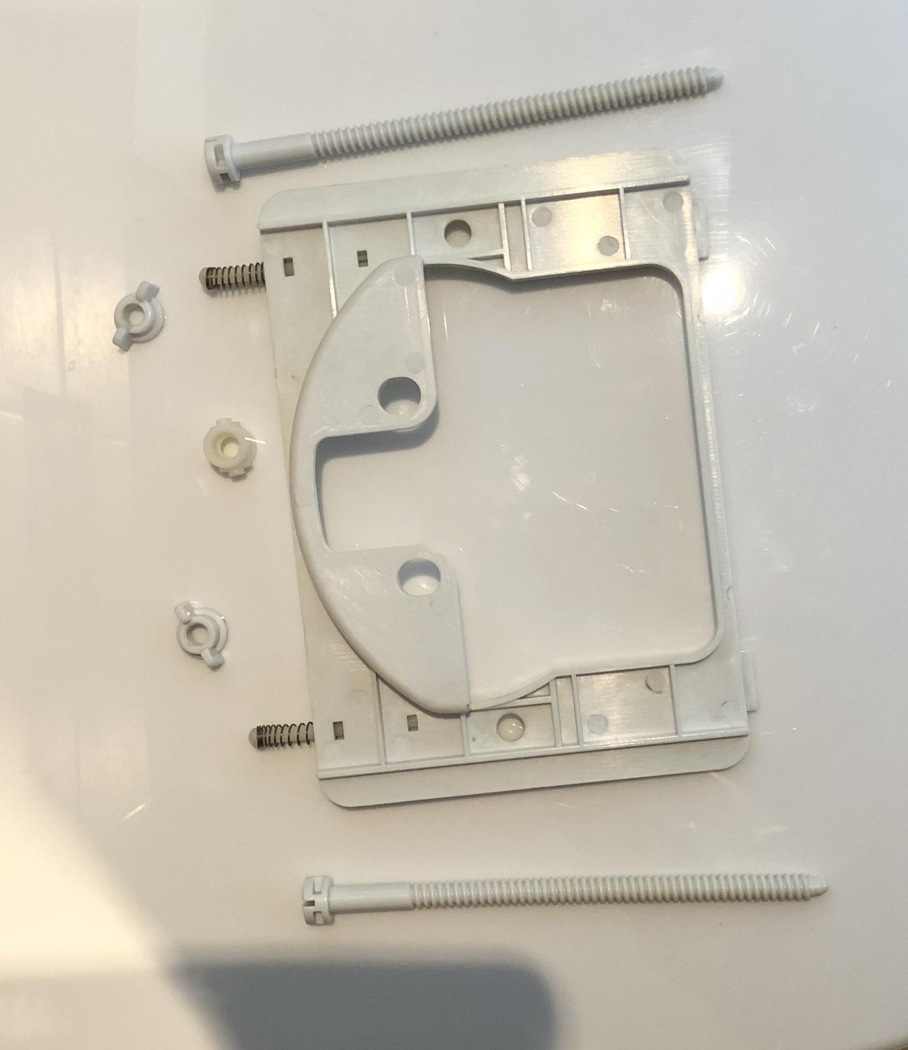

newhome Posted July 20, 2018 Share Posted July 20, 2018 Since I have so far failed to get a plumber out here and I have a number of jobs that need doing I thought that I had better try some of them myself. This is way out of my comfort zone so I’ll be needing quite a lot of help ?. As I don’t know what anything is called I am going to try it @Onoff style with photos. So first up I have a cistern in the loo downstairs that won’t stop running and need to fix it. I am going to attempt to remove everything in one of the ensuite bathrooms that aren’t used to begin with to practice on before tackling the downstairs one. This is what I have when I’ve removed the flush plate and the first panel. I assume that I now need to remove the next white panel so do I just unscrew the 2 things either side? Then what? Link to comment Share on other sites More sharing options...
PeterW Posted July 20, 2018 Share Posted July 20, 2018 The two white threaded bits turn 90 degrees and they should pull out, then the plastic plate will follow 1 Link to comment Share on other sites More sharing options...

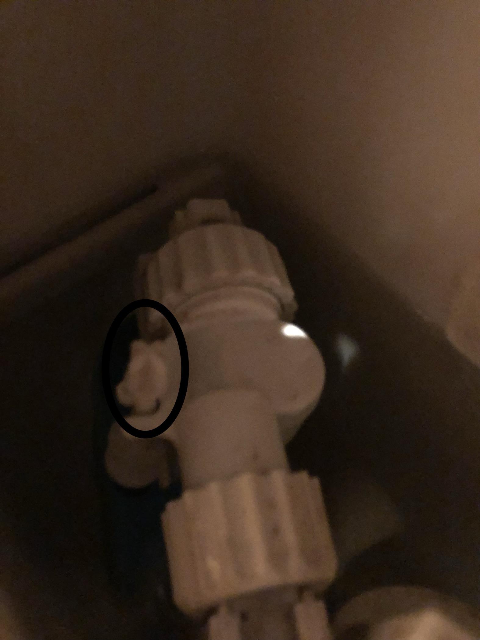

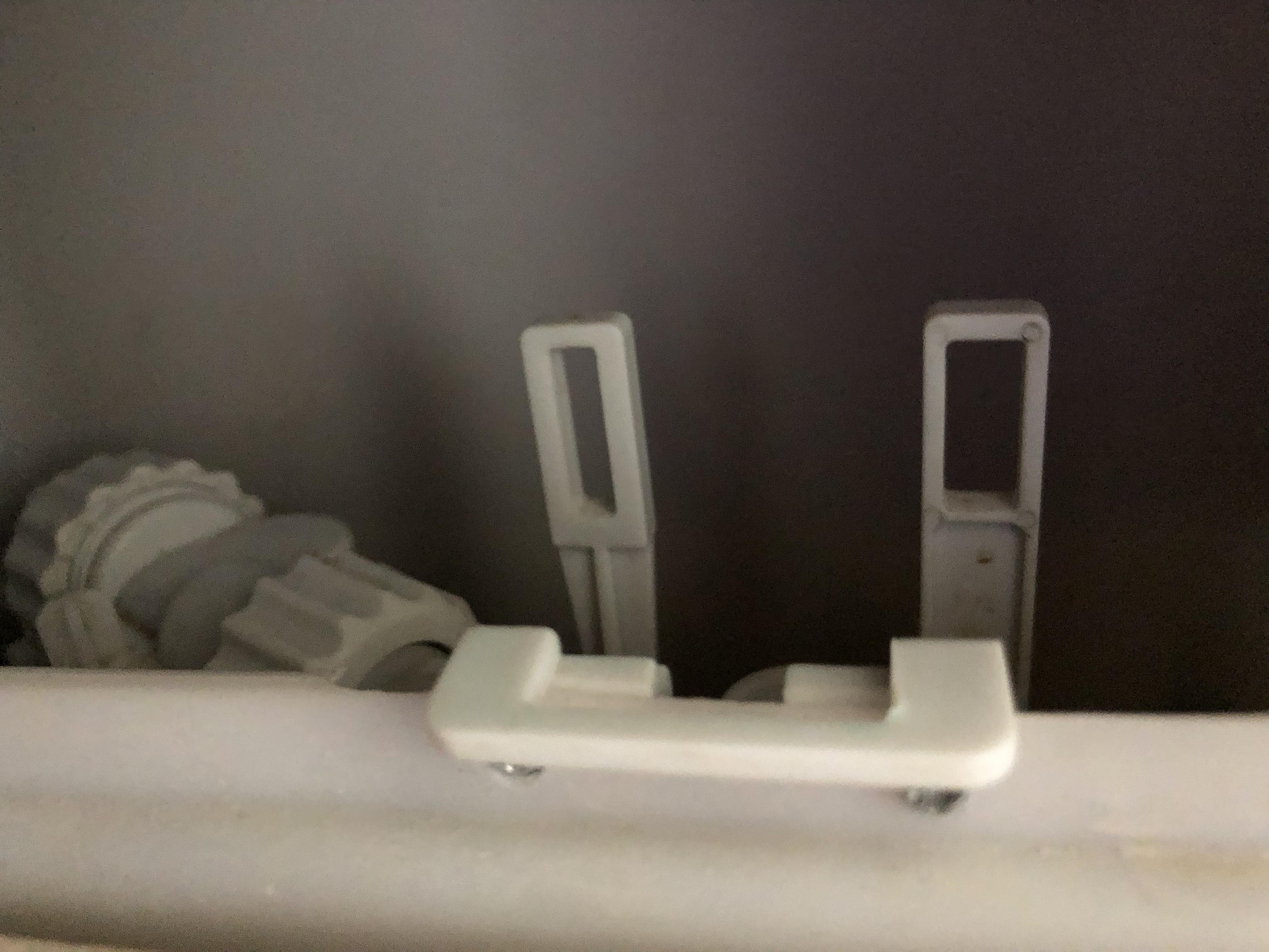

newhome Posted July 20, 2018 Author Share Posted July 20, 2018 Thanks! Too impatient to do it one at a time so now it’s buy one get one free . I think there are 2 different issues. When I flush the upstairs one it stops quite happily so the issue it has with not stopping the water 100% must be to do with the flush mechanism not being attached / working properly when connected. This is what I have, and all quiet on the Western front. Downstairs however with everything disconnected the water continues to run through the cistern. If I pull up the bit circled quite hard it stops but as soon as I let it go it continues to run. So setting aside reattaching the upstairs one for a mo, how can I fix the issue with the one downstairs please? Link to comment Share on other sites More sharing options...

PeterW Posted July 20, 2018 Share Posted July 20, 2018 34 minutes ago, newhome said: Thanks! Too impatient to do it one at a time so now it’s buy one get one free . I think there are 2 different issues. When I flush the upstairs one it stops quite happily so the issue it has with not stopping the water 100% must be to do with the flush mechanism not being attached / working properly when connected. This is what I have, and all quiet on the Western front. Downstairs however with everything disconnected the water continues to run through the cistern. If I pull up the bit circled quite hard it stops but as soon as I let it go it continues to run. So setting aside reattaching the upstairs one for a mo, how can I fix the issue with the one downstairs please? Right circled bit is the float on the fill valve so that “shouldn’t” have anything to do with water leaving the cistern. The silver knob coming from the back - try turning it clockwise towards you and see if the water stops. Link to comment Share on other sites More sharing options...
Jeremy Harris Posted July 20, 2018 Share Posted July 20, 2018 4 minutes ago, PeterW said: circled bit is the float on the fill valve so that “shouldn’t” have anything to do with water leaving the cistern. Unless the cistern is actually over-filling and the overflow is down the pan, as is often the case. In that case it may well be something as simple as the fill/float valve not being adjusted properly, so screwing the circled bit clockwise "should" cause the valve to shut off at a lower level and stop the overflow. Alternatively, the valve could just have failed and be letting by, in which case the best bet is to replace it. 1 Link to comment Share on other sites More sharing options...
ProDave Posted July 20, 2018 Share Posted July 20, 2018 4 minutes ago, PeterW said: Right circled bit is the float on the fill valve so that “shouldn’t” have anything to do with water leaving the cistern. The silver knob coming from the back - try turning it clockwise towards you and see if the water stops. I think the cistern is continuing to fill, and then overflowing down the flush pipe. Turn that bit Peter circled clockwise until the water stops. You might need to then experiment with it a bit as it sets how full the cistern will fill before the water stops. 1 Link to comment Share on other sites More sharing options...
newhome Posted July 20, 2018 Author Share Posted July 20, 2018 6 minutes ago, PeterW said: The silver knob coming from the back - try turning it clockwise towards you and see if the water stops. Yep, water stops. Link to comment Share on other sites More sharing options...
newhome Posted July 20, 2018 Author Share Posted July 20, 2018 11 minutes ago, Onoff said: What make are they? A crap one! @PeterW said he thought they were Abacus I think. Link to comment Share on other sites More sharing options...
PeterW Posted July 20, 2018 Share Posted July 20, 2018 Ok so the isolator works, turn the silver knob 45 degrees til water starts flowing. Now give the circled bit 2 full turns anti-clockwise. 1 Link to comment Share on other sites More sharing options...
newhome Posted July 20, 2018 Author Share Posted July 20, 2018 7 minutes ago, PeterW said: so the isolator works, turn the silver knob 45 degrees til water starts flowing. Now give the circled bit 2 full turns anti-clockwise. Done that but the cistern refills and starts overflowing again. Not sure if it's relevant but there are some bubbles flowing up from within the cistern. Link to comment Share on other sites More sharing options...
PeterW Posted July 20, 2018 Share Posted July 20, 2018 The two rectangular levers - pull the right hand one up and let it flush and see if it settles the fill down again Link to comment Share on other sites More sharing options...
newhome Posted July 20, 2018 Author Share Posted July 20, 2018 Nope. As soon as it flushes even with the tank then empty it is letting a small trickle of water out into the bowl somehow when the flush stops. When it refills the trickle becomes a flow and it continues to fill. Does the silver knob just determine how fast the water flows in? Link to comment Share on other sites More sharing options...
PeterW Posted July 20, 2018 Share Posted July 20, 2018 Yes. The white bit is the screw that controls the float that sets the water level. Could be a cistern flush seal that’s gone. I think they are a Siamp flush unit ... Link to comment Share on other sites More sharing options...

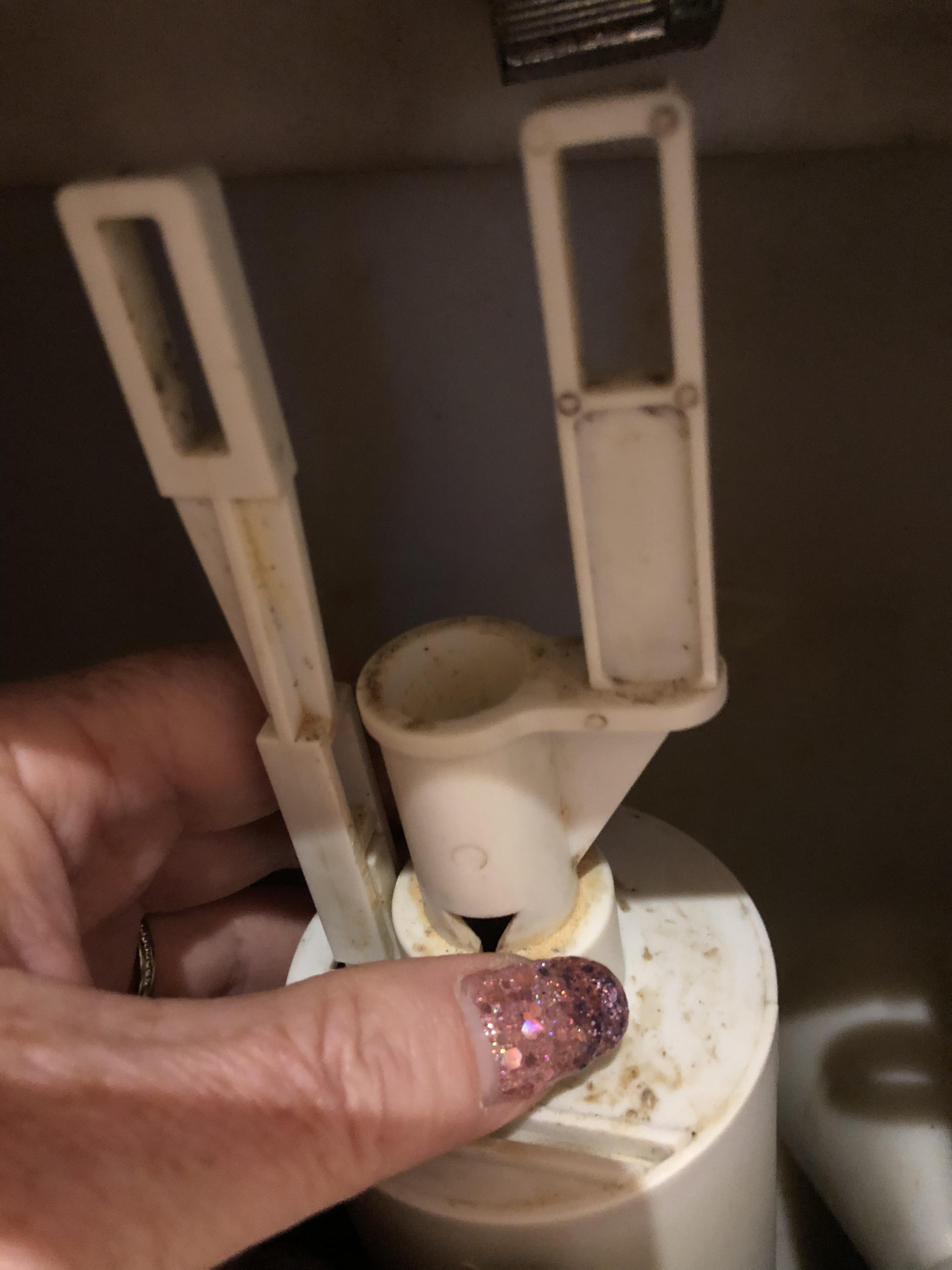

newhome Posted July 20, 2018 Author Share Posted July 20, 2018 23 minutes ago, PeterW said: take hold of the thing with the two plastic rectangles by the tube, So the thing with the 2 plastic rectangles goes inside a larger tube further down. Is it the tube going into the larger one that I need to remove or the actual larger one? ? Link to comment Share on other sites More sharing options...
PeterW Posted July 20, 2018 Share Posted July 20, 2018 The larger tube is a complete assembly - should come out in one go Link to comment Share on other sites More sharing options...
Nickfromwales Posted July 20, 2018 Share Posted July 20, 2018 Take pics for what came from where. The main flush assembly quarter turns like changing a lightbulb. 1 Link to comment Share on other sites More sharing options...
newhome Posted July 20, 2018 Author Share Posted July 20, 2018 Just now, Nickfromwales said: Take pics for what came from where. The main flush assembly quarter turns like changing a lightbulb. Thanks. I've managed to get it off (arms now look like I've had a fight with a bramble bush - I won't be giving up the day job ). I can't get the unit out though as it seems too long to get through the small hole . Link to comment Share on other sites More sharing options...

newhome Posted July 20, 2018 Author Share Posted July 20, 2018 1 minute ago, Nickfromwales said: It all comes out. That's the design. Have a single voddy and then revisit it. If I have a voddy it’ll be coming out in bits! I’ve been googling but have ended up on the Screwfix forum where people are being called knobs for fitting a wall hung one to start with. And all the videos I’ve found are for installation not maintenance. In the gerberit video looks like the bits that stick up unclip to make it shorter. Is that what I need to do? These bits. Link to comment Share on other sites More sharing options...
