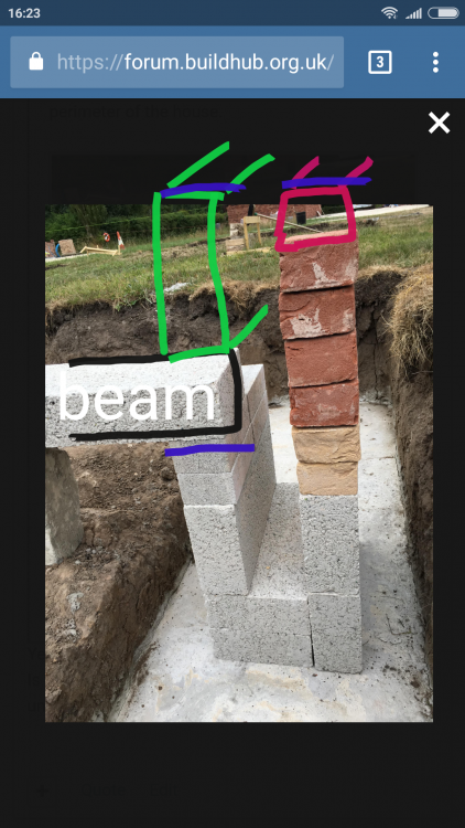

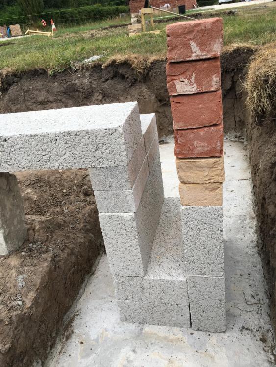

epsilonGreedy Posted July 19, 2018 Author Share Posted July 19, 2018 9 minutes ago, Declan52 said: What depth of insulation and concrete is going on top of the beams. Probably 120mm + 75mm with UFH pipes embedded. Link to comment Share on other sites More sharing options...
Declan52 Posted July 19, 2018 Share Posted July 19, 2018 28 minutes ago, epsilonGreedy said: Probably 120mm + 75mm with UFH pipes embedded. You should be looking at 150mm min pir type insulation. Been a long time since I used Jeremys heat loss calculator but you should put in 120mm and 150mm in the floor section and see what the difference is and take it from there. 1 Link to comment Share on other sites More sharing options...
epsilonGreedy Posted July 21, 2018 Author Share Posted July 21, 2018 On 20/07/2018 at 00:13, Declan52 said: You should be looking at 150mm min pir type insulation. Been a long time since I used Jeremys heat loss calculator but you should put in 120mm and 150mm in the floor section and see what the difference is and take it from there. Yes I feel the same, think 120mm just scrapes past building regs. I have been delaying doing serious number crunching on SAP calcs. Link to comment Share on other sites More sharing options...
Declan52 Posted July 21, 2018 Share Posted July 21, 2018 You kind of need to know your finished floor height before you start your founds as all your measurements will be based around this. Time to get the calculator warmed up. Link to comment Share on other sites More sharing options...
epsilonGreedy Posted July 21, 2018 Author Share Posted July 21, 2018 5 hours ago, Declan52 said: You kind of need to know your finished floor height before you start your founds as all your measurements will be based around this. Time to get the calculator warmed up. Ok. As a matter of interest why would it not be possible to up the PIR by 30mm to 150mm just before scheduling the screed contractor? Something to do with door thresholds perhaps? Link to comment Share on other sites More sharing options...
PeterW Posted July 21, 2018 Share Posted July 21, 2018 Door thresholds, ceiling heights, outside doors, the list goes on... Link to comment Share on other sites More sharing options...
epsilonGreedy Posted July 21, 2018 Author Share Posted July 21, 2018 15 minutes ago, PeterW said: Door thresholds, ceiling heights, outside doors, the list goes on... Right I need to up SAP calcs into next week's todo list. I had assumed that my plan to use aerated blocks for the inner wall coupled with 25mm PIR lined internal walls would give my SAP score such a boost only 120mm under the floor would be just enough. Link to comment Share on other sites More sharing options...
