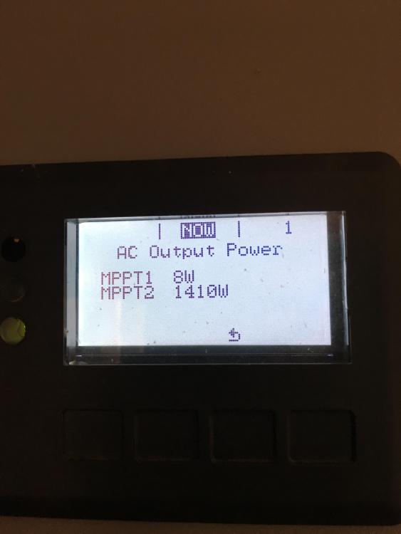

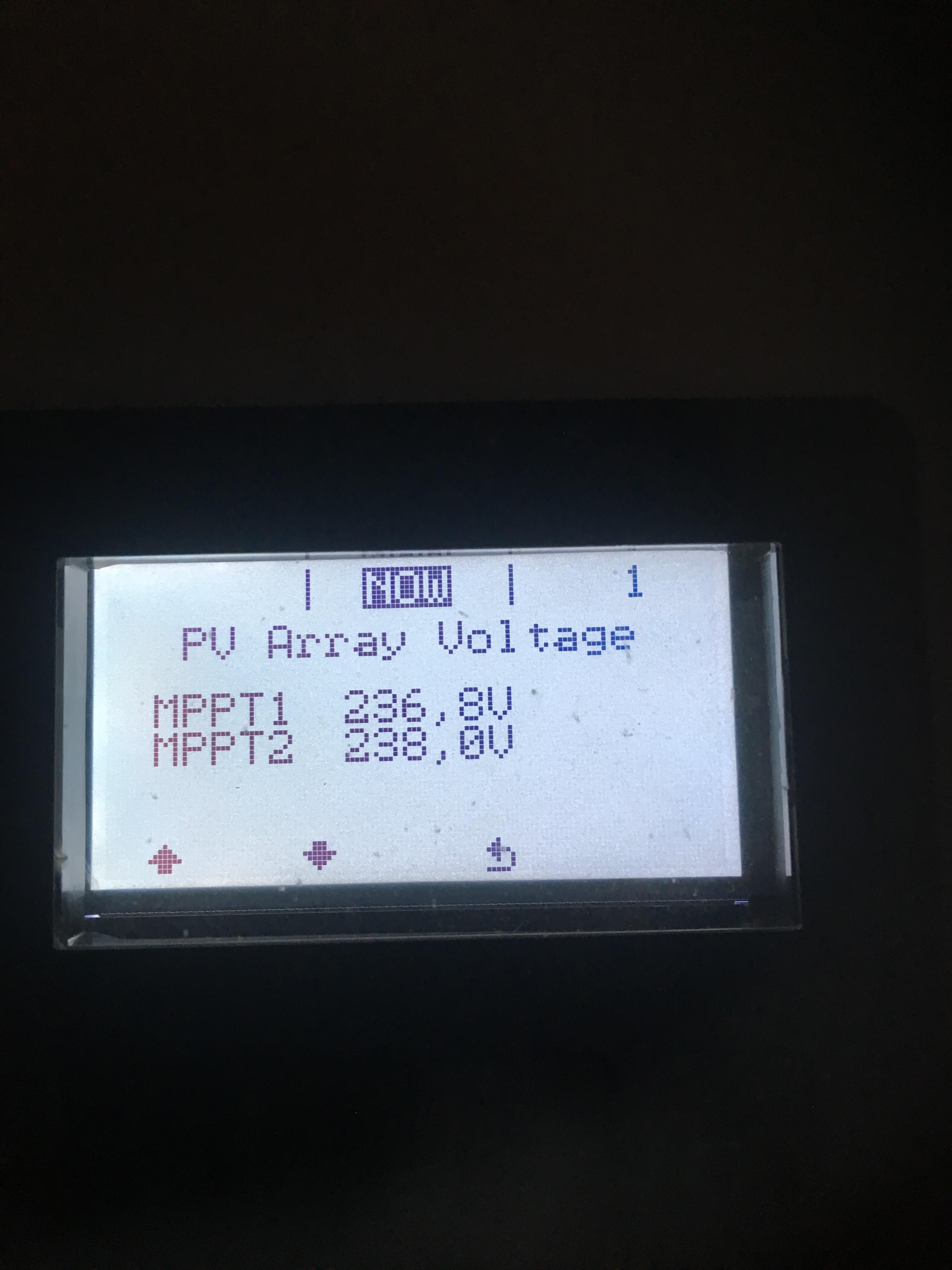

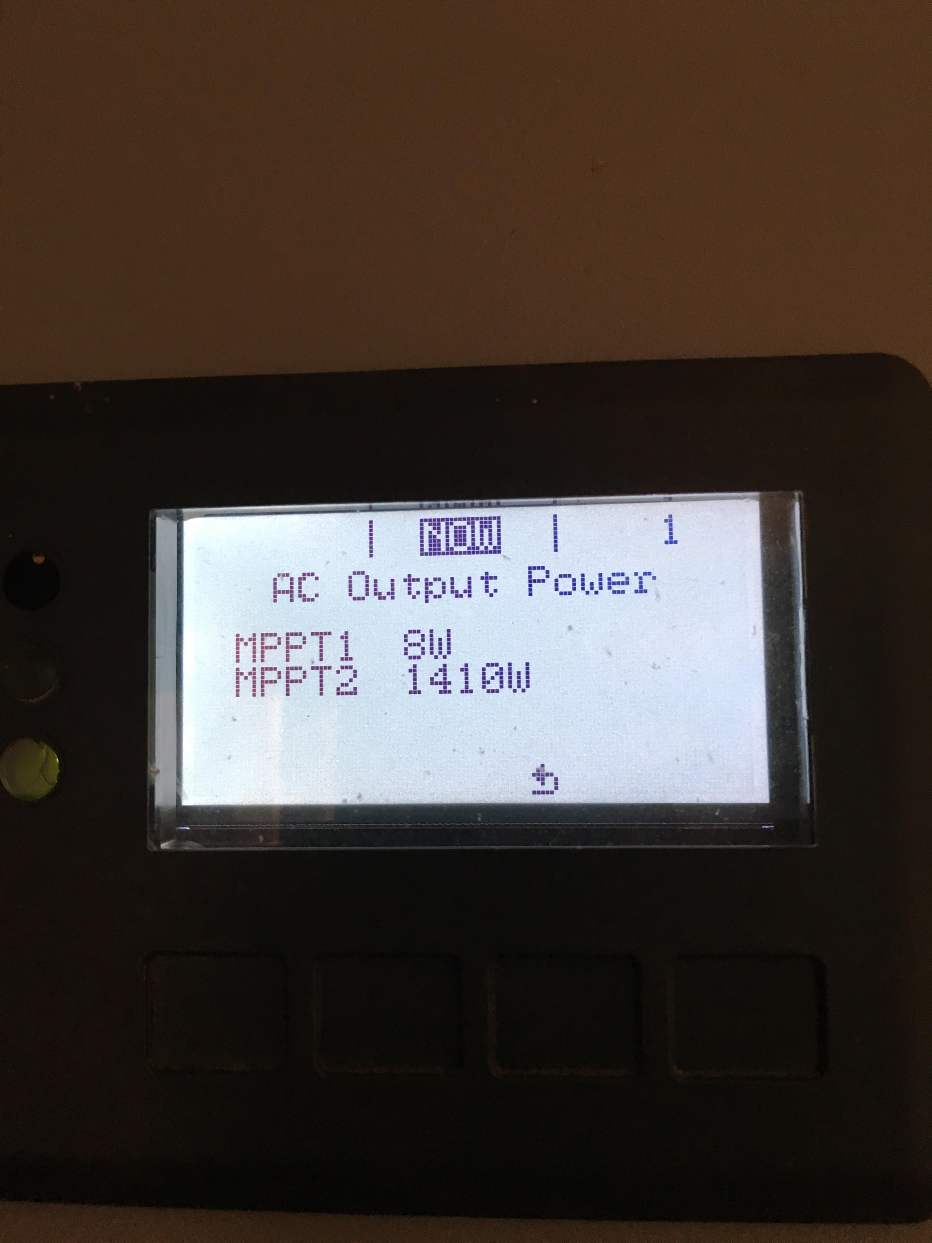

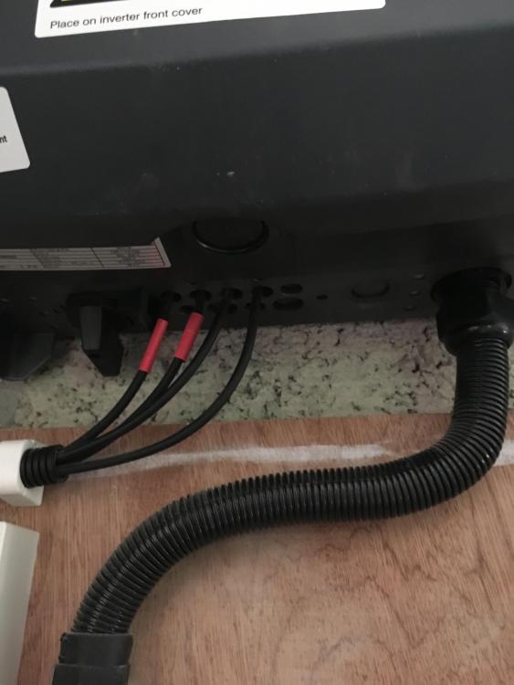

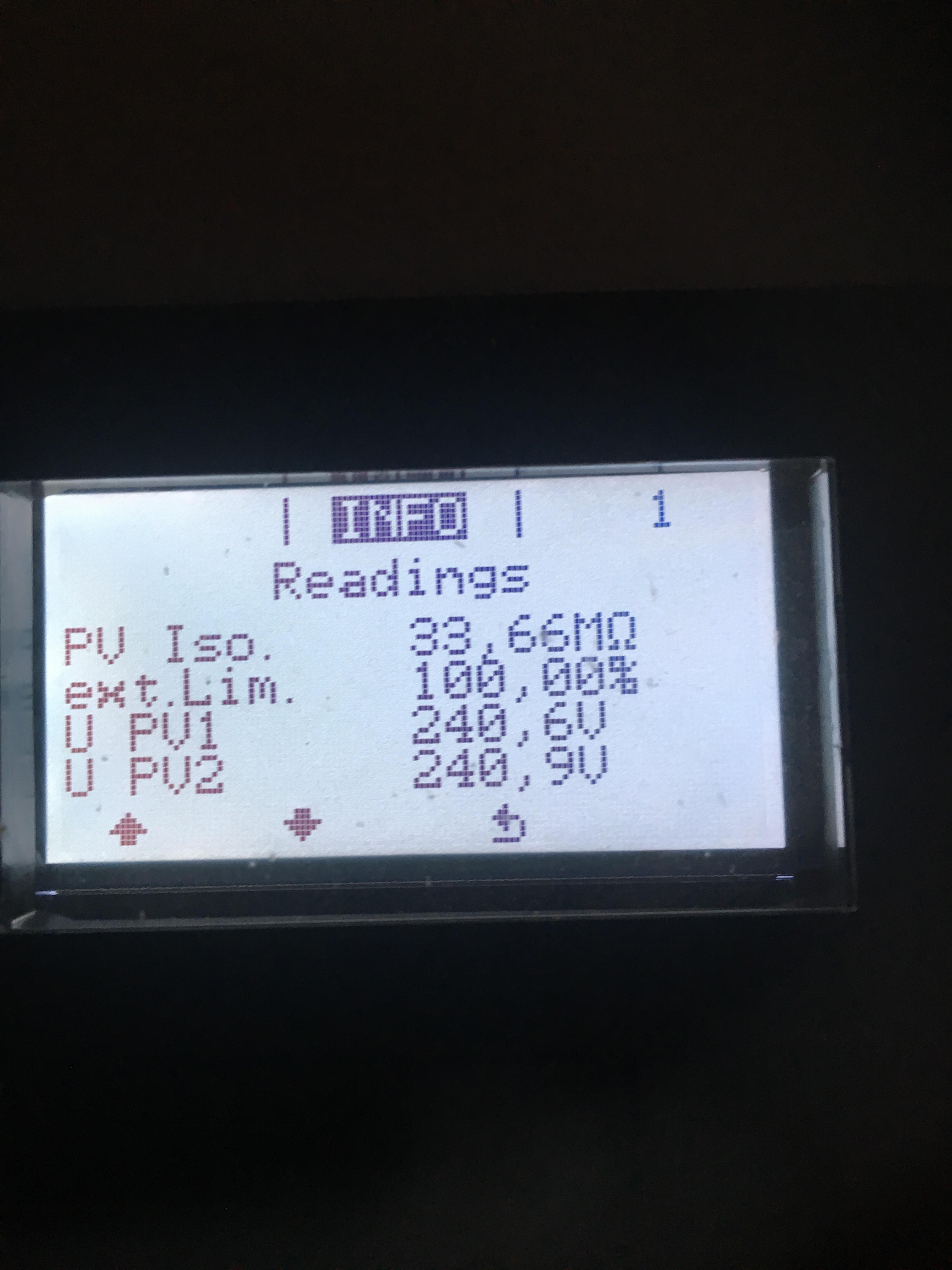

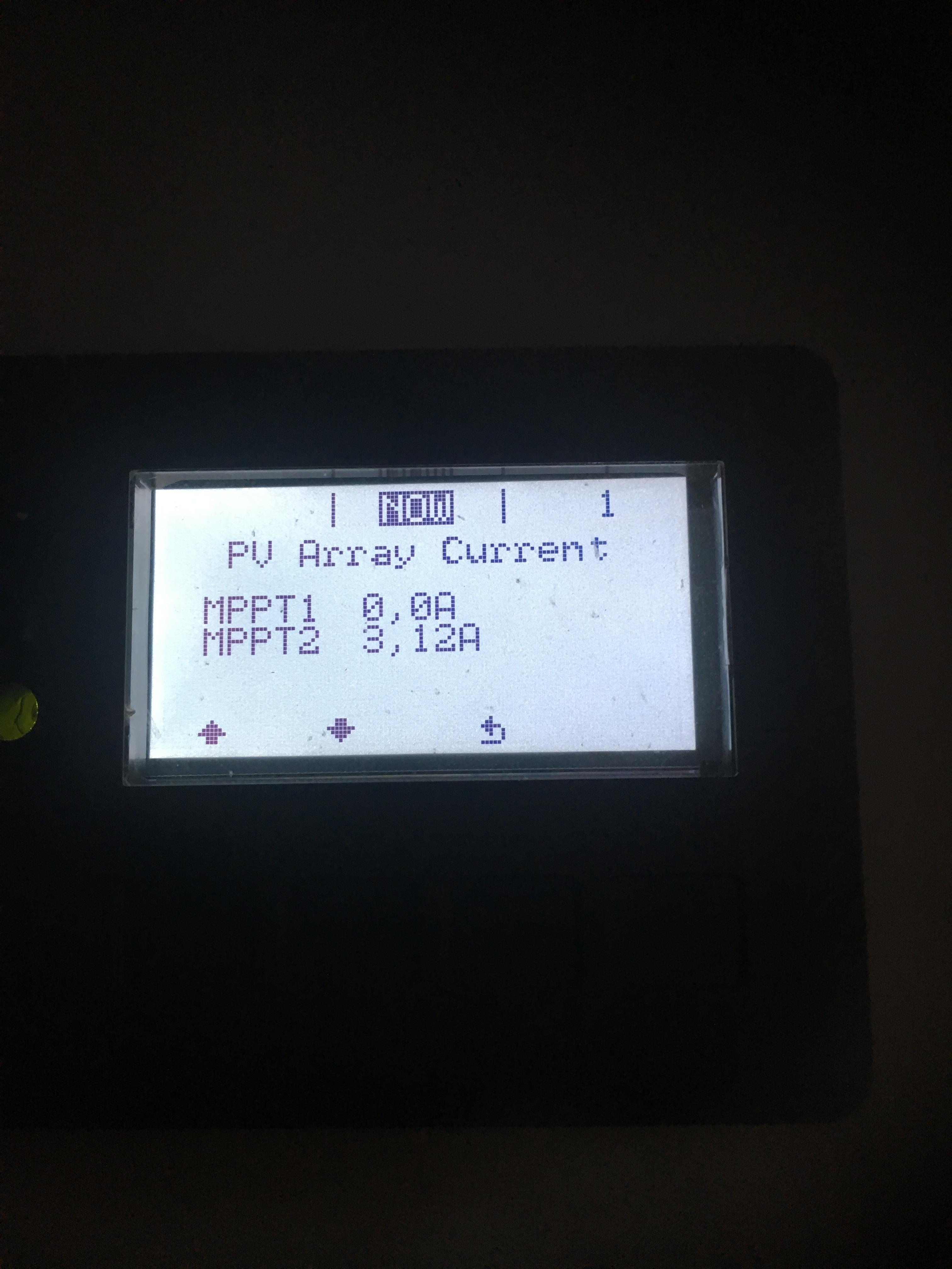

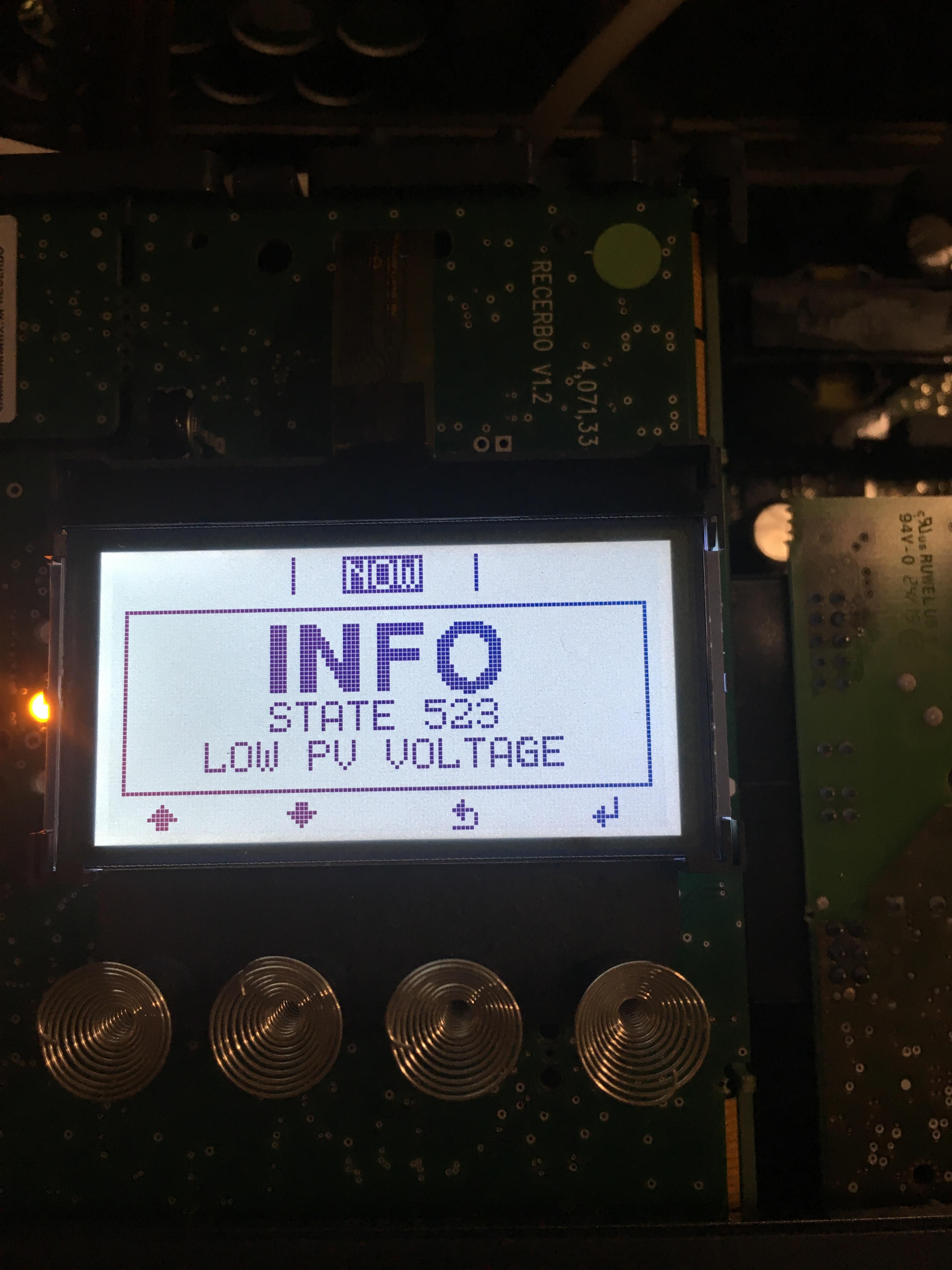

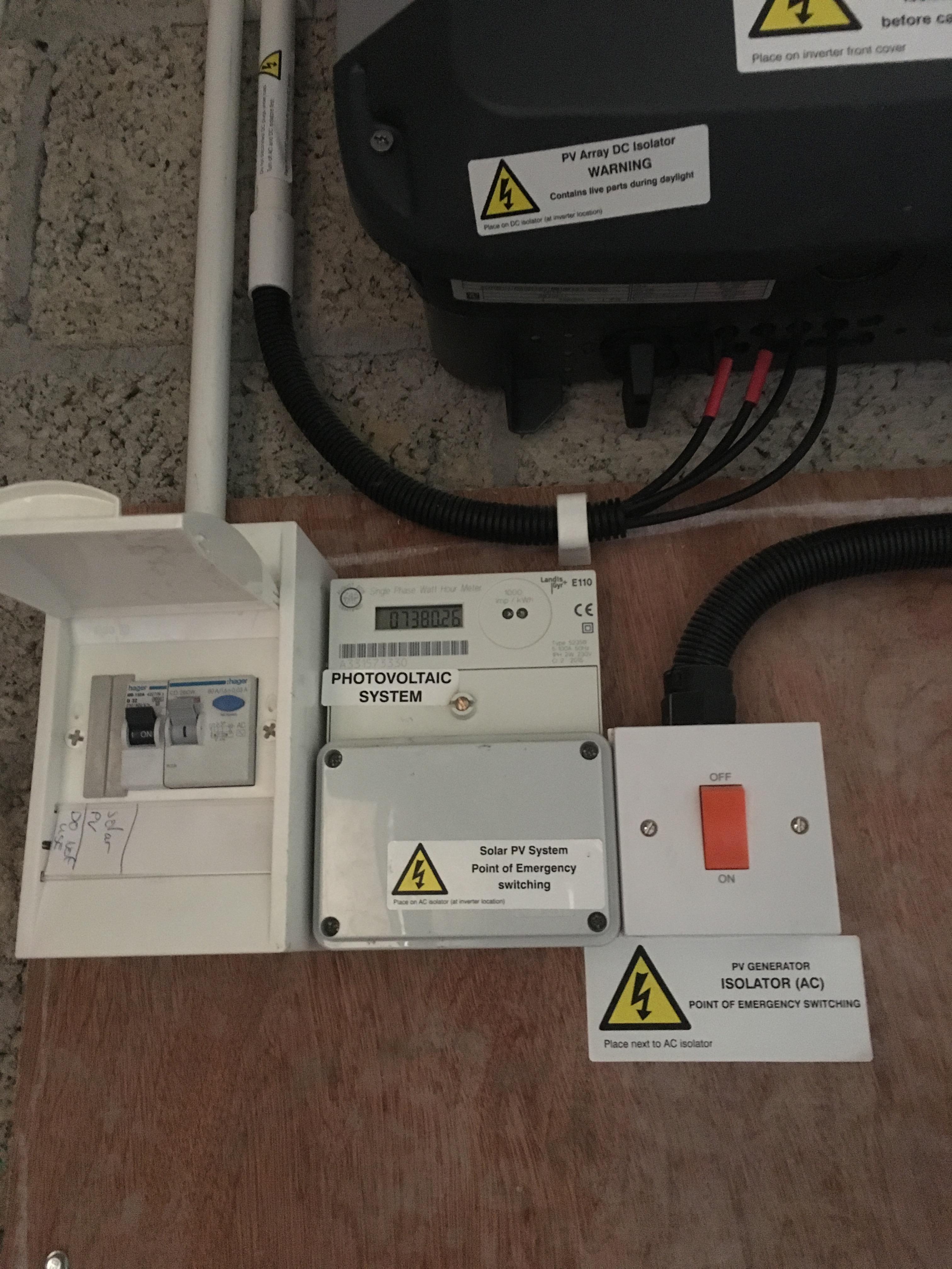

Cs111 Posted July 3, 2018 Posted July 3, 2018 (edited) I know some of you guys have panels from sun renewables who I also understand are no longer trading. Though companies house have them as still active. I’m after some advice really. fronius inverter, sharp panels I noticed that there is only approx half of the normal kw of electricity being produced by the panels over the past week - would days. We have a 4kw system split into 2 strings, today we were only seeing about 1300w. - 1800w On inspection of the fronius primo inverter there is a code STATE 522 DC1 Input Voltage too low It seems to be showing 0w - 10w being produced on dc1 and normal production or approx 1600w - 1800w on dc2. any ideas would be appreciated Edited July 3, 2018 by Cs111 Added pictures
Jeremy Harris Posted July 3, 2018 Posted July 3, 2018 Looks like one string of panels has gone open circuit. Most likely culprit will be a connector in that string I think. The only easy way to tell is to get up on the roof and have a look at the connectors. There can be problems if connectors aren't crimped to the cables correctly, leading to overheating and an open circuit, but equally it could be something as simple as a connector that's somehow been subjected to strain and just come unplugged - I've heard of that happening when people have poked around trying to clear birds nests from underneath panels. As a test, you can turn off the DC isolators and then swap over the DC inputs on the inverter (they should just plug in). If you then turn the DC isolators back on and the fault shifts to MPPT 2 you know that it's the panel string that is at fault, not the inverter. FWIW, my money is on a duff connection on the string feeding MPPT 1.
PeterW Posted July 3, 2018 Posted July 3, 2018 Could always isolate both strings, switch the connections between input 1 and input 2 to see if the fault "moves" which would indicate either a cable issue or a connection issue to the strings. Reading the MPPT figures though it would indicate the panels have output. Have you got the manual..? Crossed with JSH

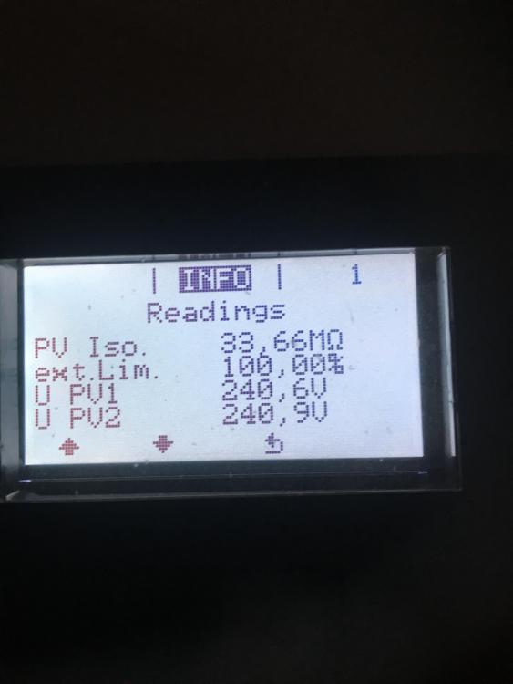

ProDave Posted July 3, 2018 Posted July 3, 2018 I would have said inverter fault as both strings seem to show the same voltage. I would also swap the strings over, and to be really safe wait until after dark to do that just in case you touch the wrong thing, And see if tomorrow the fault shows on the same string, in which case it is an inverter problem, or the fault moves to the other side in which case it is a panel or wiring fault.
Jeremy Harris Posted July 3, 2018 Posted July 3, 2018 I've got a feeling that the indicated MPPT voltage floats up when a string goes open circuit, from internal leakage, but you might be right. Swapping the strings over on the inverter should prove it one way or the other though.

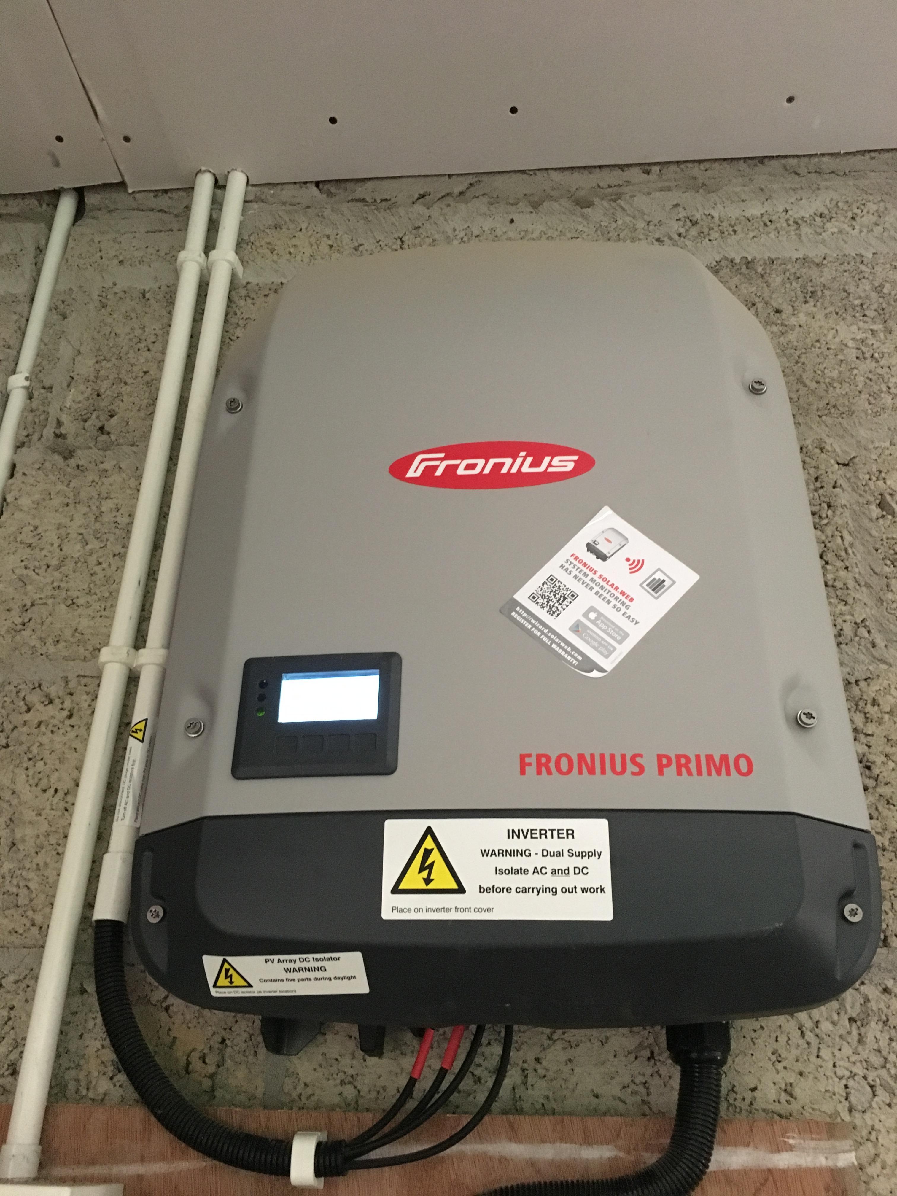

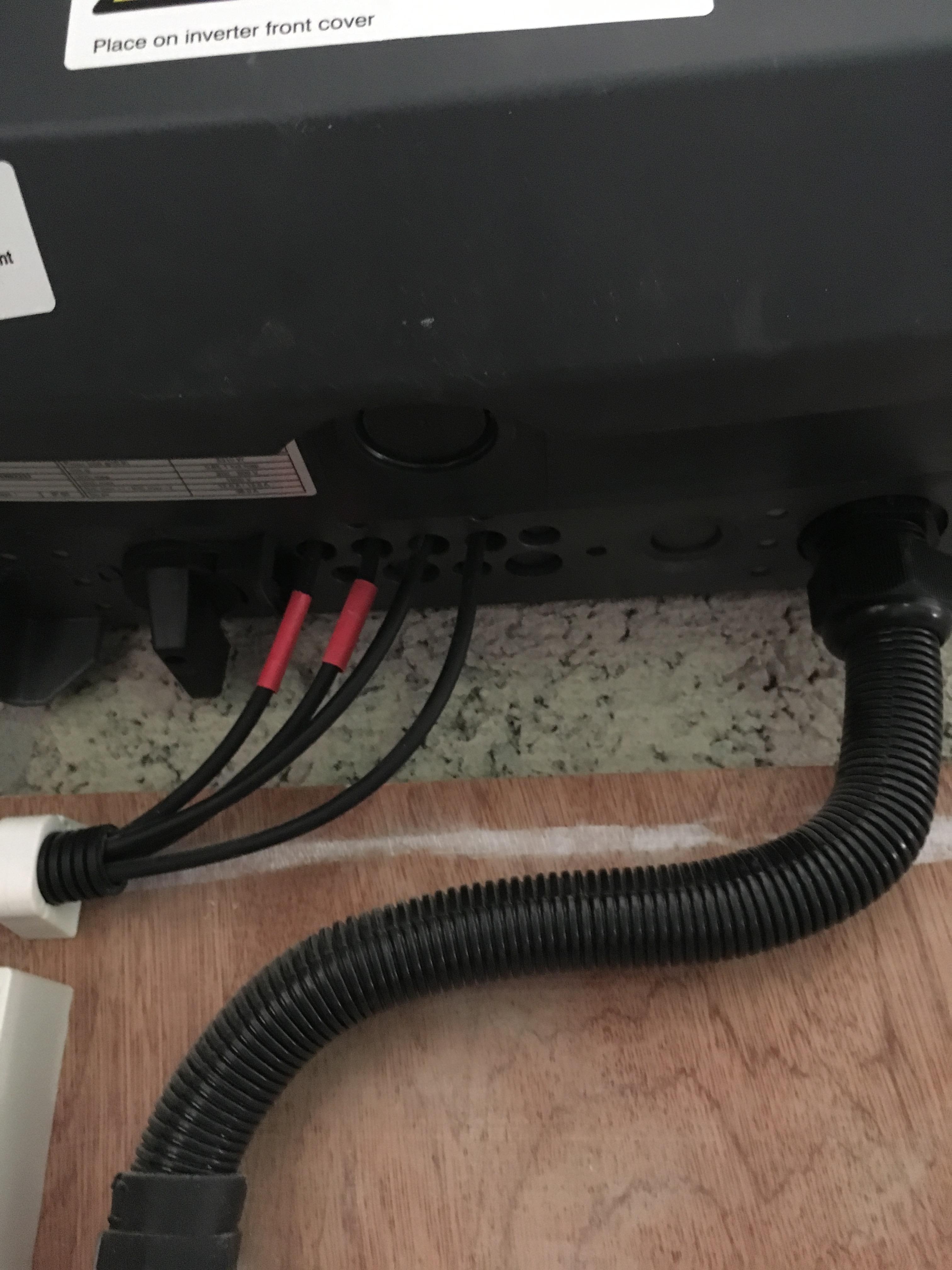

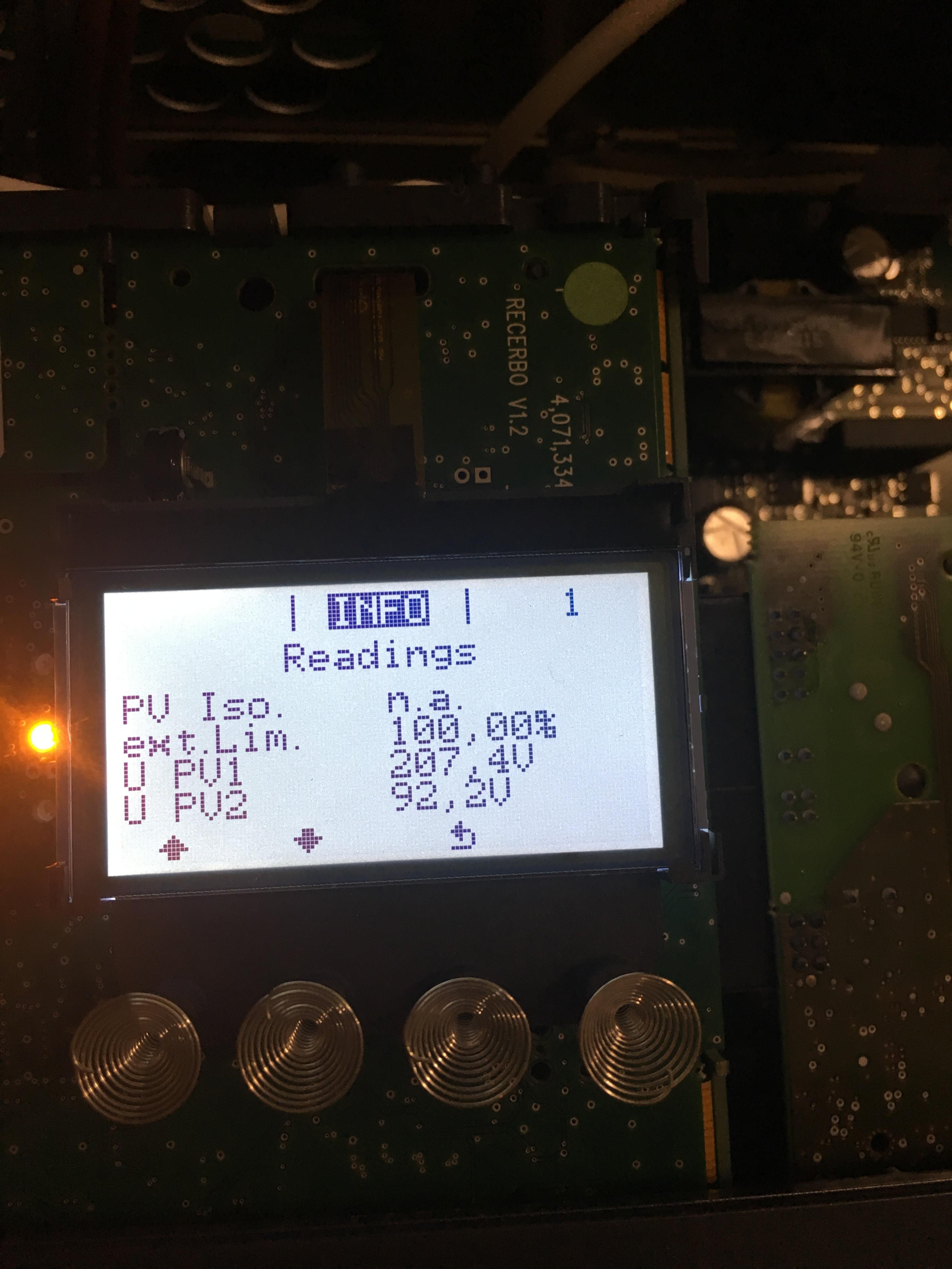

Cs111 Posted July 3, 2018 Author Posted July 3, 2018 Here are a couple more pics Showing mppt1 and mppt2 So you mean swapping over the 4 black cables ( 2 with red tops ) i don’t think they will simply unplug but will have a closer look later tonight and made sure I switch everything off just incase
Jeremy Harris Posted July 3, 2018 Posted July 3, 2018 It doesn't look as if the DC connections unplug, but there should be a pair of DC isolator switches fitted, one for each string, so that the system can be made safe. These are usually fitted right next to the inverter, but don't seem to be in your case. The usual type fitted are quarter turn rotary switches, with a yellow or white case and red knob. These isolate the DC from the panel strings so allowing the inverter to be replaced, and I thought they were a mandatory requirement. The four wires going in to the bottom are the cables from the two strings a positive and negative for each, and MPPT1 and MPPT2 should be marked inside next to the terminals, or on the underside of the cover, perhaps. Because you have to access the terminals by removing that cover, the instructions on it need to be followed, to turn off both the DC and AC isolator switches. Often the inverter AC isolator switch will be fitted right next to the generation meter and consumer unit connection.
Cs111 Posted July 3, 2018 Author Posted July 3, 2018 There is a quarter turn knob under the inverter if you look just to the left of the red wires
PeterW Posted July 3, 2018 Posted July 3, 2018 On 03/07/2018 at 19:05, Cs111 said: There is a quarter turn knob under the inverter if you look just to the left of the red wires Expand That shouldn’t be the only isolator. Is there a pair in an attic somewhere ..?

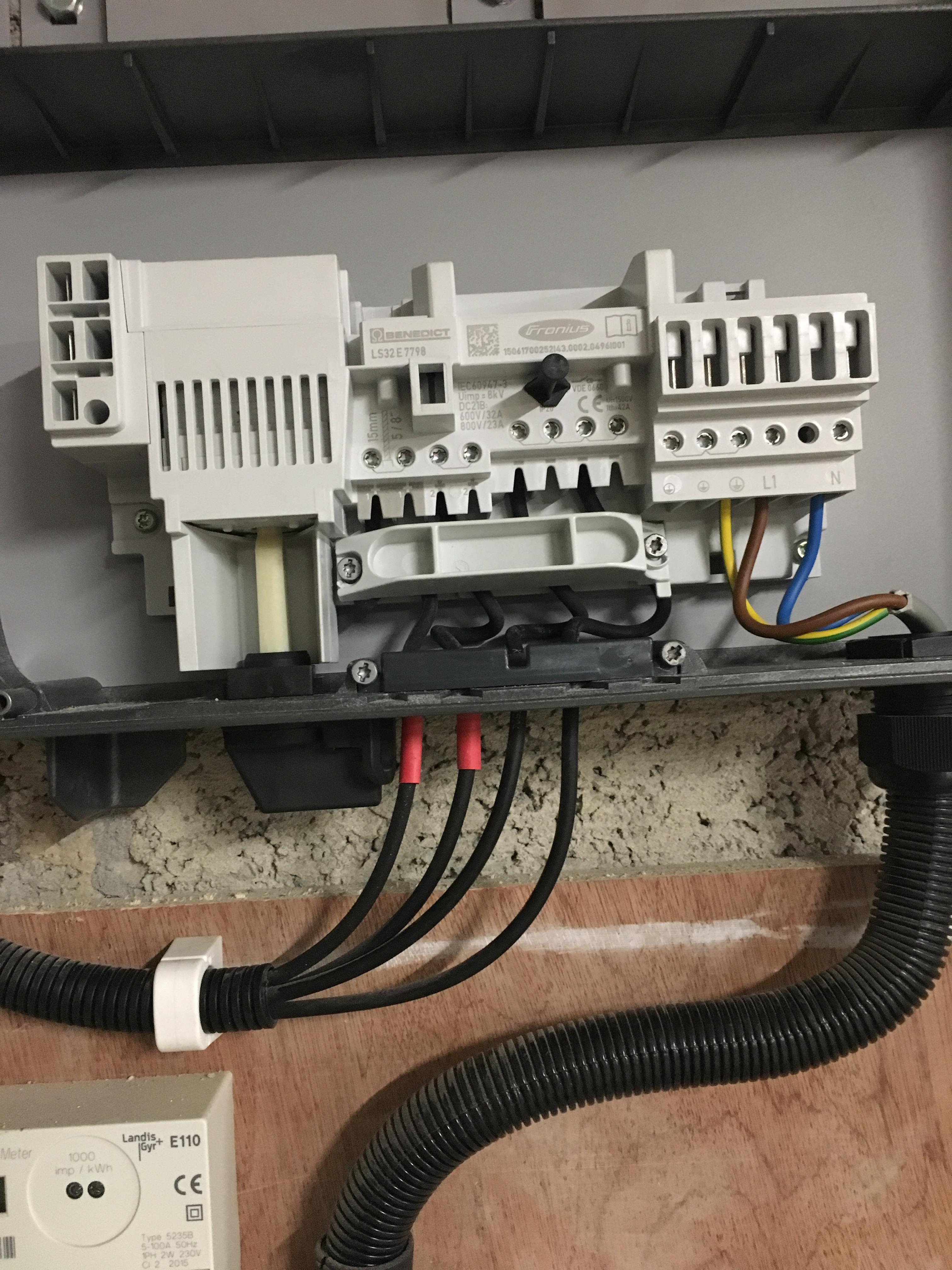

Cs111 Posted July 3, 2018 Author Posted July 3, 2018 (edited) Ok so I had a look in attic and followed the 4 black wires from the roof right down to the inverter and no other isolator or switches of any type. Had a look at the quarter turn knob on the bottom of the invertor, it says disconnect beside it if that helps Edited July 3, 2018 by Cs111

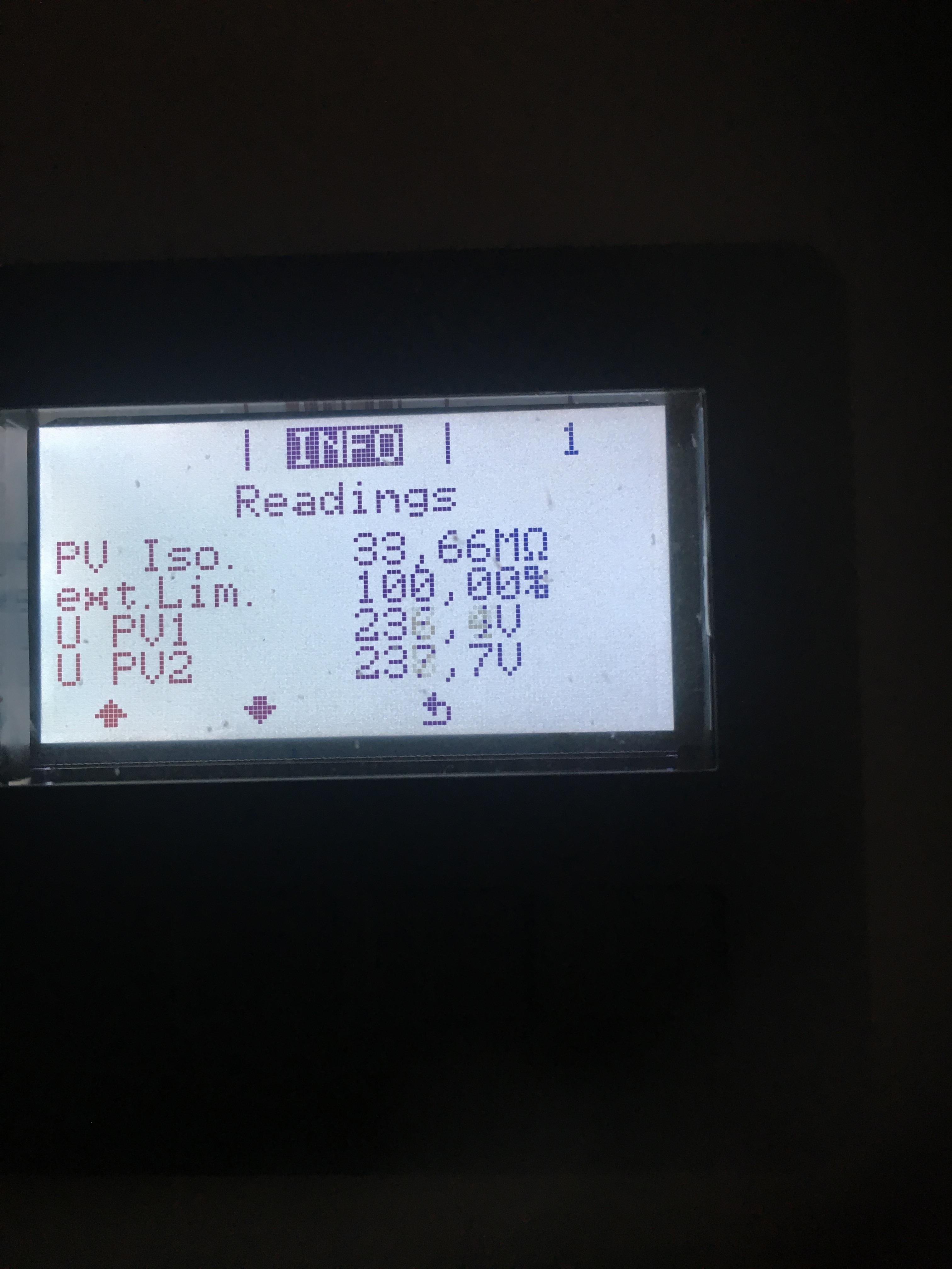

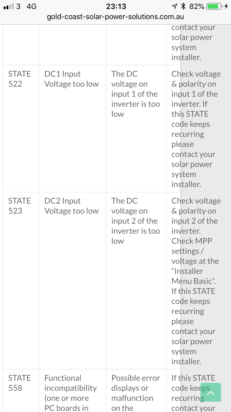

Cs111 Posted July 3, 2018 Author Posted July 3, 2018 (edited) Just swapped over the 2 sets of wires and it’s now showing the same message except state 523. Instead of state 522. i will check the mppt tomorrow when there is some daylight why would U PV1 be showing approx twice the V of U PV2 ? Also so here is a screenshot from fronius regarding the 2 codes , 522 and 523. Note 523 is slightly different from 522 Edited July 3, 2018 by Cs111
Declan52 Posted July 3, 2018 Posted July 3, 2018 The fault codes are below so by swapping the wires the fault has moved to the other string. Is that not what was supposed to happen. 1

Jeremy Harris Posted July 4, 2018 Posted July 4, 2018 That test has confirmed that it's the string at fault, not the inverter. @SteamyTea is dead right, this isn't unusual and they can be a pain to get at, as the connectors are under the panels on the roof.
Cs111 Posted July 4, 2018 Author Posted July 4, 2018 Yea just checked invertor screen and the fault has swapped to mppt2 now showing 0w. so that confirms it’s a panel, connection fault. Next step I guess it to check each panel one by one. Is it safe to do this with the invertor , ac switch off ?
