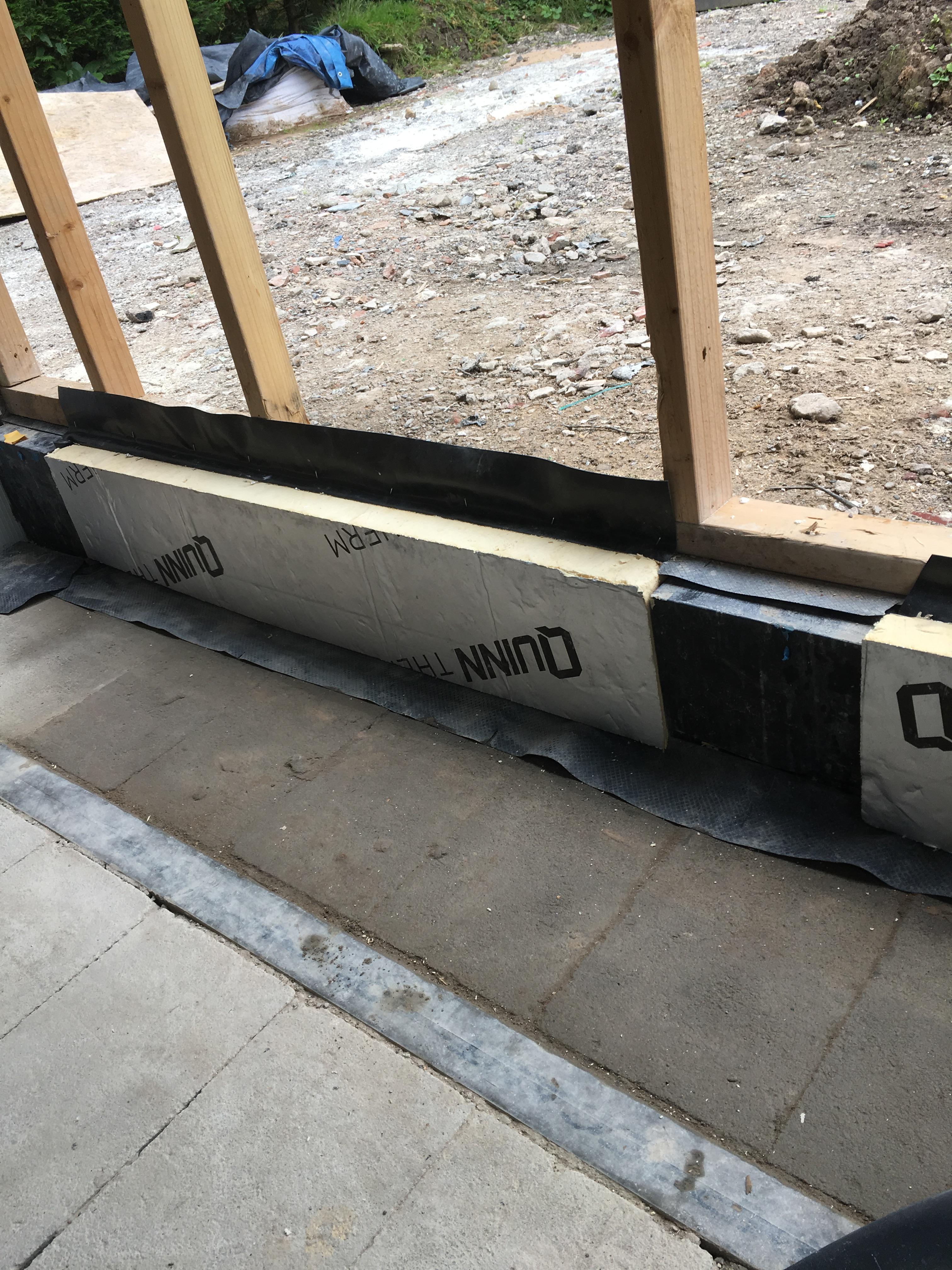

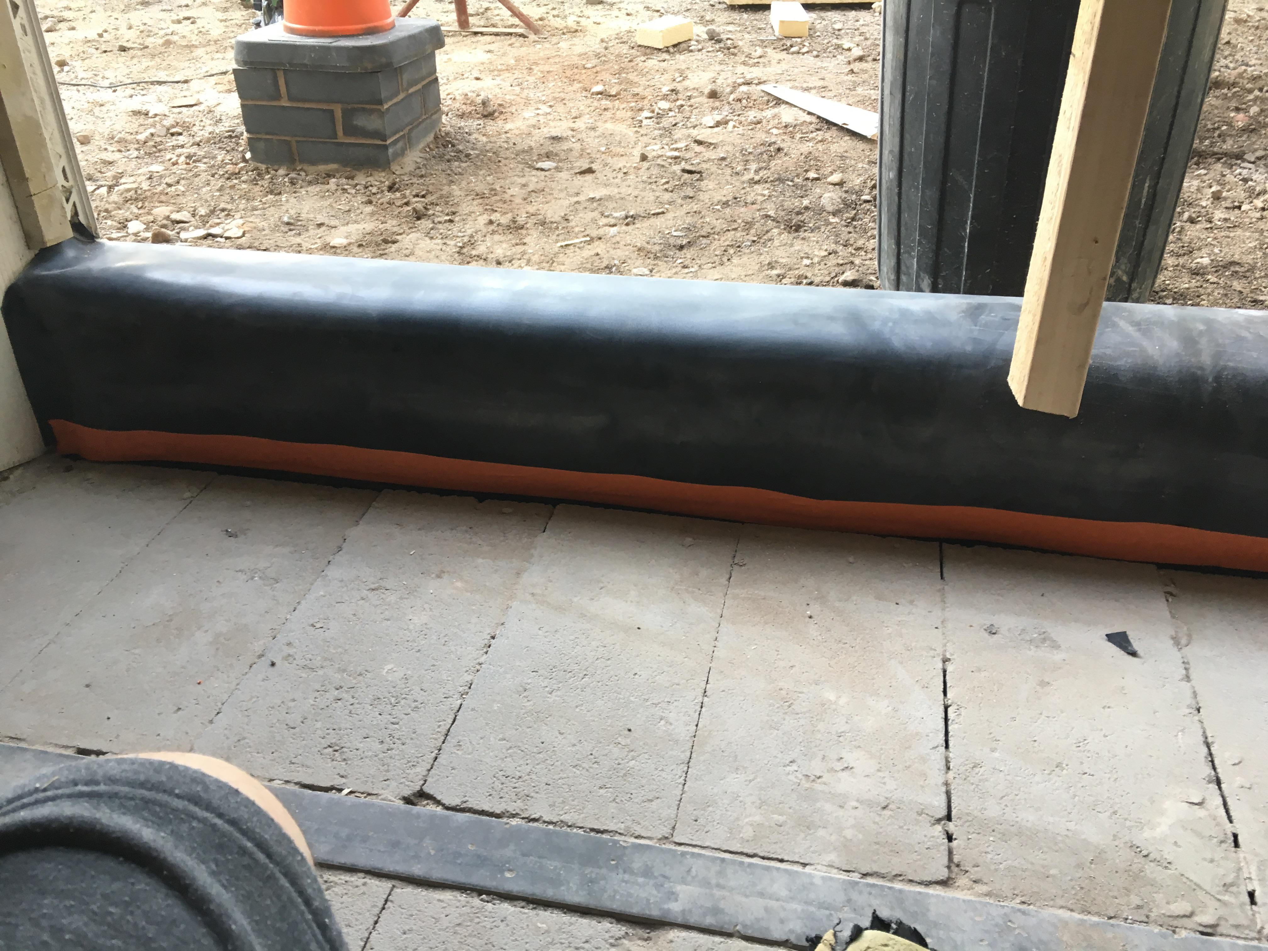

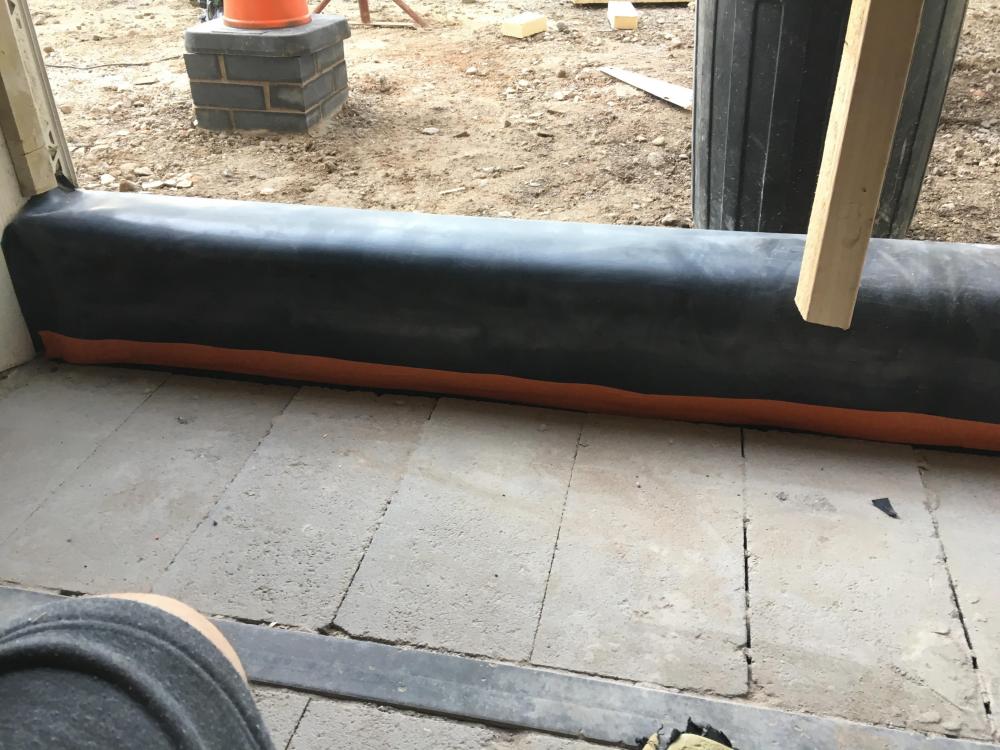

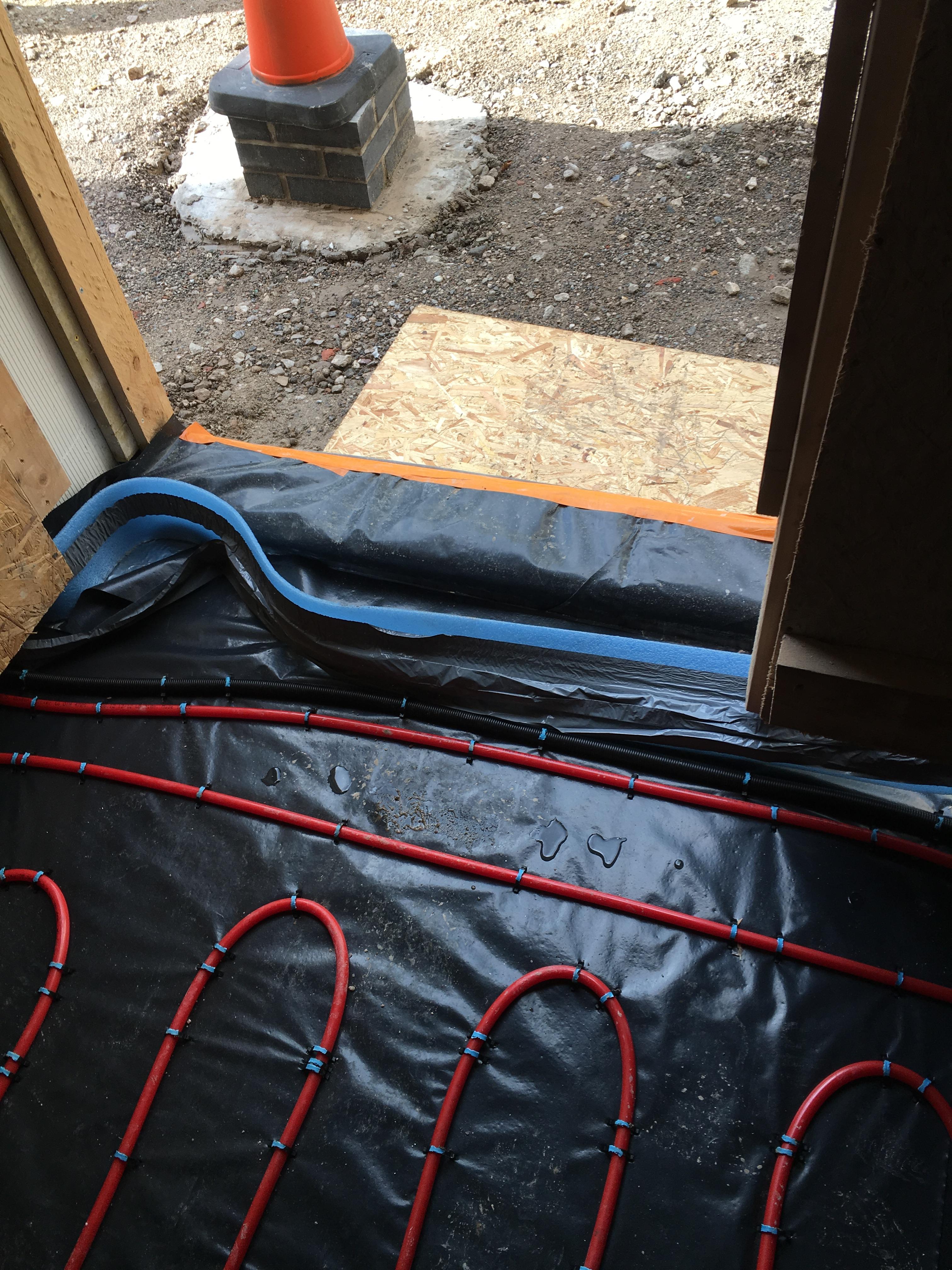

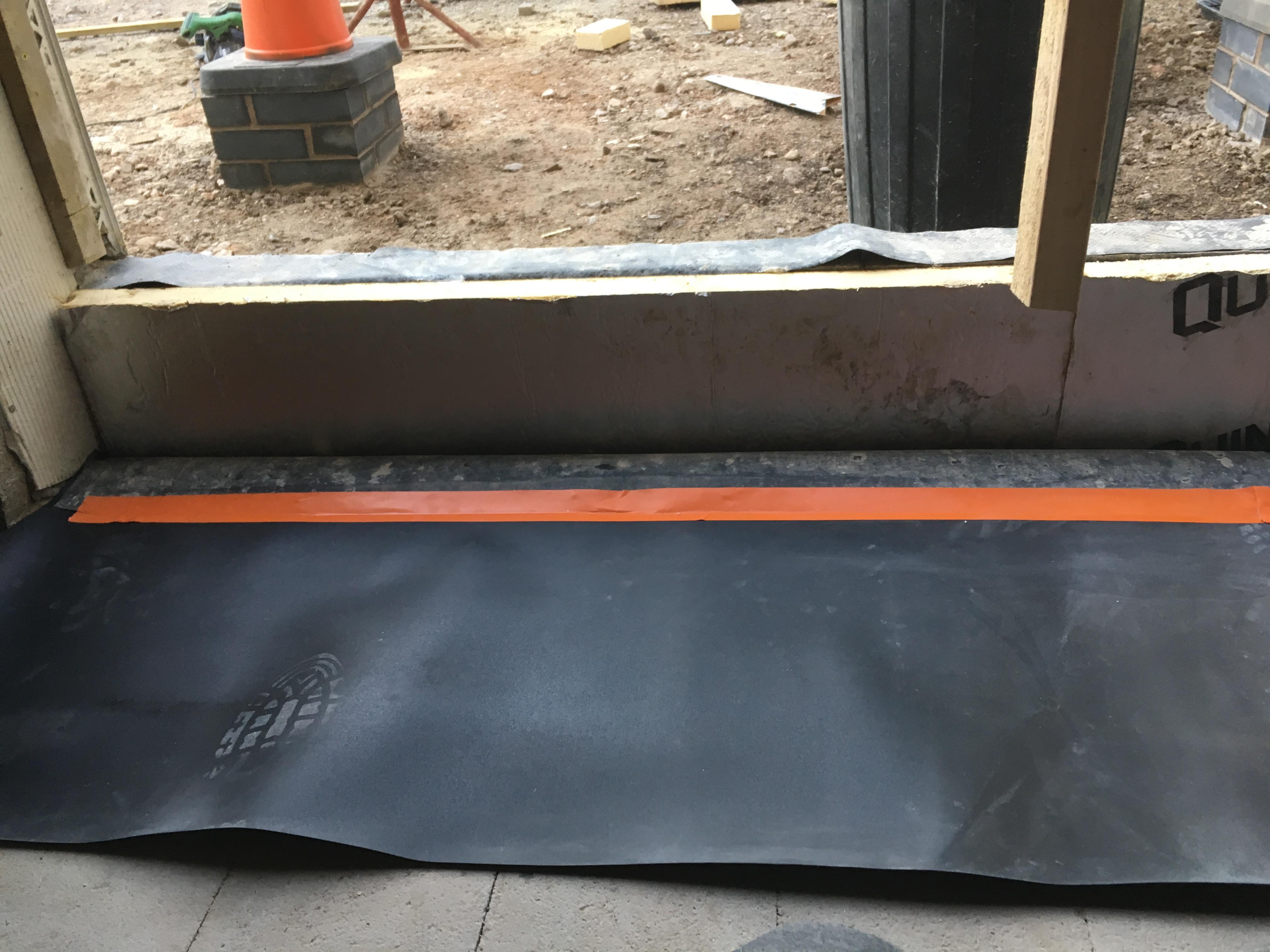

I’m not sure if this will help with the external ground level But the internal block across each doorway can be nicked out and the screed returned against the external brick
Heres a couple of pictures that I took for BC
